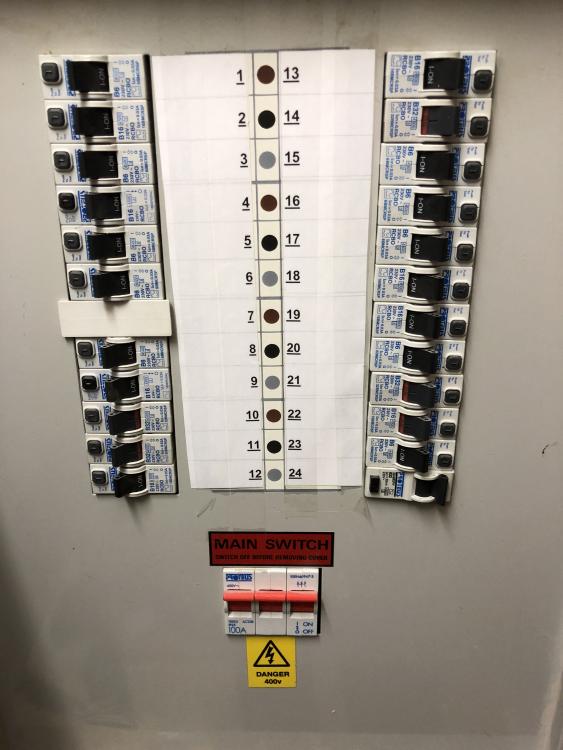

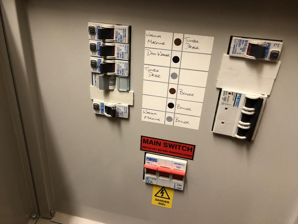

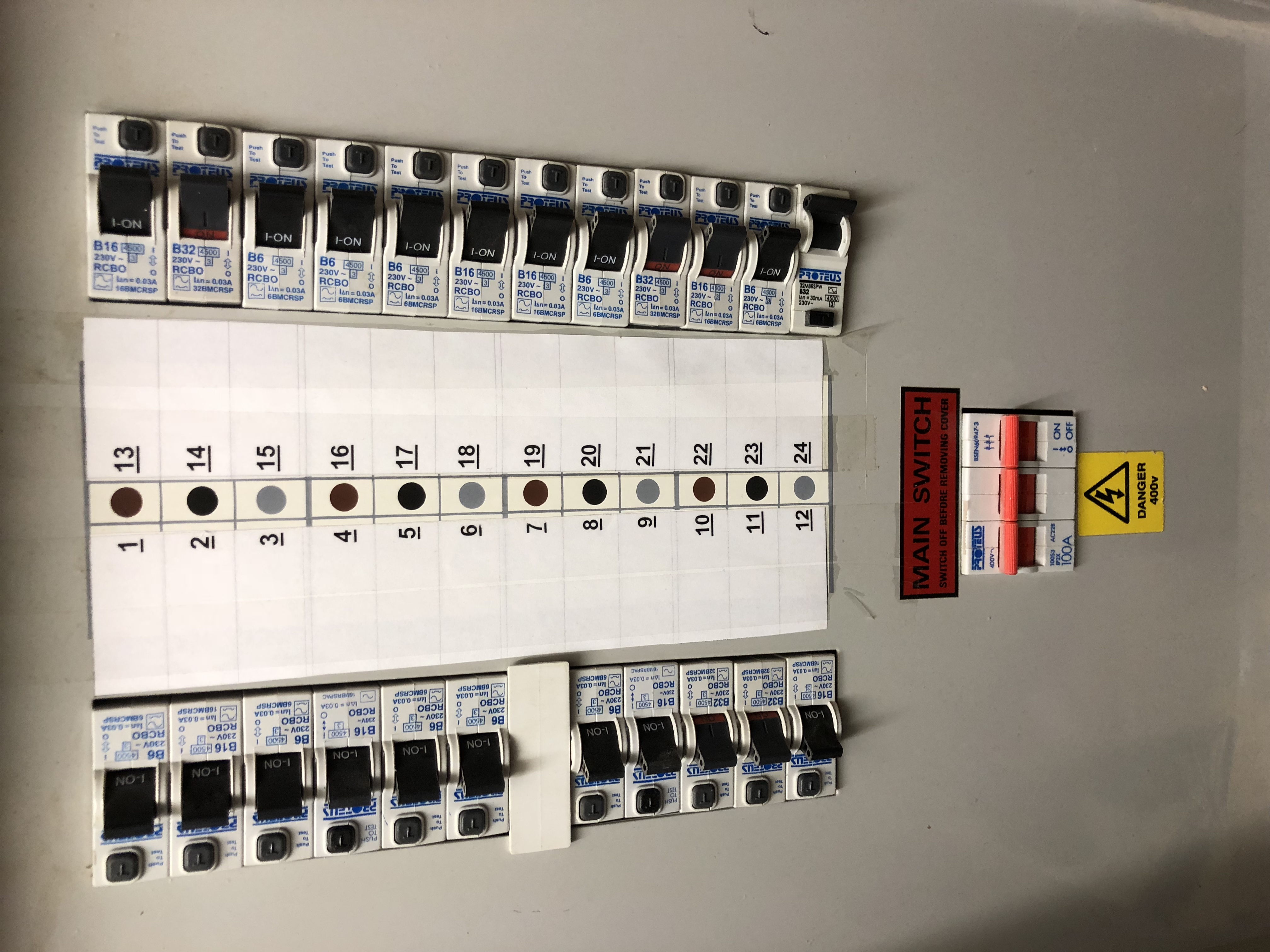

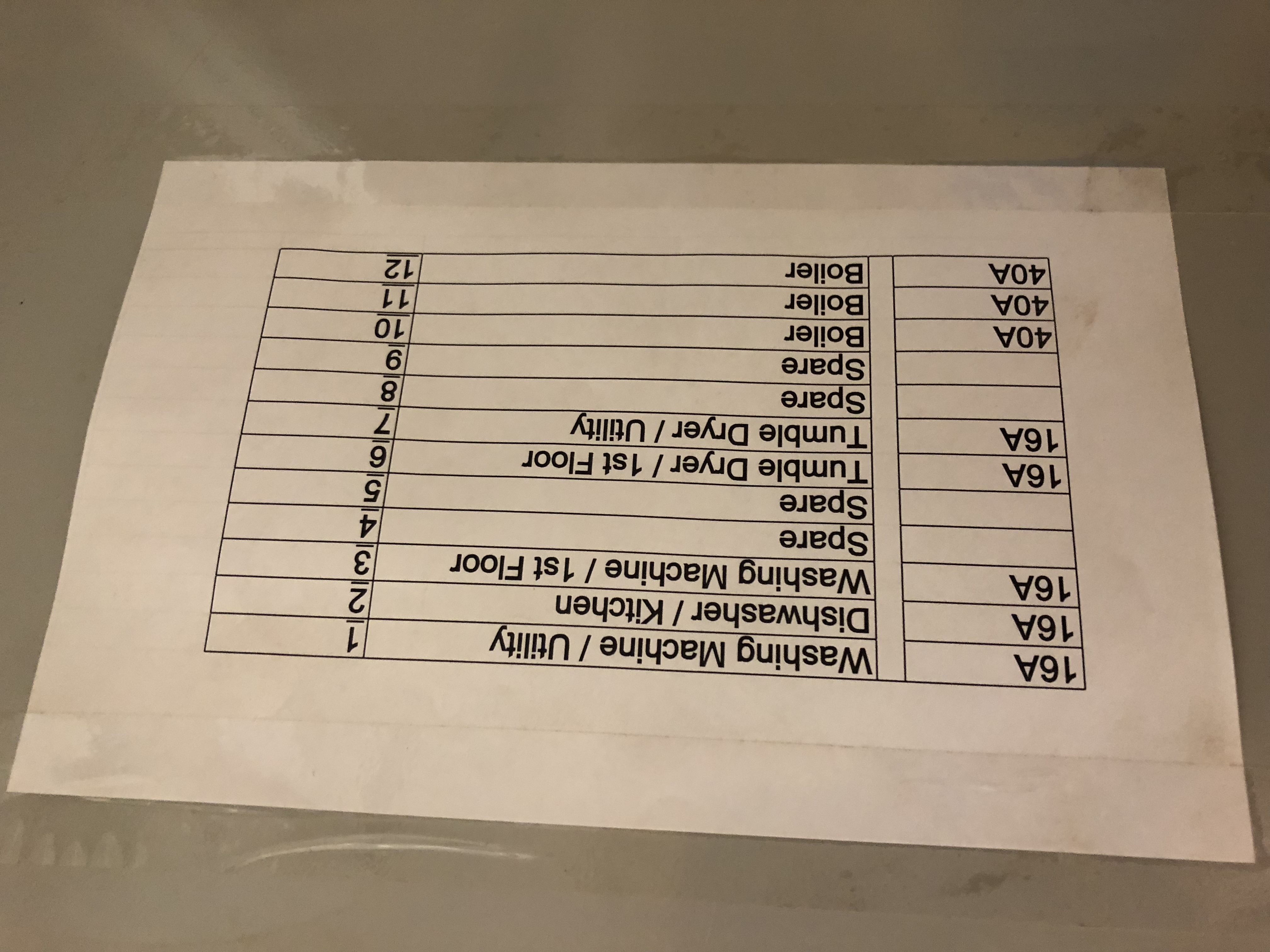

newhome Posted February 21, 2018 Author Posted February 21, 2018 Catching up on a few bits from earlier before I go try out @Nickfromwales instructions. Consumer unit photos

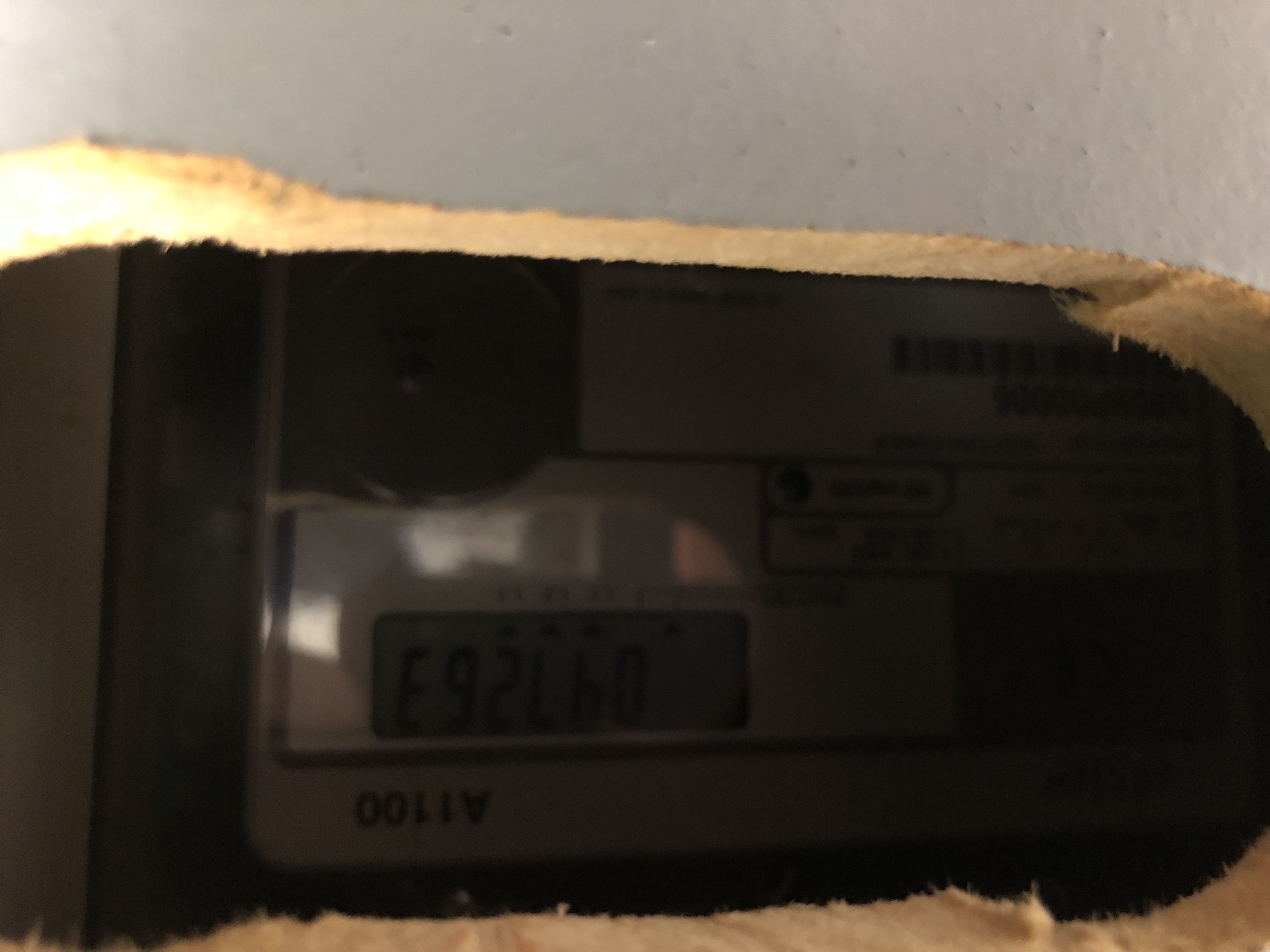

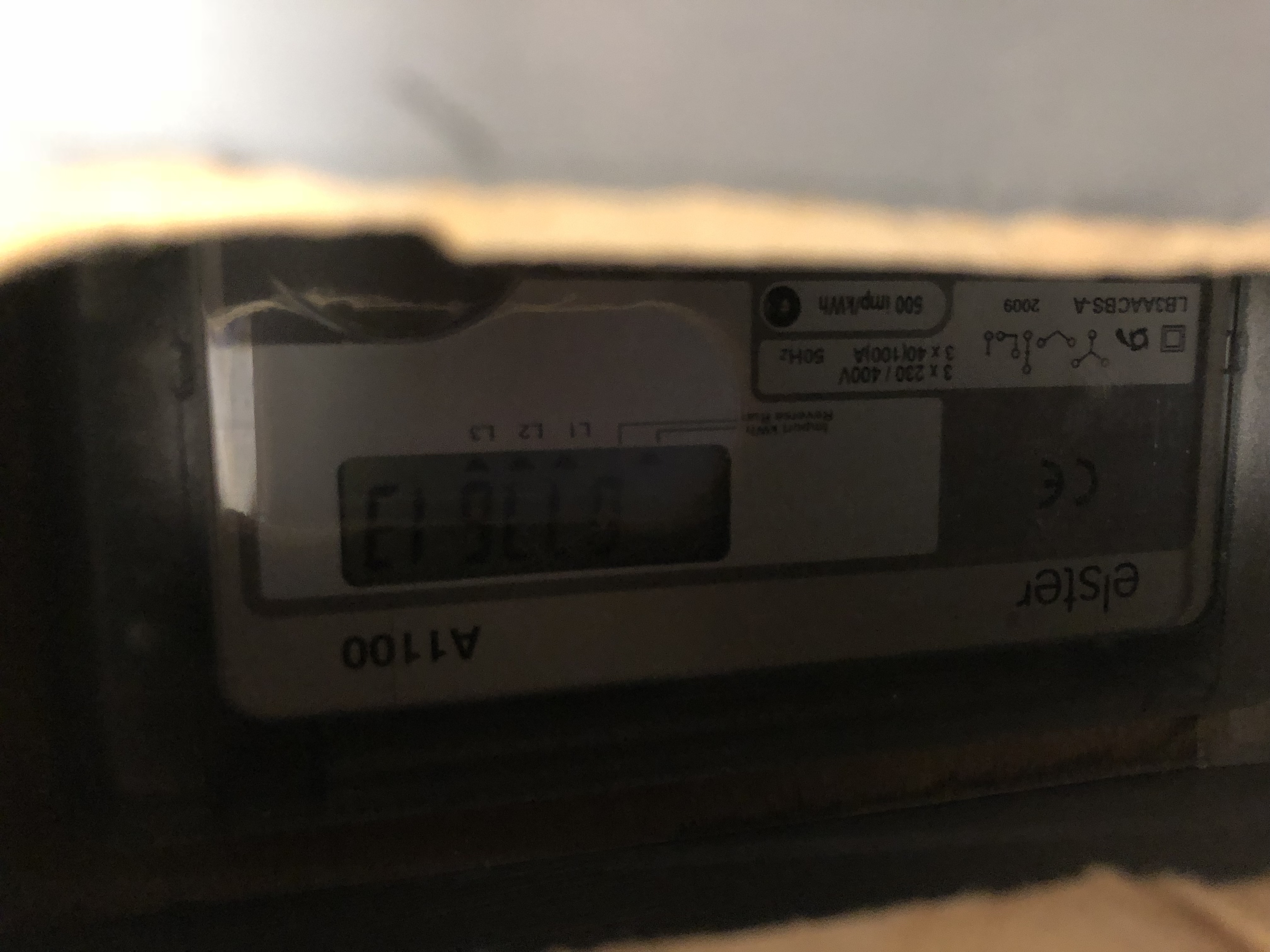

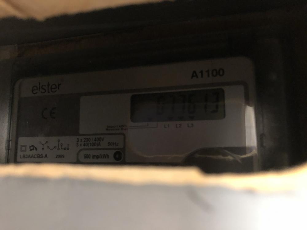

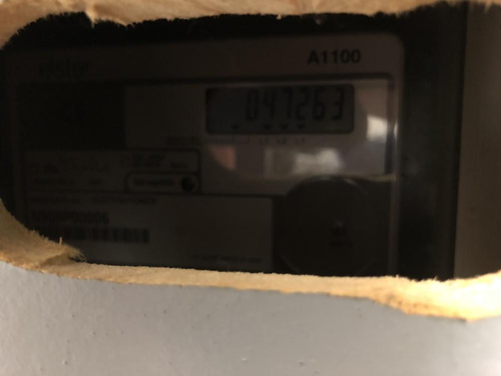

newhome Posted February 21, 2018 Author Posted February 21, 2018 And some photos of the bits of the meters I can see. They are boxed in apart from the bit where you can read the meters but essentially they are side by side. I can unscrew the covers (I think!) if it’s helpful?
Nickfromwales Posted February 21, 2018 Posted February 21, 2018 Crikey. Is it a nursing home or a small school ? The wiring is as over-engineered as the plumbing.....I think I feel a theme here. At least the wiring needs no work doing from a glance, as its about as good and diverse as a system could get. A microwave oven with its own circuit! and then the cooker hood has its own circuit too. God bless your late husband, he was an engineer through and through. A man after many of our hearts. I'll leave pro Dave comment on the electrics as my brains still in rehab learning about your plumbing but I don't envy his task either! 1

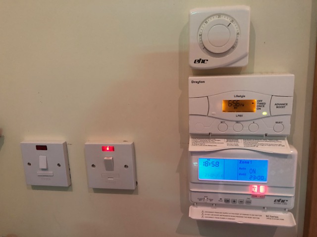

newhome Posted February 21, 2018 Author Posted February 21, 2018 And the local man put 2 switches on the wall next to the controllers. The one that is switched off is the immersion and the one that is on is the boiler.

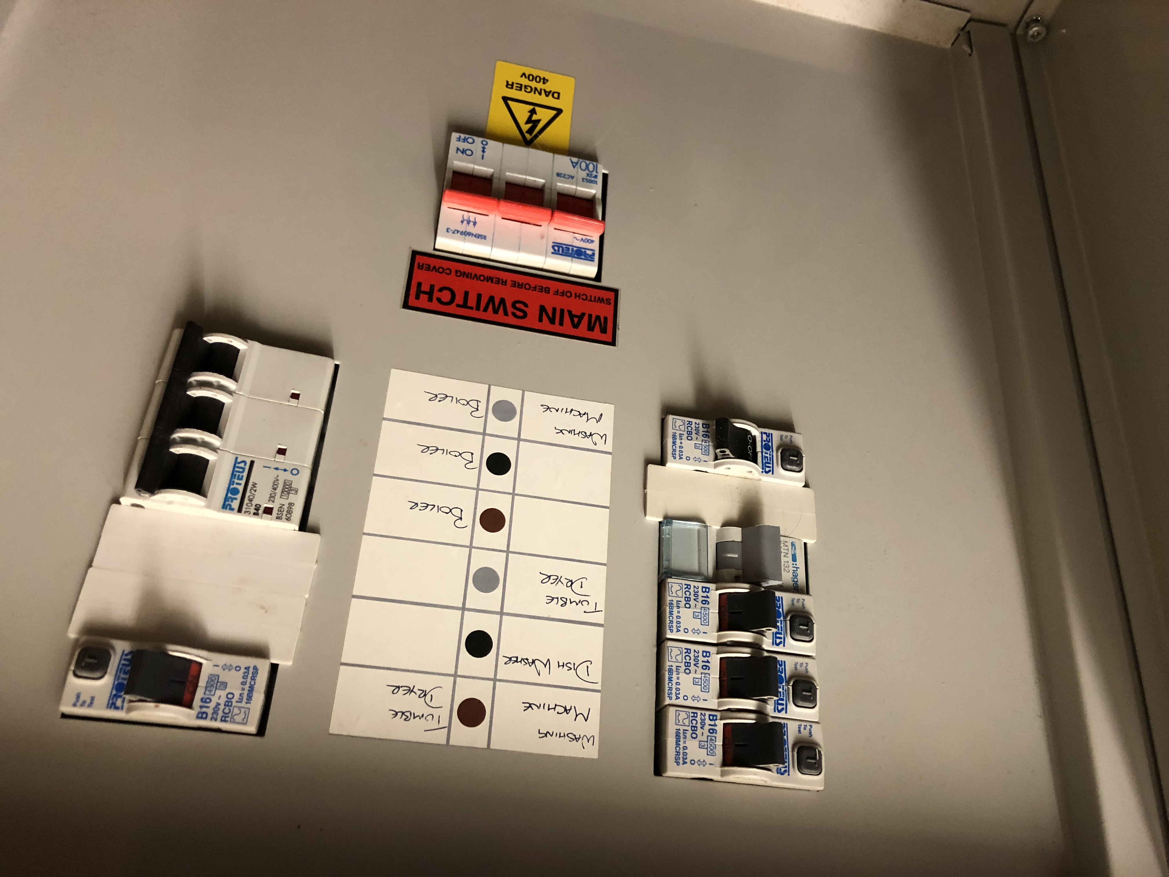

Nickfromwales Posted February 21, 2018 Posted February 21, 2018 Hmmm. The shot of the first CU shows a stray MCB ( trip switch ) thats not on the legend. The whole house is all RCBO, which is the best you can get with no exception, so a bit odd to see one thats been added thats just a regular trip.
Nickfromwales Posted February 21, 2018 Posted February 21, 2018 3 minutes ago, newhome said: And the local man put 2 switches on the wall next to the controllers. The one that is switched off is the immersion and the one that is on is the boiler. Did he fit the Drayton time clock and why? I think the EHC one is part of the original setup and the two zones / channels on that may be the summer / winter controls I spoke of in 'war and peace'. The other theory is the Drayton does DHW.
newhome Posted February 21, 2018 Author Posted February 21, 2018 2 minutes ago, Nickfromwales said: Did he fit the Drayton time clock and why? I think the EHC one is part of the original setup and the two zones / channels on that may be the summer / winter controls I spoke of in 'war and peace'. The other theory is the Drayton does DHW. He fitted all of the bits in the photo. None of that was there before. The Drayton time clock controls the underfloor heating pump.

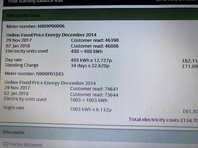

newhome Posted February 21, 2018 Author Posted February 21, 2018 20 hours ago, newhome said: @Nickfromwales the top invoice here explains what the Drayton does but essentially it turns the UFH pump off and on via time switch.
Nickfromwales Posted February 21, 2018 Posted February 21, 2018 ok some clarity for my melted head. Did local guy come out AFTER the system was fully installed, or is he the original installer.
Nickfromwales Posted February 21, 2018 Posted February 21, 2018 1 minute ago, newhome said: @Nickfromwales the top invoice here explains what the Drayton does but essentially it turns the UFH pump off and on via time switch. Yup, the second bill confirms he should have got back in his van and left the better man. Nearly £700 for him to chop some unnecessary equipment in and make it worse imho. He may have looked like a knight in shining armour at the time but 'cock' still seems fit from where im sitting. 1
newhome Posted February 21, 2018 Author Posted February 21, 2018 1 minute ago, Nickfromwales said: ok some clarity for my melted head. Did local guy come out AFTER the system was fully installed, or is he the original installer. He came out about a year ago eons after it was all installed and after my hubby had died as I wanted to try to get the hot water working without the UFH pump being switched on. He installed the 5 new bits as pictured. Definitely definitely none of that was in the original spec.
ProDave Posted February 21, 2018 Posted February 21, 2018 Can you remove some f the boxing in. I want to see both the meters in full and any time clocks and the wiring associated with them. I see the 3 phase consumer units That all looks okay . I am trying to establish how the metering system for this tariff works so I need the best picture you can of the meters and their wiring. At the moment about 1/3 of your usage is at the peak rate., that tends to confirm some of your heating load is on at the peak rate time and being charged thus.

Nickfromwales Posted February 21, 2018 Posted February 21, 2018 10 minutes ago, newhome said: He came out about a year ago eons after it was all installed and after my hubby had died as I wanted to try to get the hot water working without the UFH pump being switched on. He installed the 5 new bits as pictured. Definitely definitely none of that was in the original spec. I think this statement nails it. I doubt he, or perhaps you, knew that the system ( what you already had fitted ) just needed to be configured properly, and had the means there to do what you wanted by programming. The touchscreen heat miser system clearly is plenty comprehensive enough to do the job, just its the dangerous grey area where plumbing and complex wiring reside........and very few plumbers have the slightest clue about multi-discipline wiring and controls. I make a good few quid off my Gas registered plumbing mates who cant do any complex wiring, particularly old to new conversions. Can you recall which controls were in place before 'his' arrival ?
ProDave Posted February 21, 2018 Posted February 21, 2018 40 minutes ago, Nickfromwales said: Hmmm. The shot of the first CU shows a stray MCB ( trip switch ) thats not on the legend. The whole house is all RCBO, which is the best you can get with no exception, so a bit odd to see one thats been added thats just a regular trip. And the wrong make for the board.
Nickfromwales Posted February 21, 2018 Posted February 21, 2018 3 minutes ago, ProDave said: And the wrong make for the board. Yup. Who's been fiddling with that ?
ProDave Posted February 21, 2018 Posted February 21, 2018 5 minutes ago, Nickfromwales said: Yup. Who's been fiddling with that ? Someone didn't want to darken the doors Of CEF to get the correct Proteus one.
Nickfromwales Posted February 21, 2018 Posted February 21, 2018 2 minutes ago, ProDave said: Someone didn't want to darken the doors Of CEF to get the correct Proteus one. Yup More worrying its not giving any earth protection to whatever it services.
newhome Posted February 21, 2018 Author Posted February 21, 2018 8 minutes ago, ProDave said: And the wrong make for the board. The remedial work after the electrical test was carried out wasn't done by my hubby as he was too sick by then. We had a firm out to do it. Not sure if that's one of the things they put in. There were a few things to address. Dunno. I have no chance of getting that cover off, at least not tonight. The screws are tight as ar4eholes and I can't find a screwdriver to fit, and anyway it looks like they've been sunk with a drill and I don't really do drills and things .
