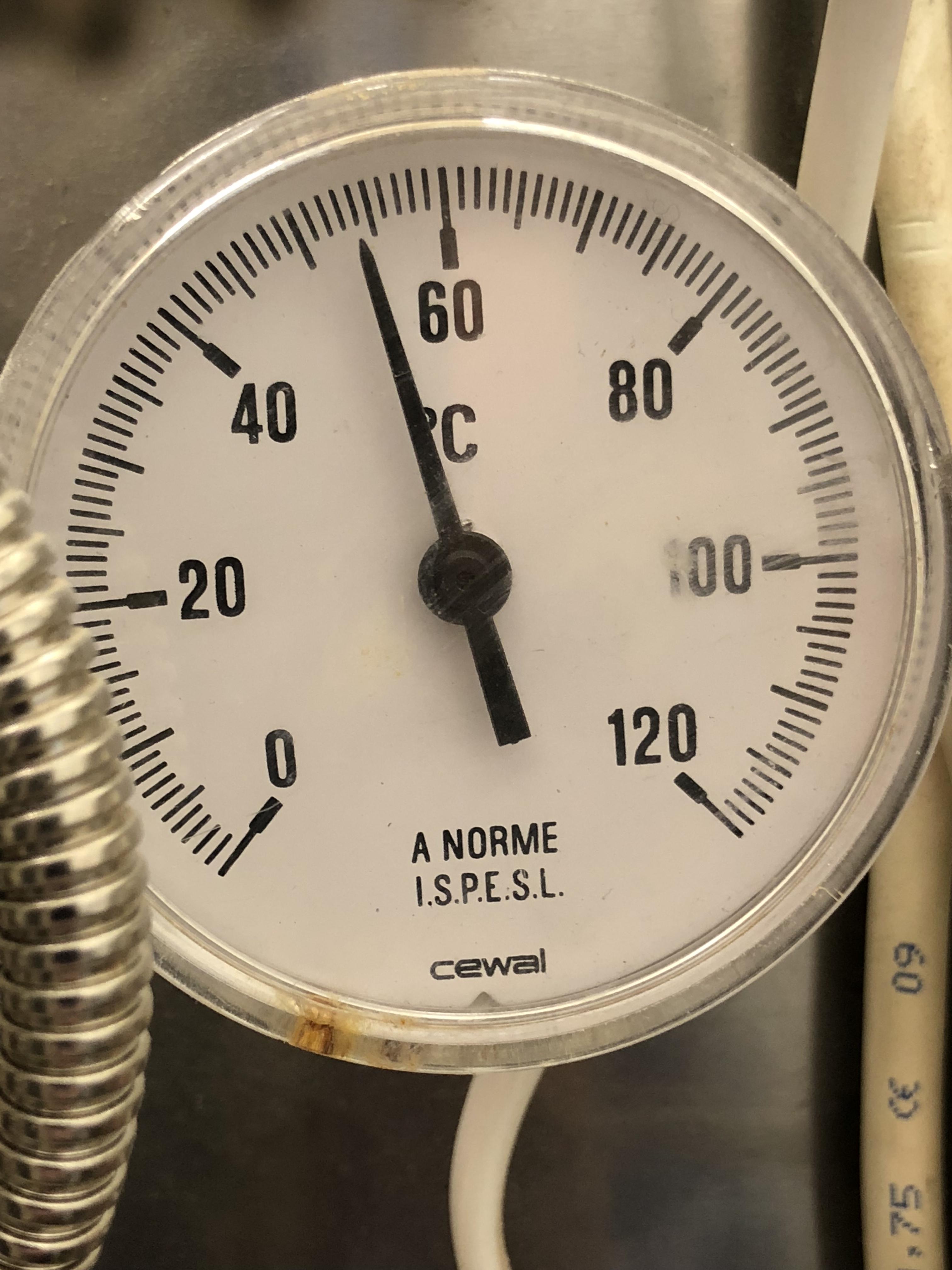

newhome Posted February 23, 2018 Author Posted February 23, 2018 11 minutes ago, MikeSharp01 said: PS was the TS temperature rising, even very slowly above the 45 / 50 or was it dead stable? Dead stable. Boiler at 65 - TS dead stable at 45, boiler at 70 - TS dead stable at 50, and boiler at 75 - TS dead stable at 54. I left the boiler on all day today to check and it's been at 54 the whole day.

MikeSharp01 Posted February 23, 2018 Posted February 23, 2018 Hmmmm... That sounds Odd - loosing 20Deg across the circuit feels very high and is incredibly wasteful. Might need to insulate the pipe work from boiler to Heat exchanger and heat exchanger to TS as well as the heat exchanger. (Unless somewhere there is some system in control of the TS based on the Boiler water temperature which feels like a remote possibility.)

PeterW Posted February 23, 2018 Posted February 23, 2018 17 minutes ago, newhome said: Dead stable. Boiler at 65 - TS dead stable at 45, boiler at 70 - TS dead stable at 50, and boiler at 75 - TS dead stable at 54. I left the boiler on all day today to check and it's been at 54 the whole day. Hmmm ... faulty boiler thermocouple would do that... would explain why the TS never gets to temperature.

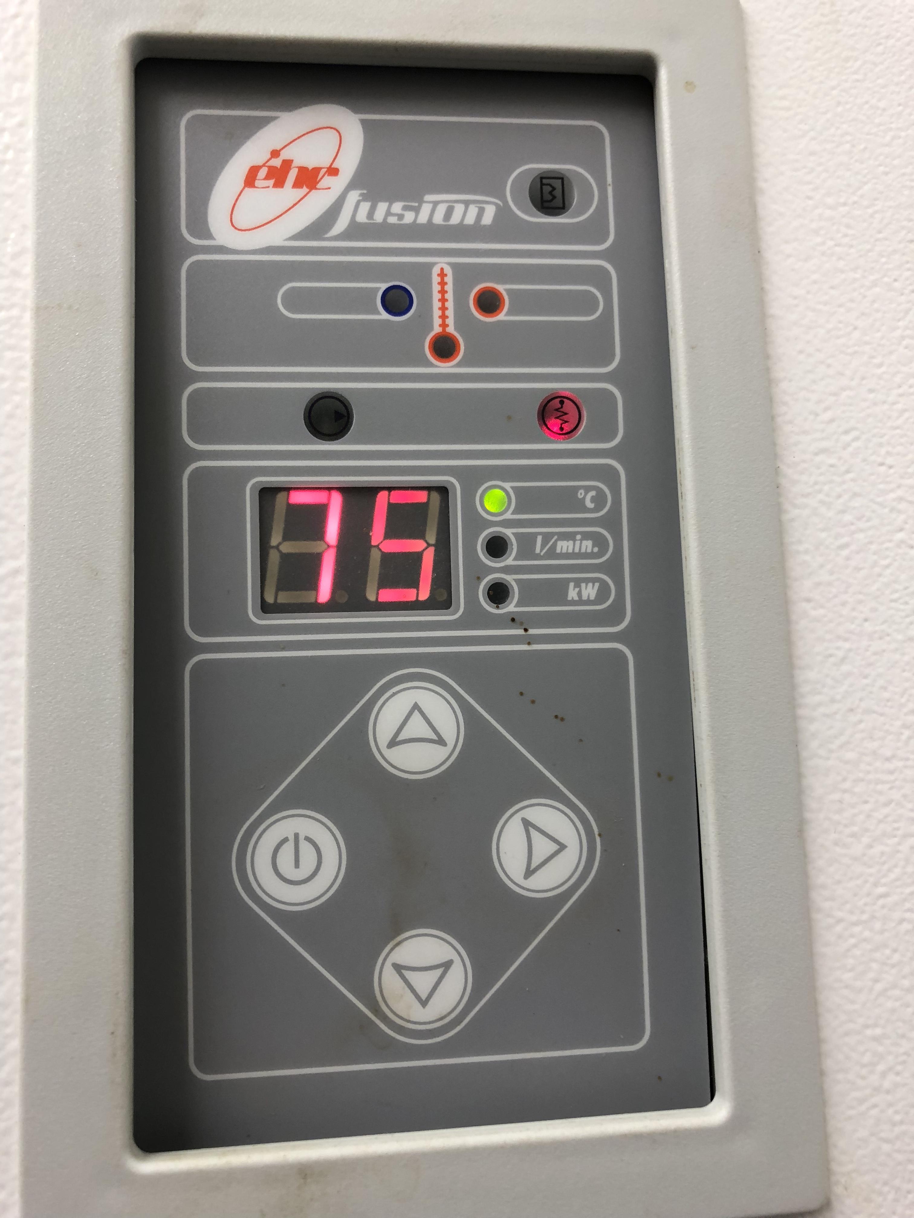

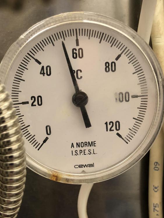

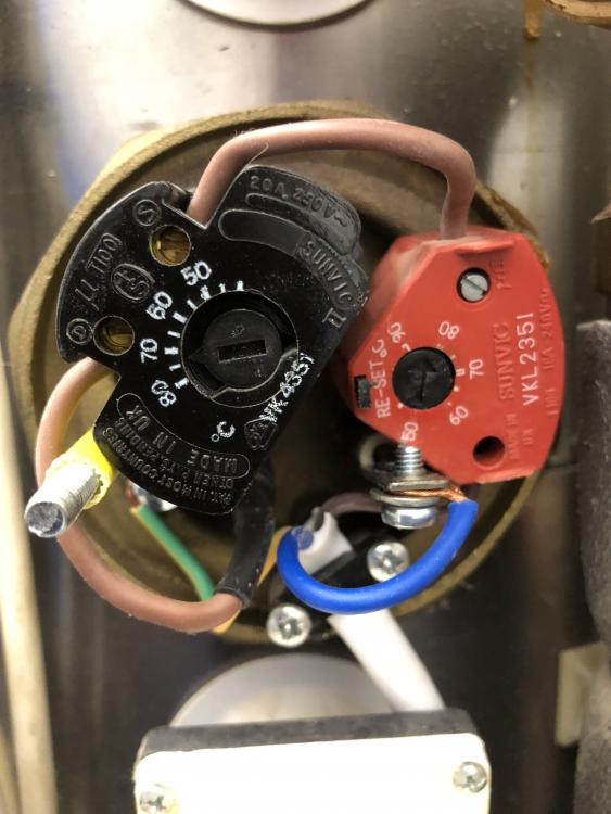

newhome Posted February 23, 2018 Author Posted February 23, 2018 @MikeSharp01 Here you go . Taken just now. And the 3rd photo is for @SteamyTea . Bet you put milk in yours!

MikeSharp01 Posted February 23, 2018 Posted February 23, 2018 1 minute ago, newhome said: @MikeSharp01 Here you go . Taken just now. The difference is bonkers and means the losses are massive. Lets wait and see what the temperatures are at the various points when you can measure them.

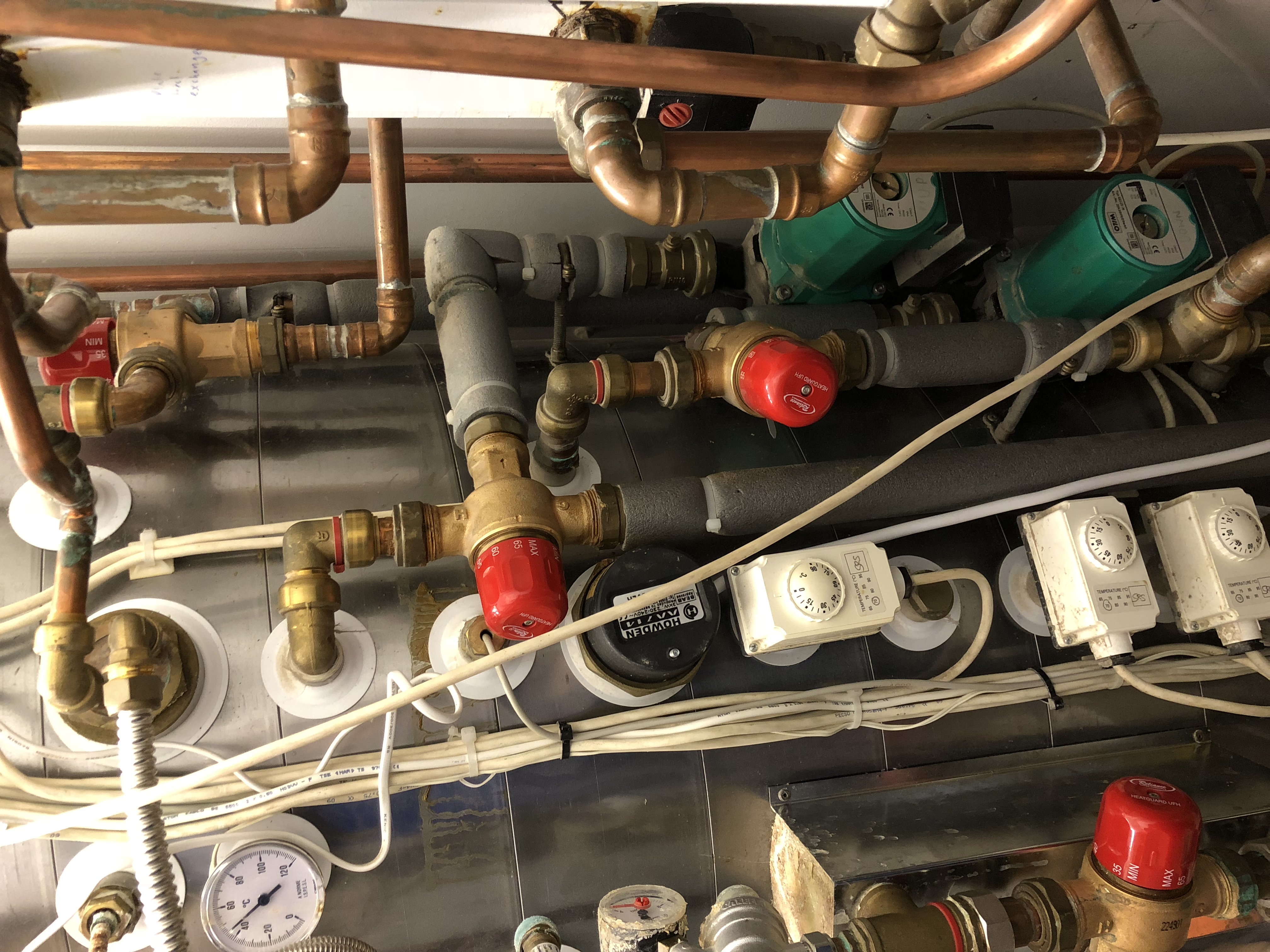

PeterW Posted February 23, 2018 Posted February 23, 2018 On 21/02/2018 at 01:06, Nickfromwales said: Getting closer... @Nickfromwales I think it’s piped wrong.... The schematic you posted shows multiple heat sources to a single heat bank. The top source on the picture is of a gas boiler, not an electric boiler on this storage tariff. It would explain why the boiler shuts down so quick too. If it is putting the full 24Kw into the top 25% of the tank, then as soon as it gets down to the top stat it’s cutting out - 75% of the tank is still cold or cool. The electric boiler needs to be piped as per the pellet boiler as then it will heat the whole tank and hence act as a buffer for the time that the E2000 is not available. I can’t see where the solar circuit is attached but I bet it’s near the top too - there is no way you can thermosyphon that much heat into a tank that size as it will stratify.

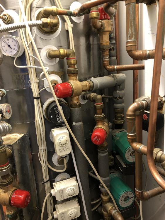

PeterW Posted February 23, 2018 Posted February 23, 2018 12 minutes ago, newhome said: @MikeSharp01 Here you go . Taken just now. And the 3rd photo is for @SteamyTea . Bet you put milk in yours! Whereabouts is that on the tank for reference please ..?

MikeSharp01 Posted February 23, 2018 Posted February 23, 2018 3 minutes ago, PeterW said: The schematic you posted shows multiple heat sources to a single heat bank. The top source on the picture is of a gas boiler, not an electric boiler on this storage tariff. It would explain why the boiler shuts down so quick too. If it is putting the full 24Kw into the top 25% of the tank, then as soon as it gets down to the top stat it’s cutting out - 75% of the tank is still cold or cool. The electric boiler needs to be piped as per the pellet boiler as then it will heat the whole tank and hence act as a buffer for the time that the E2000 is not available. That makes sense - in schematic the pellet boiler is the prime mover, with the heat pump doing a low grade heat input at the bottom of the TS and coping with the UFH if it can.

newhome Posted February 23, 2018 Author Posted February 23, 2018 1 minute ago, PeterW said: Whereabouts is that on the tank for reference please ..? Top left.

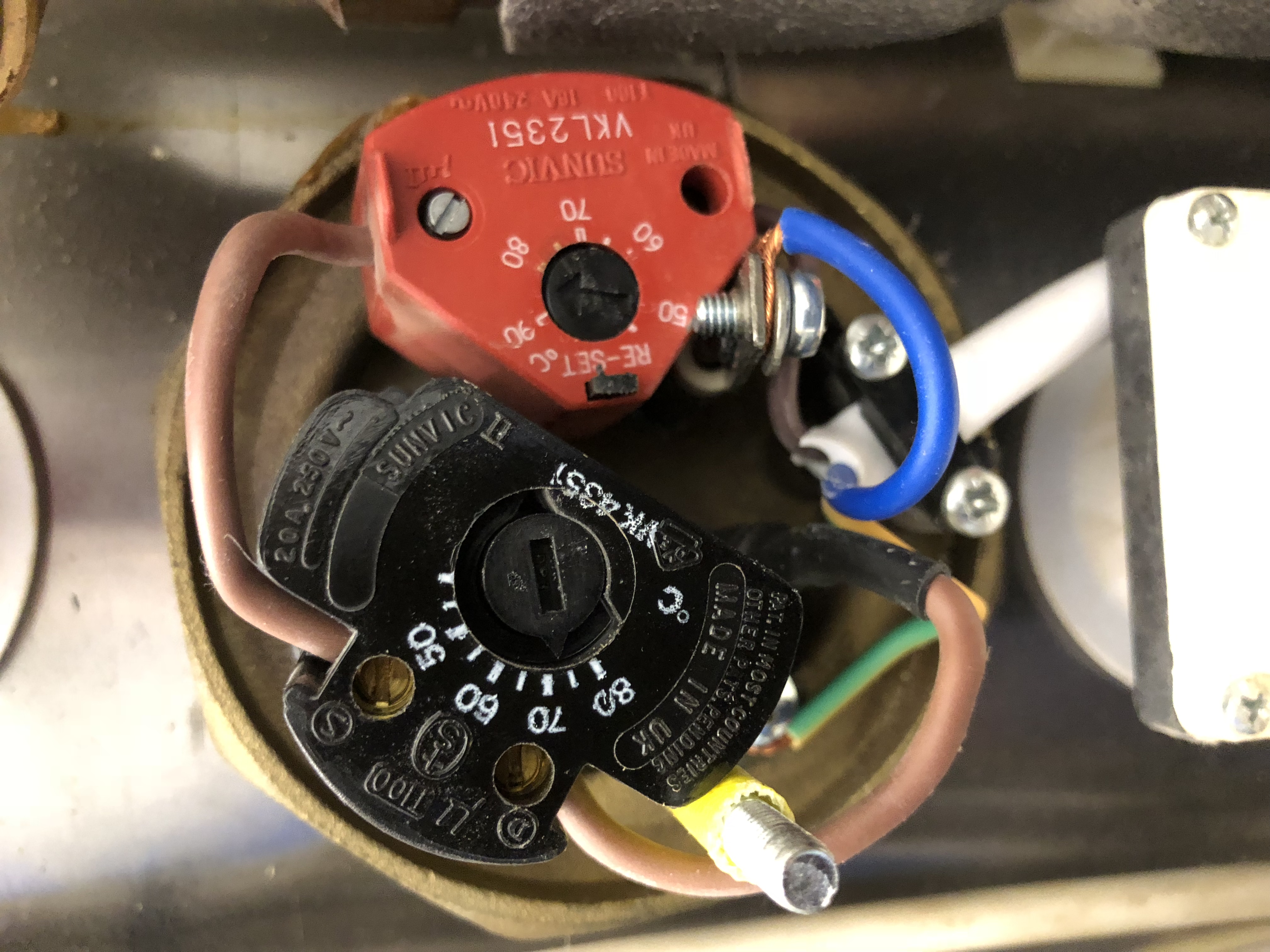

MikeSharp01 Posted February 23, 2018 Posted February 23, 2018 There is at least one immersion heater there, what is that doing I wonder, is that the prod the system needs to syphon I wonder.
newhome Posted February 23, 2018 Author Posted February 23, 2018 6 minutes ago, MikeSharp01 said: There is at least one immersion heater there, what is that doing I wonder, is that the prod the system needs to syphon I wonder. It’s just a back up if the boiler is fecked. It’s switched off. I have used it in the past. It takes about 3 hours to heat up hot enough water to shower.
SteamyTea Posted February 23, 2018 Posted February 23, 2018 (edited) 6 minutes ago, newhome said: It takes about 3 hours to heat up hot enough water to shower. If it is a 3 kW element and it runs for 3 hours, that is 9 kWh. You must take very long showers, or the heat (the old word for energy) is going somewhere else. Re the above picture. Isn't it limited to 65°C now, what the reset is for? Edited February 23, 2018 by SteamyTea
PeterW Posted February 23, 2018 Posted February 23, 2018 Oooh as you have the screwdrivers out.. any chance of taking the cover off one of the UH1 UFH units and posting a couple of pics of the inside ..?
MikeSharp01 Posted February 23, 2018 Posted February 23, 2018 (edited) Yes but if the immersion is powered from one of the cheap rate power lines it will be much more cost effective than the boiler in cheap rate times and it may, may, also help the water being heated in the top of the tank by the boiler heat the whole tank because it will set up a convection current in the tank. The immersion heater is all bar the shouting 100% efficient in that all the heat goes into the water, none is wasted - until it gets to the outside of the tank and leaches away into the air. Edited February 23, 2018 by MikeSharp01
