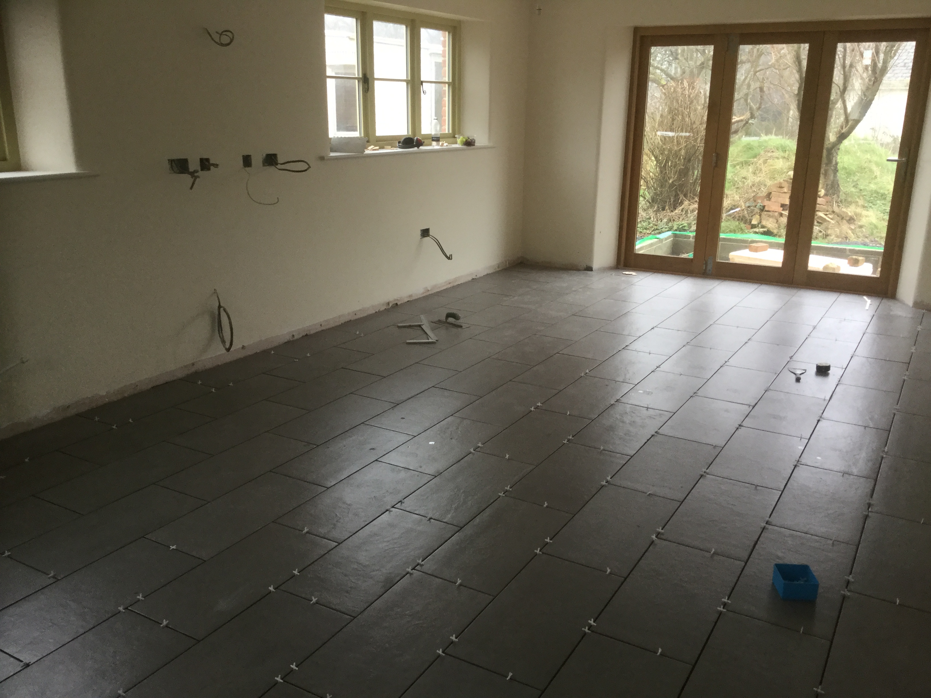

joe90 Posted February 18, 2018 Author Posted February 18, 2018 (edited) Well, apart from a few tiles in an awkward corner I have just completed 40 sq metres over the weekend and feeling quite pleased with myself, although I ache a little I think the knee pads did a Stirling job. ( let’s see if I can get out of bed in the morning ?). only 24 meters of stone and 32 mtrs of wood to go? Edited February 18, 2018 by joe90 2
Barney12 Posted February 18, 2018 Posted February 18, 2018 1 hour ago, joe90 said: Well, apart from a few tiles in an awkward corner I have just completed 40 sq metres over the weekend and feeling quite pleased with myself, although I ache a little I think the knee pads did a Stirling job. ( let’s see if I can get out of bed in the morning ?). only 24 meters of stone and 32 mtrs of wood to go? Darn impresive it looks to!
Nickfromwales Posted February 18, 2018 Posted February 18, 2018 Nice tile. Do NOT put a grey grout in....PLEASE! @joe90 A top tip for grouting, after sponging to get the first wipe out of the way, switch to a cheap mop to remove the remainder. A caretakers mop, rather than a fibre mop, is the best as it doesn't drop into the grout lines. Cleans this stuff up ( especially the charcoal / black ) in minutes, whereas with a sponge and bucket you'll be there for hours. 2 1
PeterW Posted February 18, 2018 Posted February 18, 2018 1 hour ago, Nickfromwales said: Nice tile. Do NOT put a grey grout in....PLEASE! @joe90 A top tip for grouting, after sponging to get the first wipe out of the way, switch to a cheap mop to remove the remainder. A caretakers mop, rather than a fibre mop, is the best as it doesn't drop into the grout lines. Cleans this stuff up ( especially the charcoal / black ) in minutes, whereas with a sponge and bucket you'll be there for hours. @Nickfromwales does that work on slate too..??
Nickfromwales Posted February 18, 2018 Posted February 18, 2018 32 minutes ago, PeterW said: @Nickfromwales does that work on slate too..?? Yup, but Chinese slate needs a scrubbing brush for the grain on the last pass, then a final mop. Seal the slate first of course 1
ProDave Posted February 18, 2018 Posted February 18, 2018 They look like the tiles I have been laying in my bathroom. Just the grouting to do. I HATE grouting, that is SWMBO's job.
Nickfromwales Posted February 18, 2018 Posted February 18, 2018 9 minutes ago, ProDave said: They look like the tiles I have been laying in my bathroom. Just the grouting to do. I HATE grouting, that is SWMBO's job. Use the mop. you'll never go back
CC45 Posted February 18, 2018 Posted February 18, 2018 What tiles are they @joe90? Nice looking job there.
joe90 Posted February 19, 2018 Author Posted February 19, 2018 Thanks for the comments guys, yes I am pleased with it. Tiles came from B@Q, Italian porcelain £12 per meter and swmbo likes them. Yes Nick going with charcoal grout and thanks for the heads up re the mop.
joe90 Posted February 20, 2018 Author Posted February 20, 2018 Nick, just ordered this from Ebay, https://www.ebay.co.uk/itm/Bentley-Mop-Handle-and-Bucket-Set-Cotton-Mop-Head-Cleaning-Floor-Metal-Bucket/222562257806?ssPageName=STRK%3AMEBIDX%3AIT&_trksid=p2057872.m2749.l2649 thanks for the heads up
Nickfromwales Posted February 20, 2018 Posted February 20, 2018 15 minutes ago, joe90 said: Nick, just ordered this from Ebay, https://www.ebay.co.uk/itm/Bentley-Mop-Handle-and-Bucket-Set-Cotton-Mop-Head-Cleaning-Floor-Metal-Bucket/222562257806?ssPageName=STRK%3AMEBIDX%3AIT&_trksid=p2057872.m2749.l2649 thanks for the heads up With great mop comes great responsibility. Trust me, when you see how quickly that works compared to even a Wash-boy bucket and sponge its 1000x better. Just mop slowly so you don't flick up the walls. Latex gloves for grouting will help, but if theres two of you who can grout side by side just to get it down then even better. I take it you know to switch the ufh off the day before ?
joe90 Posted February 20, 2018 Author Posted February 20, 2018 Thanks Nick, UFH not yet commissioned so not a problem, only me, myself and I on the job ! I am sure I am not the only one pleased with these pearls of wisdom.
Nickfromwales Posted February 20, 2018 Posted February 20, 2018 Oh, and mop at 45 degrees to the grout lines, not along them With porcelain the grout will stay wet for a long time, so it'll push down if you mop along them.
