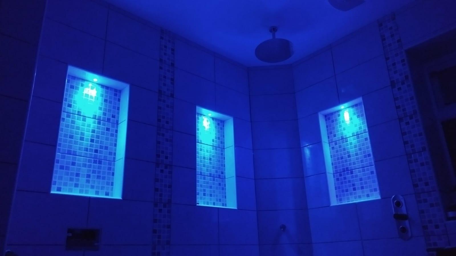

Pocster Posted January 12, 2019 Posted January 12, 2019 (edited) 16 hours ago, Onoff said: Lying in the bath with a beer listening to Deadmau5's Strobe just letting it build! OK I'm fully clothed and I daren't pan down for all the crap but it's going to be pucker when done. Couldn't resist getting the lights in. Comment from a mate: "It’s not like a blacklight and shows all the stains does it? ?" Did you choose rgb led strips ? So you can change the colour ...? ala mode lighting ! Edited January 12, 2019 by pocster
Onoff Posted January 12, 2019 Author Posted January 12, 2019 1 hour ago, pocster said: Did you choose rgb led strips ? So you can change the colour ...? ala mode lighting ! The 3 blue ones are LAP brand IP68 deck lights that fit in a 22mm hole. £4.99 for 10, end of line with a £10 voucher! Hidden "strip" along the bath is LED colour changing strip with remote etc.
Nickfromwales Posted January 12, 2019 Posted January 12, 2019 Put a strip of white laminate up in the soffit, the stuff you can buy on masking tape sized rolls for making good on the ends of kitchen worktops etc. White, bond on, scrubbable / won’t degrade, and will reflect the light off the LED strip. Bingo. 1
Onoff Posted January 12, 2019 Author Posted January 12, 2019 6 hours ago, Nickfromwales said: Put a strip of white laminate up in the soffit, the stuff you can buy on masking tape sized rolls for making good on the ends of kitchen worktops etc. White, bond on, scrubbable / won’t degrade, and will reflect the light off the LED strip. Bingo. Good shout...going be a sod getting the iron up in there though... Gloss white or textured white do you reckon? Tbh I'm debating trunking lid...
