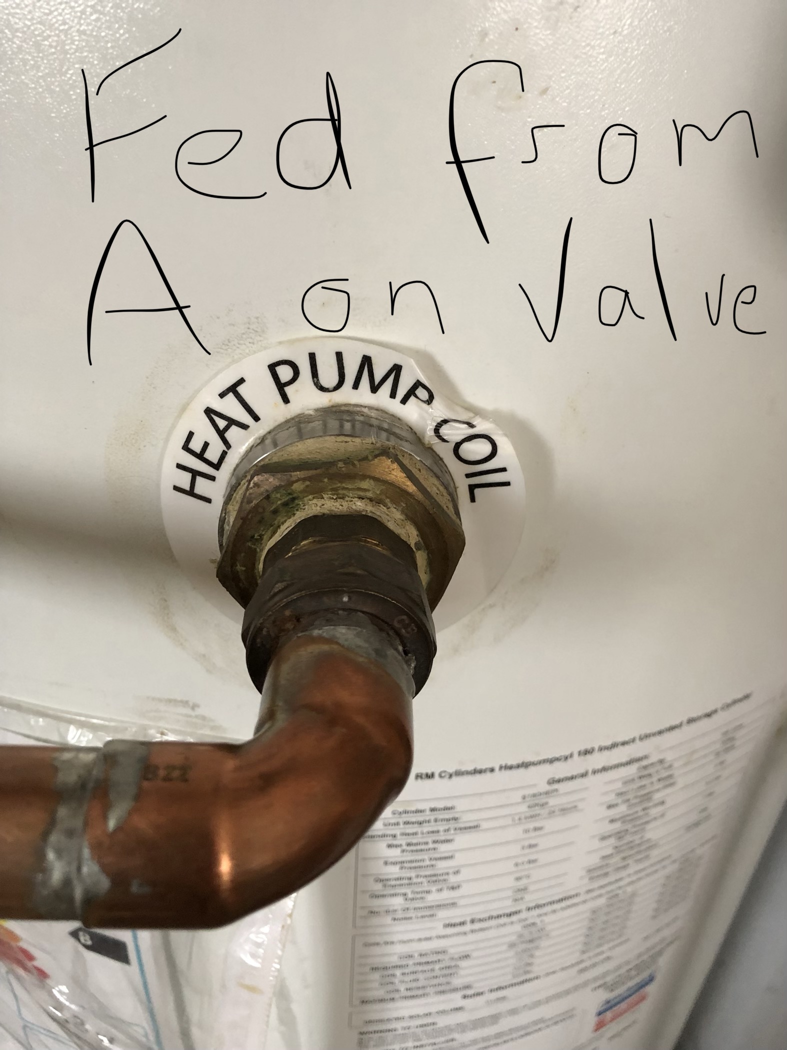

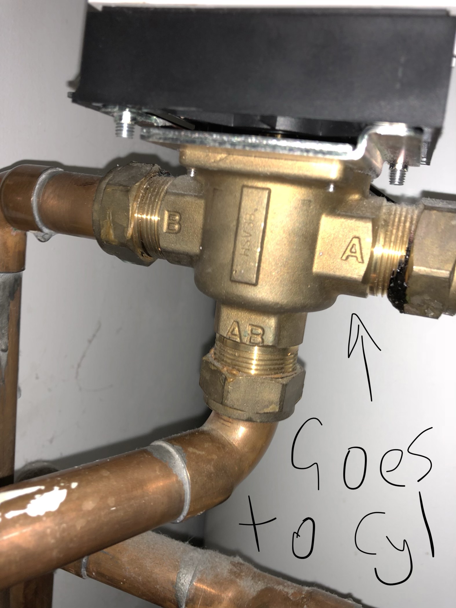

Lynford Posted April 1, 2018 Author Share Posted April 1, 2018 Morning all. Been off the case for a few weeks while the FIL had someone else look at it but had another go yesterday. It’s not getting anymore straightforward and has made me realise I should have started a lot more basic. First of all the HW timer was programmed all over the shop, on several days it was on for a total of 13hrs between 4am & 11pm. As this overrides the heating I thought I’d found the issue (plus the heating timer was set up all over the place as well) I still only seemed to get heat at the rads with the 3 port valve overridden using the lever. Apparently this valve was changed or repositioned when the HW cylinder was changed. It’s difficult to get in there to see but I got my phone in to get a picture.........I think the valve could have been fitted the wrong way round ? The system apparently was working before the HW cylinder was changed. I thought (think) that B on the valve should go to the HW cylinder ? Whereas it disappears into the floor so I think it goes to the rads. Meanwhile A from the valve goes into ‘Heat pump coil’ in the HW cylinder. Is this the wrong way round ? Just seems strange that if I manually move the valve over I get heat at the rads. If this is the case it’s partly my fault for not checking the very basics (programmer / valve orientation etc). Maybe too trusting that the ‘experts’ who have been around before have checked the right things or done their job properly. Thanks as as always for any help, always appreciated. Link to comment Share on other sites More sharing options...

Jeremy Harris Posted April 1, 2018 Share Posted April 1, 2018 Normally B goes to the coil in the cylinder, so it does look as if the valve may be the wrong way around. One of the experts like @Nickfromwales will be along shortly to confirm or deny this, I'm sure! Link to comment Share on other sites More sharing options...

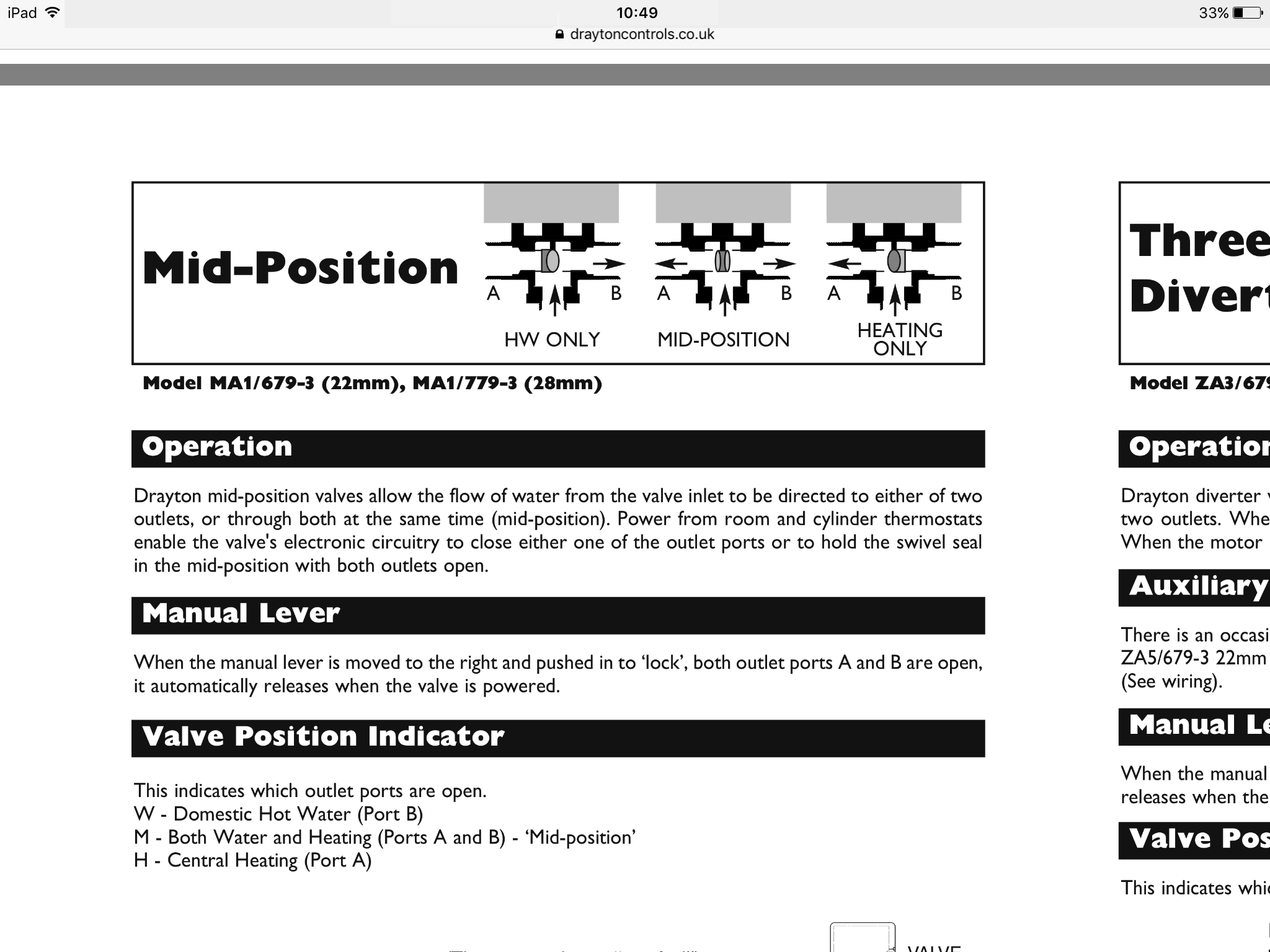

Nickfromwales Posted April 1, 2018 Share Posted April 1, 2018 B is typically DHW. As this should be a W-plan then DHW should be set to priority. The above is a mid-position for reference only, and the valve you ( should ) have should be the diverter version. Link to comment Share on other sites More sharing options...
Nickfromwales Posted April 1, 2018 Share Posted April 1, 2018 34 minutes ago, JSHarris said: Normally B goes to the coil in the cylinder, so it does look as if the valve may be the wrong way around. One of the experts like @Nickfromwales will be along shortly to confirm or deny this, I'm sure! Yup. Spin it around and it should be sorted. Link to comment Share on other sites More sharing options...
Lynford Posted April 1, 2018 Author Share Posted April 1, 2018 @JSHarris @Nickfromwales Gentlemen, thank you very much. Now to work out how to spin it around without filling the bungalow with water ! The feed to the valve has an isolator underneath the pump, I’m hoping I can knock that off and I won’t get too much of a soaking. Link to comment Share on other sites More sharing options...
Nickfromwales Posted April 1, 2018 Share Posted April 1, 2018 29 minutes ago, Lynford said: @JSHarris @Nickfromwales Gentlemen, thank you very much. Now to work out how to spin it around without filling the bungalow with water ! The feed to the valve has an isolator underneath the pump, I’m hoping I can knock that off and I won’t get too much of a soaking. Lol. Buy some wellies. You need to isolate the 3 pipes or your going to get very wet. Remember to isolate the electrical supply so you don't get electrocuted as well as drowned Link to comment Share on other sites More sharing options...

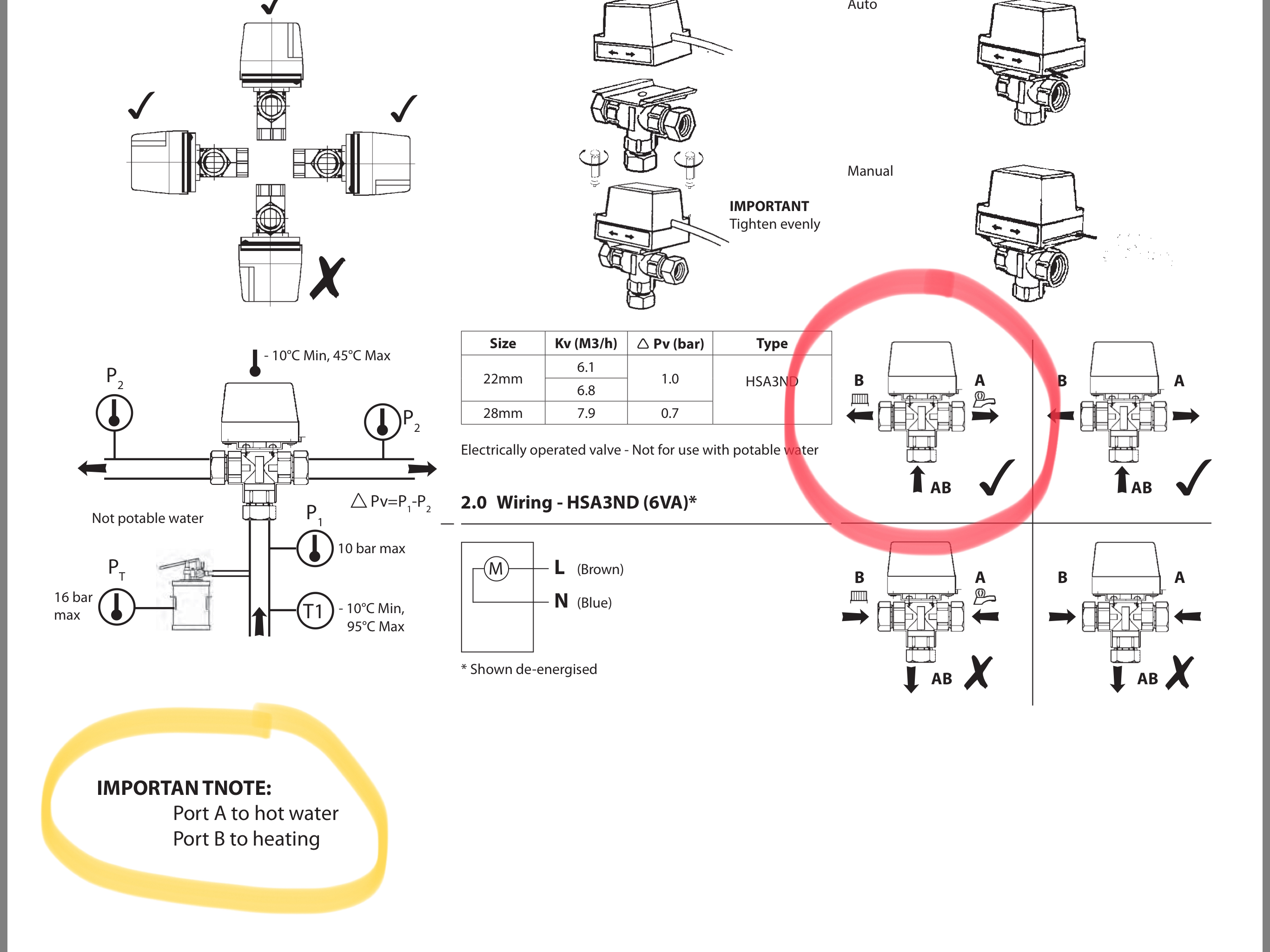

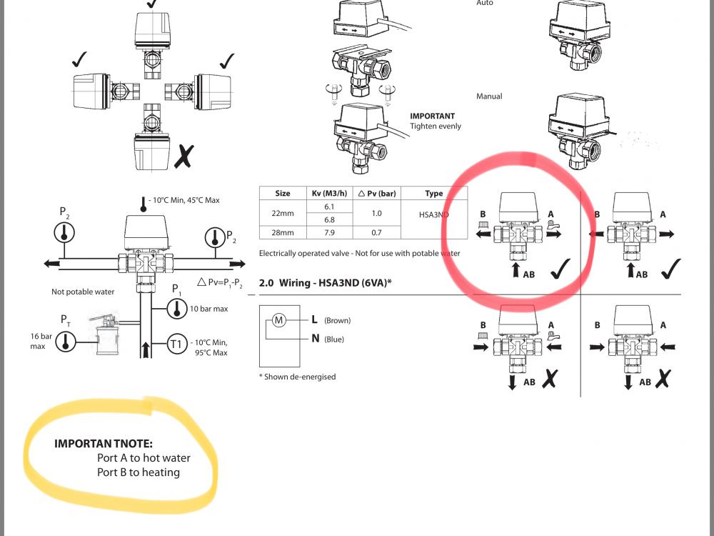

Lynford Posted April 3, 2018 Author Share Posted April 3, 2018 (edited) Hugely disappointing but glad I found this in the manual before we tried to switch the valve around ! Just confuses me more why we only get heat at the rads when the valve is manually moved over...... Edited April 3, 2018 by Lynford Link to comment Share on other sites More sharing options...
PeterW Posted April 3, 2018 Share Posted April 3, 2018 Is that the generic wiring diagram of the one that was with the heat pump ..?? Link to comment Share on other sites More sharing options...
Lynford Posted April 3, 2018 Author Share Posted April 3, 2018 That’s from the heat pump manual Peter, yes. Link to comment Share on other sites More sharing options...
Jeremy Harris Posted April 3, 2018 Share Posted April 3, 2018 So, is there a wiring problem that is switching the valve the wrong way, I wonder? The fact that manually moving the valve seems to suggest there may be. Link to comment Share on other sites More sharing options...
