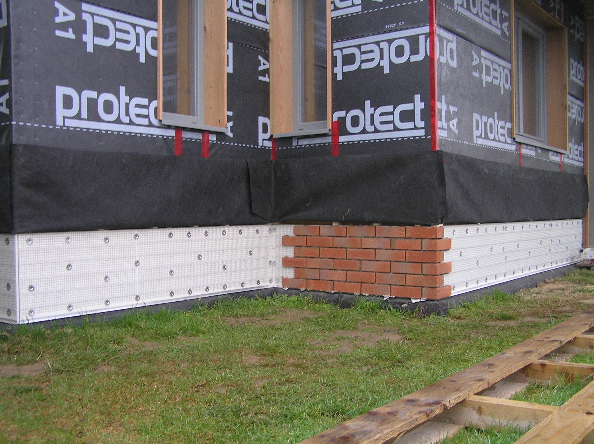

Ed_MK Posted February 6, 2018 Posted February 6, 2018 (edited) Well as we move into costing (while i wait for final Building regs to be done) I have discovered a strange enigma "Brick Slips" Our house design has copious brick slip cladding, but a REAL brick chimney planned. But ALL the bricklayers we have spoken to don't do them, never heard of them, suggest tilers, and all the tilers we have spoken to (some recommended) have never done them either ...but are prepared to "have a bash, for cash" ?! Now the company that sells these is http://www.brickslips.net/ I have contacted them for a list of their recommended installers in the SE ...tumble weed time! I guess they only want to sell and not get involved with recommending Does anyone have any experience of these, just to give you an example ...Brick slips or Brick Tiles as some call them: here is a video of them going on (although I am not sure this will be the applicable way on our Timber SIPS Potton build Edited February 6, 2018 by Ed_MK

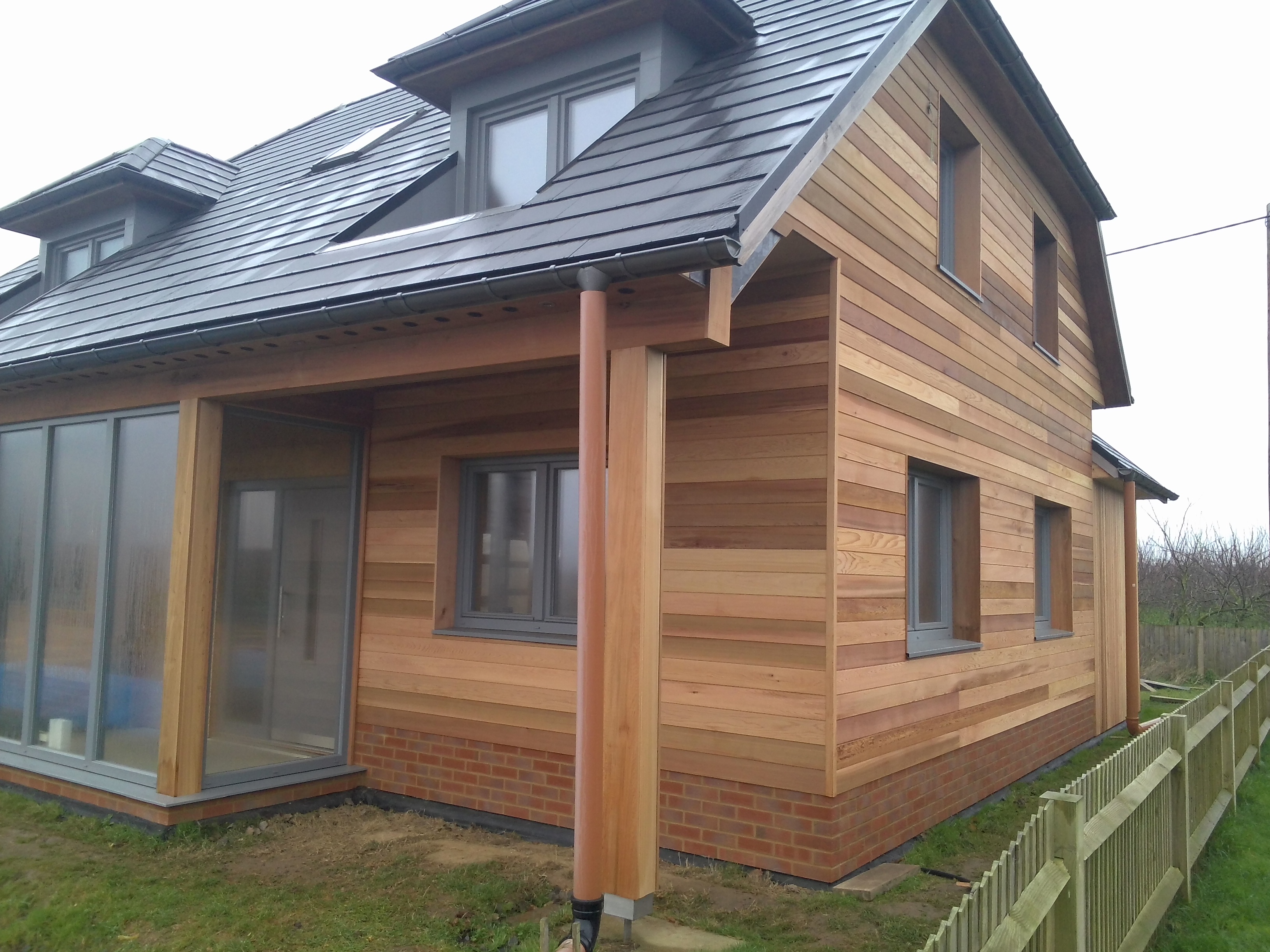

Gone West Posted February 6, 2018 Posted February 6, 2018 (edited) @Ed_MK We have a brick slip plinth on our build which is the same as in your video clip. The Wetherby system was really easy to install. I fitted the backing board and the wire mesh etc and a local 'builder' fitted the brick slips and pointed it. If I'd had the time I would have done the slips and pointing myself. Edited February 6, 2018 by PeterStarck

Moira Niedzwiecka Posted February 6, 2018 Posted February 6, 2018 Wow Peter, Your house looks very smart. What timber cladding have you used? Have you treated it with anything? What dry verge trim have you used on the roof? Sorry to ask so many questions. Moira

Gone West Posted February 6, 2018 Posted February 6, 2018 1 hour ago, Moira Niedzwiecka said: Wow Peter, Your house looks very smart. What timber cladding have you used? Have you treated it with anything? What dry verge trim have you used on the roof? Sorry to ask so many questions. Moira Yes it's Western Red Cedar cladding and the picture was taken just after it was finished. It doesn't look anything like that any longer as the rain has washed out a lot of the colour and it's various shades of brown and grey. We didn't treat it because we didn't want the continuing maintenance. I used an aluminium angle for the verge trim which I cut to size and had powder coated. I don't mind the questions at all, it's easier answering questions than hanging and painting doors!

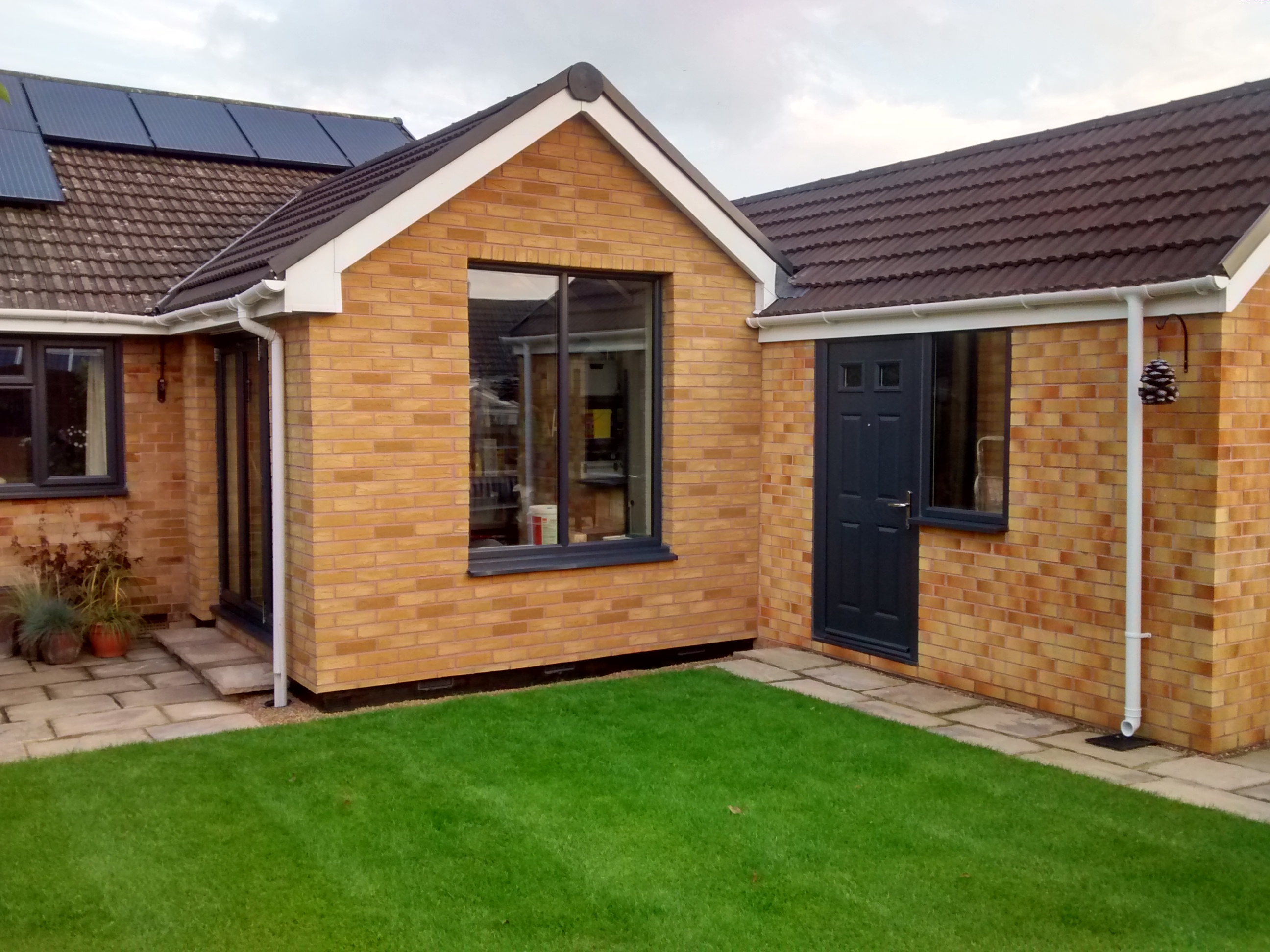

MikeGrahamT21 Posted February 7, 2018 Posted February 7, 2018 I used flexible brick slips (available via ewistore.co.uk), made by elastolith. These are DIY, and very easy to do yourself, just a little time consuming, but they look great when done. We even managed to get a good match. Building on left hand side is existing house, centre is the brick slipped one, and right hand side is a utility with real brick. You could also consider brick effect render, which is pretty impressive these days. There is a growing number of contractors doing this, but expect to pay in the region of £50-£90 per m2, its not cheap. We had a rough quote from this firm: https://www.decopierre.co.uk/ They can do pretty much anything!
