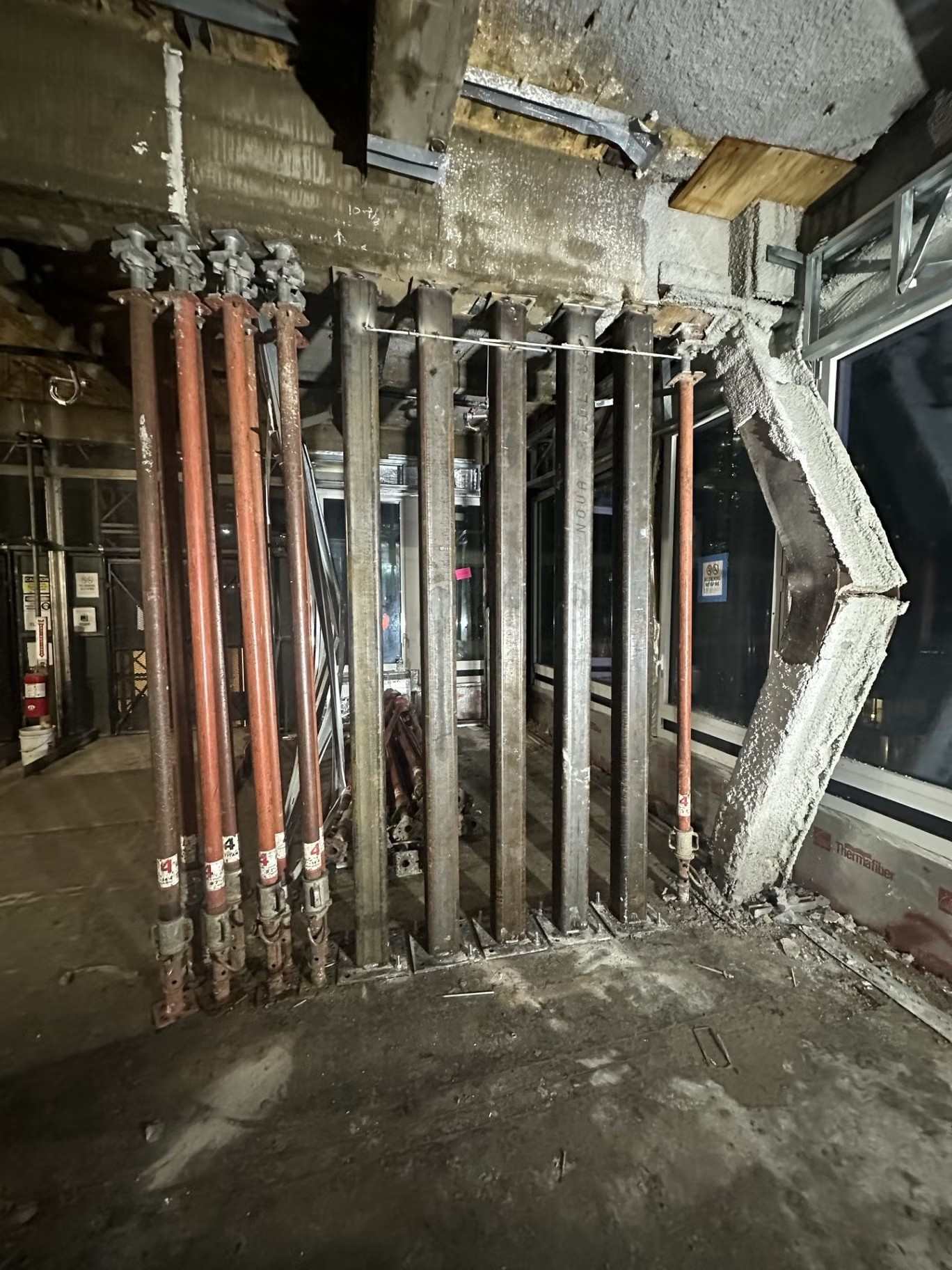

The building failing in Manhattan. A failed column and lots of temporary support.
The developer describes it as a "construction mishap".
More accurately it looks like  a total bodge without site scrutiny.
Is that a steel column,  made from bits, with a ticky tacky plate pinned on as a junction?
It appears to have failed at top, middle and bottom (classic year one engineering fundamentals), which suggests to me... be very scared about the whole building.

To your point  @saveasteading: I wonder how the repair in the first post was financed?

I think it said that the City was doing emergency work, because bits are falling off it into the road, and the whole thing could collapse.
Imagine the desperate shenanigans taking place to divest the company responsible from wherever the money is.
Meanwhile in Exeter we have a £31M school that's going to be demolished, having never been occupied because of the threat of collapse.  The companies have gone bust, so the state pays more than twice.
subsidence, missing bolts..... so who knows what else.
Does nobody supervise these days?
