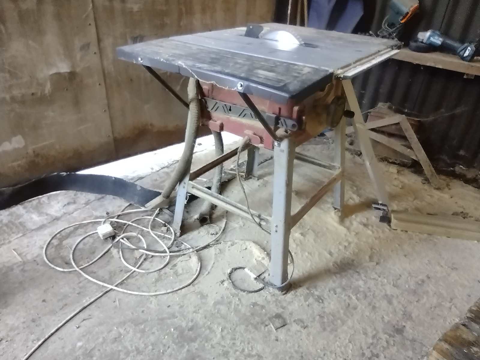

So I have this table saw I use in my workshop I've had it for a few years and recently changed the blade for the first time with a nice Rutland blade after the original one was blunt as anything causing the wood to smoke and taking ages to cut. I also cleaned out the table saw whilst removing the old blade. The problem is I am using it currently to cut cls studs to the desired length for my project and the blade keeps catching/ jumping/ kicking when I use it even though I'm being quite careful to the point I don't want to use it anymore. The blade seemed ok for the first few weeks with no jumping happening  but now not so much. What an I doing wrong? I never really had this problem with my old smoky blade I would have thought a new sharp blade would cause the table saw to kick less.

The complete lack of a guard over the blade does not inspire confidence.

And I think there may be a small issue with the dust extraction...
I have the saw located at my workshop entrance so the most dust goes straight outside.

One thing I forgot to mention and not clear in the photograph is the left hand wing of the table saw was bent downwards about half an inch so I was trying to accomodate for this as well when cutting the cls, so obviously this just added to the danger. I have since sorted out that bent left wing - a couple blows with a lump hammer at the top of the support struts where they connect to the table surface sorted that right out, so now the surface is completely level.

I don't rate such low-end table saw - shaped objects very highly.
Apart from the obvious H&S concerns: lack of guard, the pile of dust that's a slipping and inhalation hazard and the spaghetti bowl of cables (you don't want to trip and fall on the non-guarded blade :$), your support tables look out of true, which probably causes the blade to stick, kick & bind.

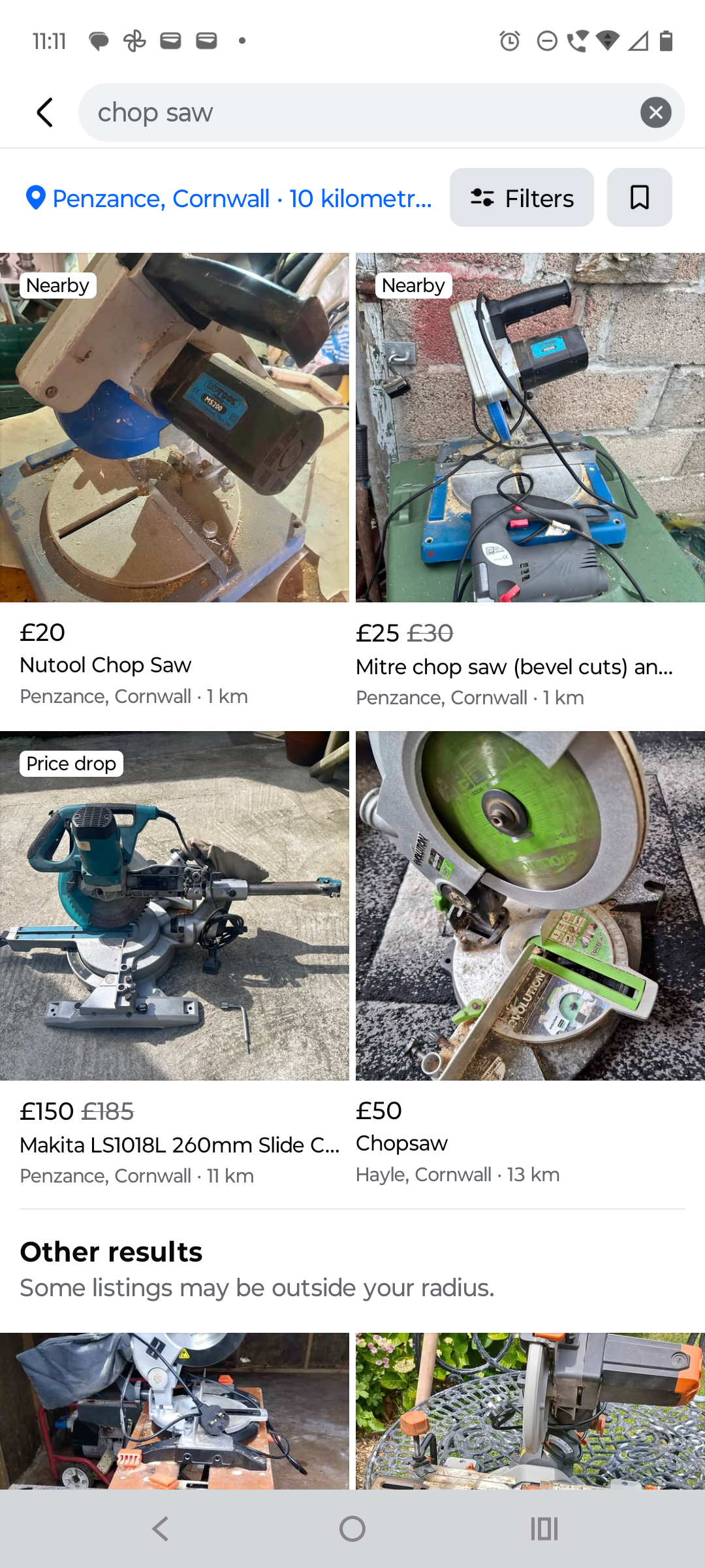

You'll very likely get a secondhand chop saw on Facebook Marketplace for not much money and local to you. The orange Evolution saws often come up. Fine for the level of accuracy you need for that.
