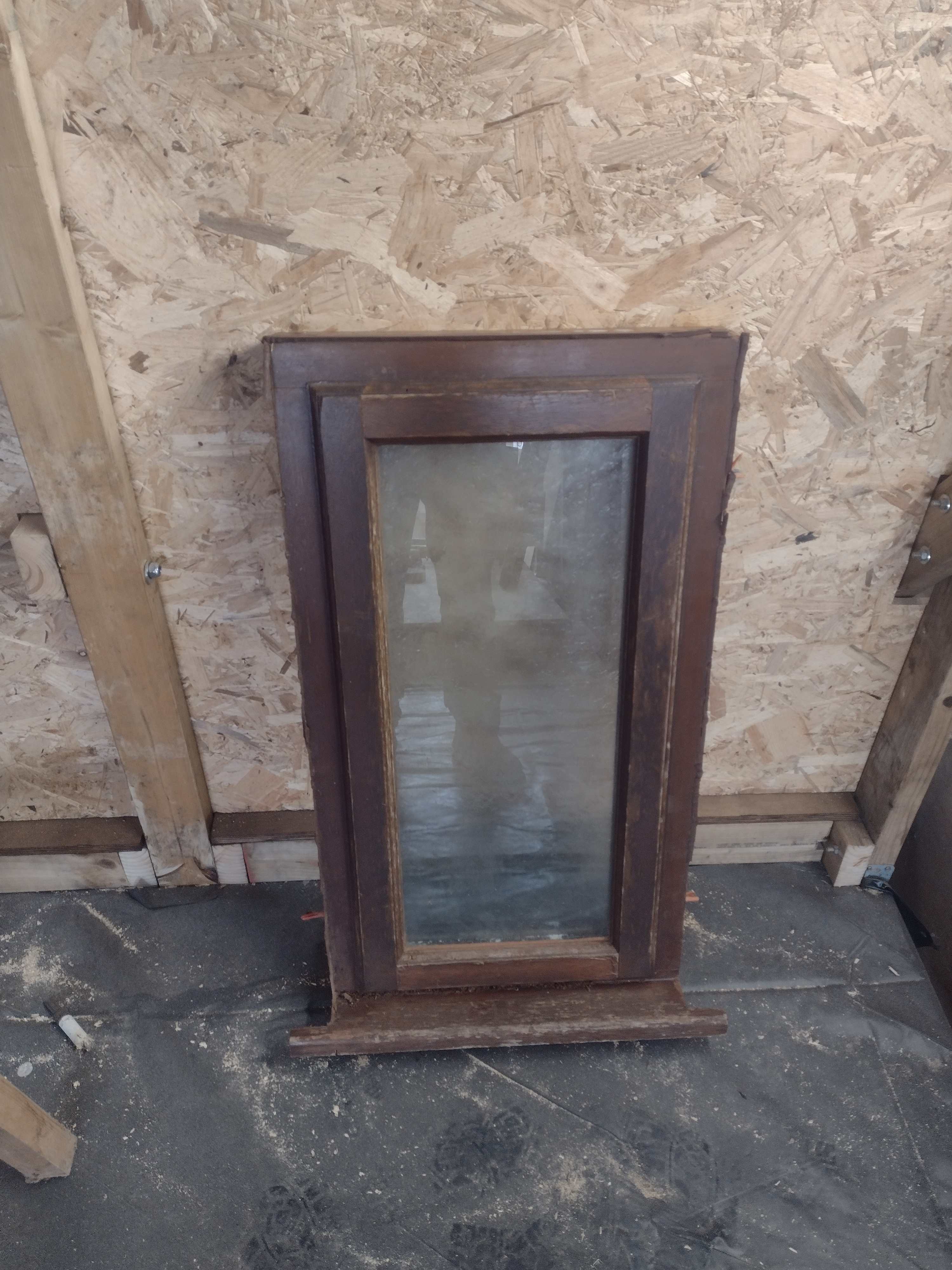

I've got this new but second hand rationel small window I'm going to install in a shepherd's hut, trouble is that it came painted white when another window I have ( in the bathroom) is bare wood. And I'm going for a rustic country style throughout the hut, so am planning to strip the window to keep the same style throughout. I've got some bartoline tx10 paint and varnish stripper and was just about the start the job but then a horrific thought came to me, what after attempting this job it looks awful? My main concern is that I won't be able to cleanly remove paint where the metal iron mongery is. The handle to open the window for example which will be highly visible doesn't look like it can be removed like other bits of metal on the product so I would have to work around it. Does anyone here have much experience with paint stripping? Would such a job be able to done to a high enough standard? I can be meticulous and diligent enough when required but need to know if this is even worth starting. If not I'll have to sacrifice the common styling throughout the hut somewhat I suppose.

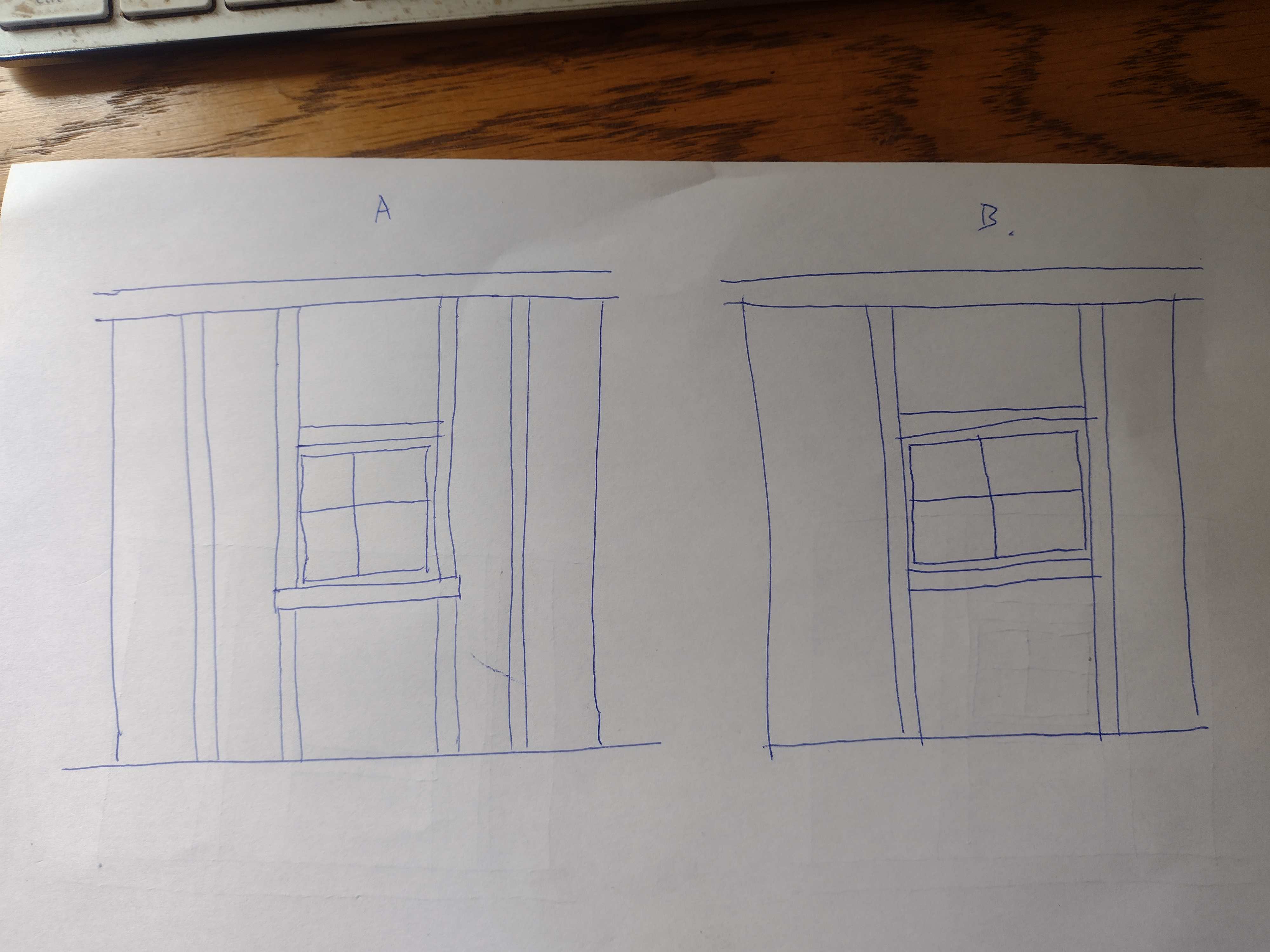

How to build a stud wall around a small window
cowboy25 replied to cowboy25's topic in General Self Build & DIY Discussion
Its an external wall, so I guess that makes it load bearing? So basically add in one or two cripple studs and double up the king/jack studs. Got it. The header I assume should be a thicker stud as well. -

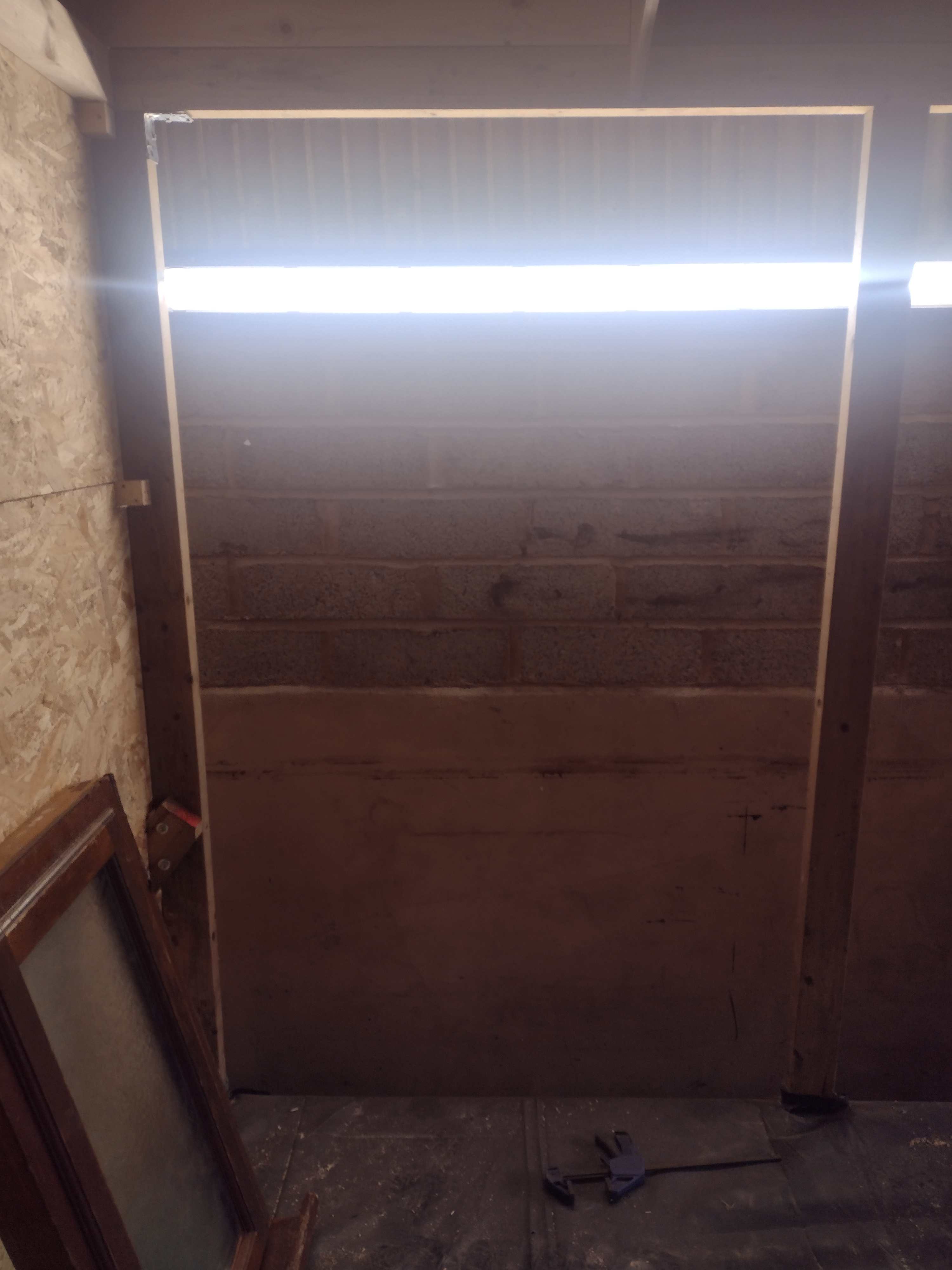

This is for a small window for a bathroom in a shepherds hut which I'm building from scratch. The bathroom is very small so will just have one small window. The size of the wall space is w 121.6 cm by h 195.2 cm and the window is w 48.5cm x h 91cm. Obviously the wall space is quite small so I was wondering if I can just have two vertical studs with the window,window header and window sill contained within as in diagram B. Would this be structurally sound? Or do I need 4 vertical studs as in diagram A? The first photo is the window and the second photo is the bathroom wall space in question between the existing vertical studs.

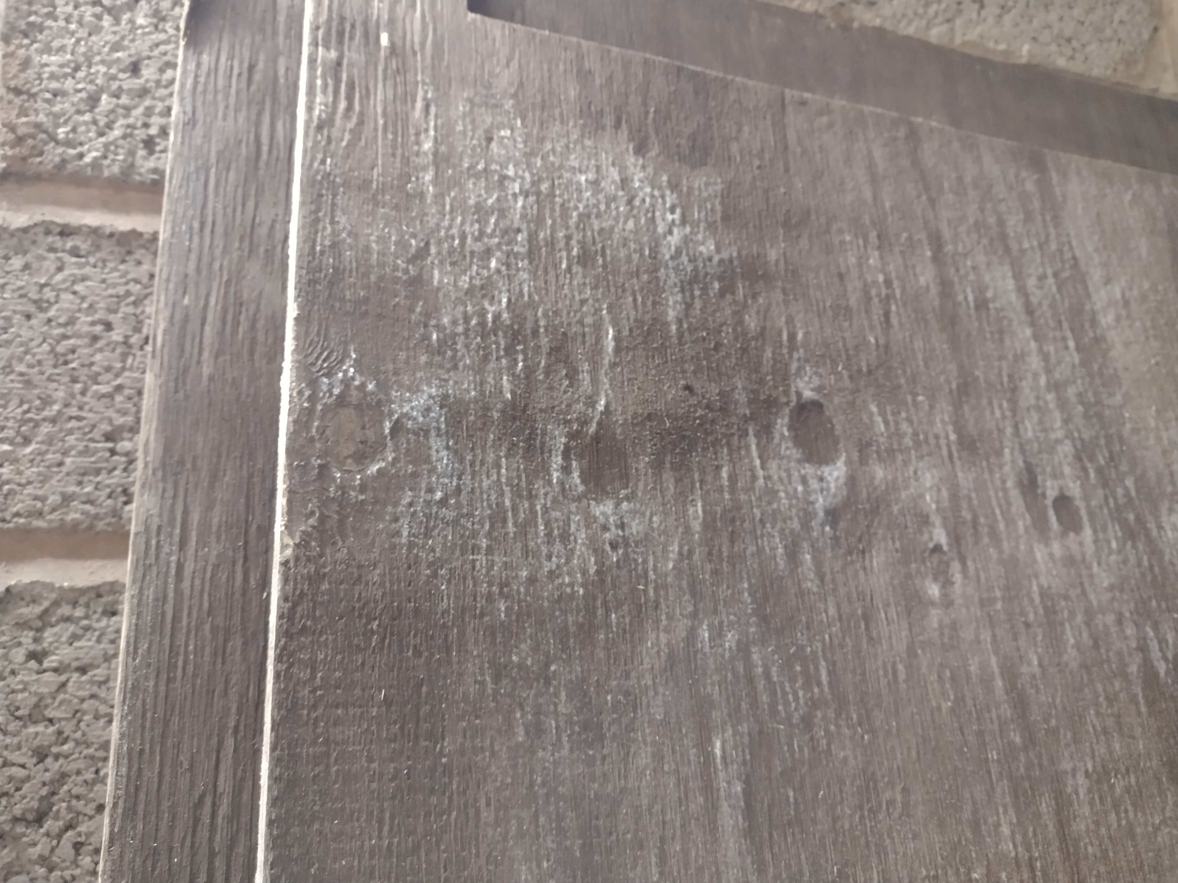

Is OSB board more resistant I wonder? Whats the answer here, I wasn't expecting this problem, no other wood in my workshop (oak flooring, tongue and groove softwood cladding, oak doors, 2x4 baton etc) is experiencing this problem.
The mould is back on 2 out of the 5 plywood boards to be used as the sub floor of the shepherds hut. Ffs. How much of problem could this be does anyone know?? Can I just scrub it off and start building or do I need to buy more mould remover? Too many setbacks here, can anyone recommend a good mould remover apparently the I used wasn't up to the job.

I bleached washed them after sanding/ wire brushing and then I used a proper mould killer as pictured. I used a mask when applying teh mould killer but not whikle sanding however I was standing next my open workshop door whilst sanding so I had access to fresh air but duly noted for the future re masks and sanding.
