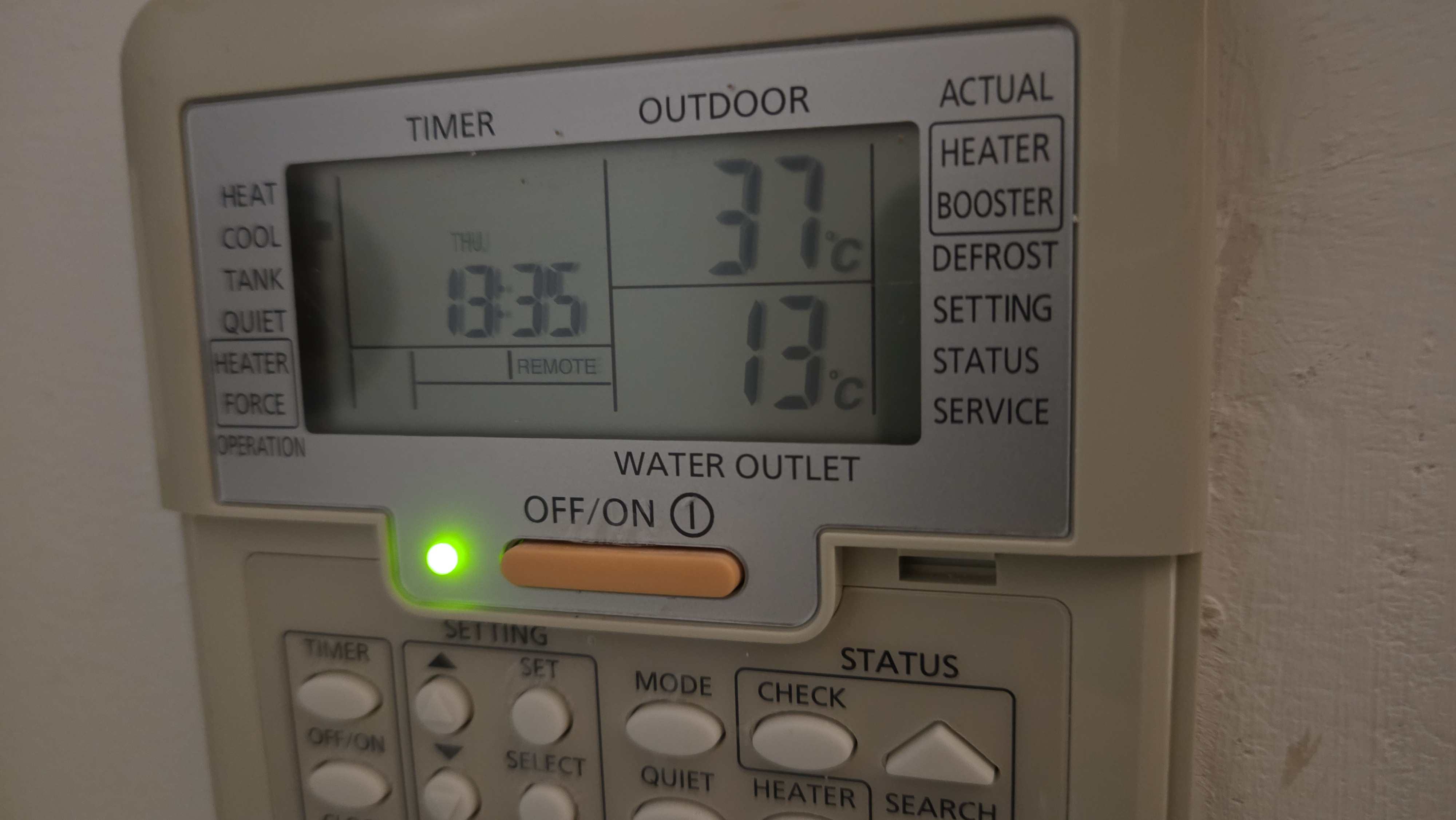

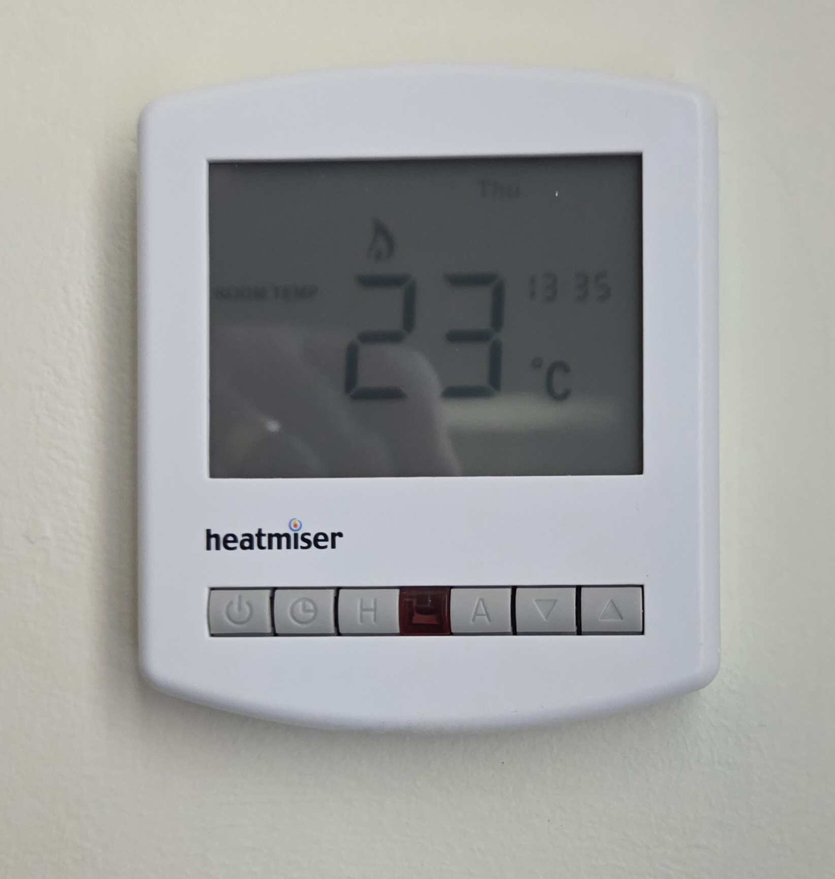

20260625_133653.thumb.jpg.34ea08473dd289c3ea96a6846e9f9db2.jpg20260625_133543.thumb.jpg.05409464a27fbbe5af02f8a8d2ac0a7f.jpg
This was at 13.35 today. We have hard (Karndean) flooring throughout. Had a few areas where the surface has got a little damp this afternoon, but I can live with that.
I lowered the flow temp on our underfloor cooling from 16 deg to 14 deg a few days ago, in anticipation of the several day heat wave.
The surface of the door (polished concrete) slowly fell to a minimum of 18.7 deg a couple of days ago. It's slowly drifted up to 18.9 deg since.
In the middle of the afternoon today, I noticed some darker spots on the surface of the concrete. Within three hours of noticing that, entire sections of the floor in the kitchen were slightly damp.
We've never seen so much as a whiff of moisture in 7 or 8 years of using underfloor cooling. It's amazing what a two degree flow temperature difference coupled with high humidity (~80 inside at the moment!) can do.
I've turned the flow temp back up and will monitor.
