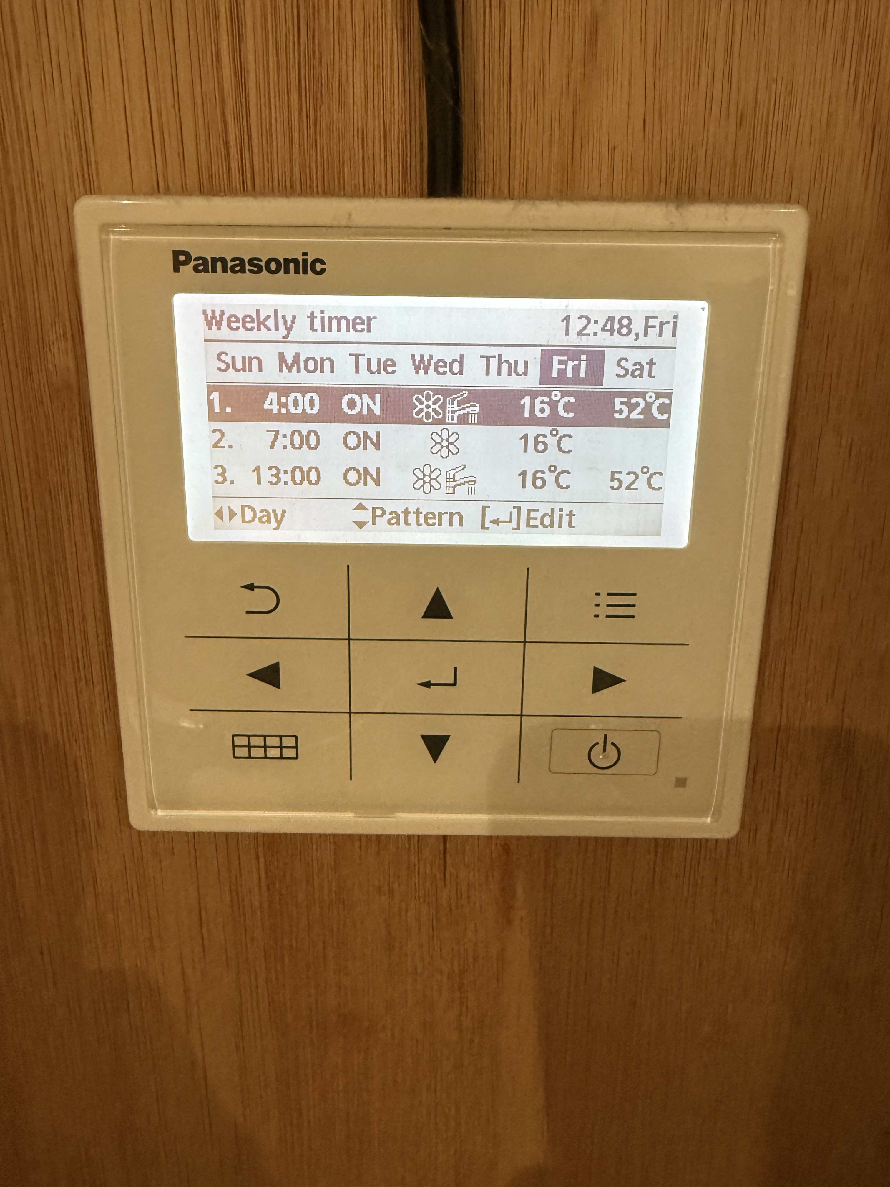

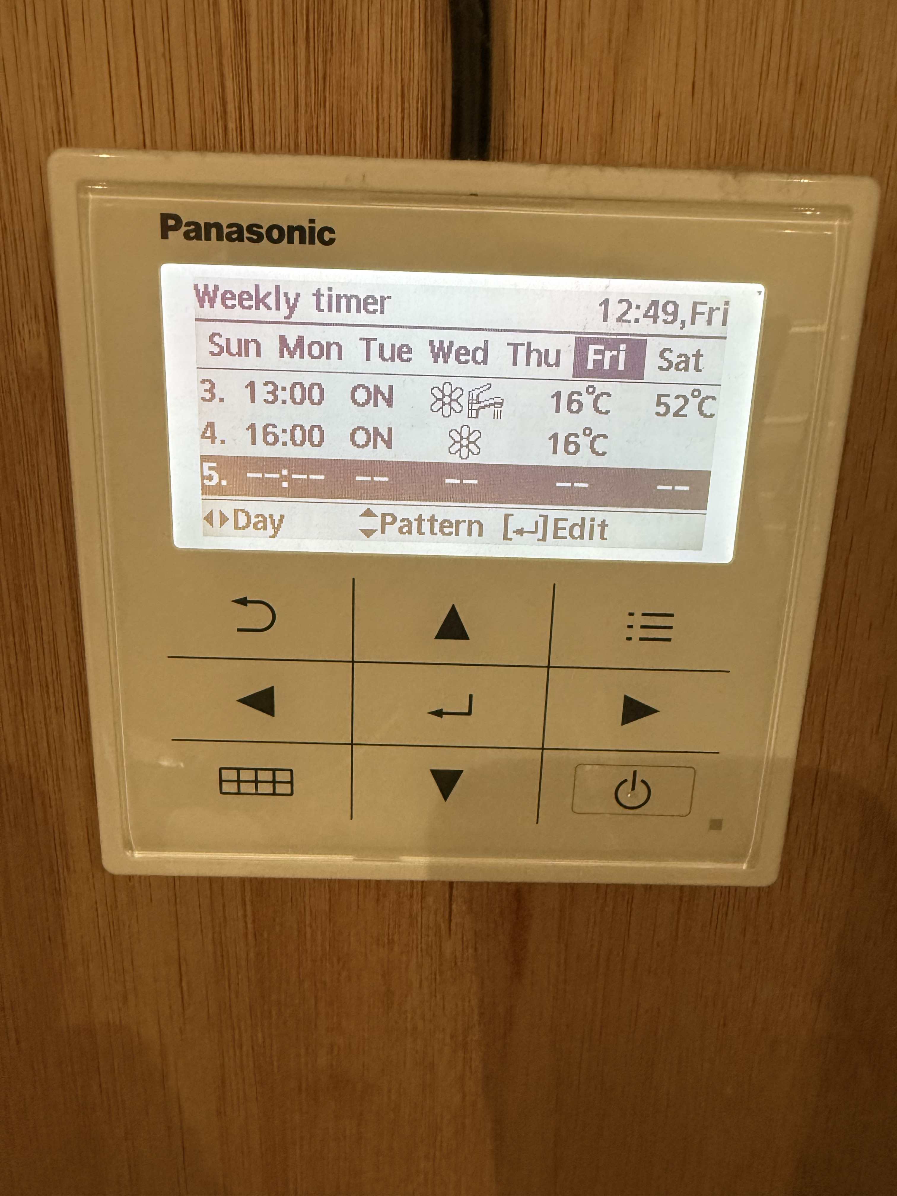

May 22May 22 Author Found it! Thank you As you said I have wound my thermostats out to 35 deg to trick the controller/pump See pics below how I have programmed it to start with to see how I go In terms when I don’t need the cooling do you guys just turn the thermostats off? Thanks again

May 22May 22 Author Yeh that’s a good setup I’ll do my summer/winter switchover as usual on my ASHP controller and then just control the cooling by thermostats. I have set my water temperature for 16deg, I have done a lot of reading on the internet and this seems the lowest it’s seems to recommend to go is the temperature you continually change? As the dew point would fluctuate wouldn’t it
May 22May 22 9 minutes ago, richo106 said: 16deg Would start there, if you are not getting the cooling effects you want (takes a few hours) you can safely go down to 14ish. Look at your UFH manifold, if you start to see water forming, you have gone too low - it should stay nice a dry.
