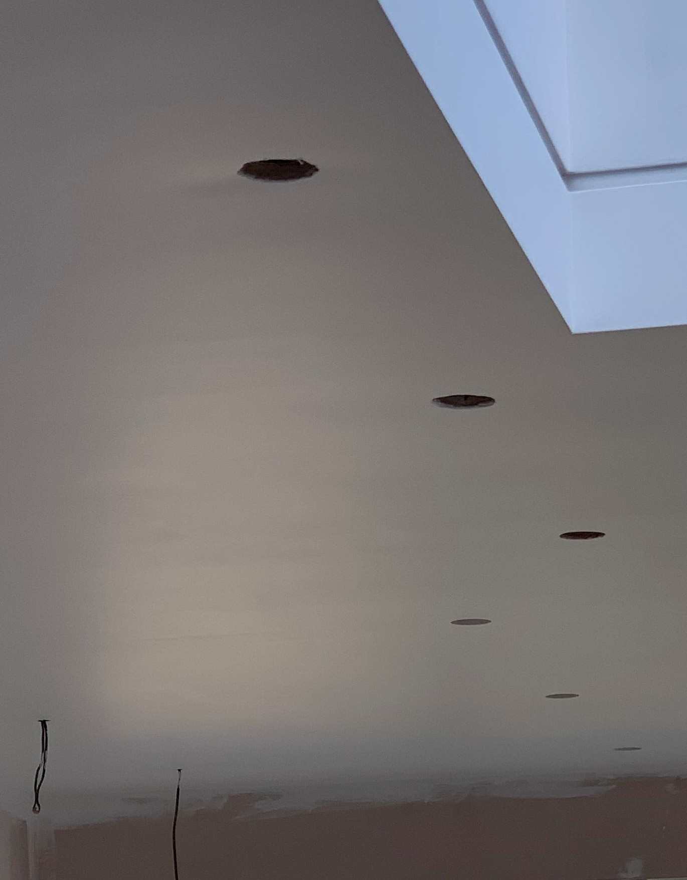

Have spent today applying Farrow & Ball Modern Emulsion in 'All White' to a large ceiling. First coat only following mist coating. All seemed fine while applying it with a roller.

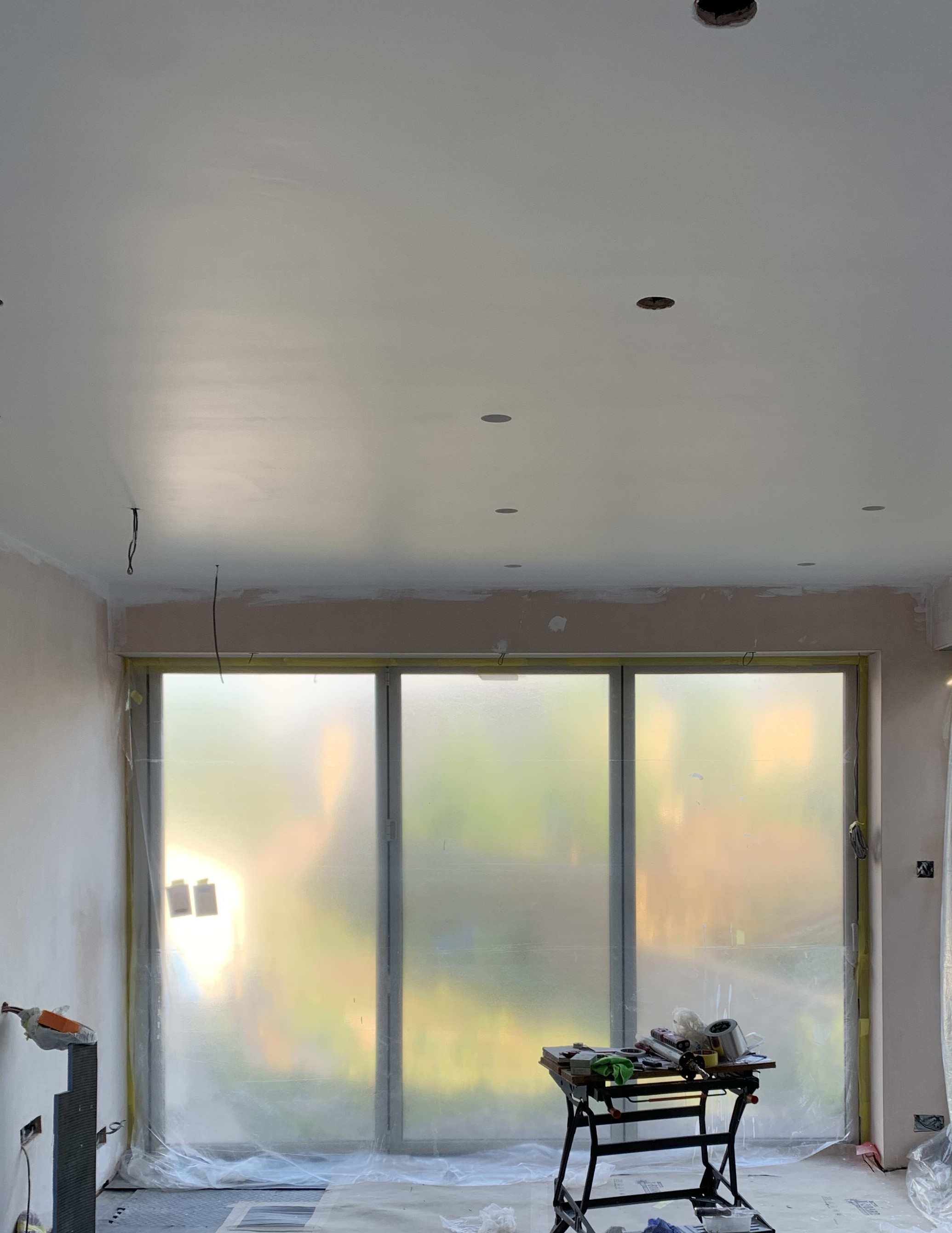

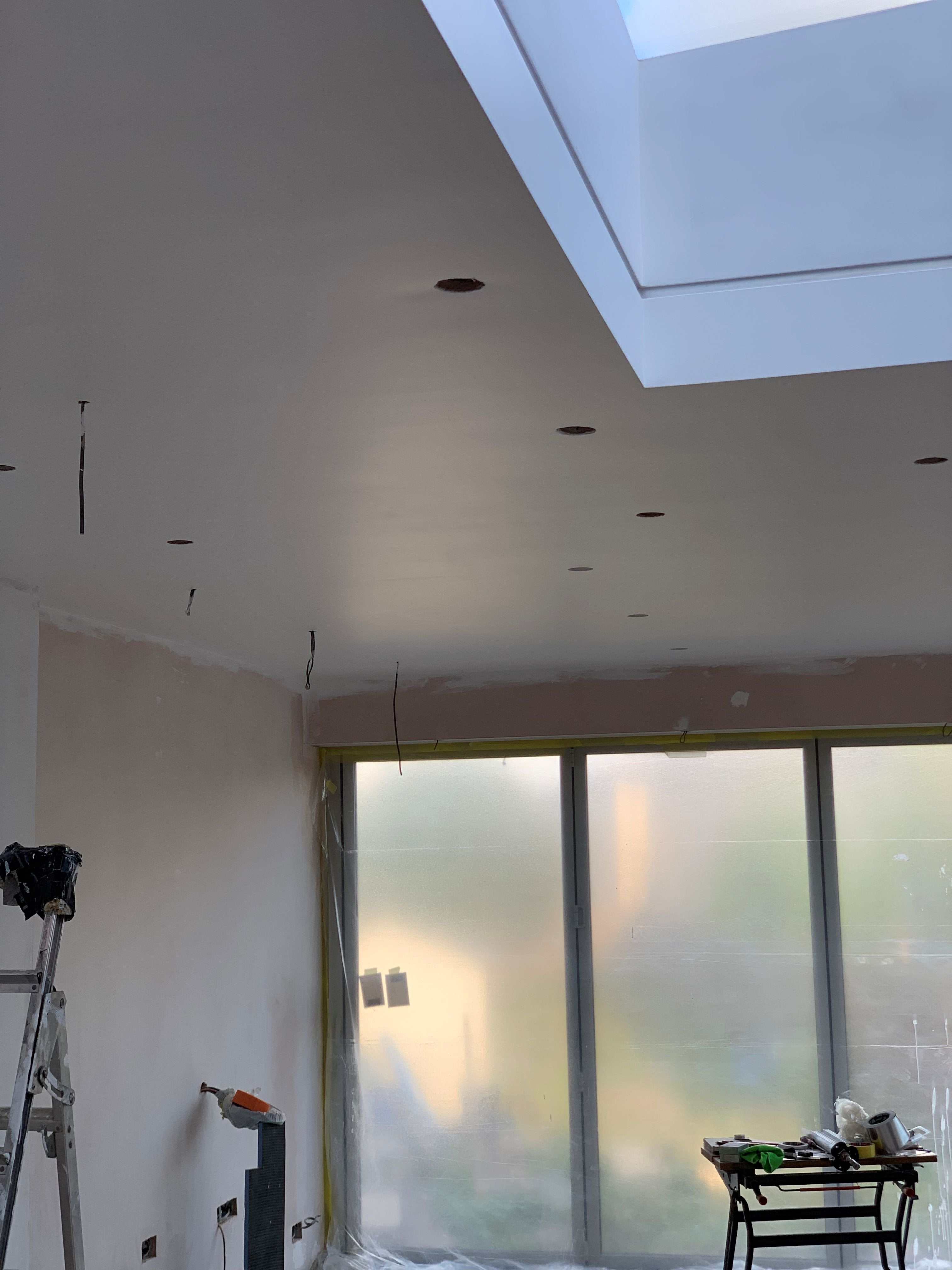

Now some hours later with some sunlight reflected back into the room (albeit through a polythene cover), the ceiling looks pretty awful. See pics.
We were going to put F&B Dead Flat on the ceiling and Modern Emulsion on the walls as the open plan room contains a kitchen. However F&B shop said some customers had done this and had it peel off because Dead Flat is not a suitable paint for rooms where moist air may be present aka Kitchens & Bathrooms. Therefore we were told to use Modern Emulsion.
Now it looks like it has a pronounced sheen, and seems to make the ceiling look very poor and uneven.
Any advice please ? I thought F&B was supposed to be a premium paint ?
Am I going to have to switch to something else which is actually Matt and if so what ?
Will a second coat solve the problem ?
(PS Mist Coat was applied by rolling away from the window, First coat of F&B by rolling across the window/room on the understanding we would then apply the final coat of F&B by rolling away from the window again.)

Wrong paint I’m afraid.

The problem you have is you are trying to to do two different things you want a shiny paint with no pores open to stop moisture getting to it because it’s a kitchen, but then you want a flat mat paint to hide the plasterers sins.

but I might be inclined to go over the f and b with a primer, maybe the Tikurila optiva primer then the Tikurila anti reflex.
