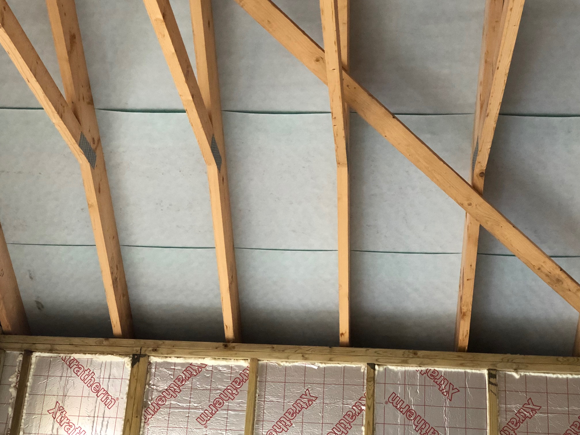

Pocster Posted January 26, 2018 Posted January 26, 2018 (edited) Hey all my spec shows insulation in between rafters then 50mm over that whole thing finished with taped joints . So when I plasterboard I just screw straight through the pir into the timber ? . I’m worried on a timber frame build that once skimmed there’s bound to be some movement and plaster cracks ? even on a masonry build you always get hair line cracks where ceiling meets external wall . There a simple trick to avoid this ? Just calk the edges ??? just assume chance of skimming cracking higher on timber frame build .... cheers Edited January 26, 2018 by pocster

Luckylad Posted January 26, 2018 Posted January 26, 2018 I would counter batten over the pir board because it's bit spongy and you'll get screws popping. I think you'll get better u value, a service void and you'll see what you're screwing into, rather than guessing through the pir. 1 1

Pocster Posted January 26, 2018 Author Posted January 26, 2018 39 minutes ago, Luckylad said: I would counter batten over the pir board because it's bit spongy and you'll get screws popping. I think you'll get better u value, a service void and you'll see what you're screwing into, rather than guessing through the pir. I think my architect wanted no thermal bridge . Insulation in between rafters then 50mm over that and the rafter edges . so complete insulation back to back

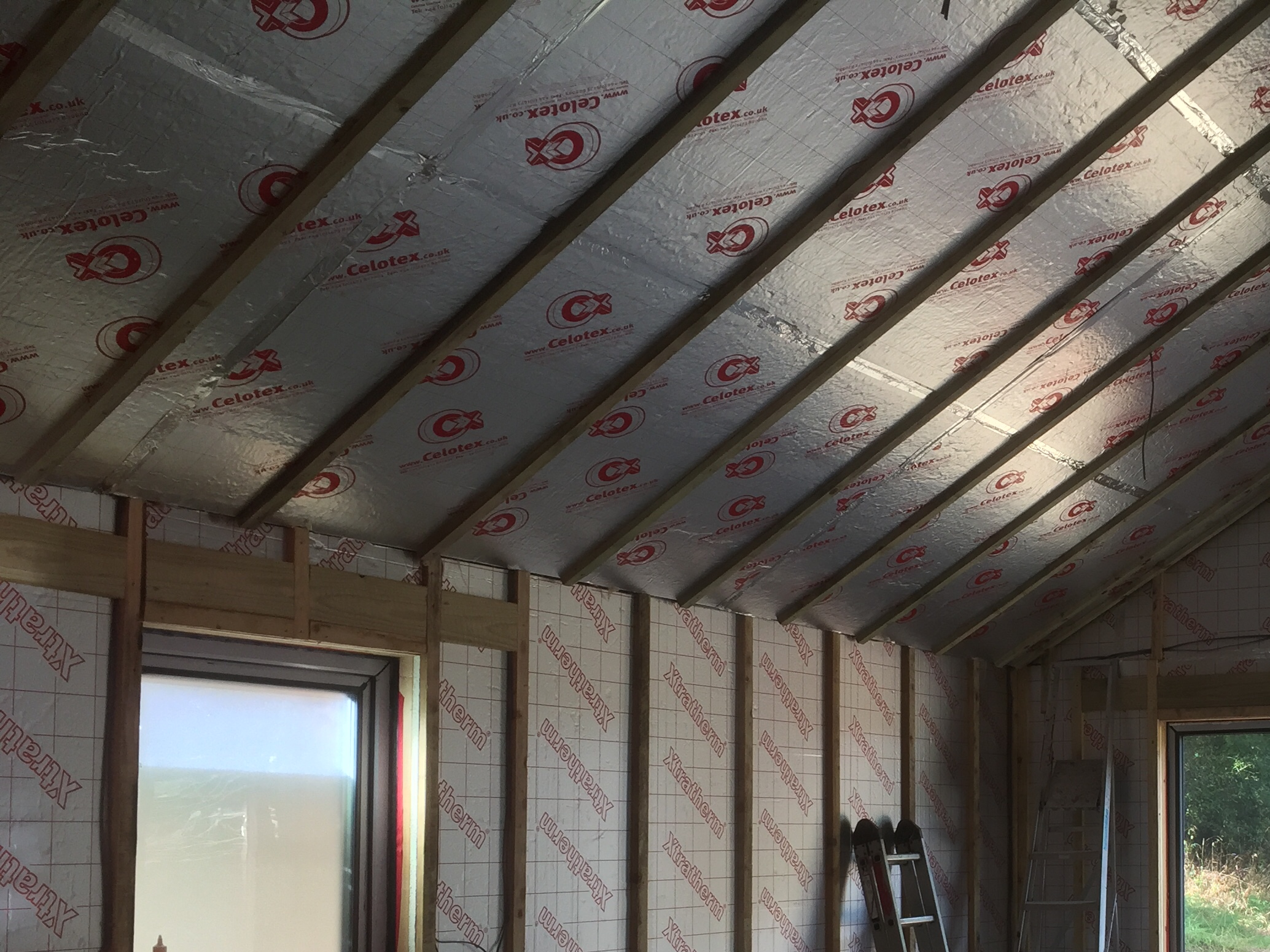

Pocster Posted January 28, 2018 Author Posted January 28, 2018 Ok!; anyway!; back to my original problem Insulation between rafters ; 50mm over the lot. Plasterboard fixes how?. The point of the 50mm over is to avoid all thermal bridges; so just upping with timber battons I guess doesn't help. Cheers
Ian Posted January 28, 2018 Posted January 28, 2018 @pocster Isn’t this the usual way of doing it: insulation between rafters and wall studs then continuous layer of PIR over the face then battens to create a wiring zone.
