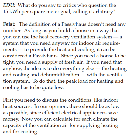

February 18Feb 18 Quote The definition of a PassivHaus doesn't need any number. The PassivHaus Institute thinks otherwise. Sure, their heat demand/load numbers are based on the theoretical ability of an MVHR system to deliver the required heat based on several other assumptions, but imo that context is of little practical relevance given they don't actually require heat to be distributed in that fashion. 1 hour ago, Mike said: In the UK at least, UFCH pipes are sometimes added for reassurance and / or for future summer cooing. But UFH isn't "sometimes" installed for "reassurance" in the UK. UFH is widely installed as the primary heating distribution system in PassivHaus-class buildings in the UK, presumably because people prefer to heat their homes that way than via hot air through a ventilation system.

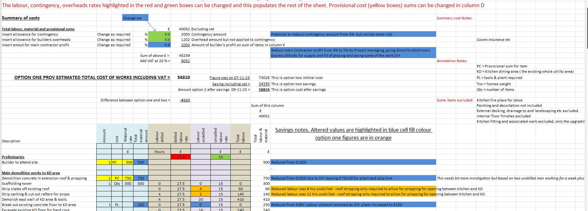

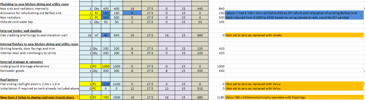

February 19Feb 19 Author @Gus Potter Thanks for the screen shots... really appreciate it We've already got some labour costs in the spreadsheet, mostly because we're aiming for supply & fit for the big ticket items (for VAT reasons... 5% on supply & fit, 20% on supply only). Thankfully, labour rates here are not too outrageous if you choose wisely Once it's watertight, we're in no huge rush and looking forward to doing as much as possible ourselves... we've done it before, albeit on a smaller scale, and while we're admittedly getting older, being hands-on is one of the drivers for the project. 12 hours ago, Gus Potter said: In the round you need to strick a balance.. but with a bit of thought you can often get to install the things you love..call these a luxury item, if you can make pragmatic savings elsewhere. This is bang on... There are quite a few aspects of our plan that many would question, but we are determined to have... a few economies elsewhere make the justification a bit easier
February 19Feb 19 17 hours ago, jack said: UFH is widely installed as the primary heating distribution system in PassivHaus-class buildings in the UK, presumably because people prefer to heat their homes that way than via hot air through a ventilation system. Sure, you can choose to heat a Passihaus however you like without restriction. Perhaps because of that, many people in the UK seem to be unaware of the underlying principle behind why 15 kWh/m²/year was chosen (for European climates) - it's not a random number - and think that they need to pay for a conventional heating system in addition to all the other costs of achieving the standard, rather than offsetting the cost saving. Indeed it's so fundamental that it's the reason that the word 'passive' is in the name - it doesn't require traditional 'active' heating or cooling, because it can maintain a comfortable temperature largely through passive means. 17 hours ago, jack said: imo that context is of little practical relevance given they don't actually require heat to be distributed in that fashion. It's pretty useful to know on a thread discussing costs vs benefits. Worth mentioning too the innovative use of Willis Heaters as a low-cost heat source for those who do choose to add UFCH; there are multiple threads on the topic.
February 19Feb 19 19 minutes ago, Mike said: unaware of the underlying principle behind why 15 kWh/m²/year was chosen (for European climates) So elaborate! 20 minutes ago, Mike said: it doesn't require traditional 'active' heating or cooling, because it can maintain a comfortable temperature largely through passive means. Not exactly correct - the heating demand rate if 10W per m² max demand is a good indicator that us incorrect. That number being chosen for a specific reason - a heating element in the MVHR (flowing at passivhaus flow rates) can supply that heat without getting a burning dust smell from the ventilation air. A passivhaus still needs heat not much, but some, you don't need a huge gas or oil boiler though.
