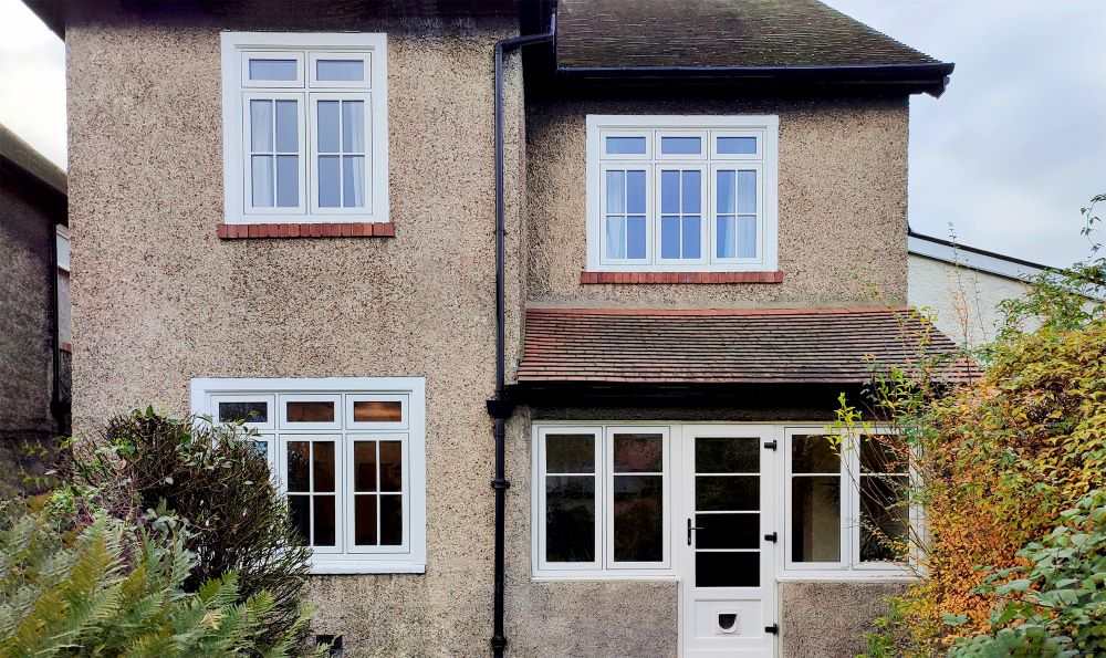

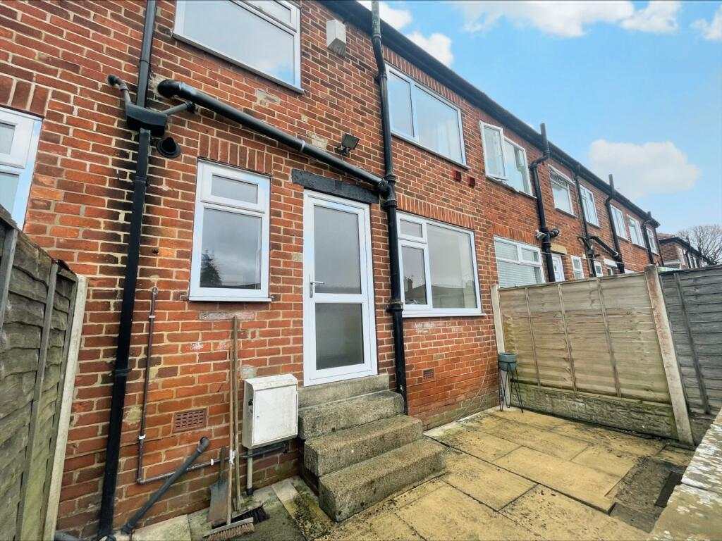

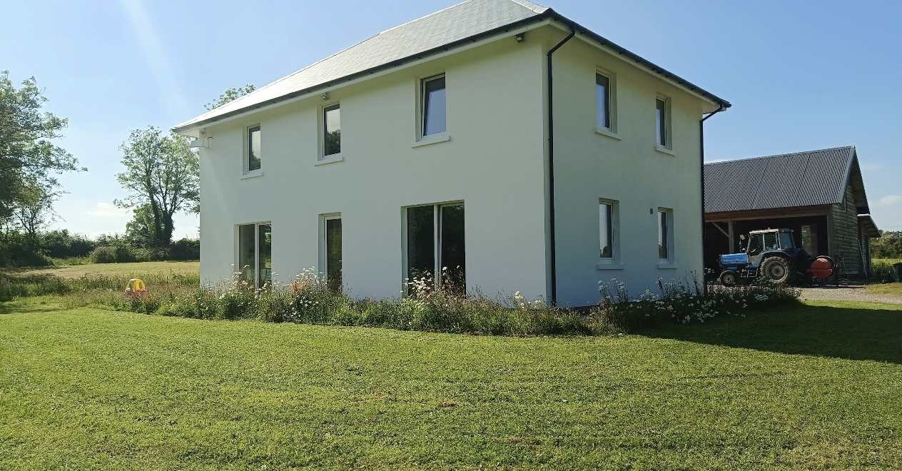

What they really mean is we don't want to have a house that looks like this,(because there may be poor people inside). What a bunch of snobs they are.
White uPvc looks just fine if appropriate care is taken of the proportions of the windows.
It's amazingly durable if you get good stuff. I don't know what the aluminum adds really.
That's ours below. White T+T Veka Softline 82.
Screenshot_20260216_222310_com_google_android_apps_photos_SearchActivity.thumb.jpg.b299d8396c4998b39ccd4ec61e8509f4.jpg
White uPvc fascia and soffit and black guttering and down pipes whilst we're at it.
