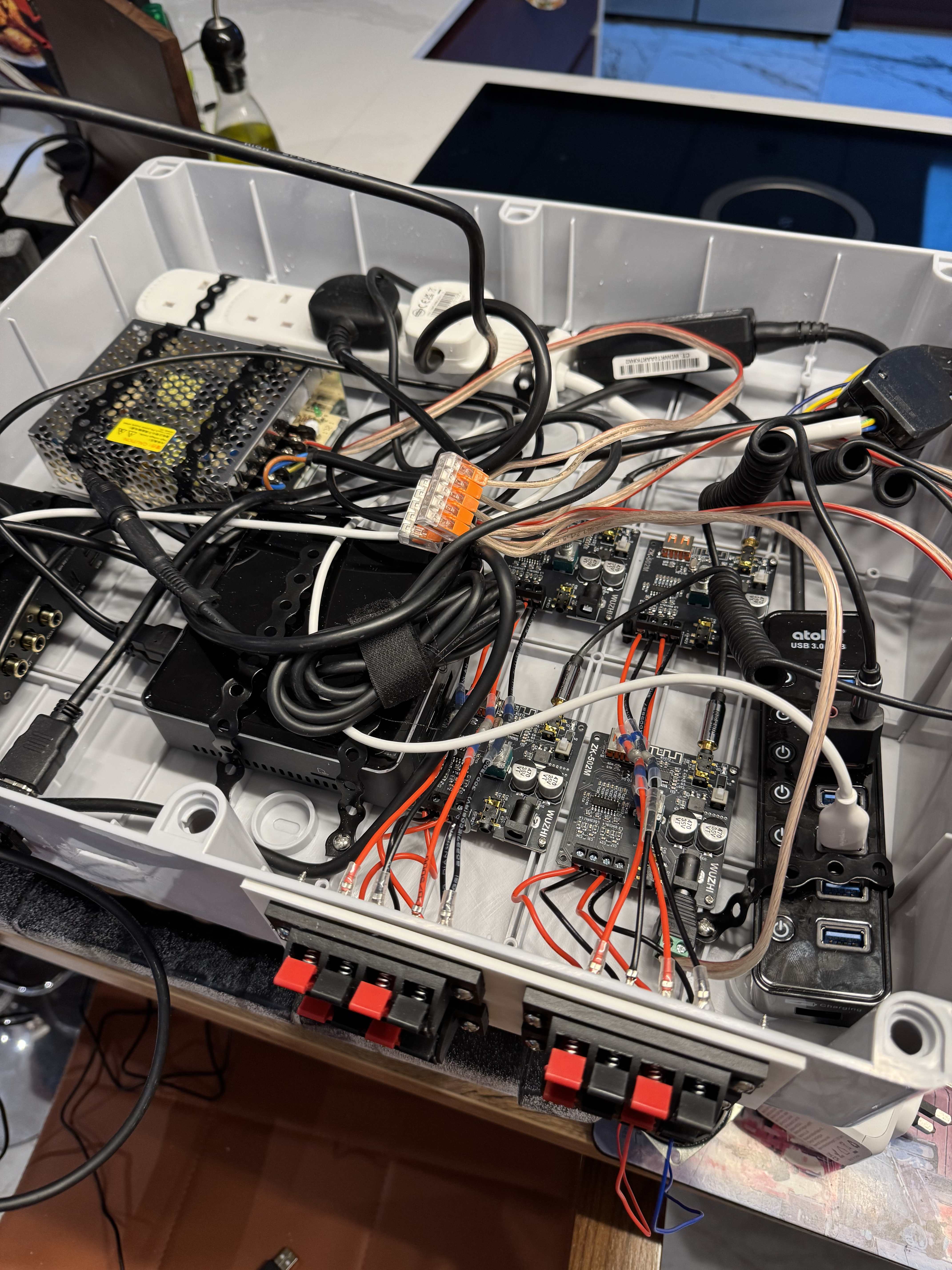

Been doing this with 5 raspberry pi’s . But it’s a pita to mange with sd card failures etc
So !
Another project !

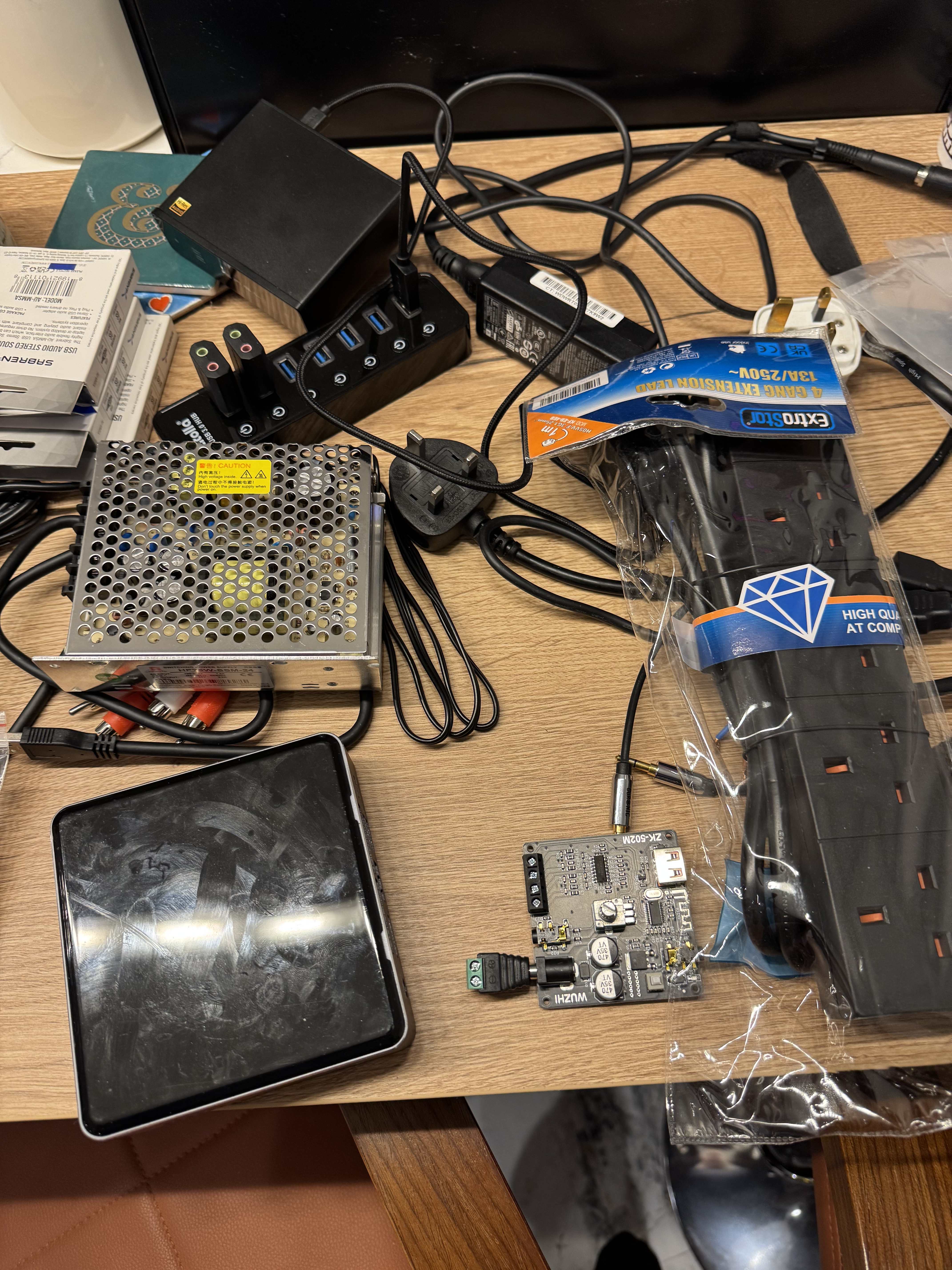

nuc i3 + hdmi touch screen ( just because it’s spare ) , usb powered hub . Cheap dacs into cheap amp boards apart from ‘ proper audio ‘ via smsl .
All in 1 case ; just 1 plug .
Here’s the bits !

I have used max2play for audio in the past and you can set it to do no sd writes once booted . Sd card failure is pretty common on pi’s . Nvr , Emmc etc all doable but they’re not really ‘ premium grade ‘ . That NUC i3 I got 2nd hand off eBay for £40 . So with its ram and ssd not only cheaper than the pi equip, but more robust .

Wiring was already in per room . Zero hum anyway . So it’s more an upgrade I guess that a new system . You could of course stick Sonos everywhere at great cost. Selling those 5 pis and Hifiberry amps on eBay covered the cost of replacement system .

What are you doing about cooling?
4" Extraction pipe direct to external wall? Or are you going for a split unit ac?

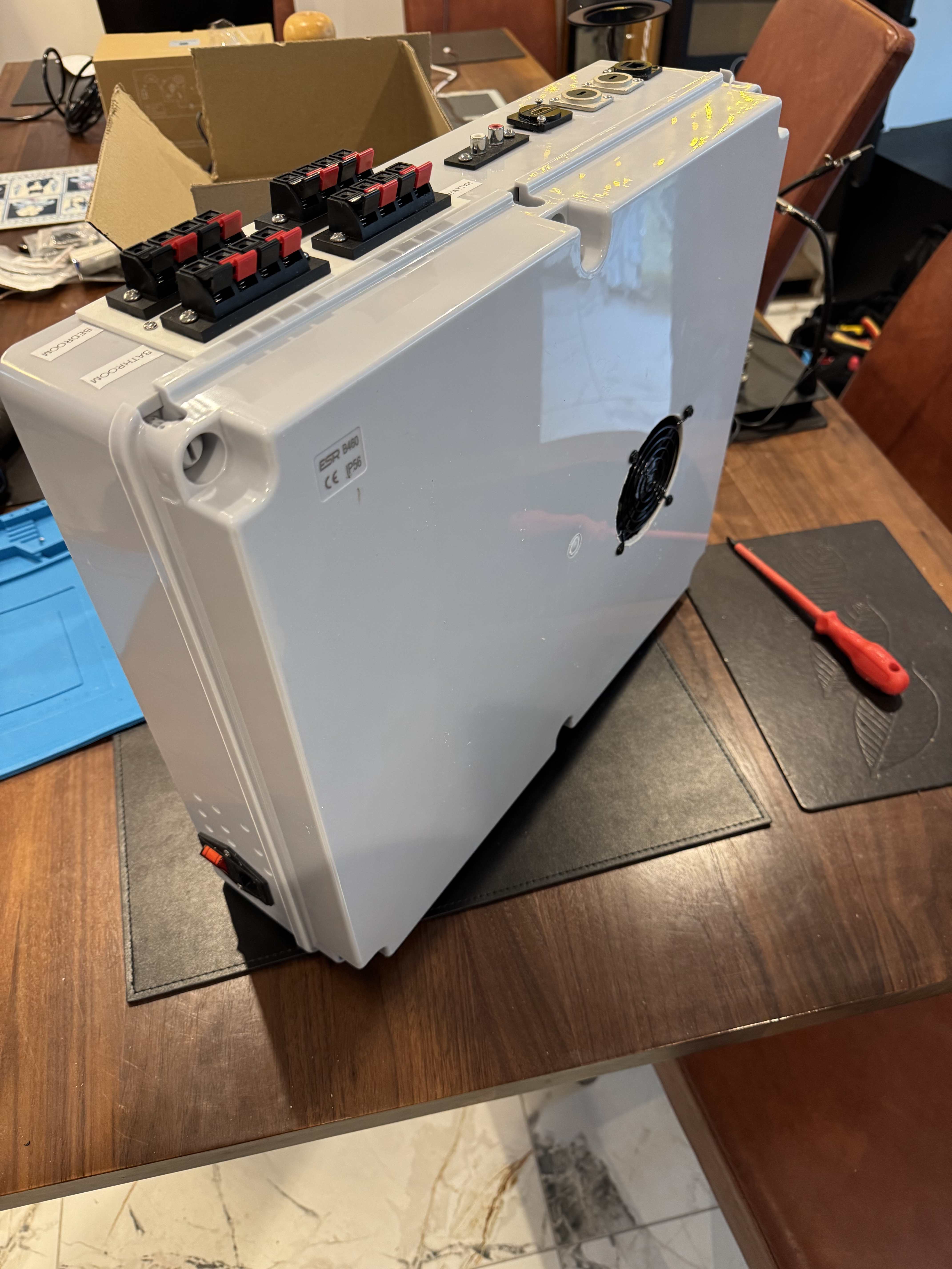

Already ahead of you . Got a usb powered fan to install

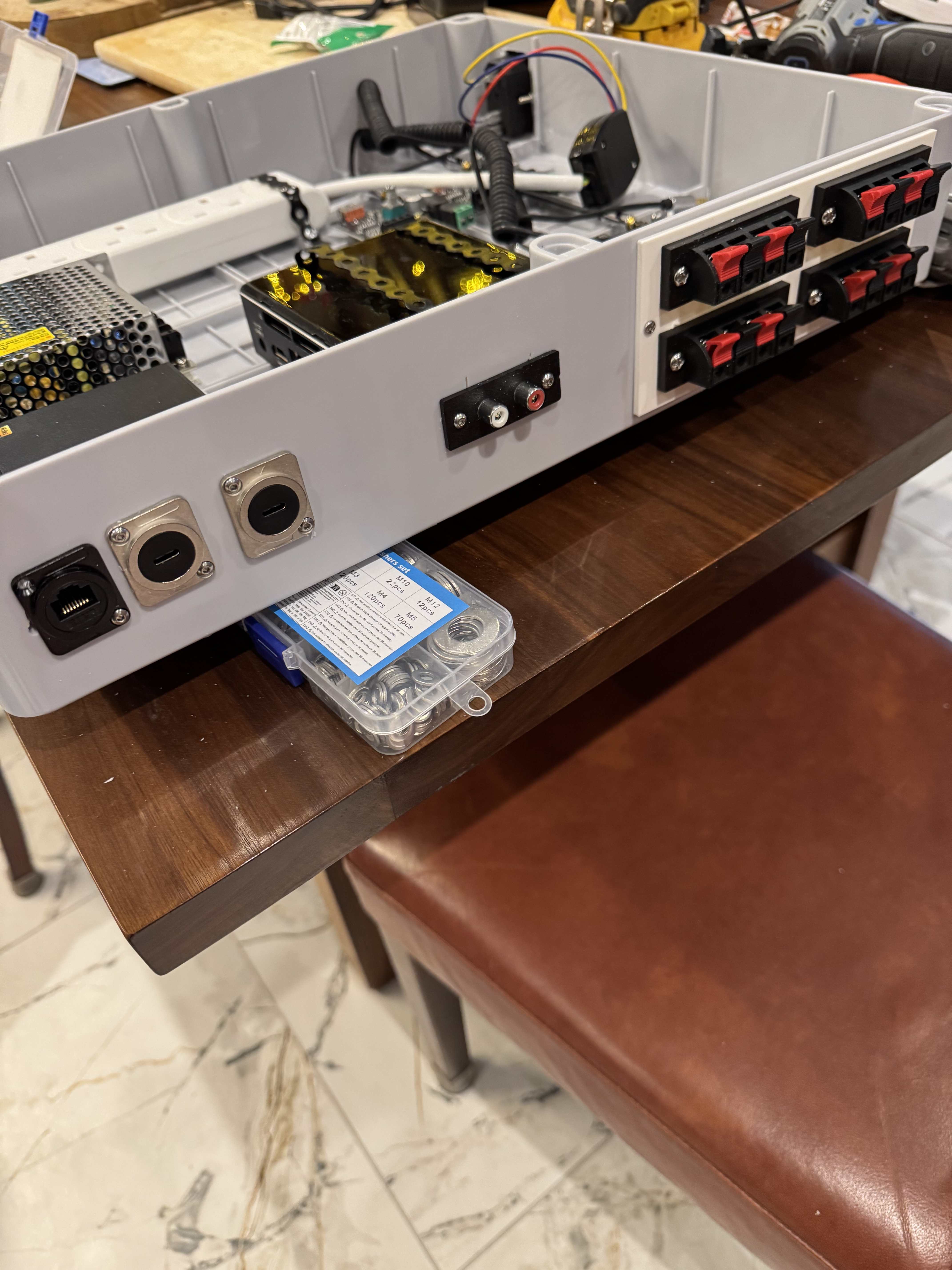

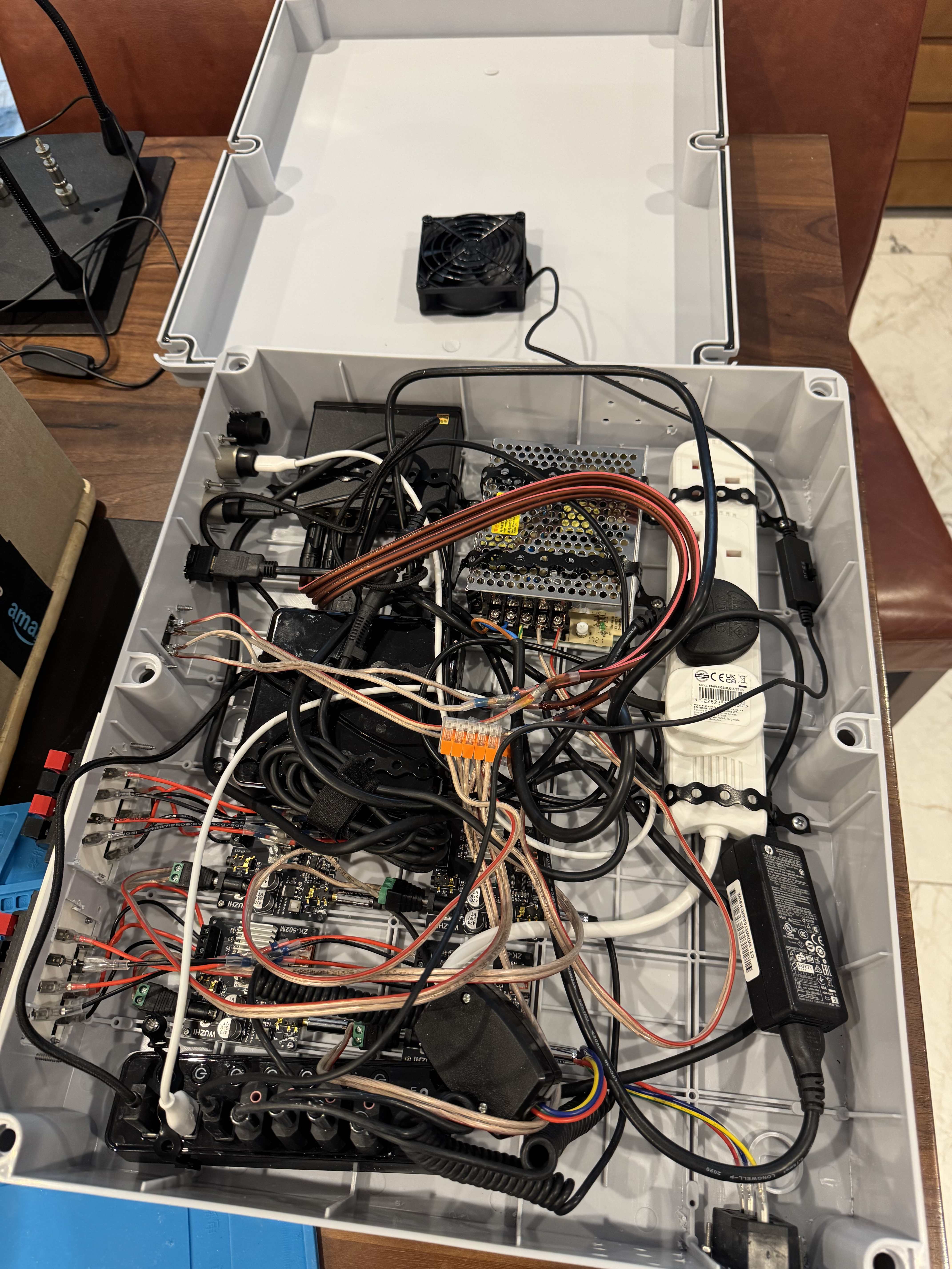

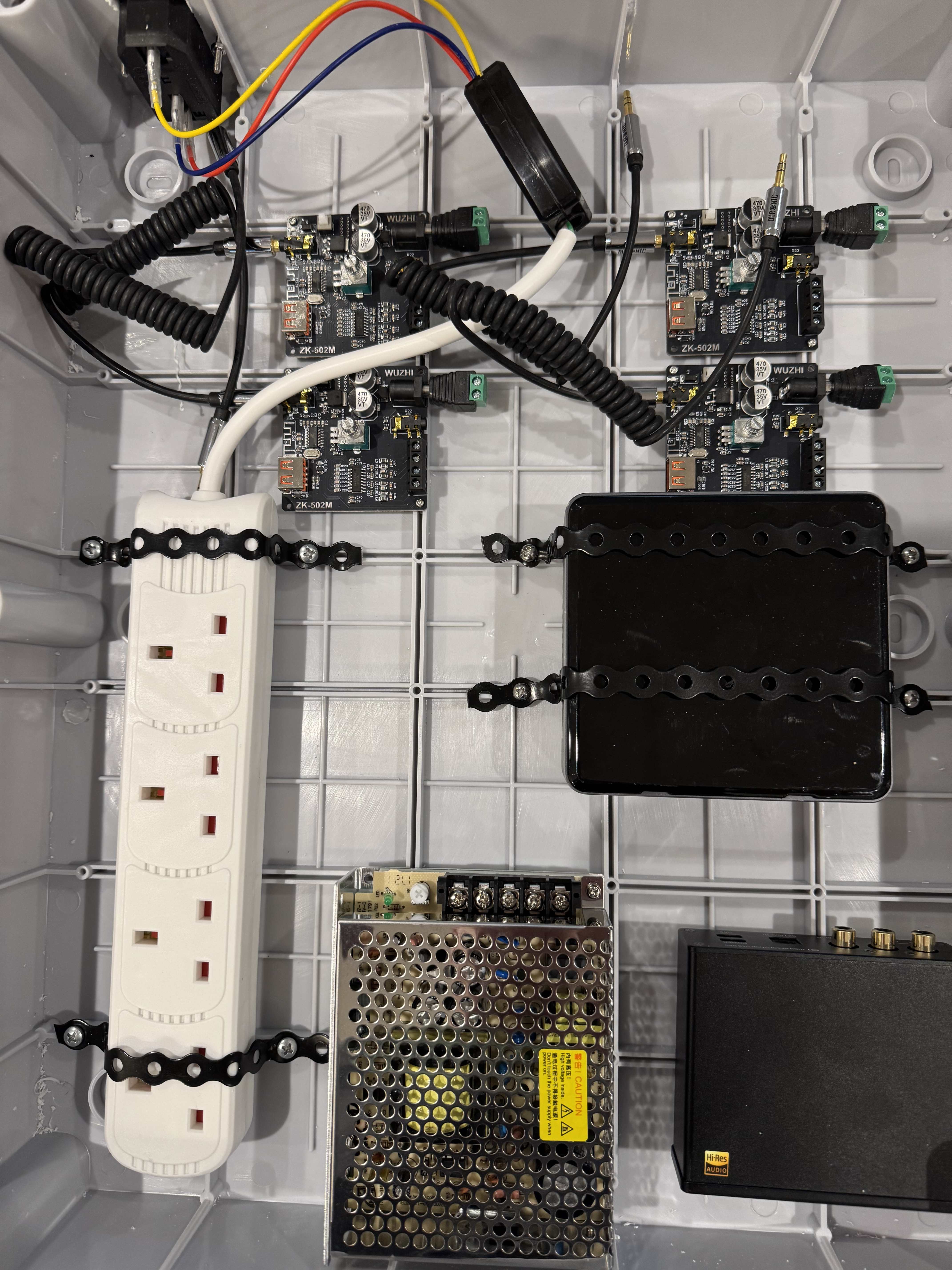

Finally deployed and wired up .
It would seem some speaker connectors are wired wrong way round ( though I checked a zillion times ! ) . But no worries .
Not told SWMBO - so that’ll be the ultimate test !
