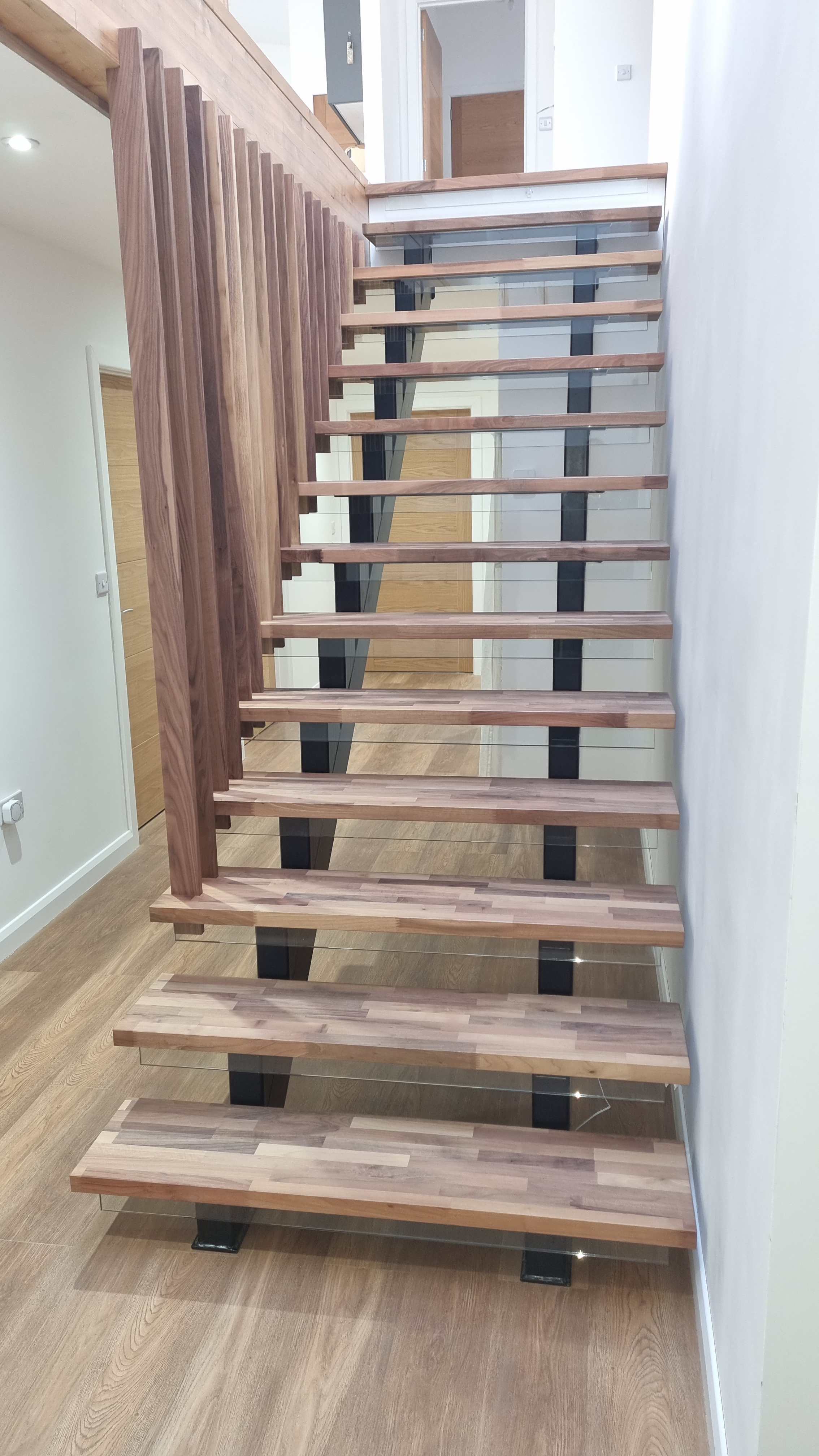

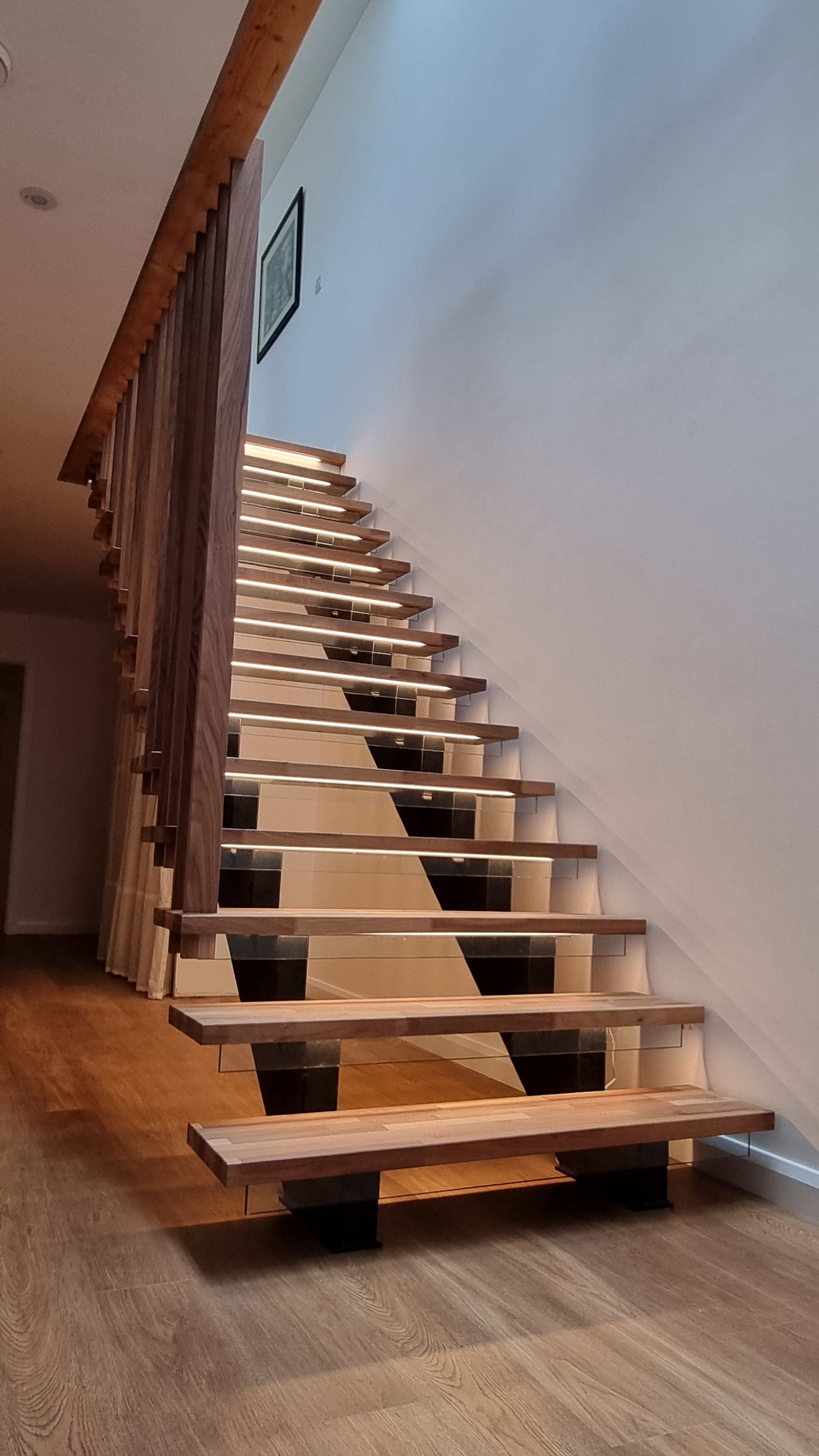

Stairs done
One of the things we paid someone to do for us.
Spines are powder coated. Cabling for lights runs inside the spines. Steps made from walnut kitchen worktops. Spindles are solid walnut. Glass is 10mm toughened from Cornwall Glass.
Why walnut? It goes with the breakfast bar made from the walnut tree we cut down, also made by same person (Principle  Constructions based in Cornwall).
Nice!
Thats the first time I've seen the transparent blocking approach to having an open stair that complies with regs. Be interested how that works out (cleaning, etc).
Handrail to be installed on the right?

No plans for a handrail at this point in time
It's a regs requirement isn't it?
It is (part K). It'll get done sometime before completion signoff 🙂

Looks fab. Well done. Just make sure you coat the timber with something that is UV resistant. Otherwise, in the same way as Mapel turns a bit orange in the sun. Your Walnut will "Fade to Grey" as the song said.
Can I ask how you lifted the stairs.  I’ve got a steel mono spine and, on my own trying to work out methods to lift and manoeuvre.
Three men and a rope. The two spines are separate pieces.
Osmo oiled 👍🏻

How much of that is the wood? Walnut is pricey, but so is the cost of getting someone to mill down your own tree. Curious how that stacks up?
@-rick-, note that none of the milled wood is in the staircase, thats just in the breakfast bar.
The wood for the staircase was about £2200
Can you look up skirts from under the stairs ? . Asking for a friend
Look carefully under the second step. Haven't hidden the wire to the camera yet 🙂
