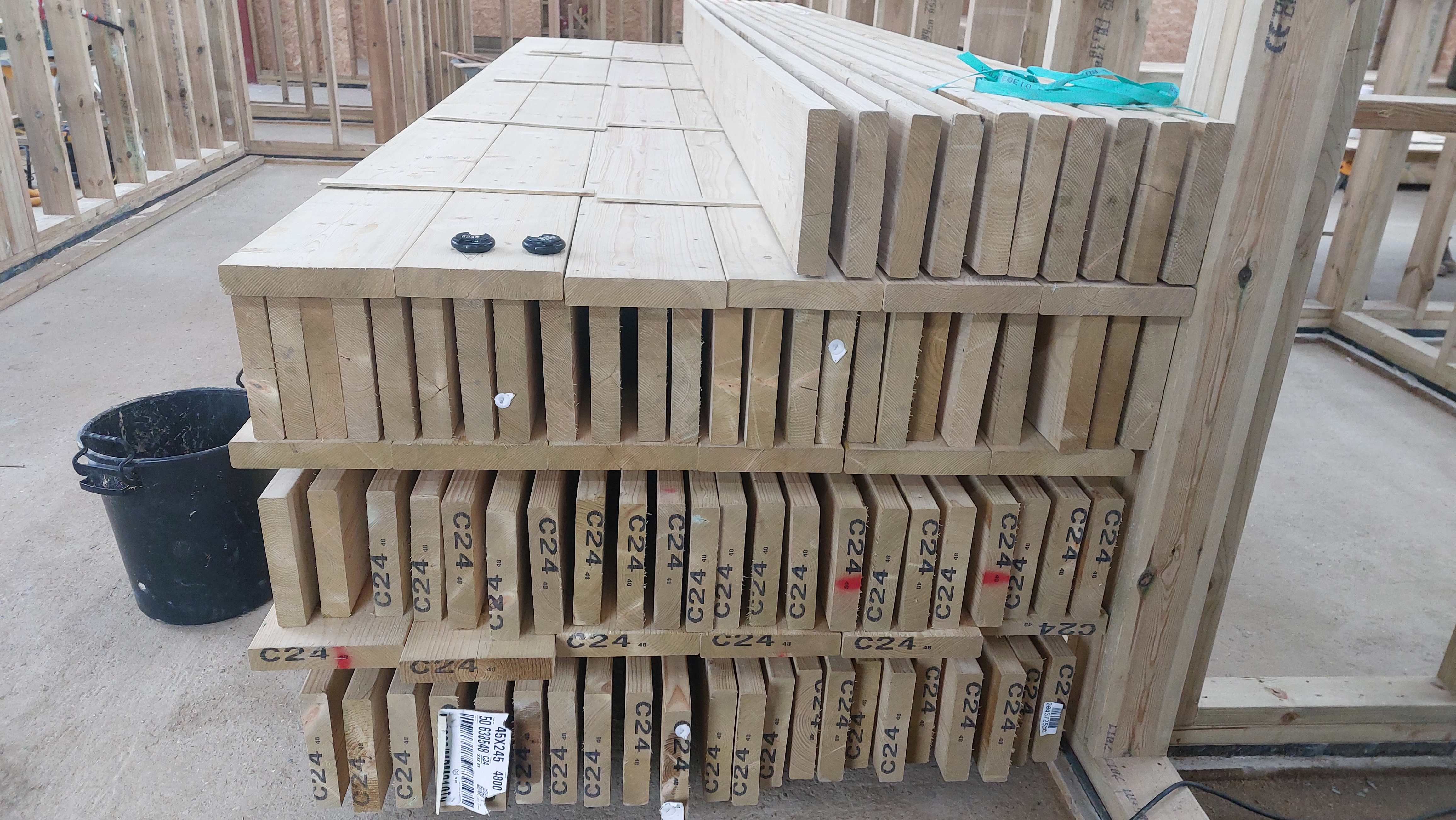

stu w Posted January 25 Posted January 25 I purchased all my c24 treated timbers to carry out my build a year before in required it .4x2, 6x2 8x2 and 9x2 Broke all the packs down and stick stripped every row, when build time come it was all around 12-14% and straight as a die. Not had a single bit of movement in the build. Is it practical, not really, is it time consuming yes, then having thousands of pounds of timber stored, was it worth it 100% 1 1
