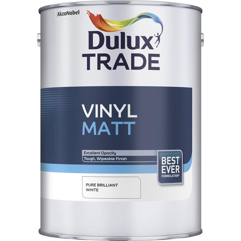

Onoff Posted July 3, 2018 Author Share Posted July 3, 2018 If I could get this stuff foc, would it be any good in this application? Could it be used, thinned down as a mist coat too? Any "againsts"? https://www.toolstation.com/shop/p45146? Link to comment Share on other sites More sharing options...
bassanclan Posted July 3, 2018 Share Posted July 3, 2018 It would be good as a final coat, but I think the vinyl might not be ideal for the initial mist coat. You can get something very cheap as a mist coat, you might need two coats, but you're aheadofscheduleon the projectand can affordtosit and watch paint dry Link to comment Share on other sites More sharing options...

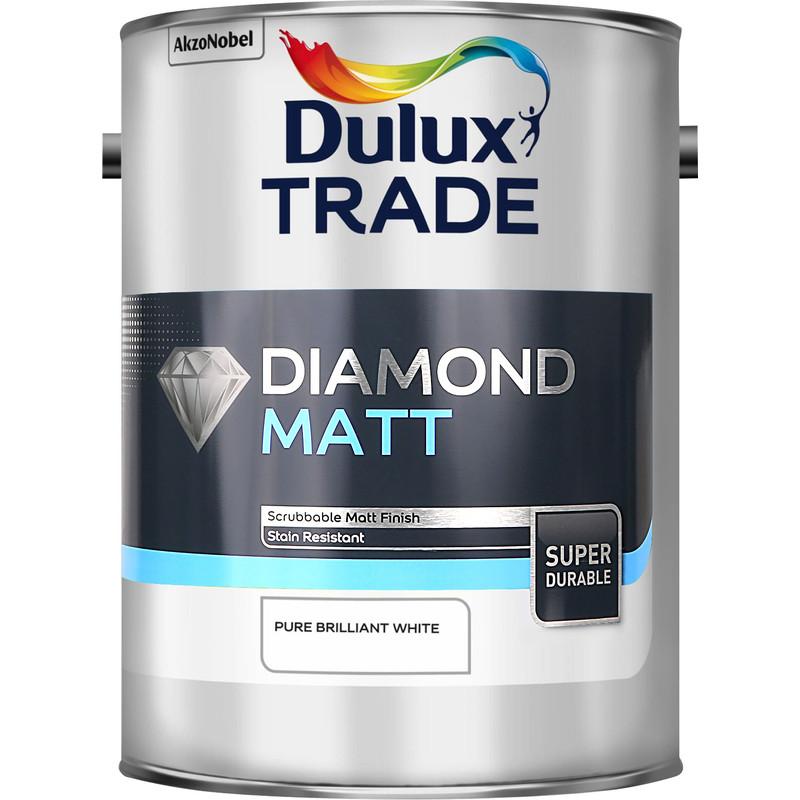

Onoff Posted July 5, 2018 Author Share Posted July 5, 2018 Once again I have to bow to the collective wisdom on here! Never done a mist coat before so a few eye openers. First, Leyland Trade Super Leytex High Opacity Matt Emulsion is GREAT! I applied it thinned with 20% water and used a short pile radiator roller. Boy does it dry quick! The plaster just sucks it in just as said here that it would. I found I needed to get it on real quick or thick streaks would dry that were hard to roller flat. Generally though it looks magic imo, almost like a finish coat. The roller application has shown some low spots. What I'm thinking is to do a second mist coat as the paint has clear filler like qualities. I reckon if I did I'd lose a few more of these minor lows and just have the odd deeper low to fill. Any againsts if I do so? Also should the second mist coat be thinned again? Lastly SWMBO (who's the painter in the house generally and favours Crown paint) informs me tonight she wants a satin finish on the ceiling as matt is too dull! Any suggestions, can't seem to find a Dulux Diamond Satin White. Cheers Link to comment Share on other sites More sharing options...

Onoff Posted July 6, 2018 Author Share Posted July 6, 2018 7 hours ago, newhome said: Go for matt on the ceiling. Why do you want it shiny? I DON'T want it shiny! Her first comment was she wanted to gloss the ceiling ffs. She reckons matt looks too dull....??? No shit! I get the feeling that as it looks new for longer, the Dulux Diamond Matt recommended here wilI look really good. Maybe it's her pikey genes coming through and the attraction to shiny things? Another gem on the horizon, she didn't want a lit mirror. Now realises you'll be in your own shadow at the sink! :) She tried turning it saying "I thought WE didn't want a lit mirror as they're expensive?". With the money spent so far it'll hardly break the bank! "No dear, you wanted a plain flat mirror hence my buying the f***ing demister pad to go on the back!" Selective memory the fairer sex! It's not like the cooking or the other is going to get any better here after 26 years so I reckon Diamond and be damned! Worst case she doesn't speak to me for a week. Best case two weeks / a month! 1 Link to comment Share on other sites More sharing options...
bassanclan Posted July 6, 2018 Share Posted July 6, 2018 Vinyl silk would give a sheen Link to comment Share on other sites More sharing options...
Onoff Posted July 6, 2018 Author Share Posted July 6, 2018 21 minutes ago, bassanclan said: Vinyl silk would give a sheen This is what's going to happen... A quick Avery label on the pc saying "SATIN" gets stuck over where it says MATT. Then a bit of silver tape where it says "SCRUBBABLE MATT FINISH"... 1 Link to comment Share on other sites More sharing options...
newhome Posted July 6, 2018 Share Posted July 6, 2018 2 minutes ago, Onoff said: A quick Avery label on the pc saying "SATIN" gets stuck over where it says MATT. Then a bit of silver tape where it says "SCRUBBABLE MATT FINISH"... Just pour it in a tin with the labelling of her dreams Link to comment Share on other sites More sharing options...
Onoff Posted July 6, 2018 Author Share Posted July 6, 2018 Just now, newhome said: Just pour it in a tin with the labelling of her dreams If I had one I would! Link to comment Share on other sites More sharing options...
