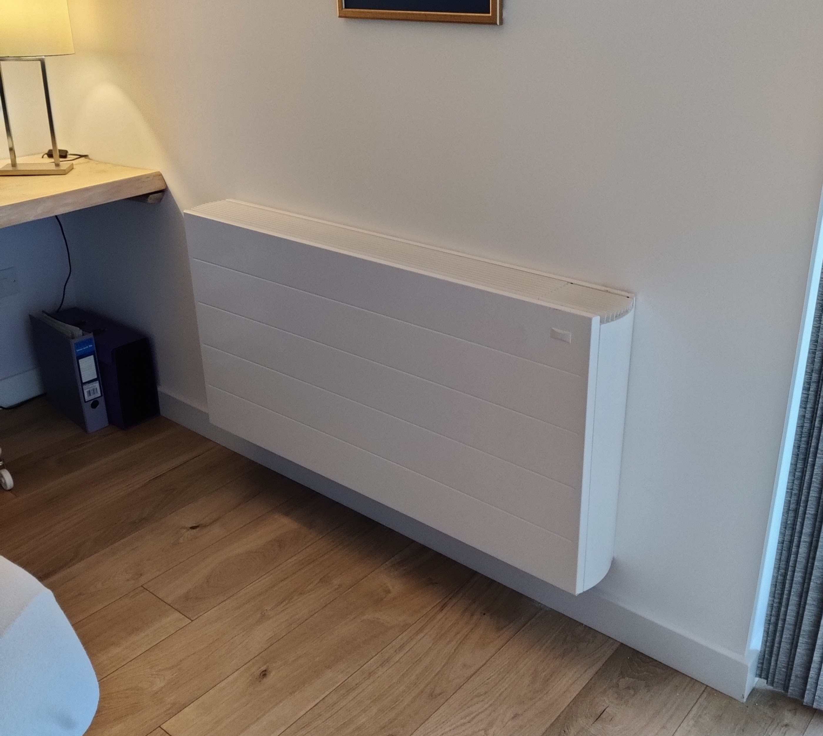

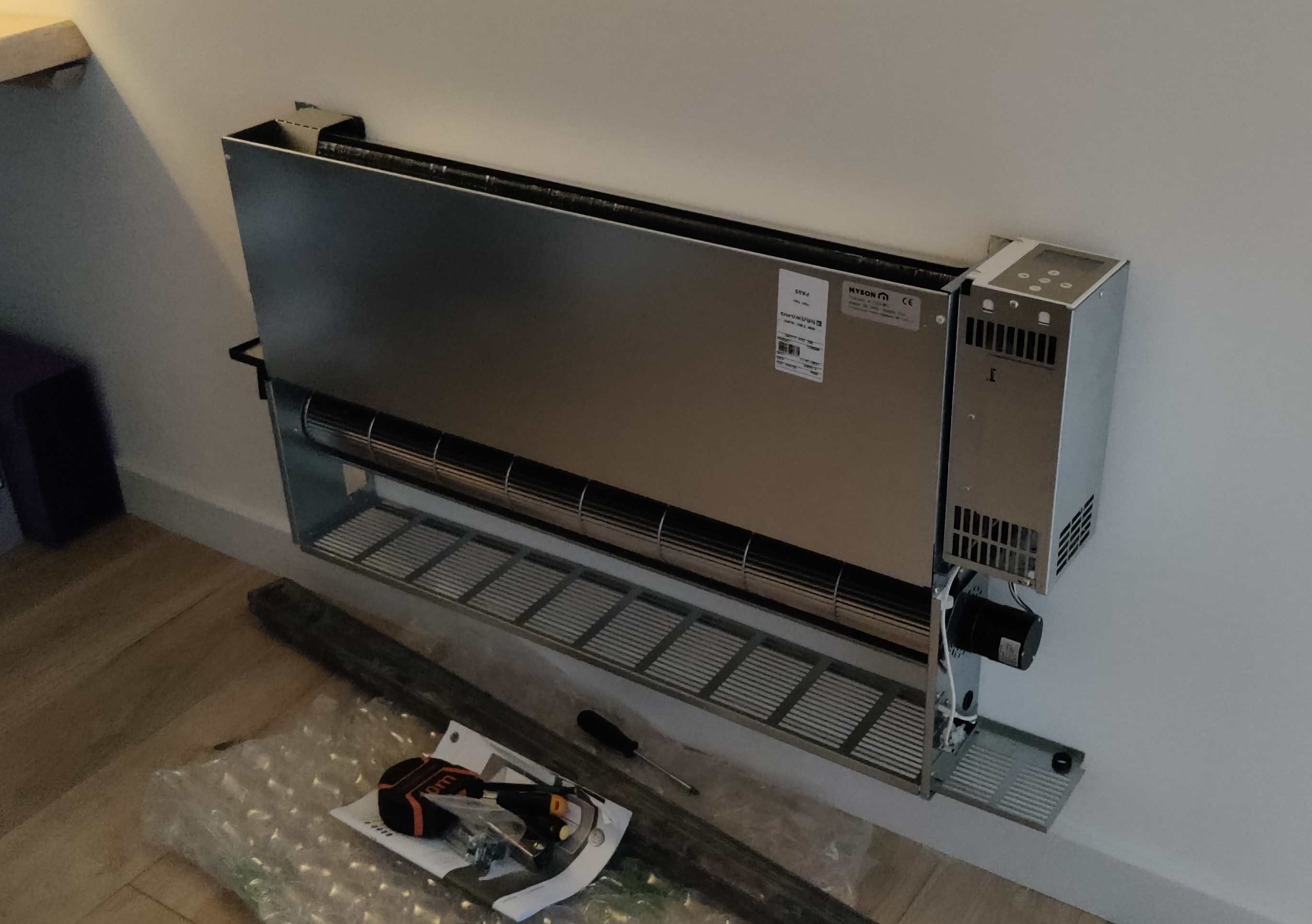

https://coolenergyshop.com/collections/radiators-fan-coils?srsltid=AfmBOoo2Jwpa28-xTPSwQCmxyskK6onq3GBoEW004T_AV7JvfWtJQvZo
Here are a couple of photos of ours which heats a summer house (a Myson unit). First is the unit without the cover installed, controller is on the right, a finned radiator panel behind the sheet metal and a linear fan below it. It basically modulates the fan speed to maintain a a set room temp. Way smaller than an equivalent radiator.
