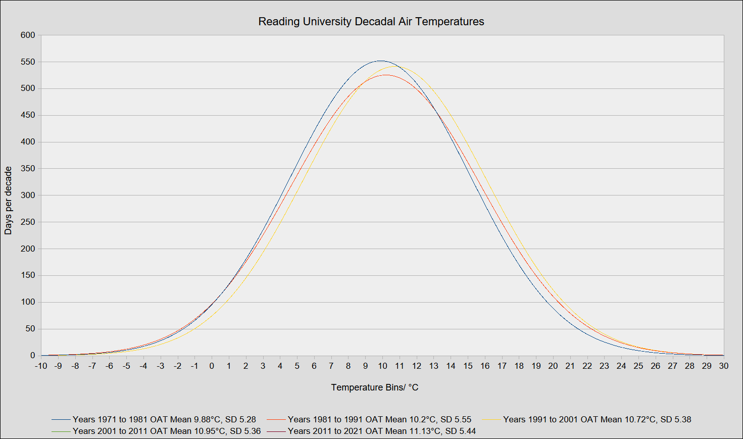

I thought I would have a look at some high quality weather data from Reading University.  It is daily mean air temperatures going back to 01/01/1971.
I split it into decades, so >=1971 to <1981 and so forth.
As air temperatures follow a normal distribution pretty well, I decided to model it from the decadal  means and standard deviations.  While this is not perfect, the fit is pretty good, good enough for calculating the need for heating and cooling.
While this data is only from one place, the same technique can be used with other datasets.
So here is the chart.
The reasons you cannot see two of the lines 2001-2011 and 2011-2020 is because there is not enough difference in the variation to worry about.
But, this is only part of the picture.  When it comes to cooling, generally, anything over 24°C mean daily temperature can cause discomfort.  In the 1971 to 1981 decade, there were 36 days that breached that limit, this jumped to 60 days during the 1980's and has been stead at 64 days since (I have not included the data since 2021).
So basically you can expect the OAT to cause problems for 1 week a year, with probably 4 nights with very excessive temperatures.
It is nice to see that the mean temperature has gone up every decade, which confirms past models.  The standard deviation, which is really the weather, rather than the climate, is always going to be variable, and just mathematically, the bigger the range of number i.e. max temp minus min temp, the greater you would expect the variations to be, which is happening (0.0134/decade).
So the mean air temperature is increasing (in Reading), the variation is getting greater and the number of cooling days is currently constant, things can change.
