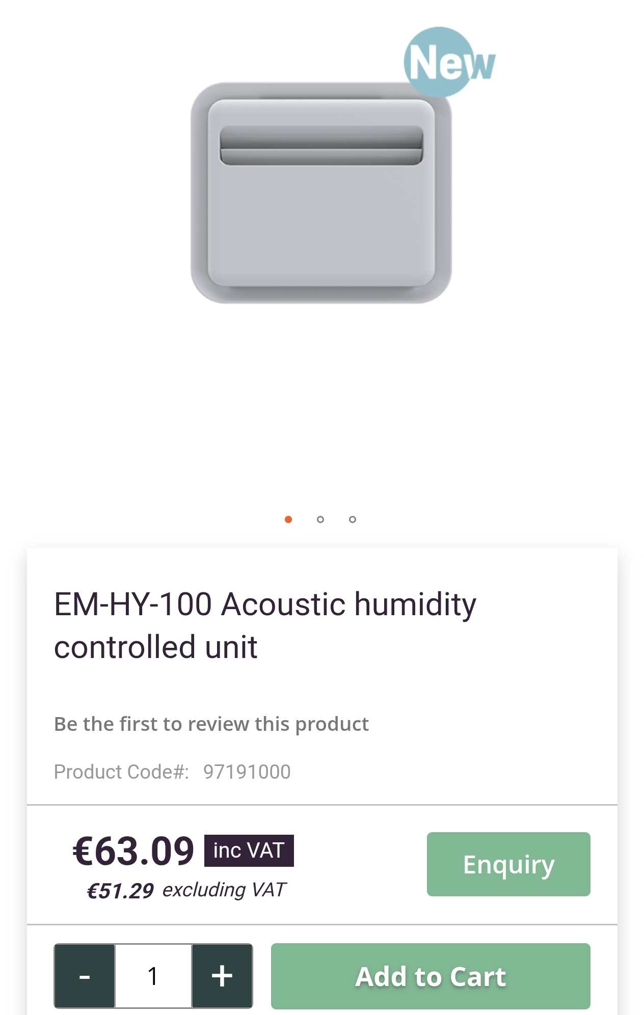

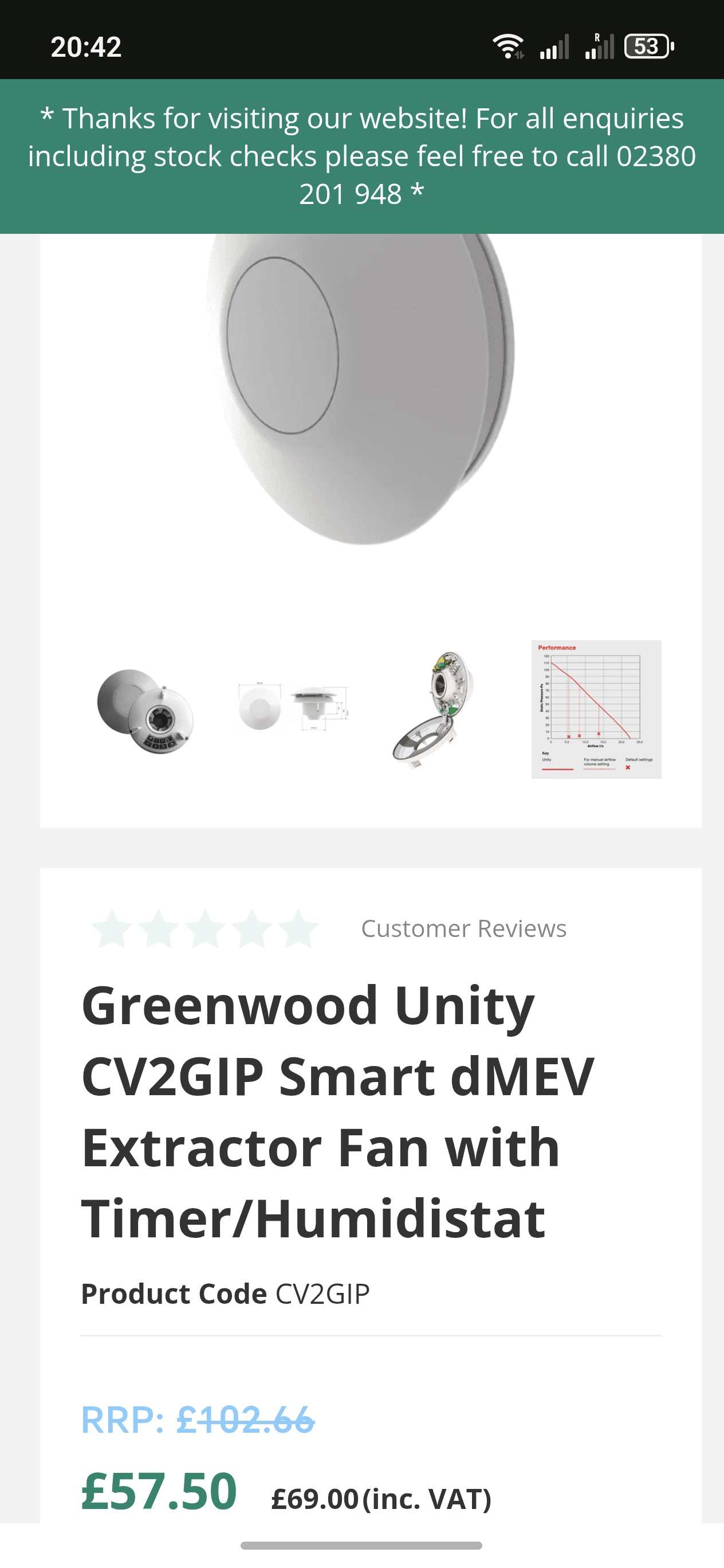

Big Jimbo Posted 17 hours ago Author Posted 17 hours ago 47 minutes ago, Adrian Walker said: You should aim to get a better air leakage of 3. At 1750square foot, it is a compact 4 bedroom, 3 bathroom house. Although i have designed for 5ach, i will aim to be better. However, i don't really have room for the ducting for MVHR, or the actual unit. That and the roof pitch is shallow at 28 degrees. It's also a cold loft space, and i have a height restriction.
JohnMo Posted 17 hours ago Posted 17 hours ago 1 minute ago, Big Jimbo said: Although i have designed for 5ach, i will aim to be better. However, i don't really have room for the ducting for MVHR, or the actual unit I would just a decent dMEV system. 2

Big Jimbo Posted 17 hours ago Author Posted 17 hours ago @Adrian Walker Also, i believe that at below 3 i would be required to fit MVHR. It is a shame but just really not got the space. I will have to have have 6 extractors for all the wet areas. I will have to have a look and consider what my options are on that front.
