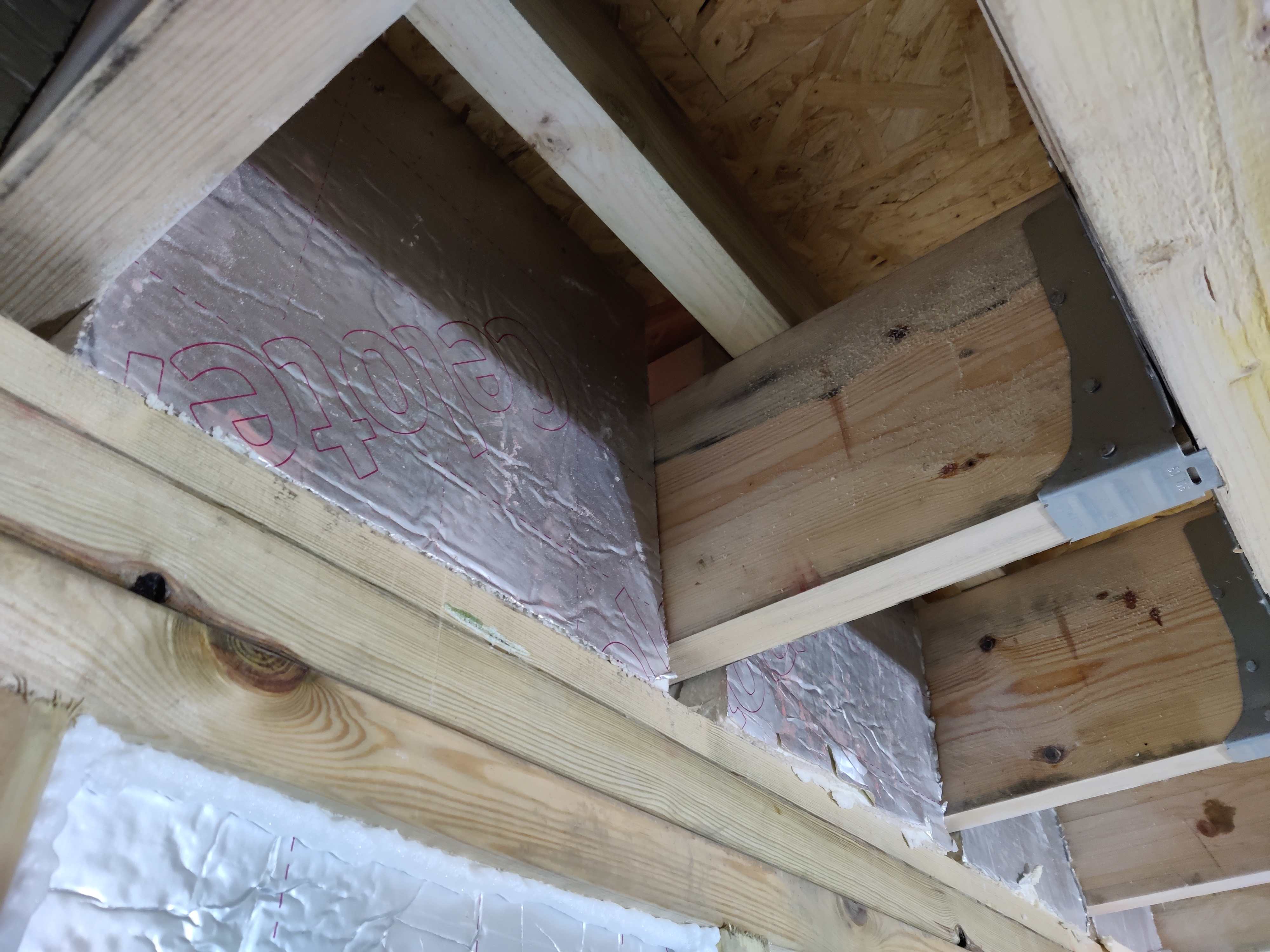

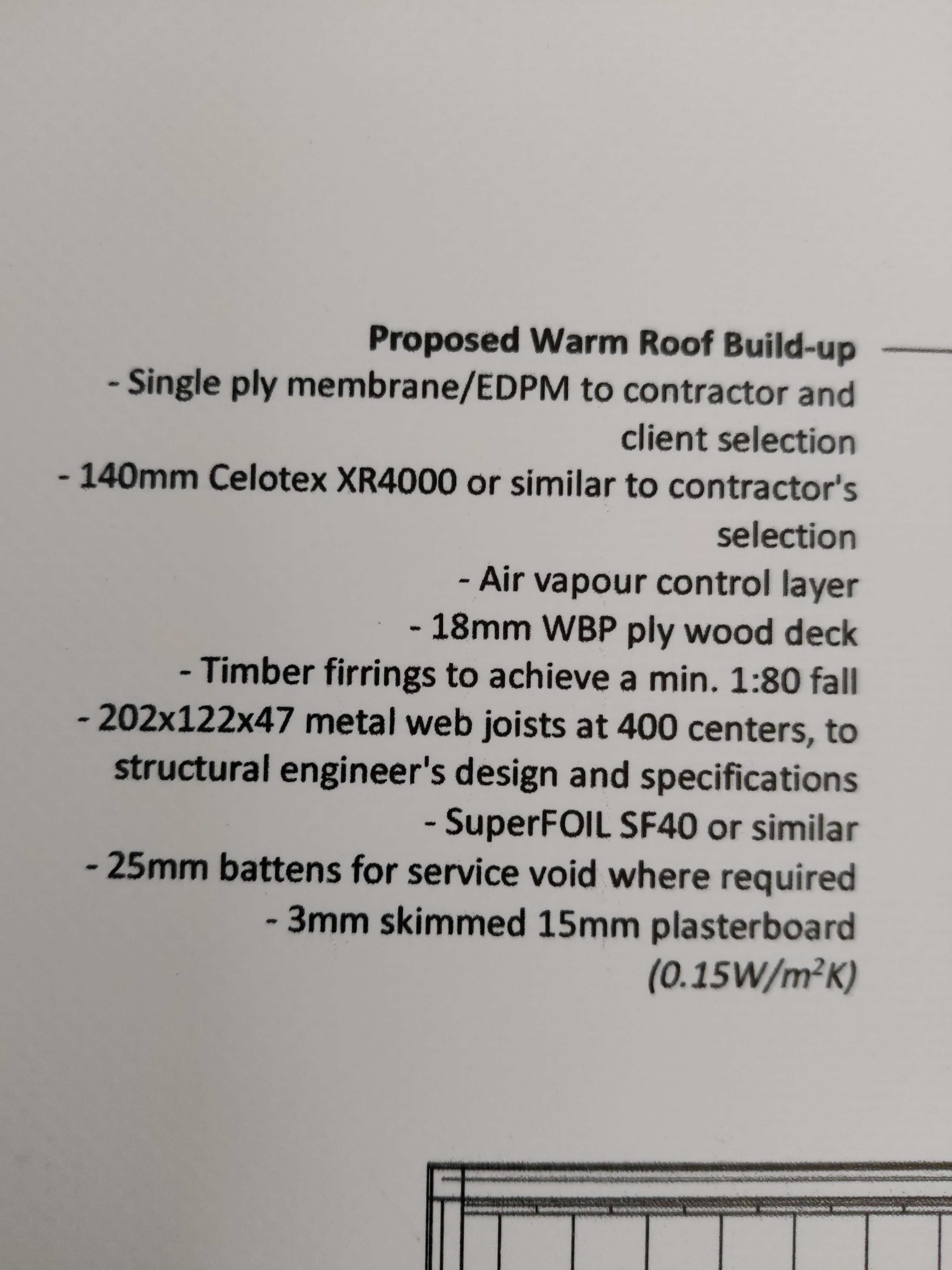

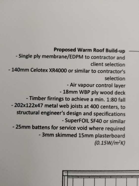

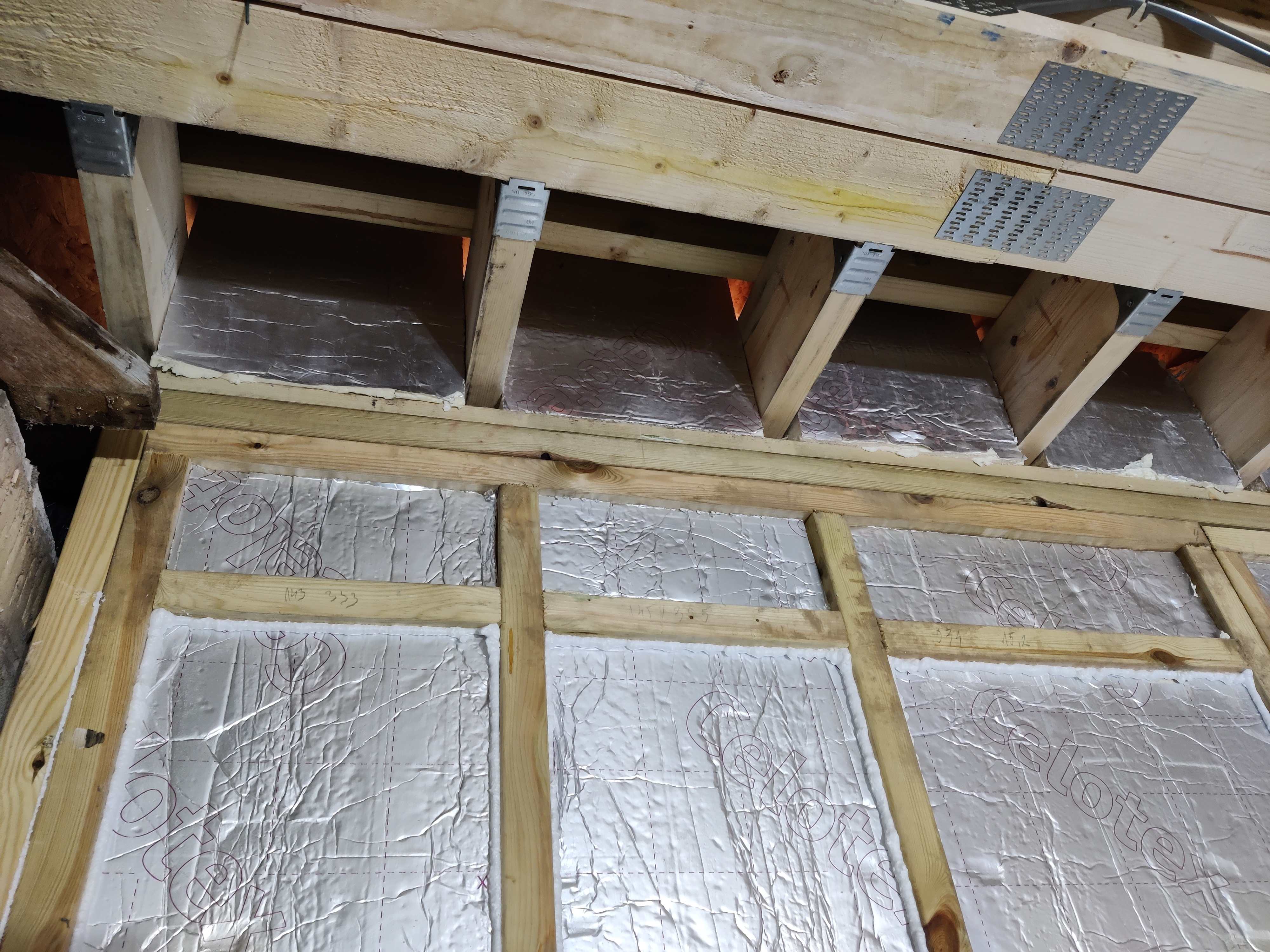

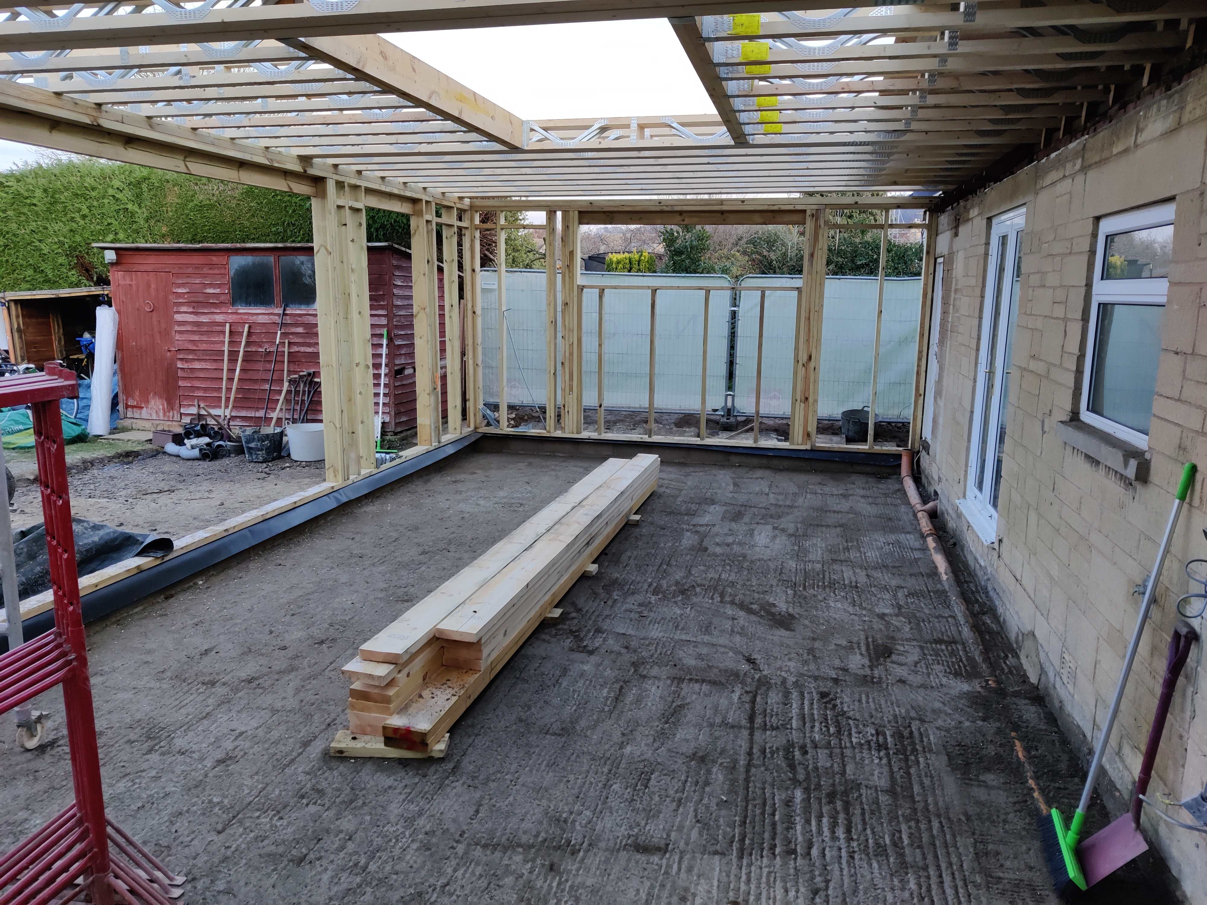

andeebee Posted November 29, 2025 Posted November 29, 2025 I am mid way through an extension and house refurb The extension is a timber frame using a warm roof on pozi joists and I am increasingly worried about the separation of the roof insulation layer from the conditioned space below due to the difficulty in sealing up the gaps between the pj and the top layer of the walls with PIR To further compound the problems, I wanted an overhang around the extension. Whilst the PJ's facilitate this structure naturally on the one face, the two sides are forming the overhang using outriggers Combine the outriggers, packing and the roof fall angle and you can currently fly a drone through some of the gaps between the roof deck and the walls Whilst air tightness could be achieved using a vcl, heat loss from the break in insulation continuation cannot and I don't understand how we have got here Possible solutions I have considered are commercial spray foam sealing from the outside of the roof cassette and the inside or my latest idea to fill the area below the roof deck with blown in insulation. Please share your thoughts and possible solutions
andeebee Posted November 29, 2025 Author Posted November 29, 2025 The gaps around the outriggers are due to added packing required to bring the roof deck level due to the discrepancy from the interface with existing building
Russell griffiths Posted November 30, 2025 Posted November 30, 2025 What’s holding up the top plates over that large opening, there’s not much of a lintel on show unless they have something on the outside.
JohnMo Posted November 30, 2025 Posted November 30, 2025 So basically all the gaps you see need to be filled. I would look to use a good expanding foam. Some of the vertical filler pieces of PIR, don't look to butt up against the OSB roof cover. All PIR needs to be hard up against that.
ProDave Posted November 30, 2025 Posted November 30, 2025 15 minutes ago, JohnMo said: So basically all the gaps you see need to be filled. I would look to use a good expanding foam. Some of the vertical filler pieces of PIR, don't look to butt up against the OSB roof cover. All PIR needs to be hard up against that. And to add to that. Once ALL the bits of PIR closing the gap are the right size (they reach the OSB layer) AND are properly sealed so there are NO gaps for air to pass through, that will have got you reasonably air tight so no fear of cold draughts coming in from outside, then you need to go outside and add as much more insulation as you can behind those relatively thin bits of PIR. It is this sort of detail that needs to be got right NOW while you can get at everything. There have been at least 2 threads on here recently where the builders have been left to it and done a shoddy job and cold air is getting in and it can be a VERY invasive job to fix it later if not done properly now. 3
Big Jimbo Posted November 30, 2025 Posted November 30, 2025 Bad eaves detail, with a warm roof. How many times do we see that.
ProDave Posted November 30, 2025 Posted November 30, 2025 10 minutes ago, Big Jimbo said: Bad eaves detail, with a warm roof. How many times do we see that. Yes it's shocking. Put a well insulated roof on top of a well insulated wall, but detail it so badly that cold air just gets in and negates it. Shocking that so many builders just do not understand that.
Nickfromwales Posted November 30, 2025 Posted November 30, 2025 It’ll also be an acoustically poor solution, so with moderate to hard rain the sound will be notable to the room interior. A blown-in insulation would be the very best solution for weaving around the metal webs and those associated impossible to get to gaps, and give a huge boost to sound deadening. As @ProDave says, this is something you need to stop all wires with and get a solution to, before moving any further forwards. Just had Gordon Lewis on site pumping my current clients roof with Warmcell (blown-in cellulose) and he’s done a fantastic job getting every nook and cranny packed full of the good stuff. 👌 Abandon the rigid insulation in the roof, and preserve that for the vertical walls only. Arcitect will need to rerun the intersitial condensation analysis before pulling any trigger. Airtightness is moot, the original house will underperform most likely, just all about draft proofing at this point; plus obvs managing repeat cold bridging, and maxing out on the (properly installed) insulation.

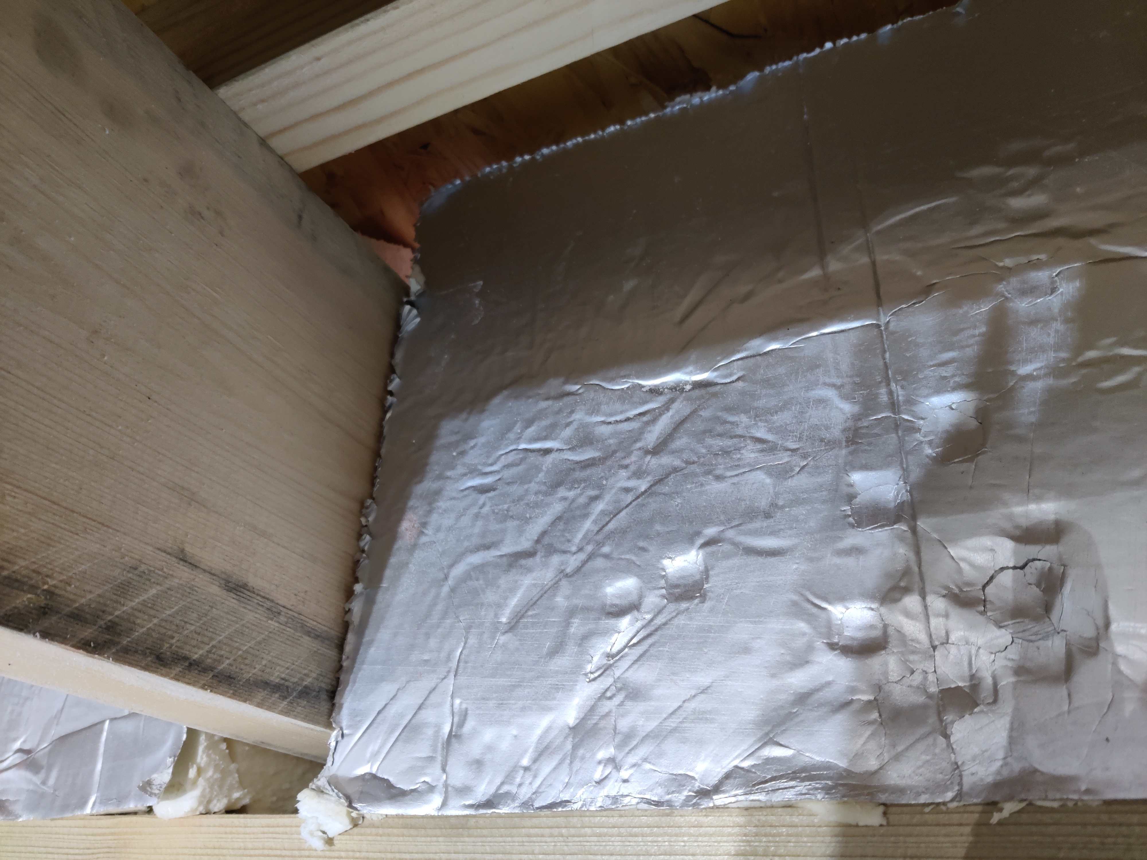

andeebee Posted December 15, 2025 Author Posted December 15, 2025 Thanks to all the above comments. I have spent the last few weeks trying to fill the gaps left by the bad fitting warm roof, using PIR cut up into blocks and foaming them in I used a airtight foam on the inside perimeter and a large area 'coverage' based foam on the outside. Still not sure I have got all the gaps, due to the now inaccessible cavities between the outriggers and the roof edge Had many sleepless nights adding up all the area of the blocks I have cut, to literally cover the daylight coming in. Had this not been addressed, at least partially by my efforts, it would have been like leaving a window open continuously. I think the best way to have installed this would have been to fill the gaps between the outriggers, prior to the installation of the roof section, as you would have far more access. The roof could have then been built onto a continuous layer

Mr Punter Posted December 15, 2025 Posted December 15, 2025 I would be filling the awkward gaps with decent mineral wool. It is far easier to use than cutting bits of PIR. Fill the whole void where you have the outriggers and any gaps where new meets old. 1
Marvin Posted December 15, 2025 Posted December 15, 2025 When I did our side extension flat roof connection to the eves side of the bungalow I used OSB vertically all the way up, in between the roof joists, sealed the gaps with mastic and then put plastic over the OSB and sealed the edges where necessary before insulating, to protect the void. When PIR insulating I foamed every gap that was between any timber and the PIR.
andeebee Posted 14 hours ago Author Posted 14 hours ago Im still filling these areas. I have 9 to go! The area where the extension meets the house is the worst as the roof joists are also in the mix. I need to fill these areas as the warm roof would meet a ventilated attic space if I dont, thus nullifying my warm roof Having spent considerable time doing this horrible job in the evenings, I have been musing over what could have been done to make it better and the conclusion I came up with it the PIR and foam blocking up should have been done before any OSB sheeting went on top of the newly erected timber walls. This could have been made to be level with the pozi-joists and even a bed of foam of silicone added to the perimeter before the OSB was laid 1
