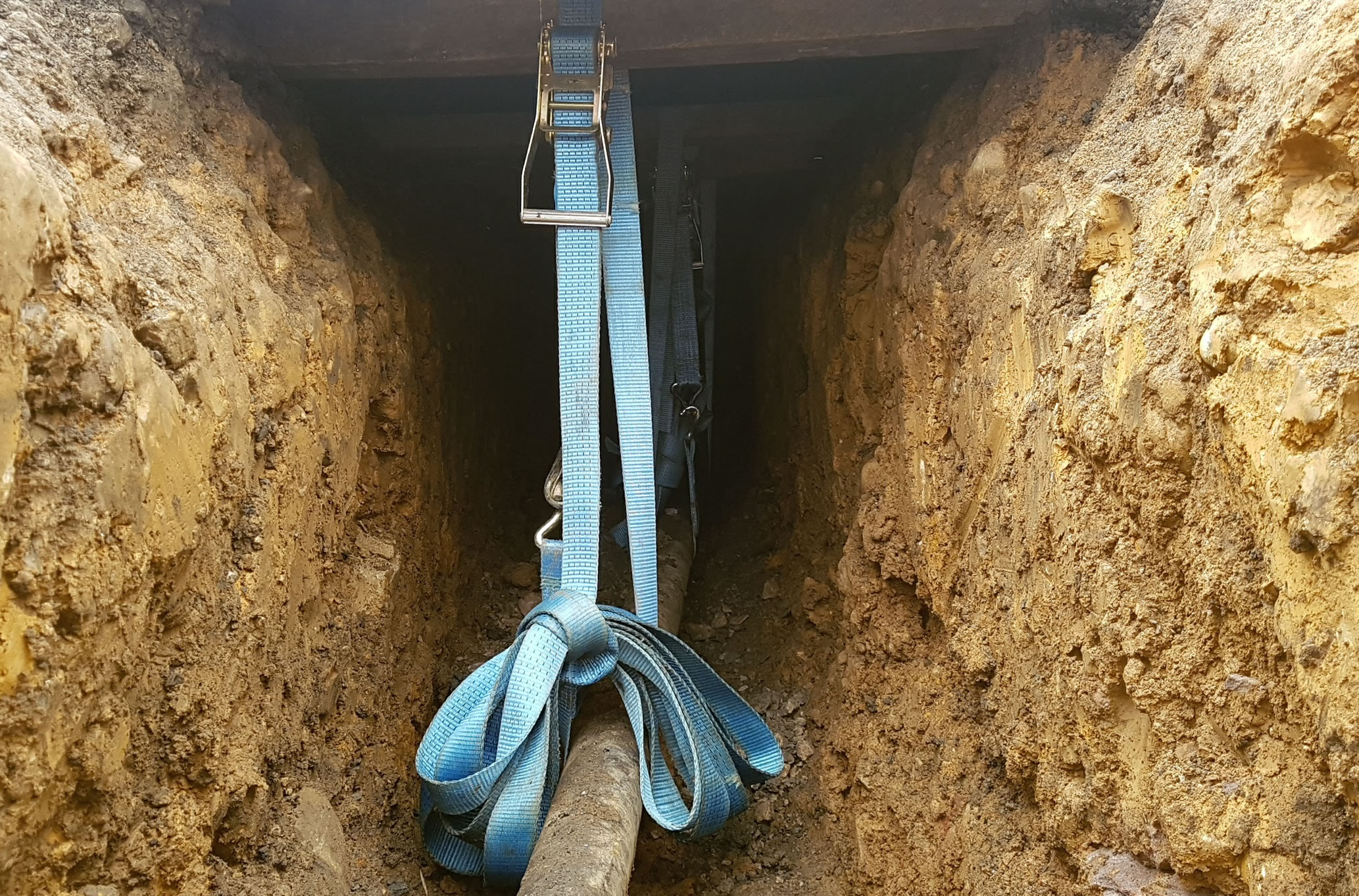

Mr Punter Posted January 16, 2018 Posted January 16, 2018 This is one for your engineer. We have just done a project which cantilevers over a retaining wall and a river. The engineer designed a piled foundation with cantilevered ground beams so that the piling rig could still operate within a safe distance from the retaining wall.

ToughButterCup Posted January 20, 2018 Posted January 20, 2018 19 hours ago, Adamantium said: [...] FYI sewer I am avoiding is 860mm across, not sure it's analagous to the example above. [...] I should perhaps have explained more clearly that it is possible to pile close to underground assets provided that the asset is insulated from the vibration by an air gap. I don't think that the diameter of (in this case) the pipe makes a difference to that principle. If the costs of CFA piling is an issue, then it might be possible to persuade your authority to allow a different method to be used if the sewer were to be suitably insulated from vibration. Just a thought......
