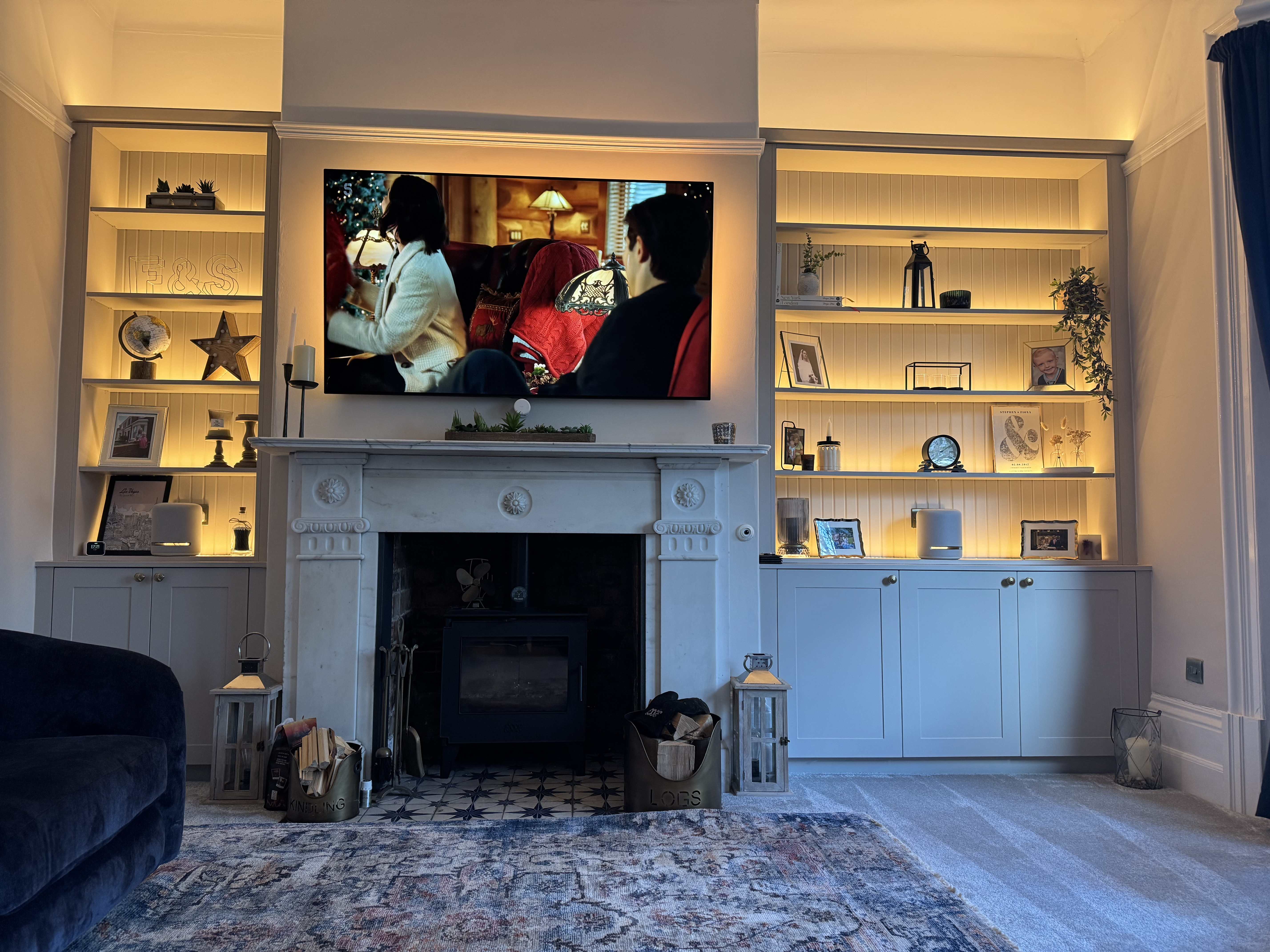

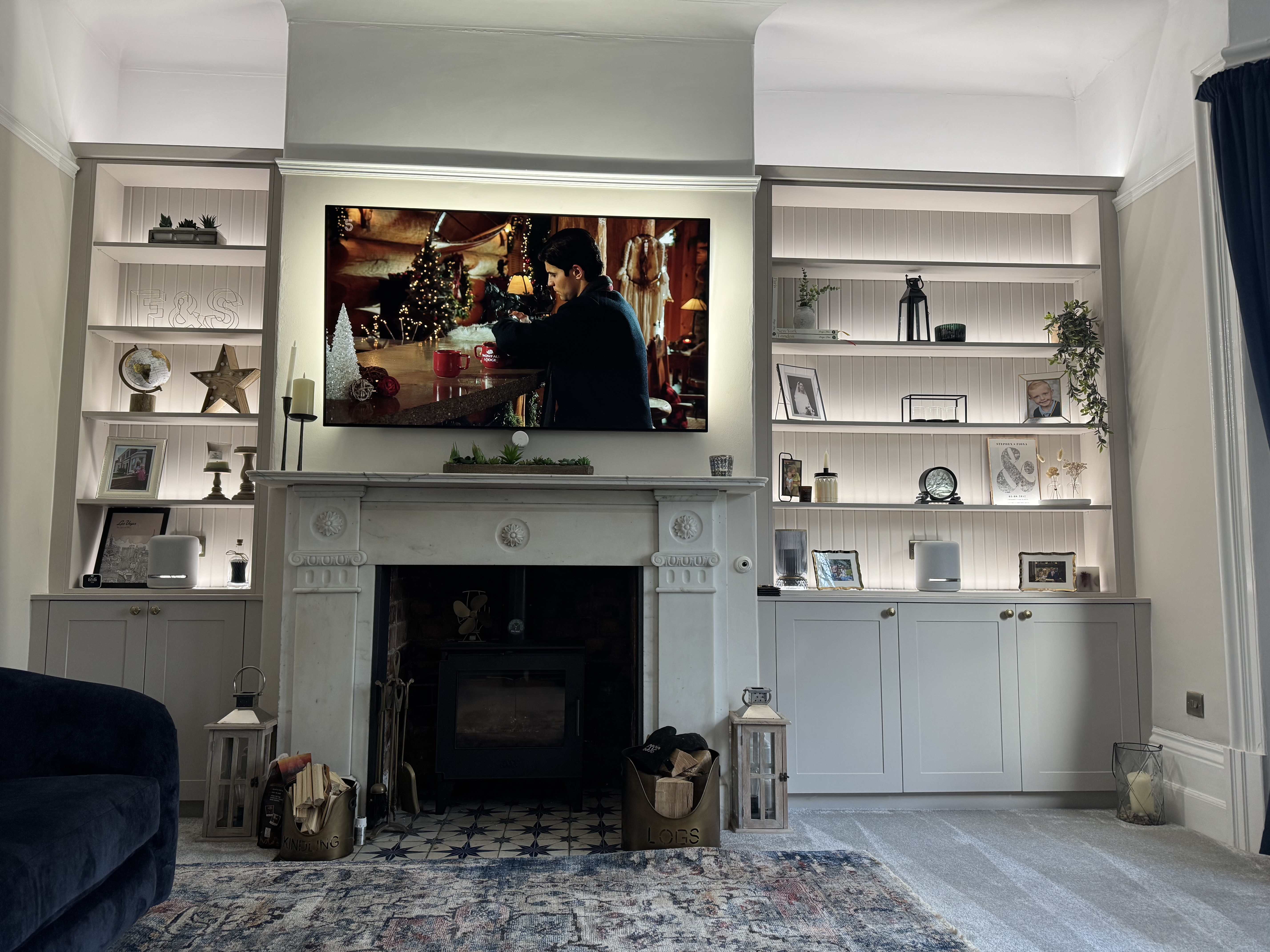

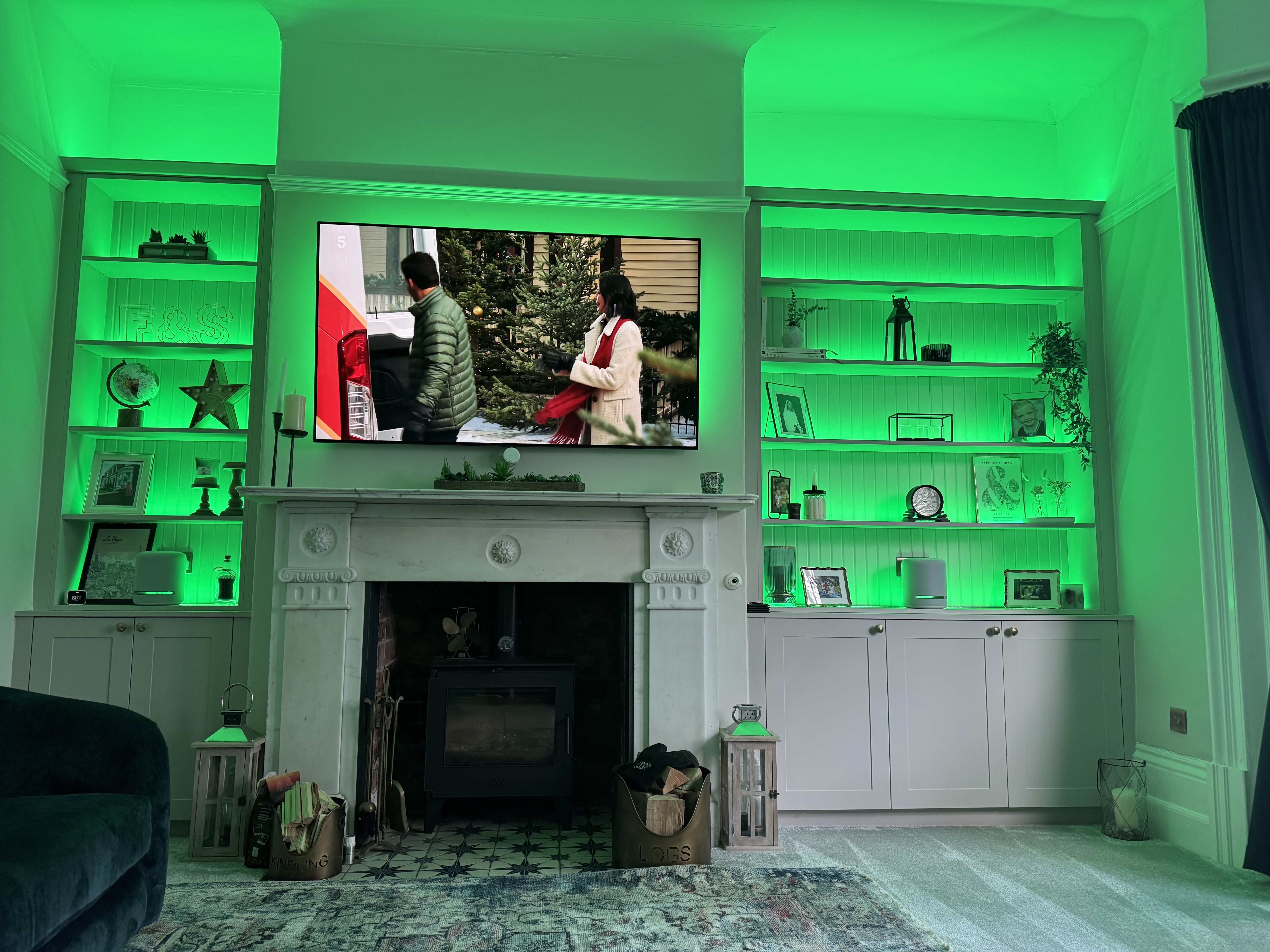

Russell griffiths Posted November 15 Posted November 15 What do you want to know, I’ve got about 12m of it in a kitchen fitted in a small aluminium track. all works from an app on the I pad and switched from the wall so the last setting is remembered. the LGBGT multi colour ones are ridiculously expensive compared to them. 1 1
Alan Ambrose Posted November 15 Author Posted November 15 @Russell griffiths - do you actually change the colour much and/or do you have it on a schedule?
Russell griffiths Posted November 15 Posted November 15 2 hours ago, Alan Ambrose said: @Russell griffiths - do you actually change the colour much and/or do you have it on a schedule? The white ones we don’t alter much, chilled out mellow white in all the glass cabinets and on the ornaments. the RGB ones we have we mess with loads more, but that’s probably just the novelty, we haven’t moved in yet.
