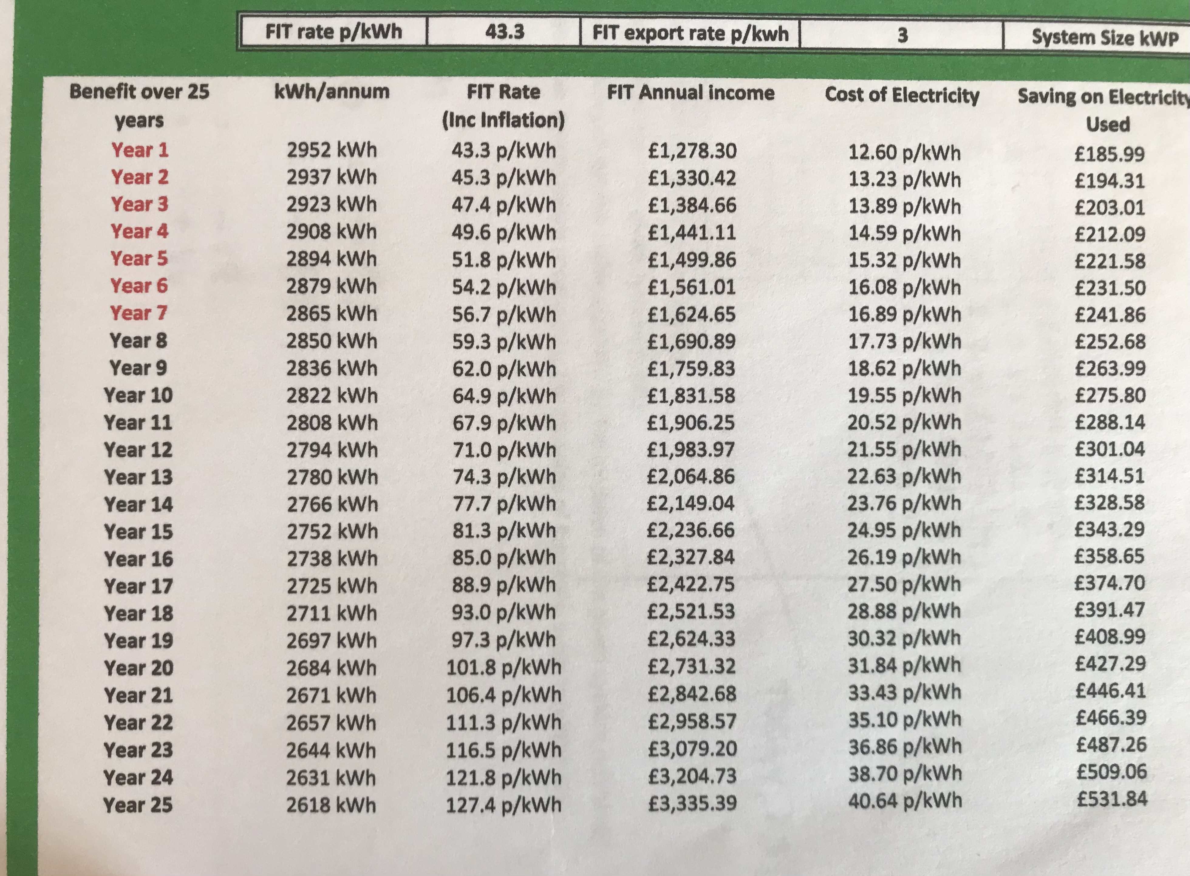

Nestor Posted November 18, 2025 Posted November 18, 2025 2 options, CPI or temporary freeze until CPI aligns with RPI, mid 2030's. Over 800,000 homes had FiT installations. Email address: RO@energysecurity.gov.uk Payback calculations below, November 2011.
Dillsue Posted November 18, 2025 Posted November 18, 2025 From the OFGEM guidance for FIT generators, section 5.4- "Generation and export tariffs are also adjusted by the percentage increase or decrease in the Retail Price Index (RPI) over the 12-month period ending on 31 December of the previous year every April, in accordance with FIT legislation." The document is guidance but it does say that the statement is in accordance with FIT legislation?? With the advent of PV diverters and battery storage I could see them varying the deemed export % rate which I beleive the secretary of state can change within the legislation but that likely amounts to peanuts in the grand scale of the countries finances??
