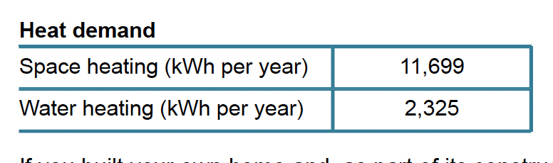

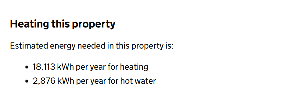

Posted
2 hours ago, Roger440 said:
My point was EPC bears little relation or indication of of actual energy use.
As an example our EPC stated below but last 5 years it has been an average of 3000 kWh for both DHW and Heating.image.png.37249f012a2bf7e637dbbda1047e93ae.png
  • Like 1
Posted
Are you using a heat pump?
Posted (edited)
Good point, yes,
Last year consumed was 2998kWh and delivered 8581kWh.
This is from the Mitsubishi readout which seems quite accurate as have an Elster and Shelly meter with very similar totals.
