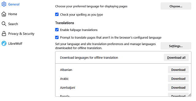

I wish BH had a spell checker. I just can't be arsed checking my dyslexia bit and spelling when I'm writing about stuff as a hobby.
For all, my grammer and spelling may be a bit off when I'm off duty.. but neglect what I'm saying at your peril.
Edited by Gus Potter
Most web browsers have them built in
