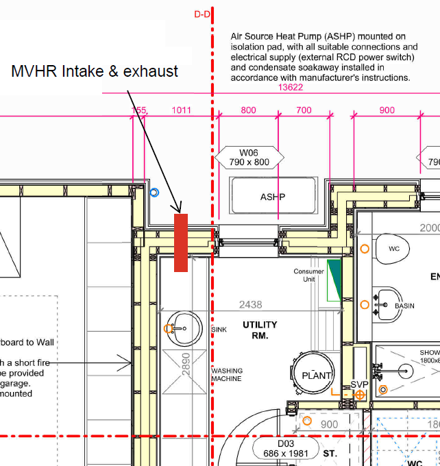

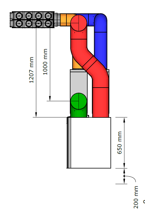

Dunc Posted September 23, 2025 Posted September 23, 2025 There are several threads which discuss the loation of MVHR intake and exhaust ducts relative to eachother and/or ASHPs but I haven't found an example of a case similar to mine so would appreciate advice: The ASHP and proposed MVHR intake/exhause are set in a small alcove, about 600mm deep. The ASHP will be stood off both walls at least 200mm. MVHR intake is proposed at ~2000mm above ground level, so about 1000mm above the ASHP. Any risk that the ASHP could create a cold microclimate due to the alcove whcih would adversely affect the MVHR?
Andehh Posted September 23, 2025 Posted September 23, 2025 There is probably a reasonable risk, especially no wind days. I do find our ASHP really kicks out some "microclimate conditions" when working in the immediate vicinity of a few sqm. Possible angled vents on MVHR facing opposite direction to ashp?
Nickfromwales Posted September 23, 2025 Posted September 23, 2025 Do you have posi joists? If so you can redirect the intake and exhaust, or just the intake, to be further away.
saveasteading Posted September 23, 2025 Posted September 23, 2025 It's all rather close together, including the heat pump. Will any of the exhaust air be drawn back into the ventilation? Probably, so not ideal, and a bit inefficient. Likewise the ashp is in a recess, so draws in ambient air from a limited area, so is more likely to draw back its own expelled (cold) air, and thus not be totally efficient. Is there a reason it can't be further from the wall?
jack Posted September 24, 2025 Posted September 24, 2025 14 hours ago, Dunc said: The ASHP and proposed MVHR intake/exhause are set in a small alcove, about 600mm deep. The ASHP will be stood off both walls at least 200mm. 200 mm seems small. Have you checked your ASHP installation manual? I have a very low capacity ASHP (5 kW) and I believe the minimum spacing from the wall for that was 300 or 400 mm.
JohnMo Posted September 24, 2025 Posted September 24, 2025 Mine is also 400mm from walls at back and side and 500mm for the maintenance access side. So that looks like it needs fixing The other thing I would change is the MVHR in out arrangements, would installed a combined flow in extract out grille and position as high up the wall as possible. Then both elements of the MVHR can have a good distance from the ASHP Grille such as this https://www.paulheatrecovery.co.uk/product/200mm-directional-external-combi-grille-for-mvhr-black/

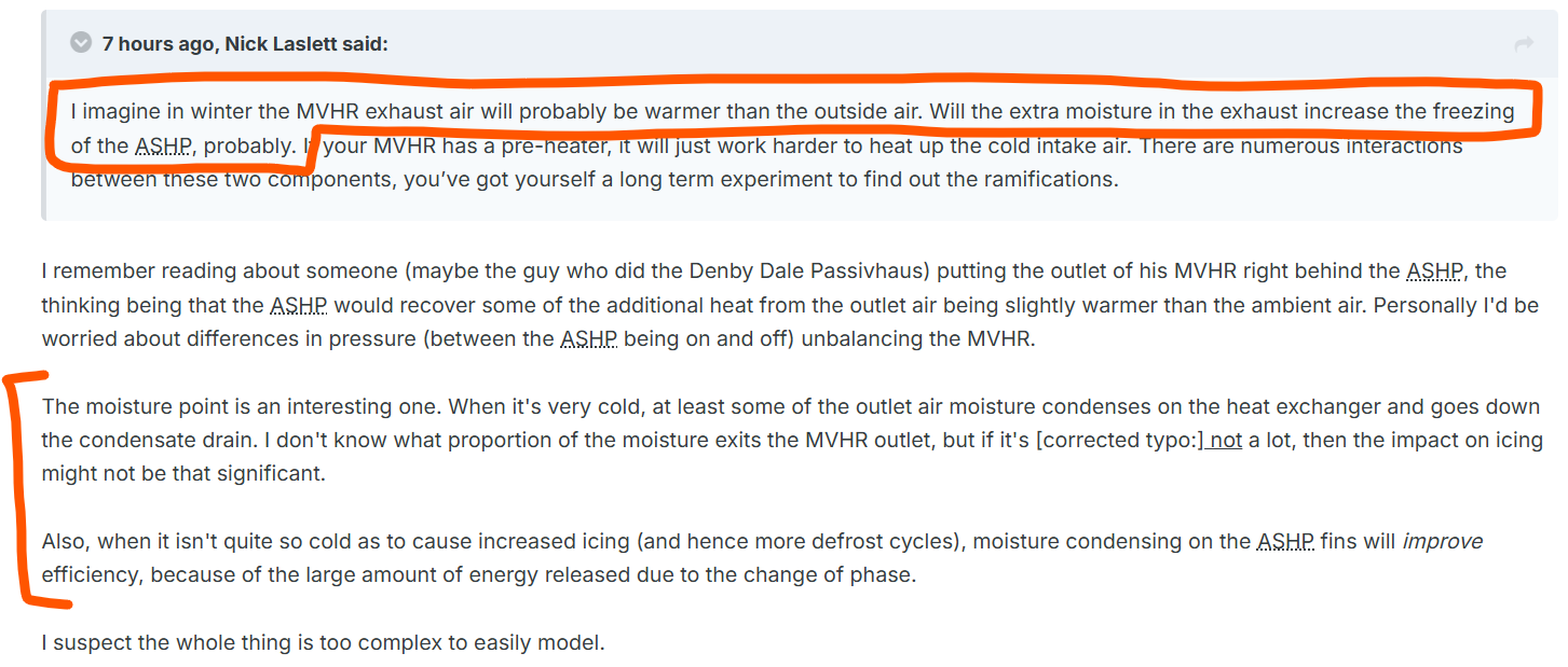

Nick Laslett Posted September 24, 2025 Posted September 24, 2025 (edited) Hello @Dunc, I feel that the short answer, is don’t worry too much about it. Does it follow best practice, no. Will there be some additional inefficiencies in the MVHR and ASHP during the two short periods when we have more extreme weather, probably. When an ASHP is going full power to heat a house, when it is -2° outside, it does create a lot of very cold air. I imagine in winter the MVHR exhaust air will probably be warmer than the outside air. Will the extra moisture in the exhaust increase the freezing of the ASHP, probably. If your MVHR has a pre-heater, it will just work harder to heat up the cold intake air. There are numerous interactions between these two components, you’ve got yourself a long term experiment to find out the ramifications. I’ve made plenty of compromises/cock-ups on my build. Don’t beat yourself up too much on this one. *Edit. You should endeavour to put your best efforts into getting as efficient install of an ASHP and MVHR, within the constraints of your build. My curiosity got the better of me, too interested in the experiment results in 3 years time, to see how these two components interact in this situation. Edited September 24, 2025 by Nick Laslett 1

Nestor Posted September 24, 2025 Posted September 24, 2025 What is the distance between the supply and extract of the MVHR, mine are 2 metres apart with the extract above the supply. Would move it to another wall or 2 - 3 metres above ASHP, if possible.
SteamyTea Posted September 24, 2025 Posted September 24, 2025 1 tonne of air dropped in temperature by 3.6°C, had diminished in energy by 1 kWh. This is a power of 1 kW. Air has a density of around 1.2 kg/m3. So a tonne has a volume of around 125 m3. Assuming an air mixing ratio of 10:1 between the ASHP outlet and the MVHR, that will be 100W difference (2.4 kWh/day). In reality, I suspect that there is so much turbulent mixing from the relatively fast moving air that the difference is closer to 100:1, so 10W (0.24 kWh/day). So not worth worrying about, fit one less downlighter. Those that have both MVHR and an ASHP could help clear this up by taking some temperature readings, one I the MVHR inlet, one for OAT and the important one, physically halfway between the two. 1
jack Posted September 24, 2025 Posted September 24, 2025 7 hours ago, Nick Laslett said: I imagine in winter the MVHR exhaust air will probably be warmer than the outside air. Will the extra moisture in the exhaust increase the freezing of the ASHP, probably. If your MVHR has a pre-heater, it will just work harder to heat up the cold intake air. There are numerous interactions between these two components, you’ve got yourself a long term experiment to find out the ramifications. I remember reading about someone (maybe the guy who did the Denby Dale Passivhaus) putting the outlet of his MVHR right behind the ASHP, the thinking being that the ASHP would recover some of the additional heat from the outlet air being slightly warmer than the ambient air. Personally I'd be worried about differences in pressure (between the ASHP being on and off) unbalancing the MVHR. The moisture point is an interesting one. When it's very cold, at least some of the outlet air moisture condenses on the heat exchanger and goes down the condensate drain. I don't know what proportion of the moisture exits the MVHR outlet, but if it's [corrected typo:] not a lot, then the impact on icing might not be that significant. Also, when it isn't quite so cold as to cause increased icing (and hence more defrost cycles), moisture condensing on the ASHP fins will improve efficiency, because of the large amount of energy released due to the change of phase. I suspect the whole thing is too complex to easily model. The one thing I would try to do is to direct the MVHR outlet air towards the far side of the ASHP. With a bit of luck, the outward airflow from the ASHP might entrain some of the air from the MVHR outlet and push it away from the house. Some sort of baffling or screening could also help encourage the "right" sort of air movement overall. 2

Dunc Posted September 24, 2025 Author Posted September 24, 2025 Hi all, thanks for the thoughts! Lots to ponder. Just to try to address some of the thoughtful comments: Nothing is fully fixed in position yet but I need to cast the slab for the ASHP soon and the MVHR needs to be installed soon too (so it is a bit too late to make larger chages). The original ASHP position was architect driven and I suspect just because it looks tidy on the plan. ASHP ideally should stay on that elevation as the plant room with DHW cylinder and UFH manifold are just the other side of the wall so giving shortest pipe runs (as @Iceverge just hinted at). The ASHP can certainly move outwards from the alcove; my plumber/installer was the one who said minimum 100mm off all adjacent walls...I upped that to 200mm coz I'm paranoid. But sounds like others may feel more gap is better. Will check Mitsubishi instructions. Another option may be to rotate the ASHP 90 degrees? Bit ugly perhaps. Similarly MVHR box is in the same plant room so shortest runs for intake/exhaust pipes is into that alcove. That wall is single storey so intake can't move any further up. One proposal from CVC is to put the intake on the wall left of the alcove, same elevation. But really this only moves things ~900mm and introduces a world of pain installing through the garage/house dividing wall which of course must be fire resistant and airtight. And the timber claddign on the external wall of the garage is already in place . Interestingly CVC have only suggested moving the intake and don't seem to be concerned about the exhaust. The combigrille is interesting but if we are arguing the ASHP will move a lot of air around having intake and exhaust closer may increase rather than decrease the problem? lots to ponder!

Dunc Posted September 24, 2025 Author Posted September 24, 2025 Well thanks for the recommendation to check MI @jack. Intreaguingly my installer was half- right. >=100mm from adjacent side walls but >=200 (or 300mm for the 5kW unit - why more for the smaller pump?) from a back wall (https://library.mitsubishielectric.co.uk/pdf/book/EcodanPUZ-WM50-60-85-112VH-AA_Installation_Manual_BH79D849H02UK#page-6-7). So it can sit in snug, but I think we'll bring it forward a good 500mm anyway. What I handn't realised until I read that, is that the big grill and fan are the outlet side of the pump. AFAICT warm air is drawn in the "back" of the unit. In my ignorance I assumed that was intake. So the ASHP exhaust air will be expelled outside the alcove area. Given we're in northern scotland and it's windy 99% of the time, especially in winter, I'm reassured that it'll mix with amient quite rapidly and the MVHR should be fine. I'd love to have had it modelled but as others have said, seems too complex to achieve. Fairly unconcerened about MVHR outlet condensate - it'll be minor compared to atmosphere most of the time (coz it's always raining up here ) 1

jack Posted September 24, 2025 Posted September 24, 2025 1 hour ago, JohnMo said: Think that's a good way to encourage defrosts to occur sooner and more often than needed, humid air from house though ASHP condenser. Any or all of what I said might be wrong, but that's exactly the point I was discussing:
