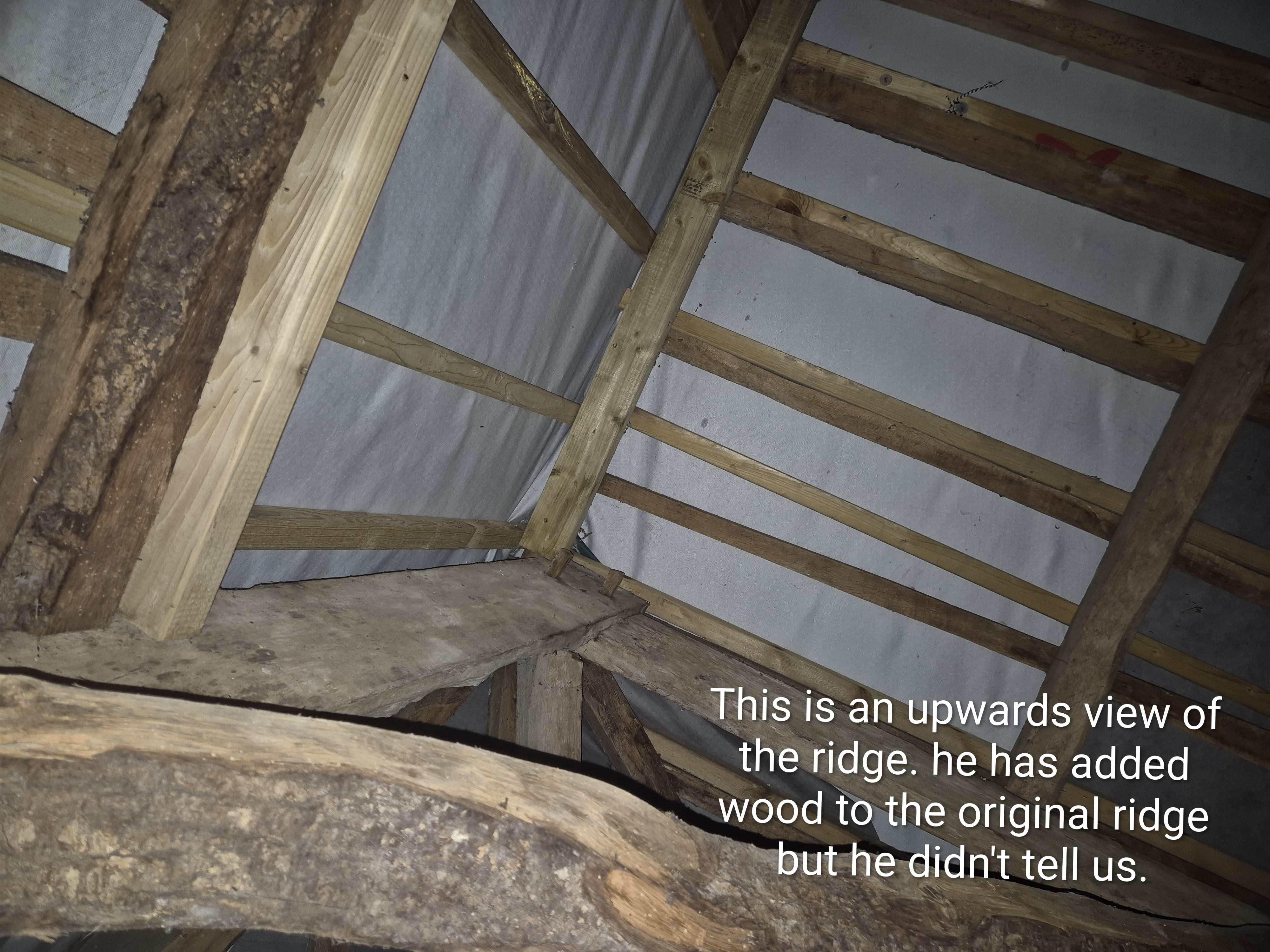

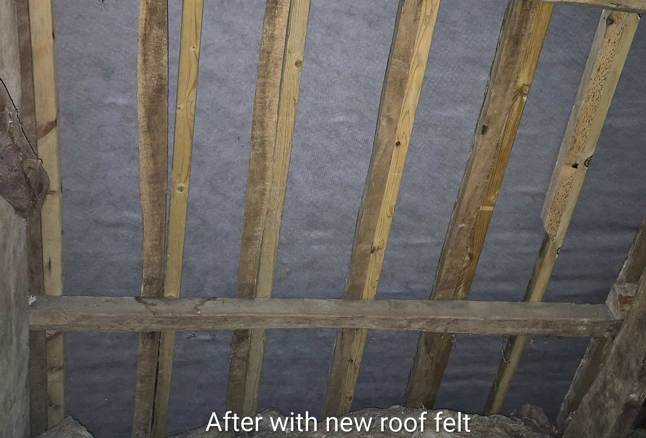

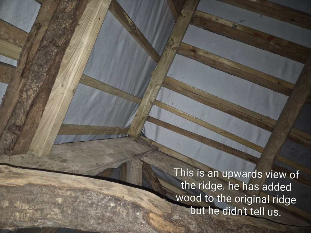

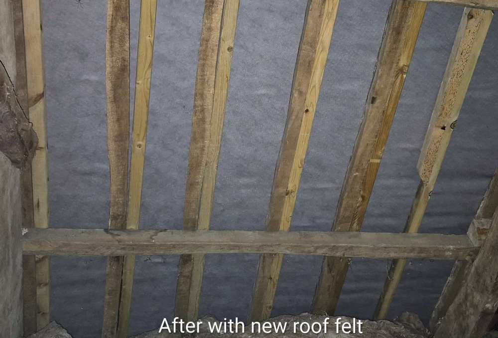

Andy62 Posted September 20 Posted September 20 We had new slate tiles and roof lined but builder has added wood to the perlin roof without telling us. The work was completed 3 years ago and we never use our loft so we have just found out. Can anyone tell me what is going on in this picture. What is the added wood for?
Nickfromwales Posted September 20 Posted September 20 It looks like they’ve fortified the existing timbers, and one looks to have been cut out / short, so was necessary to do a good (robust) job. Odd as it should have been in your quote as it’s a significant amount of work so would have been costed for you to agree to it being done. Did you read their quote word for word?

Redbeard Posted September 20 Posted September 20 Surely, in the end we can see of the 'upward view' it is not fixed to the truss and isn't transferring any load?? Or am I reading it wrongly? How big, out of interest, is the roof (measured on the slopes)?

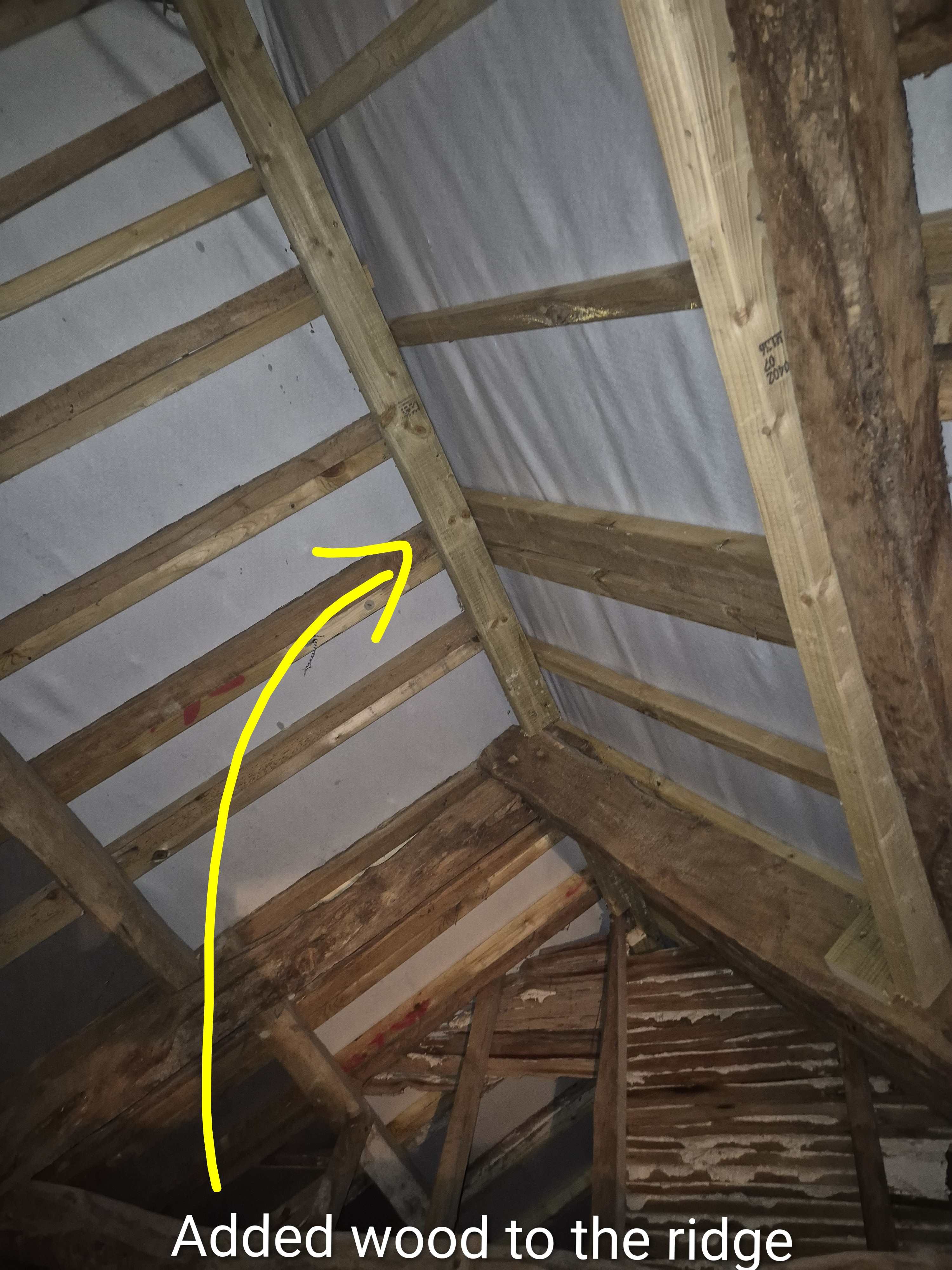

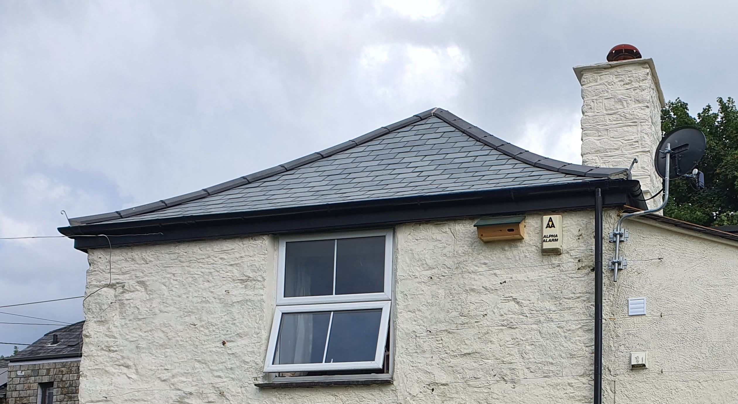

Andy62 Posted September 20 Author Posted September 20 This is what's strange I have never seen pieces of wood attached to a truss. It is screwed into the old ridge beam but not attached at the end. The old ridge is underneath it when you look under the new piece of wood. Is this okay? I have no idea so it would be good to understand why he has done this. Is this the truss in this picture? - Yellow arrow. These are all the way along the ridge. An estimate of the length of the roof without slopes is 13 metres. There is a hip at each end. Not sure how long the slope is.
Alan Ambrose Posted September 21 Posted September 21 You sound a bit alarmed, but actually it could just be the roofer being a bit professional. It looks like he has determined at some time that the original trusses were not strong enough and beefed them up. Better he did this than not, yes? Was your original roof a bit out of whack? Is the new roof much heavier? How old is the original? Suggest, if in doubt, call in an SE to check. Or ask the roofer, very politely. Some of that roof is 100 years old or older?
BadgerBodger Posted September 21 Posted September 21 As @Nickfromwales is saying. It looks like they’ve just reinforced the existing structure. some of this might be been due to a need due to rot, or the builders opinion that what was there was inadequate or even just for ease and safety of battening. the original rafter spacing appear irregular, you don’t often see them not meeting at the spar ends which would possibly explain the reinforced ridge which he would then probably have nailed into. then the original rag gets are also not parallel and/or straight. This can present an issue for counter battening (if done) and lathing. it just takes a bit more time really but if the spacing is excessive walking the lathe afterward may in his view have been unsafe (too much deflection. seeing the type of roof timbers originally used this looks like a really old house? It’s quite typical to see a hodge podge of solutions up there are everyone has their own take. unless you have a defect now because of it, I likely wouldn’t be worried. surprising he didn’t mention it though.
MikeSharp01 Posted September 21 Posted September 21 It struck me that it may have been used to try and straighten the ridge - pull everything along a common line or at least pull out the larger bends =- which may only have been a few mm. It is also possible that it was used to keep everything together while the roof was put on, so when the structure was it it's weakest, and the intention was to remove it but never done.
Redbeard Posted September 21 Posted September 21 13 hours ago, Andy62 said: Is this the truss in this picture? - Yellow arrow. No, the 'truss' I meant is 2 to the right - the big timbers bolted at the top of the inverted 'V'

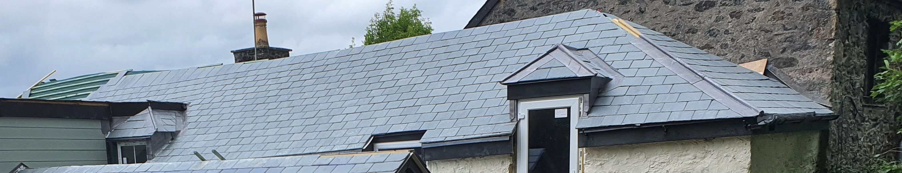

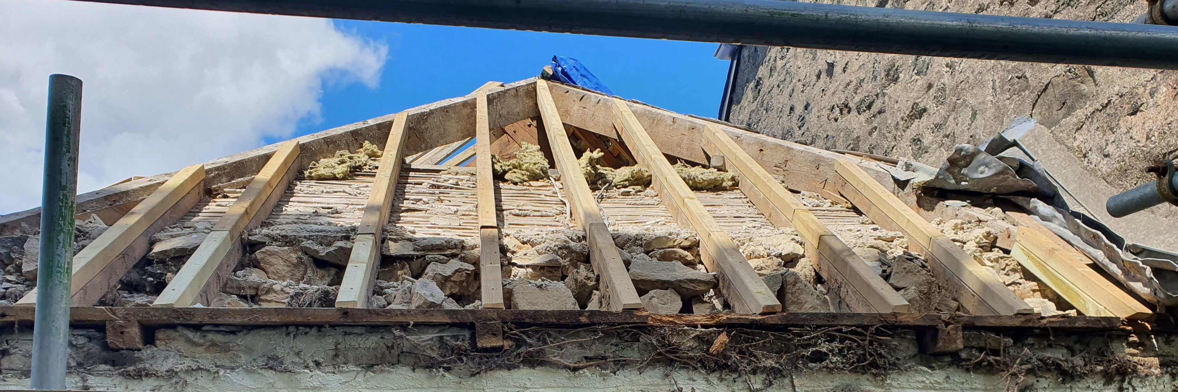

Roundtuit Posted September 21 Posted September 21 Looks like a quality job to me (as an amateur). From your last pics, he may have raised the ridge a little to retain the original building fabric. Is it listed?

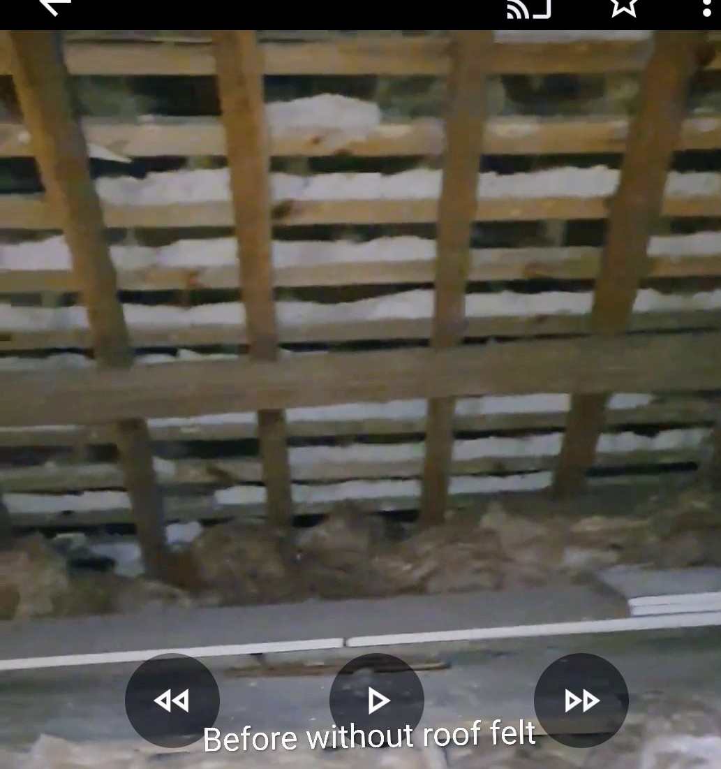

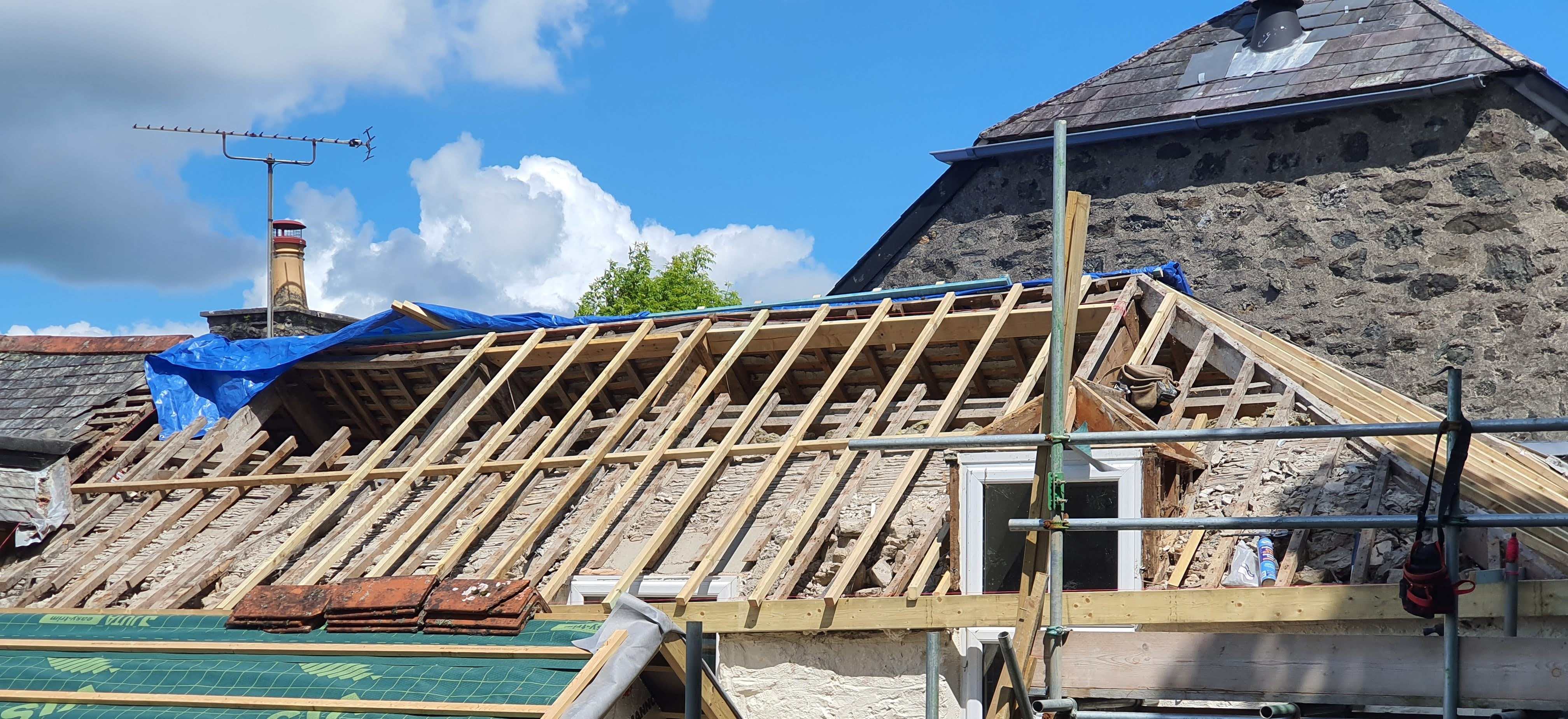

Andy62 Posted September 23 Author Posted September 23 (edited) Yes, we were not told about the work the builder just did it. I have double checked his invoices and there is nothing other than wood for new battens, felt, screws, cost of removal of all old tiles and ridge tiles, cost to buy new slate tiles, new ridges tiles. Leading and fitting costs for leadimg for around the chimneys and some windows and new fascia boards and guttering. I cannot see all of the work he did. The photos of the work weren't taken by me they were taken by a friend who stayed at my house whilst the work was being done as we had to go away. it wasn't until I went in the loft and noticed loads of new wood that I did a double take. I can't see how I can be liable for anything if I didn't even know the work had been done and I have the proof in the invoices. Thanks again for commenting! Edited September 23 by Andy62
Roundtuit Posted September 23 Posted September 23 Sometimes, particularly with old properties, trades build-in a margin to cover the stuff they can't see until they start. Tbh, I'd find it reassuring to see that your roofer has done what he sees necessary to do a proper job, which is what it looks like from the external photos. As above, I'd say don't worry about it unless someone else does, but is there perhaps a warranty on the roofing job that you can offer up if it's queried?
