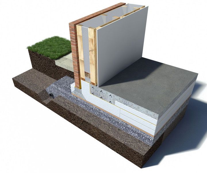

Russell griffiths Posted January 8, 2018 Author Posted January 8, 2018 Having a look at this pic just for an example. Lets say for argument that all the insulation in the pic is 100mm thick, so we have 300mm under the main slab with 100mm of concrete over the top, so if we require thicker sections through the slab for point loads or supporting walls why not get rid of the top layer of eps and replace with additional 100mm of concrete, so in effect the picture would have 200mm of eps and 200mm of concrete. Tell me why this is silly/stupid im hoping that I’ve preempted your answers in my head, but need some clarification. Cheers.

IanR Posted January 8, 2018 Posted January 8, 2018 (edited) 3 hours ago, Russell griffiths said: Yes it would add an awfull lot of concrete, but what is cheaper 1m square of concrete or 1m of eps. EPS100 is quite a bit cheaper than concrete per unit volume. 3 hours ago, Russell griffiths said: Lets say for argument that all the insulation in the pic is 100mm thick, so we have 300mm under the main slab with 100mm of concrete over the top, so if we require thicker sections through the slab for point loads or supporting walls why not get rid of the top layer of eps and replace with additional 100mm of concrete, so in effect the picture would have 200mm of eps and 200mm of concrete. Tell me why this is silly/stupid It's not stupid, but if you're happy with the U Value that 200 EPS provides, and you have the bearing capacity in the subsoil that can take the higher pressures from the line and point loads, why put in the extra concrete if it's not required? The localised 200mm thick integrated beams are very easy to produce, you just leave a gap of the desired width in the top layer of EPS, so there really isn't any extra labour needed to produce them. Since UFH is generally included within the insulated slab, there is a benefit to keeping it "thin" - to keep its heat-up time as low as possible. Edited to add: I have an AFT engineered insulated slab, which is on similar principles to the MBC version. Edited January 8, 2018 by IanR 2
Nickfromwales Posted January 9, 2018 Posted January 9, 2018 11 hours ago, Russell griffiths said: Yes it would add an awfull lot of concrete, but what is cheaper 1m square of concrete or 1m of eps. ? 2 sheets of of 100mm EPS can be carried by one man. That negates over half a m3 of concrete ! Why on earth would you actively remove insulation from under your heated slab? 200mm of eps isn't exactly poor, but not as good as 300mm. Also, the additional weight of flooding to the full ring beam depth may push your groundworks and S/E costs up so I think this option is a ? ? Ask yourself one simple question...."Should I be buying more concrete unnecessarily, or fitting more insulation that will serve me better over my time in the property". Fwiw, I'm constantly arguing with customers 'builders' over slab construction, and specifications of, when I'm fitting UFH and screed after they have left. For some reason they prefer to pour ridiculous amounts of concrete into sunroom / conservatory / extension slabs instead of using more insulation. I can only imagine it's because that's how their great gran-pappy used to do it "during the war" and he didn't get any complaints. That and the fact that they won't be contributing to the additinal energy consumption that the poor floor type will cause . 1

Russell griffiths Posted January 9, 2018 Author Posted January 9, 2018 (edited) So looking at the pic I found, am I missing something, in a lot of the replies it looks like the more insulation you can cram under a slab the better, I fully agree. In the pic is a ring beam that the wall sits on, this is sitting on 200mm of insulation, the rest of the slab is only 100mm thick so you can add an extra 100mm of insulation underneath so it sits on 300mm, if you then put 2-3 thicker beams throughout the slab to stiffen it up these will allso only have 200mm underneath them, so looking at the pic have we not created a slab with many major cold spots all around it and through out the middle. This will require the thoughts of blokes far cleverer than me. @JSHarris @IanR Edited January 9, 2018 by Russell griffiths
Russell griffiths Posted January 9, 2018 Author Posted January 9, 2018 9 hours ago, Nickfromwales said: Also, the additional weight of flooding to the full ring beam depth may push your groundworks and S/E costs up so I think this option is a ? ? Why? I believe it would be cheaper, if you have to excavate to a required depth surely it is easier and less labour intensive to pour a thicker slab than to have spent the time pre forming thickening beams and adding the additional re enforcement. A pour and finished slab takes the same time to lay regardless of whether it is 100mm -150mm or 200mm

Nickfromwales Posted January 9, 2018 Posted January 9, 2018 16 minutes ago, Russell griffiths said: Why? I believe it would be cheaper, if you have to excavate to a required depth surely it is easier and less labour intensive to pour a thicker slab than to have spent the time pre forming thickening beams and adding the additional re enforcement. A pour and finished slab takes the same time to lay regardless of whether it is 100mm -150mm or 200mm Over say 100m2 what would be the additional weight of the extra 100mm of wet concrete poured? I would think that would be factored in to the specifics for the ground preparation at the design stage, possibly requiring additional sub base preparation etc, plus the extra cost filling the volume with concrete would be significant. I think your maths may be out but I've been wrong before . 3 minutes ago, IanR said: I have a quote from Kore that puts the cost of 1 cu m of EPS100 at £58 delivered. I paid £96 for 1 cu m of C35 concrete delivered. So basically twice the cost, and an additional 50+ days to dry out. Plus it's lower insulation value under a heated slab. ?
IanR Posted January 9, 2018 Posted January 9, 2018 (edited) 1 hour ago, Russell griffiths said: So looking at the pic I found, am I missing something, in a lot of the replies it looks like the more insulation you can cram under a slab the better, I fully agree. In the pic is a ring beam that the wall sits on, this is sitting on 200mm of insulation, the rest of the slab is only 100mm thick so you can add an extra 100mm of insulation underneath so it sits on 300mm, if you then put 2-3 thicker beams throughout the slab to stiffen it up these will allso only have 200mm underneath them, so looking at the pic have we not created a slab with many major cold spots all around it and through out the middle. Even at the localised 200mm thick EPS below the beams the U value is still better than Building Regs, so I wouldn't characterise it as cold spots, and certainly not "majour". But it does need to be taken into consideration when calculating the whole floor U Value, just as timber fraction does when considering the whole wall U Value. Taking my floor as an example, I have a 475m2 slab, of which 79m2 "only" has 200mm EPS underneath, due to integral beams. But 396m2 has 300mm EPS underneath. So 83% at 300mm thickness and 17% at 200mm. The overall effect on U Value is quite small. Your suggestion is to remove the top layer of EPS and have the 100% of the floor with 200mm EPS. Still an OK U Value, but not as good as good as keeping the reductions localised. 59 minutes ago, Russell griffiths said: if you have to excavate to a required depth surely it is easier and less labour intensive to pour a thicker slab than to have spent the time pre forming thickening beams and adding the additional re enforcement. It's really not a lot of work to set out the EPS formers. I believe AFT allow 3 days for 3 people to get from compacted sub-base to concrete pour for an average slab. There's really not a lot of work to do the whole floor with beams, so very little to save by not doing the beams. The additional reinforcement would still be required to strengthen the slab where the load bearing walls will be sitting. Edited January 9, 2018 by IanR 1 2
Russell griffiths Posted January 9, 2018 Author Posted January 9, 2018 34 minutes ago, IanR said: I have a quote from Kore that puts the cost of 1 cu m of EPS100 at £58 delivered. I paid £96 for 1 cu m of C35 concrete delivered. So I think my mind is being distorted by costs. The prices I have seen for eps look to be higher than the ones @IanR is quoting, and the cost of concrete is cheaper. I was typing this as Ian did his last reply. What an excellent reply and just what I was looking for. Top man Ian. So in essence having 20% of a slab with a slightly lower u value than the rest of it will be better than 100% of the slab at the lower value. I was having trouble thinking a colder area all around the edges would be sucking all the goodness out from the middle so why bother trying to improve the middle if the edges just rob it back. Excellent as always thanks everyone. ?? 2 1
