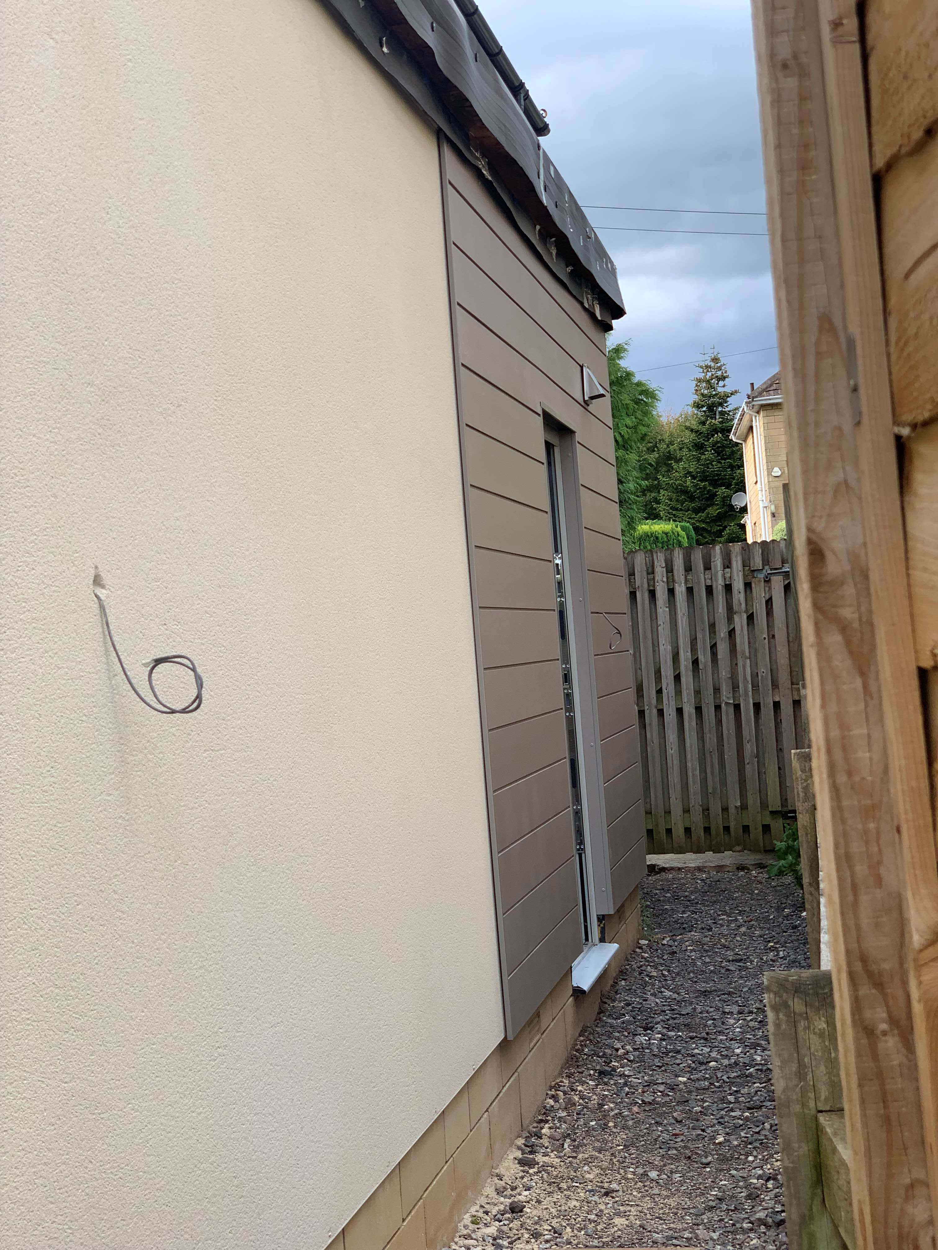

Any ideas for the best way to protect cladding from damage by adjacent building works please ?

Building work to dig and lay foundations and build the outer wall of an extension a metre away from the cladding, possibly with adjacent scaffold or platforms. Yes work will be done from the metre gap which is our land. So digging including use of a digger, breaking out, cutting, dust, possibly knocking with ladder, or tools, spashing with mortar etc.
Part of wall is also rendered - k-rend. The only obvious fixing point is fascia/soffit/capping timbers at the top of the single storey wall - where timber has not yet been covered with any alu roofline trim.

Thanks  for response. A main problem would seem to be how to actually fix any covering, given you cannot fix into the cladding or render, and the height to top of roof is about 3.2m. (taller than any 2.4m board)
Also needs to survive the weather going into winter for 3/4 months.
What do you mean by 'protection boards' ? Proplex ?
Concerned that anything in direct contact with the cladding and render will then itself abrade the surface finish as it is bound to move somewhat over time from the weight of it or action of weather or being knocked.

I have, but they propose to hang 2.4m insulated plasterboard sheets from the fascia board. Doesn't seem the best idea to me, given even polystyrene rubbing against the surface seems likely to mark or damage it. Also plasterboard and rain doesn't seem a good mix and p/board sheets hanging could blow about or even come down off fixings.
So as to create a void/air gap between the covering and the actual cladding and rendering ?
Not sure how to spike into the ground which is hardcore over earth.
A fence. Otherwise it will be damaged.
Be aware too that a replacement sheet of cladding never matches. One damaged sheet can require the whole face to be replaced. That may require fascias and gutter removal.
Photographs, submitted formally to your neighbour will prove condition and that you mean what you say about repercussions.
Where is the boundary?
Scaffold protection sheets the full height of the scaffold. Have them pay for a temporary fence to run the full length of your house. Assume it will get damaged and agree now in writing what the remedy will be. Patching a repair might not look acceptable to you and replaced cladding might not match well.
Is the existing fence coming down and the scaffold will be on your land?
I’d just fix a dust sheet to the fascia and weight it at the bottom.

Dust sheet will rip off in wind and doesn't protect against knocks.
Any scaffold will not go up until a lift is needed and might just be platforms.
What is the relationship like with the neighbour and/or the neighbour's contractor? I would set out very clearly what you would like  any protection to achieve, and ask them to make a proposal for your agreement. Make it clear in writing that if the arrangements they make are deficient in any way, and your property is damaged in any way, your course of action will be (xxx). If this is all done in advance, in writing they cannot say later that  they were not warned. (I fully accept that if there is less than 100% co-operation this is a lot easier to say than to achieve).
Buildings have protective sheets attached to them for months, years in some cases. If the scaffolding is going to be on your land then it’s going to be very close to your house so won’t they have to fit a scaffold sheeting down it anyway like they do when it’s on the street? It’ll be the scaffolders that will hit your house if it’s so close so be mindful of that. I still think dust sheet from your fascia, scaffold protection, and try and get in site type boarding/fencing which is typically just painted OSB. Then agree how any damage will be remediated in writing.
