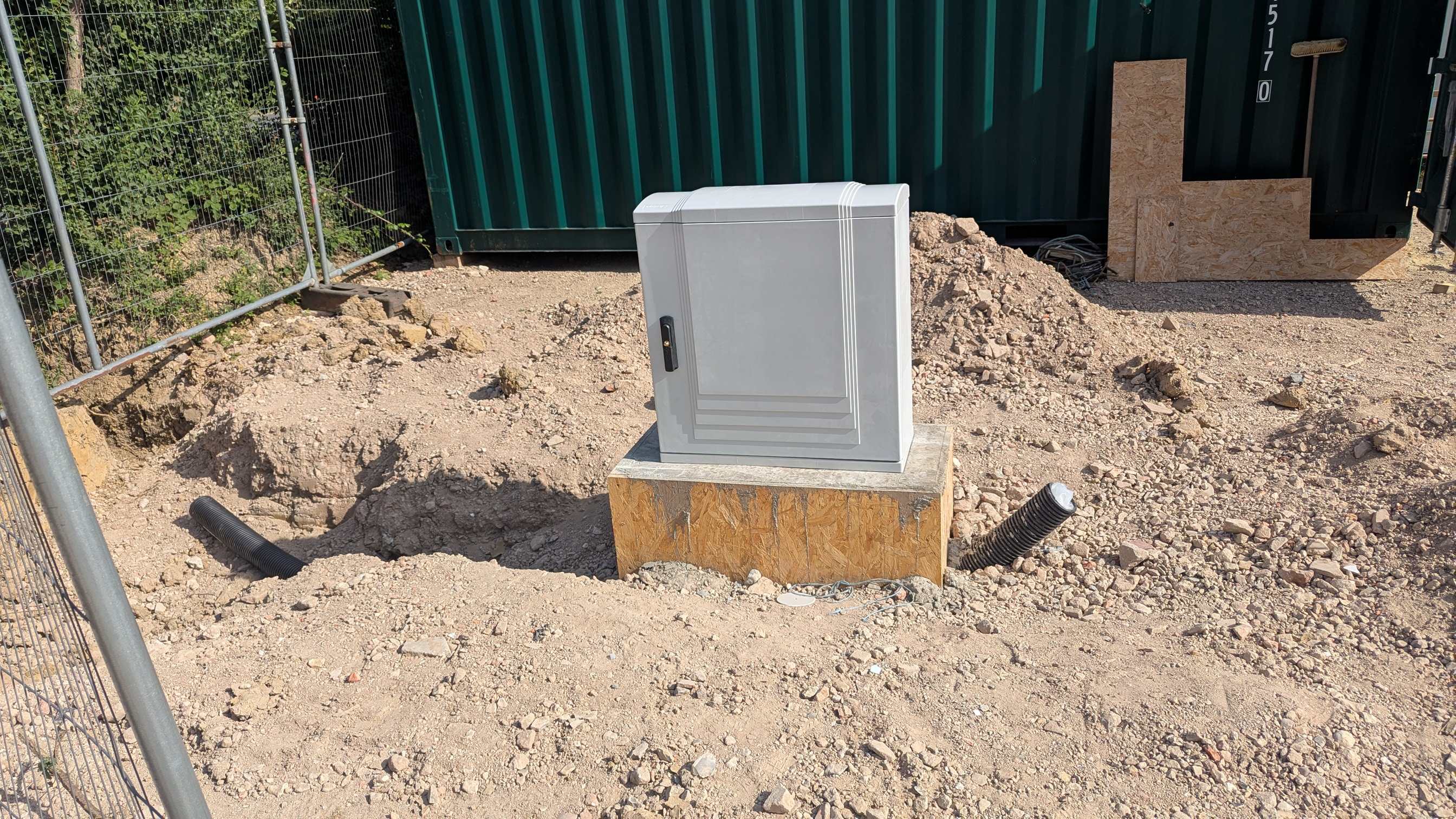

Buy a kiosk (would suggest a 3 phase kiosk even if single phase supply) and mount it on a concrete pad. Fit it with three ducts (supply in, cable to house, and a spare) For the ducts Have the meter installed in it, a small CU and some sockets. That’s your temp supply. When it comes time for your permanent supply you remove the small CU and sockets, fit an isolator and run your house supply from it.

Unless you are a bricklayer who can also make a nice door, buy a fibre glass kiosk. You need  proper hockeystick  ducts too.
The concrete base is easy diy apart from getting the ducts in the right places.... these cables are big and stiff.
Thr kiosk will look the business and recognisable the electric company will be happy,  and it's easy to recognise and access in perpetuity.

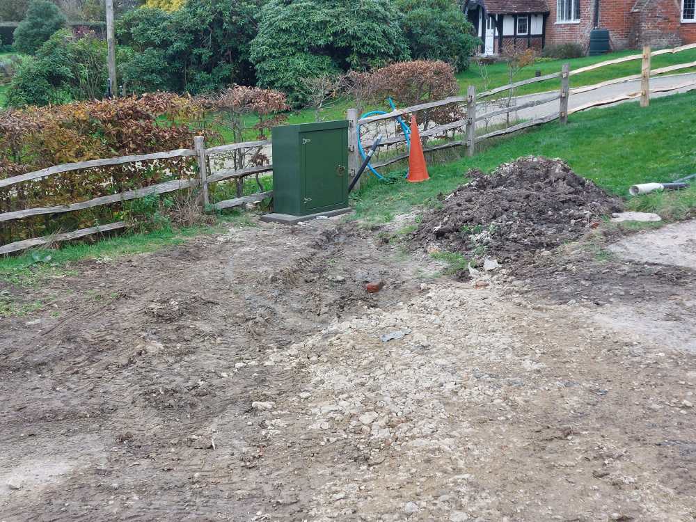

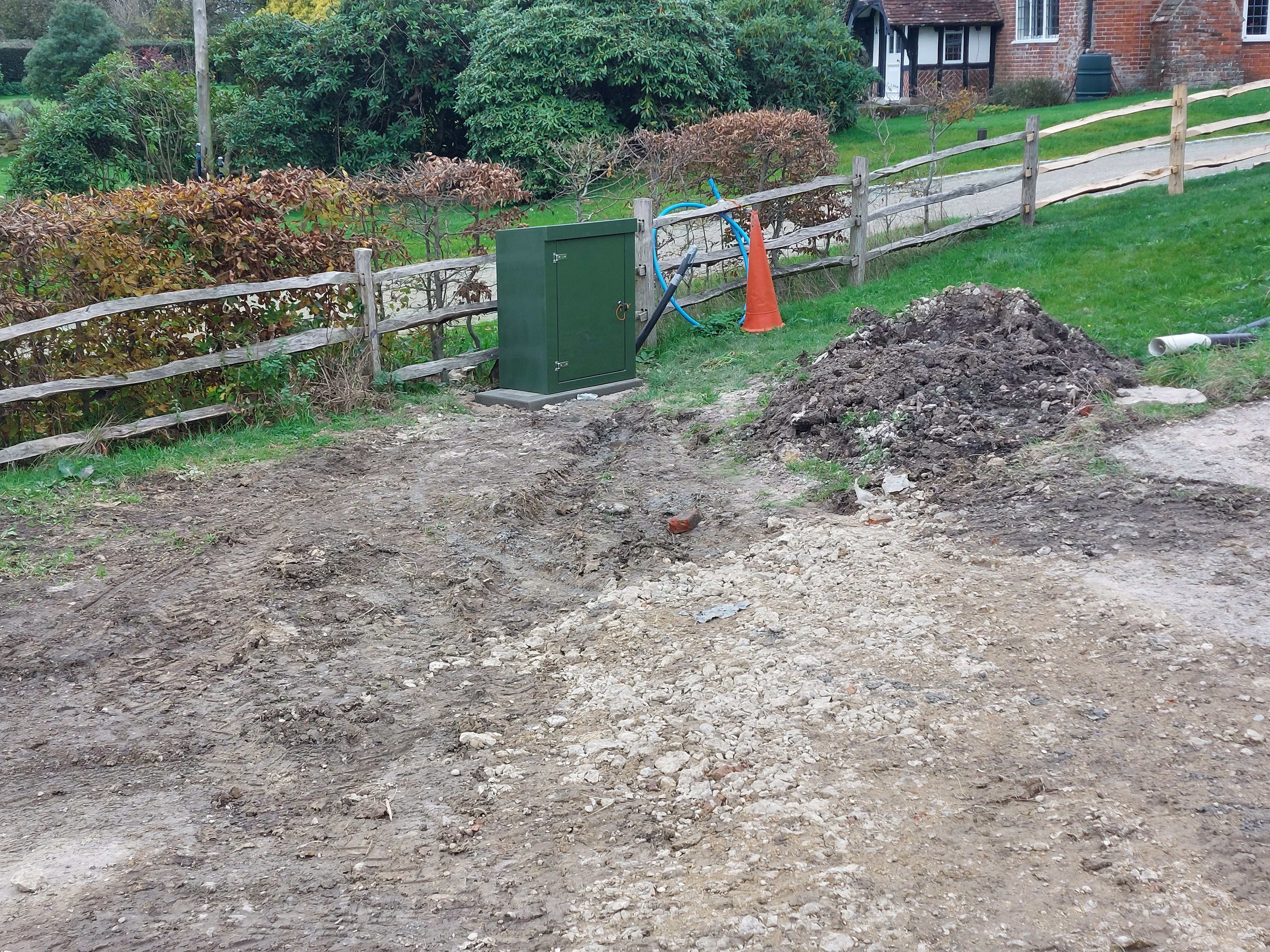

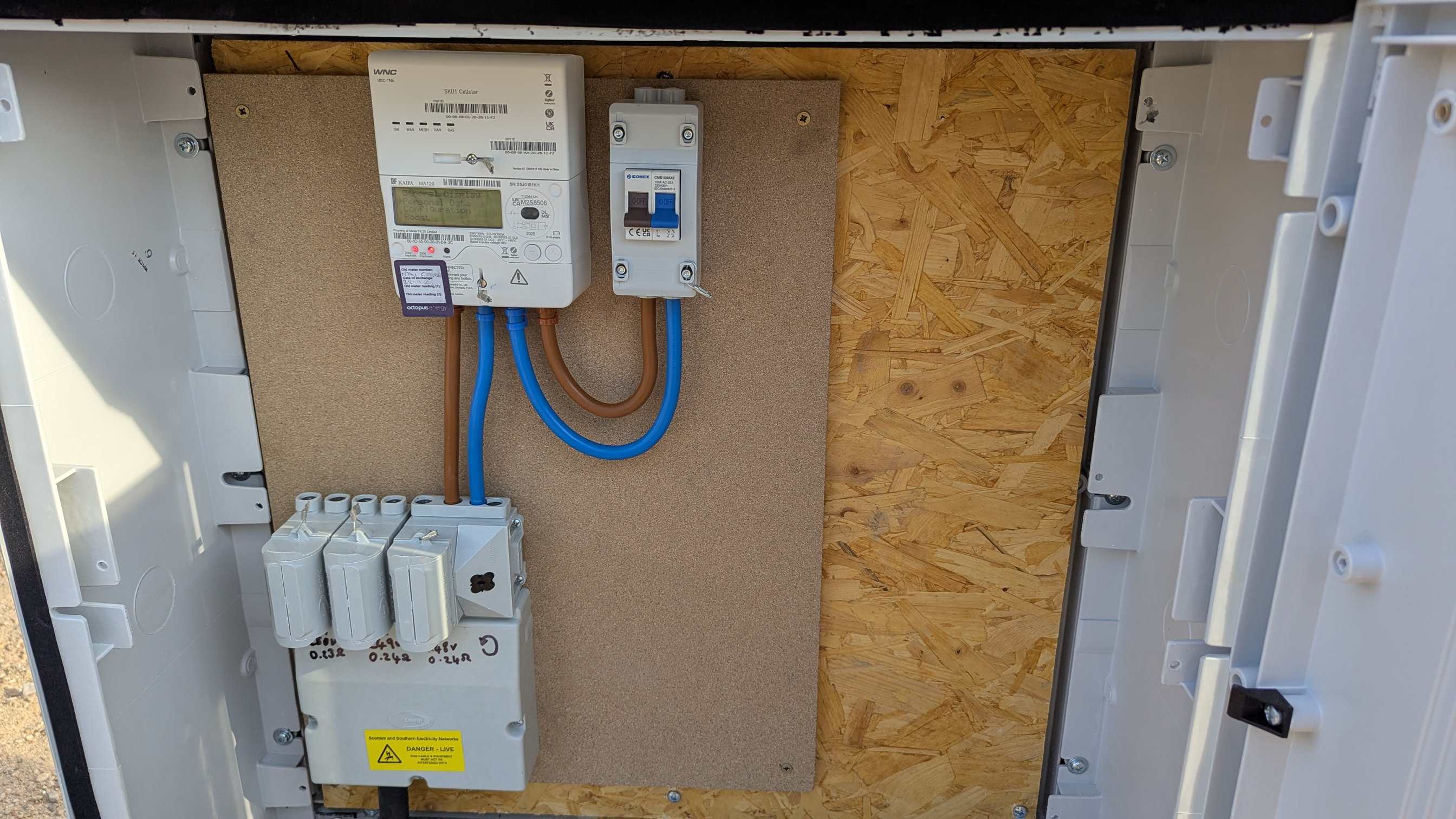

I installed this relatively cheap and easy to install
As above once the supply is installed into your kiosk there is no need to move it, the supply and meter will stay there and you lay a big armoured cable from there to feed the house.

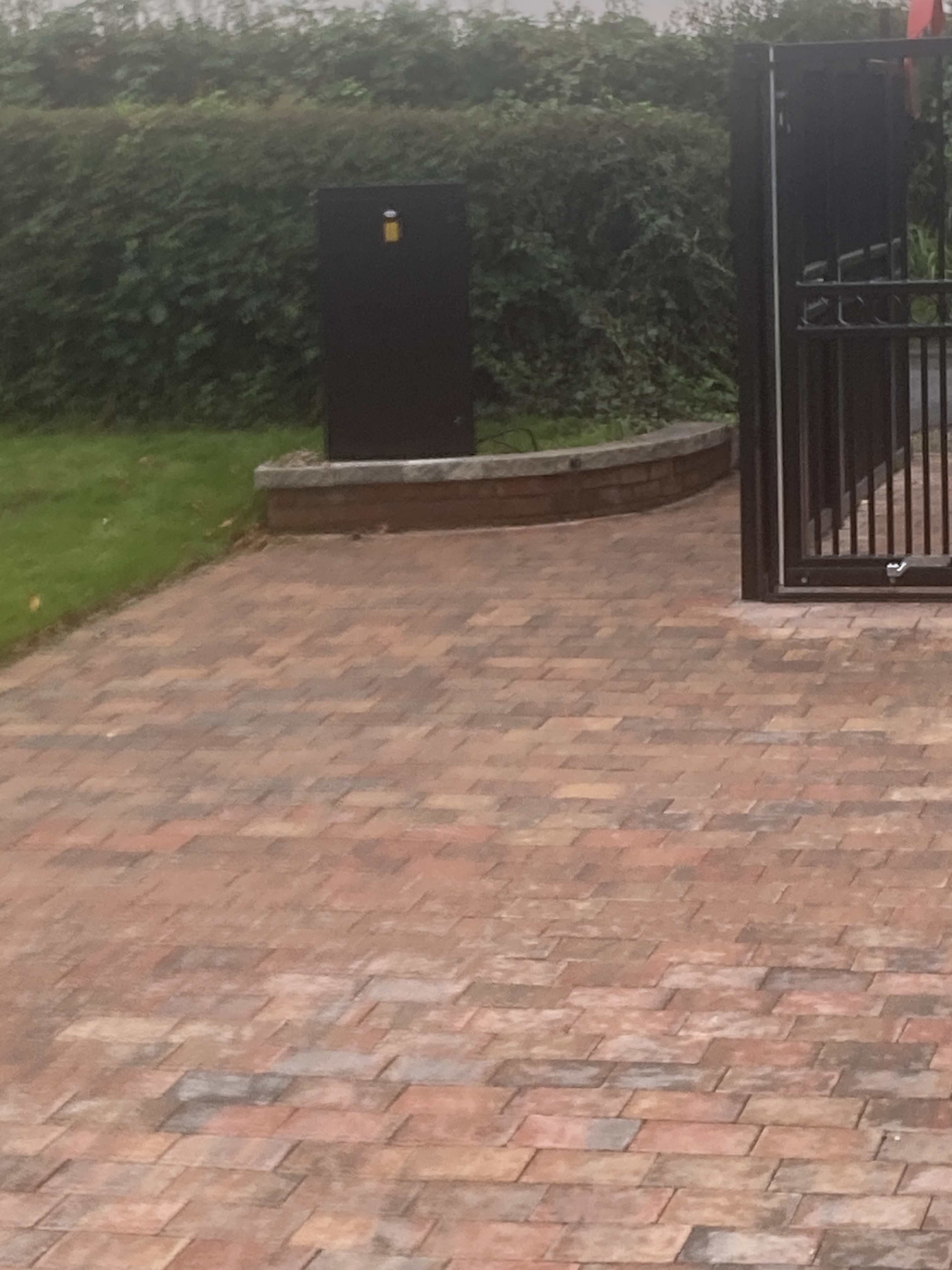

I did a white external meter box on a post. Positioned it exactly where it would end up in the house.  As wall was built it was moved about slightly. Once water tight box was cut away from meter and positioned correctly.

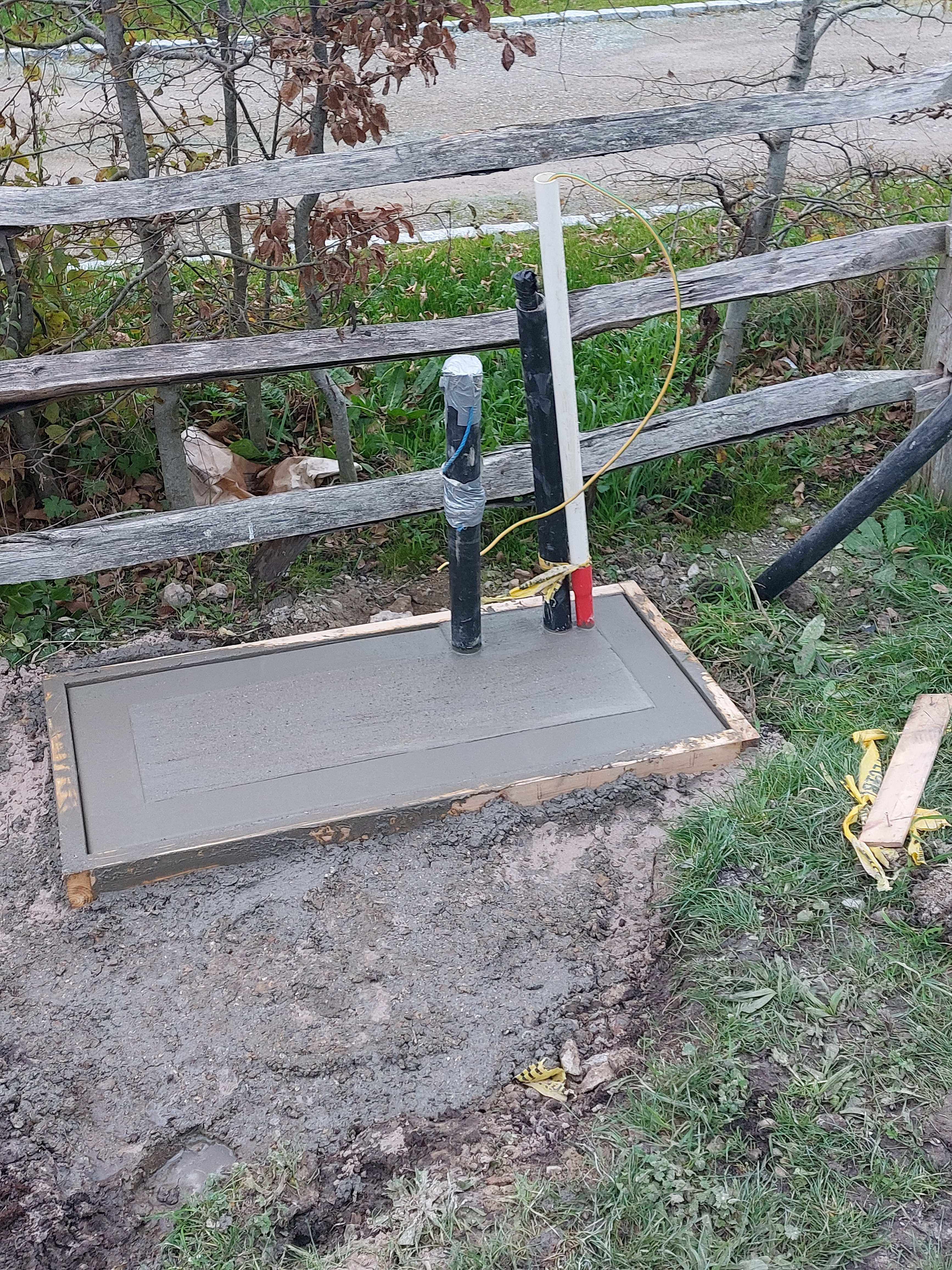

IMG_20201117_100526.thumb.jpg.6051137551d830cf37e86c863db3bd4a.jpgIMG_20201013_153129.thumb.jpg.36f5ded7911f9547c19ce563650cbe2f.jpg

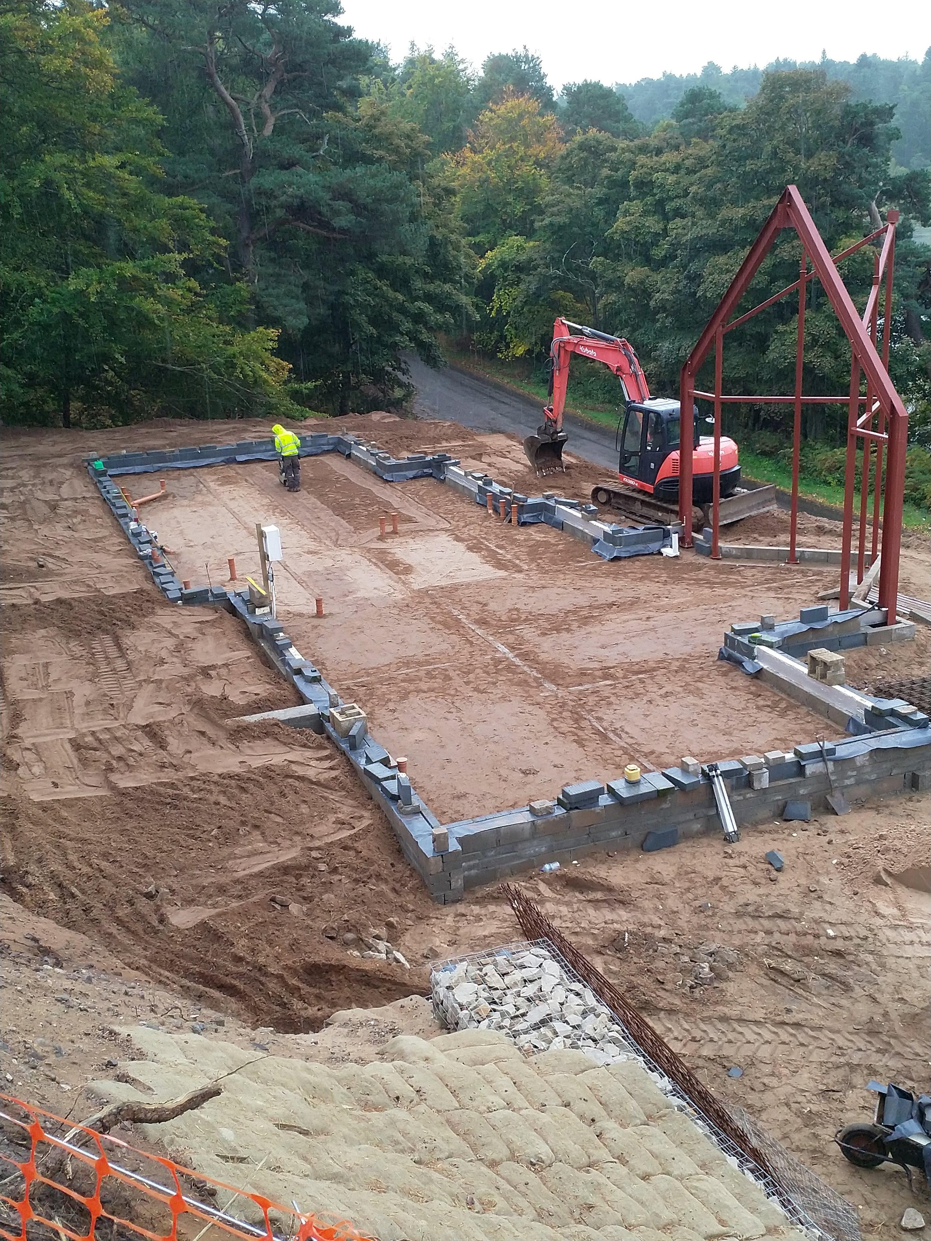

We demolished a house and rebuilt. The meter was moved by the power company to a temporary kiosk as already suggested. Once the new build was water tight we paid to move the meter again into the plant room. I was expecting the power company to go back to the pole for the final new connection into the plant room and was surprised that they just made an underground connection to the temporary kiosk supply cable to make the new supply. Saved them about 15 meters of cable, the builder was doing all the digging except the last 3 meters to the pole which the power company wanted to do them selves.

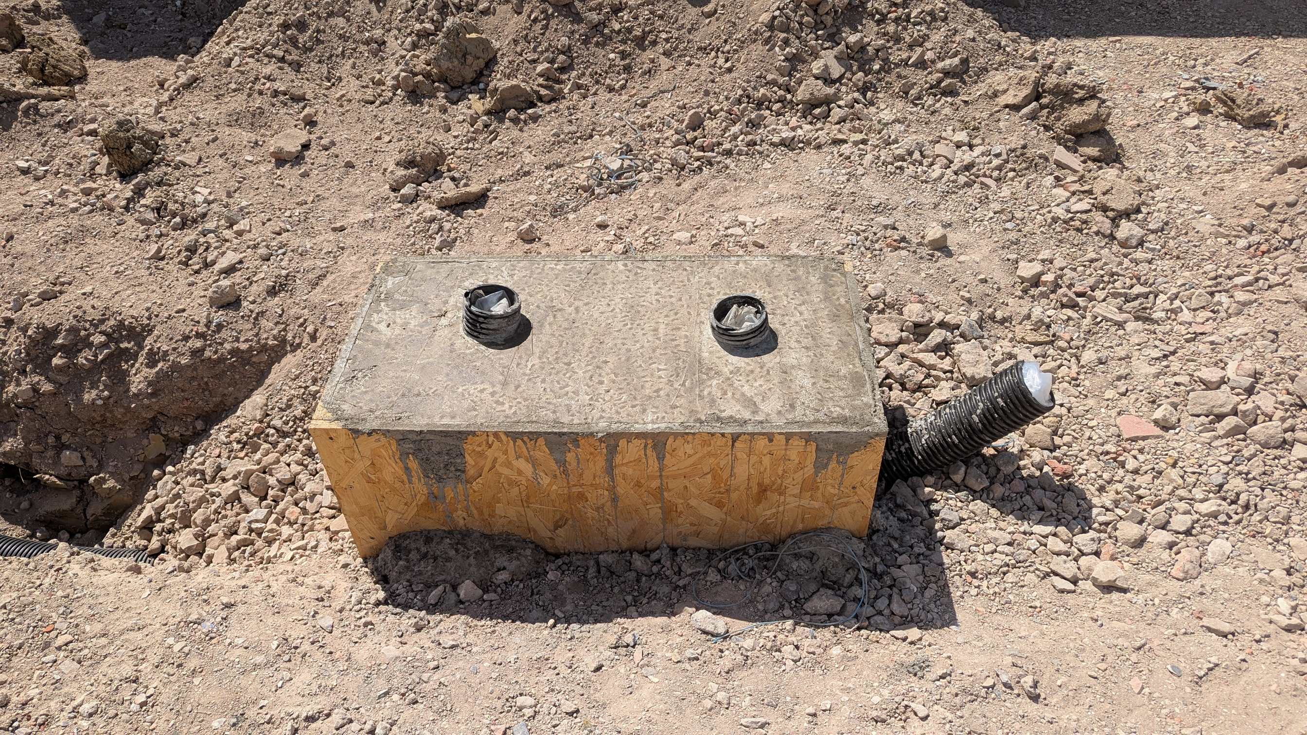

I used the 38mm diameter black hockey sticks. The white ones are smaller (32mm I think) In hindsight I should have just continued the ducting in the ground up into the kiosk for house supply as the cable was 35mm2 so only just fitted but it took several goes.
I built a concrete pad and put external box on top.  Will remove next year when house is built
What do people mean by "black hockey sticks"?

I got mine here https://meterboxesuk.co.uk/product-category/electric-meter-boxes/
One other question.  I am going to mount the grp kiosk within 3 ft of the pole where they will bring the feed from.  What I'm not sure about is the additional 100mm ducting that they mention.  They mention for split phase you need to install a 50mm hockey stick to a depth of 450mm below FFL.  It's the section from the hockey stick to the pole that I'm not getting.  Does the SWA cable that they will install also have to go into some sort of ducting?
No. If the box and pole were 20m apart then they would need an exposed pit at each. In your case they join so it is all pit.

Given that others have said how difficult it is to pull the cable through the ducting and around the bend, has anyone found a larger hockey stick duct than the 50mm (split phase / 3 phase) that SSEN specify which would work with 100mm internal diameter ducting?
The other stupid question I have is around the ingress of water into the underground ducting.  I assume that the ducting remains below ground and is not bent 90 degrees and partially up the side of the pole when they come to connect.  The pole is on a bank and the kiosk is lower.  I just have visions of water making it's way in one end and coming out inside the kiosk.
And one final thing.  How do you connect 100mm ducting to a 50mm hockey stick.  The internet seems to suggest using tape!  Surely, there must be a ducting to hockey stick reducer?

The black hockey sticks have a bigger diameter (38mm)  than the white ones which are more common.
