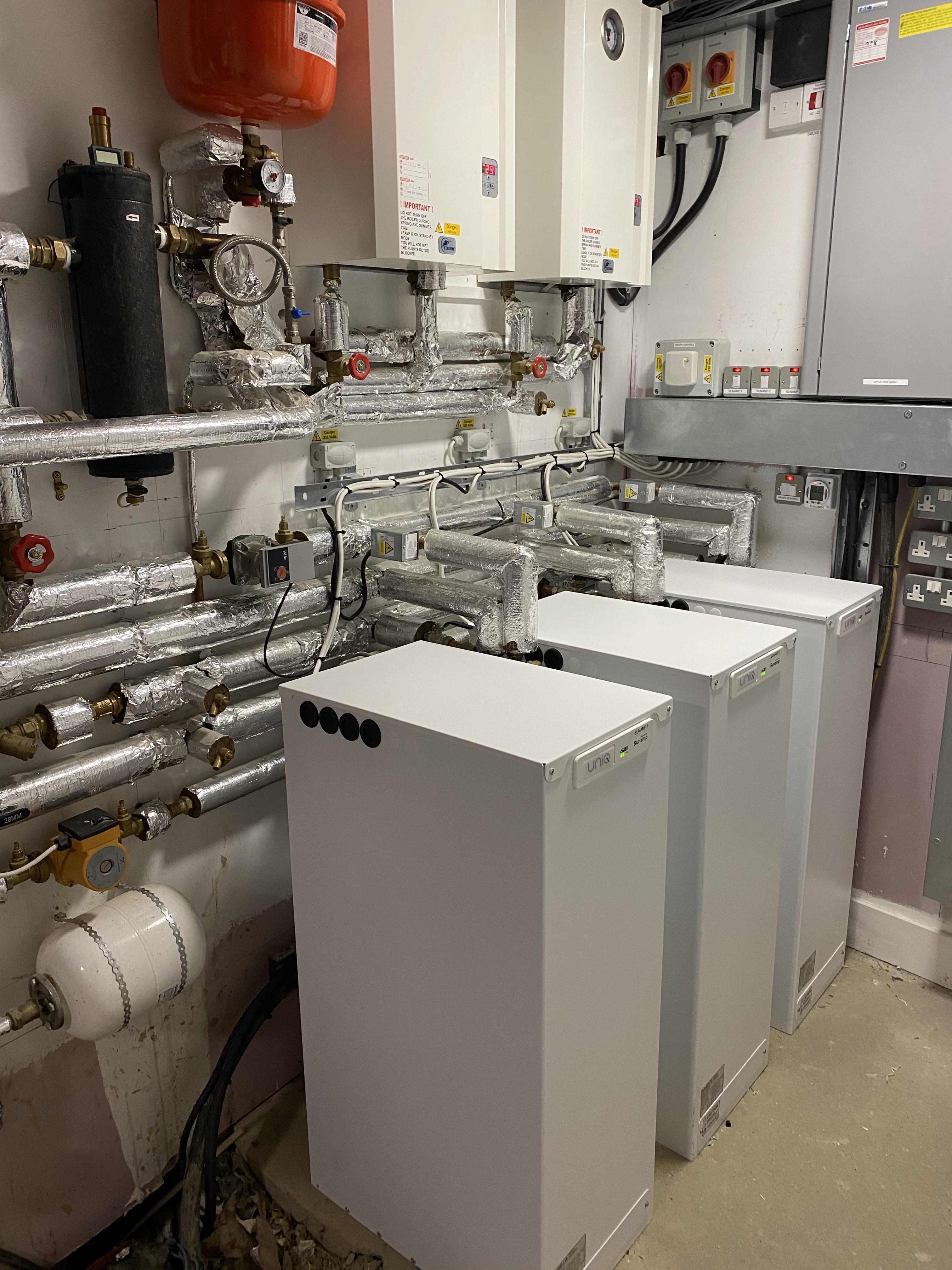

Nickfromwales Posted February 10, 2021 Posted February 10, 2021 19 hours ago, TonyT said: Copper for me? Yup. In the plant rooms / exposed areas ( like one of my previous installs above ) I always change to something solid, but behind the scenes I run Hep everywhere else. The benefit of not having hidden joints in the fabric of the dwelling is good enough reason for me to mix the disciplines accordingly. 1

Nickfromwales Posted February 10, 2021 Posted February 10, 2021 Just now, pdf27 said: What's the benefit of copper in these areas - is it just aesthetics, or is there some functional benefit? Just all the controls / valves etc need something ‘fixed’ and copper / brass offers that. Push-fit also tends to allow the pipe to rotate ( deadly with JG Speedfit as it can simply undo itself. I try to do all my plant rooms with copper and a mix of soldered and strategic compression joints, eg to allow a ‘spanner only’ removal of any and all valves etc, ( so no cutting and soldering to replace anything U/S is the end goal ). @PeterStarck’s install with JG remains a thing of beauty, but a labour of love.
TonyT Posted February 10, 2021 Posted February 10, 2021 Connecting copper direct to boilers isn’t a problem, it is for plastic in the event of fire, plastic melts, copper doesn’t copper has antimicrobial properties. copper is generally going to be easy to alter in the future, where as plastic fittings may be specific and become obsolete. Copper doesn’t sag and looks better with brass stand-off clips. first impressions copper looks proper in a plant room, plastic looks like a builders been at the plumbing.
Nickfromwales Posted February 10, 2021 Posted February 10, 2021 7 minutes ago, TonyT said: Connecting copper direct to boilers isn’t a problem, it is for plastic Most if not every boiler manufacturer stated not to connect push fit within 800-1000mm of the boiler. 8 minutes ago, TonyT said: in the event of fire, plastic melts, copper doesn’t So you get a free sprinkler system 9 minutes ago, TonyT said: copper has antimicrobial properties. Not really a problem in a modern sealed system. 10 minutes ago, TonyT said: copper is generally going to be easy to alter in the future, where as plastic fittings may be specific and become obsolete. Only a problem really if you go for a lesser known manufacturer. Copper is on its way out, so the market lead will end up plastic / other synthetic in the long run. 12 minutes ago, TonyT said: Copper doesn’t sag and looks better with brass stand-off clips Pipe clip centres need to be observed, but agree where on show, or where repeated light impacts may occur, copper is best. 13 minutes ago, TonyT said: first impressions copper looks proper in a plant room, plastic looks like a builders been at the plumbing. Lol. Agree 100%.
