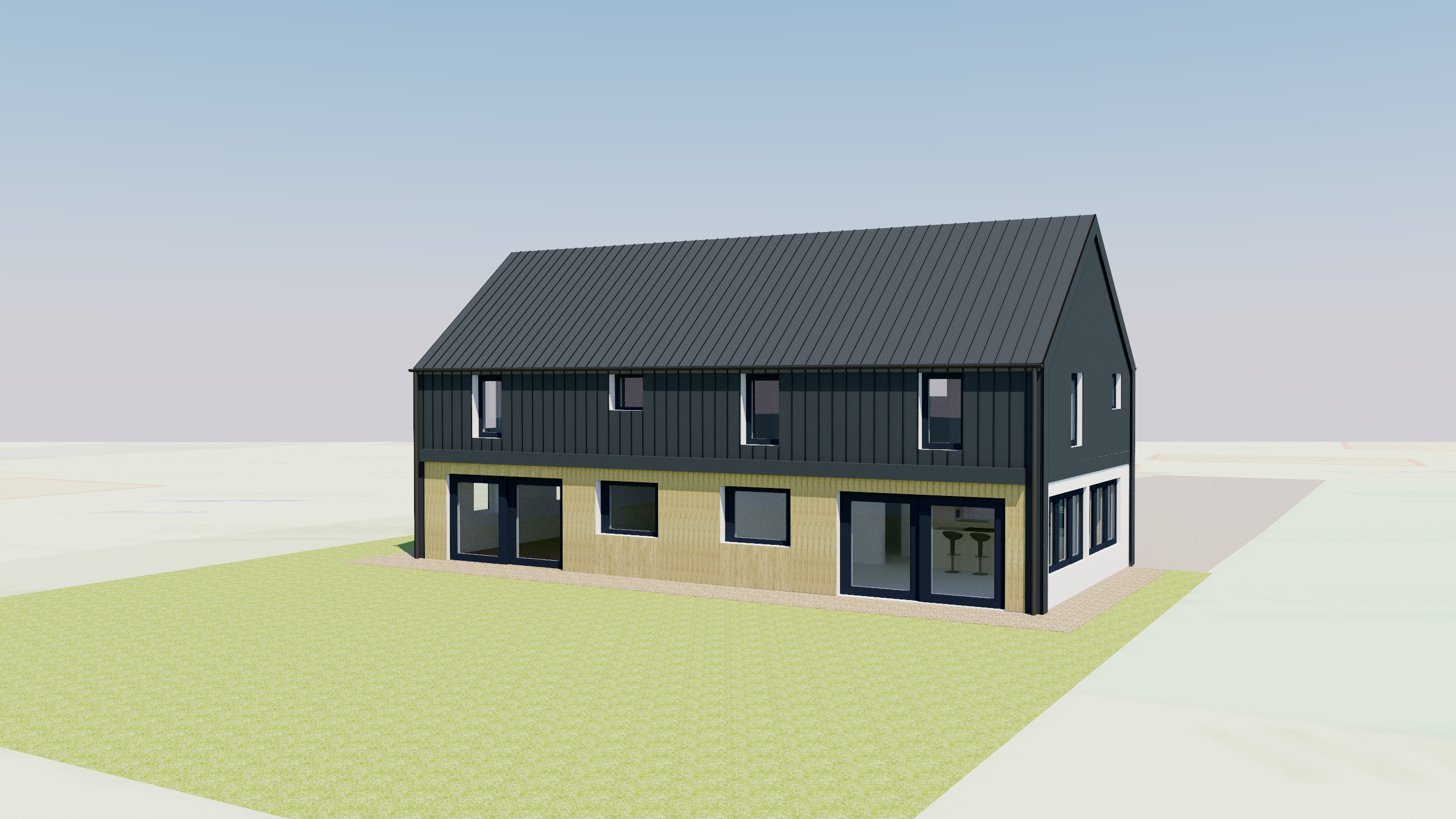

graeme m Posted January 9, 2018 Author Posted January 9, 2018 The issue is I have a small south facing roof at a low pitch 30m2, there's no space in the garden for panels, there is a large garage with a flat roof of 28m2 but as a condition of our planning Arun Council (howk Spit) have removed any permitting developement rights so I'm not even sure we can use the garage roof. The plan is to prepare the house for batteries and install once they become viable. I can fit a gas boiler as back up but was hoping to avoid this. I'm just not sure we can get enough KWs from the space.

graeme m Posted January 9, 2018 Author Posted January 9, 2018 10 minutes ago, Ferdinand said: Can you fit an in roof system which is flush without pd? Would that retrofit? Or you could apply for PP. Ferdinand have a look at the plan and you'll see what we have. The roof is zinc, we can either run between the joins or cut around the panels or sit on top, not keen on the las option.512-1-002-ProposedFloor&RoofPlans-10.pdf512-1-002-ProposedFloor&RoofPlans-10.pdf
Ferdinand Posted January 9, 2018 Posted January 9, 2018 (edited) Sorry ... thought it was an existing roof. My bad. Could you also or alternatively do a brise soleil like this to shade your windows, which would give you more solar panel area and perhaps fill an energy gap? Would give you 6-10 or so panels, perhaps 1.6-2 kWp or 3kWp+, depending on density of panels. It is at a Grand Design called Underhill House. Possibly the 1st certified ph in the country. More info. http://www.seymoursmith.co.uk/underhill-psv.php Just an idea. Attachment to the wall might skirt some Regs. Edited January 9, 2018 by Ferdinand
Russdl Posted January 9, 2018 Posted January 9, 2018 5 hours ago, graeme m said: Ferdinand have a look at the plan and you'll see what we have. The roof is zinc, we can either run between the joins or cut around the panels or sit on top, not keen on the las option Hi Graeme, that's not hugely dissimilar to what we have planned and, if we get planning, we're hoping to use the Tata Steel panels that incorporate built in PV. The PV is in strips and is bonded to each panel, between the standing seams. Copied below is the response from BIPVCo after my request for information regarding our own plans which may be of some use. I hasten to add, I have no idea if this product is good, bad or indifferent. Thank you for your email. Across a 15.5m roof, you could fit up to 39 Urban panels if you used a 390mm width panel. Lets say 37 to allow for end panels A 4.8m long roof could accommodate a 219w panel, so that’s 219 x 37 = 8.1kWp across one roof The cost of each module (excluding the inverters, cabling etc), supply only, would be £361.35 ex vat/delivery

graeme m Posted January 14, 2018 Author Posted January 14, 2018 On 1/9/2018 at 17:04, Russdl said: Hi Graeme, that's not hugely dissimilar to what we have planned and, if we get planning, we're hoping to use the Tata Steel panels that incorporate built in PV. The PV is in strips and is bonded to each panel, between the standing seams. Copied below is the response from BIPVCo after my request for information regarding our own plans which may be of some use. I hasten to add, I have no idea if this product is good, bad or indifferent. Thank you for your email. Across a 15.5m roof, you could fit up to 39 Urban panels if you used a 390mm width panel. Lets say 37 to allow for end panels A 4.8m long roof could accommodate a 219w panel, so that’s 219 x 37 = 8.1kWp across one roof The cost of each module (excluding the inverters, cabling etc), supply only, would be £361.35 ex vat/delivery Thanks for that. We have looked at those flexi panels, they look good but they aren't as efficient at fixed panels. I don't think we'd gain anything but I will look again.
