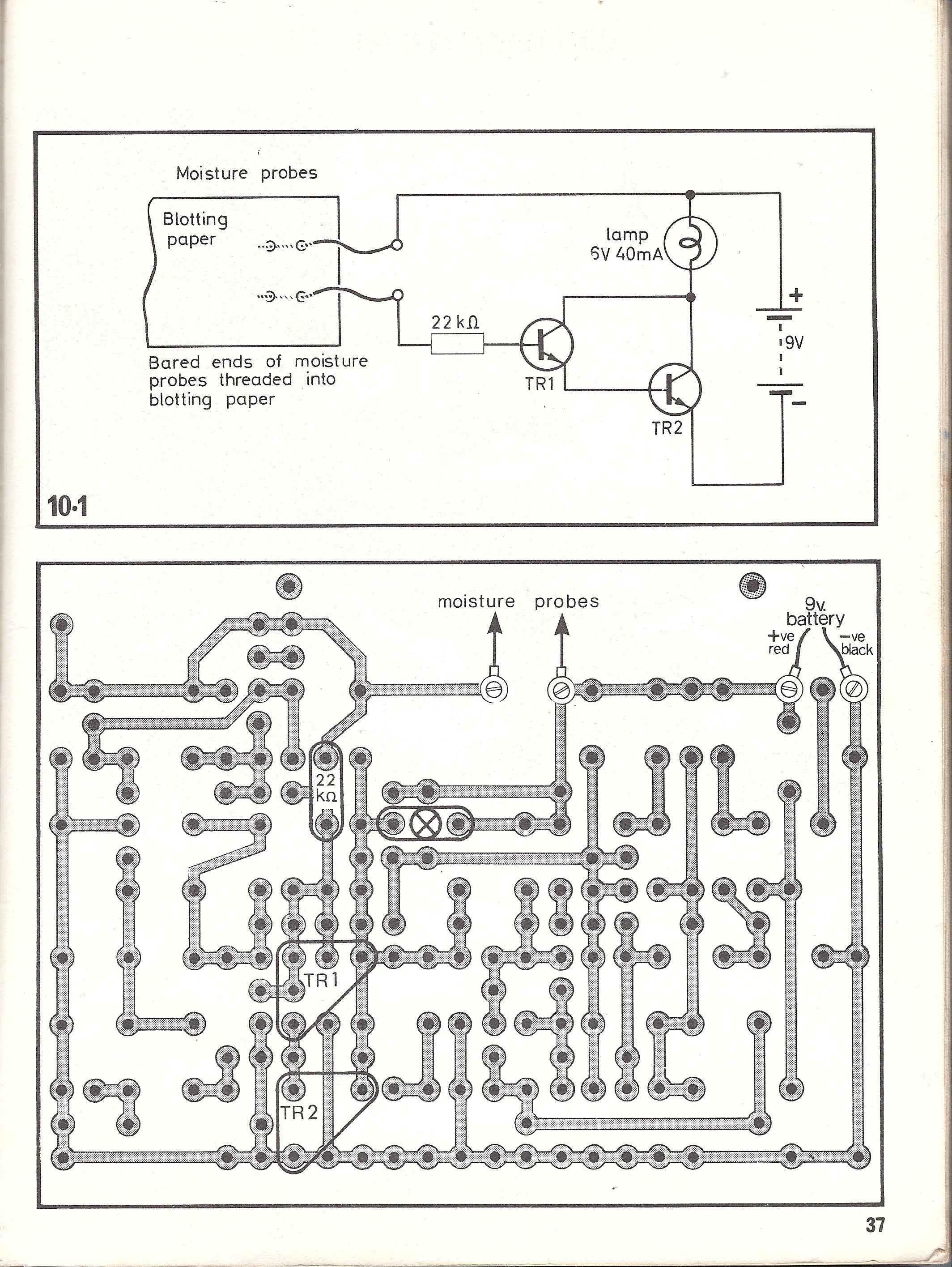

Old school! :)
From the electronics kit I got for Christmas in 1973, I used Veroboard instead of blotting paper...it went green outside! I remember trying to convince my Mum all she needed to do was watch for the lamp to light to know it was raining:
