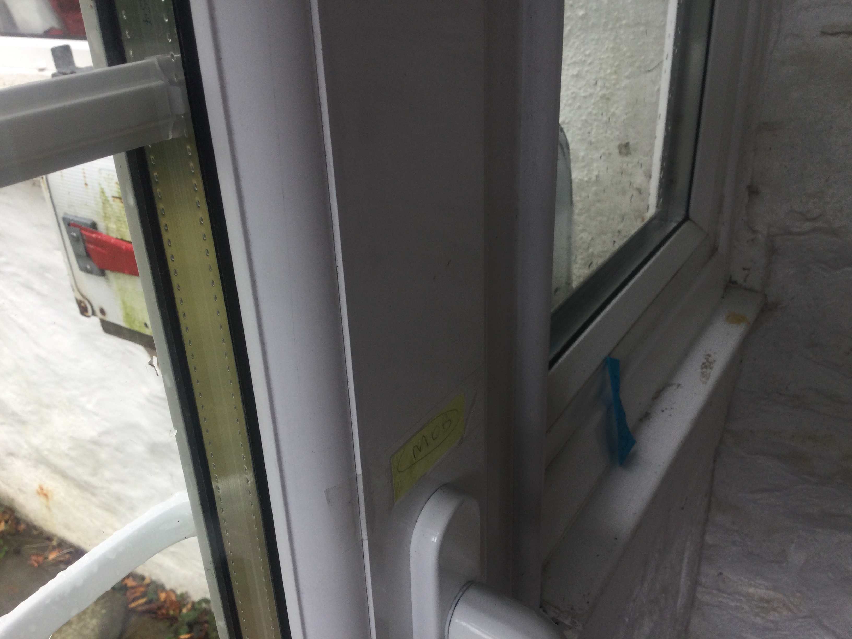

August 25, 20251 yr Author 1 minute ago, dpmiller said: how does the door look like it's fitting into the frame as it closes- are any of the latchy bits rubbing anywhere? Hi there dpm, no nasty catching on latch bits thankfully. Only at the door plastic at the bottom, clashing on the steel rim of the cill. I understand this -does suggest innitially- that the door's simply gone out of kilter & drooped a tad on the lockside. But you see the house's upvc door & windows, along with 2 extensions, are clearly not a pro job. A decent-effort amateur job, yes. But an awful lot of sub par (even to my amateur stds). Eg WC timber doorframe badly not vertical so the door just closes irritatingly whenever you open it/ EG white silcone to fit the last window trim bits looks like a child's done it! So my hunch is, the chaps's just not hung the upvc front door very well ~20 yrs ago. Thanks Zoot.
August 25, 20251 yr Just fix it. Shimming little double glazed units is easy. Buy yourself the plastic wedge/lever so you don't bugger the glass and get on with it as per below: I've just done my 2100 x 900 mm full glass / triple glazed units - heavy swines - much the same way. Used birch ply spacers (on top of the channel spacer) rather than plastic as the plastic has a tendency to deform over time where the birch does not. That, and I had the birch ply and a chopsaw to cut it to size, but no plastic. Timber cut end grain also works.

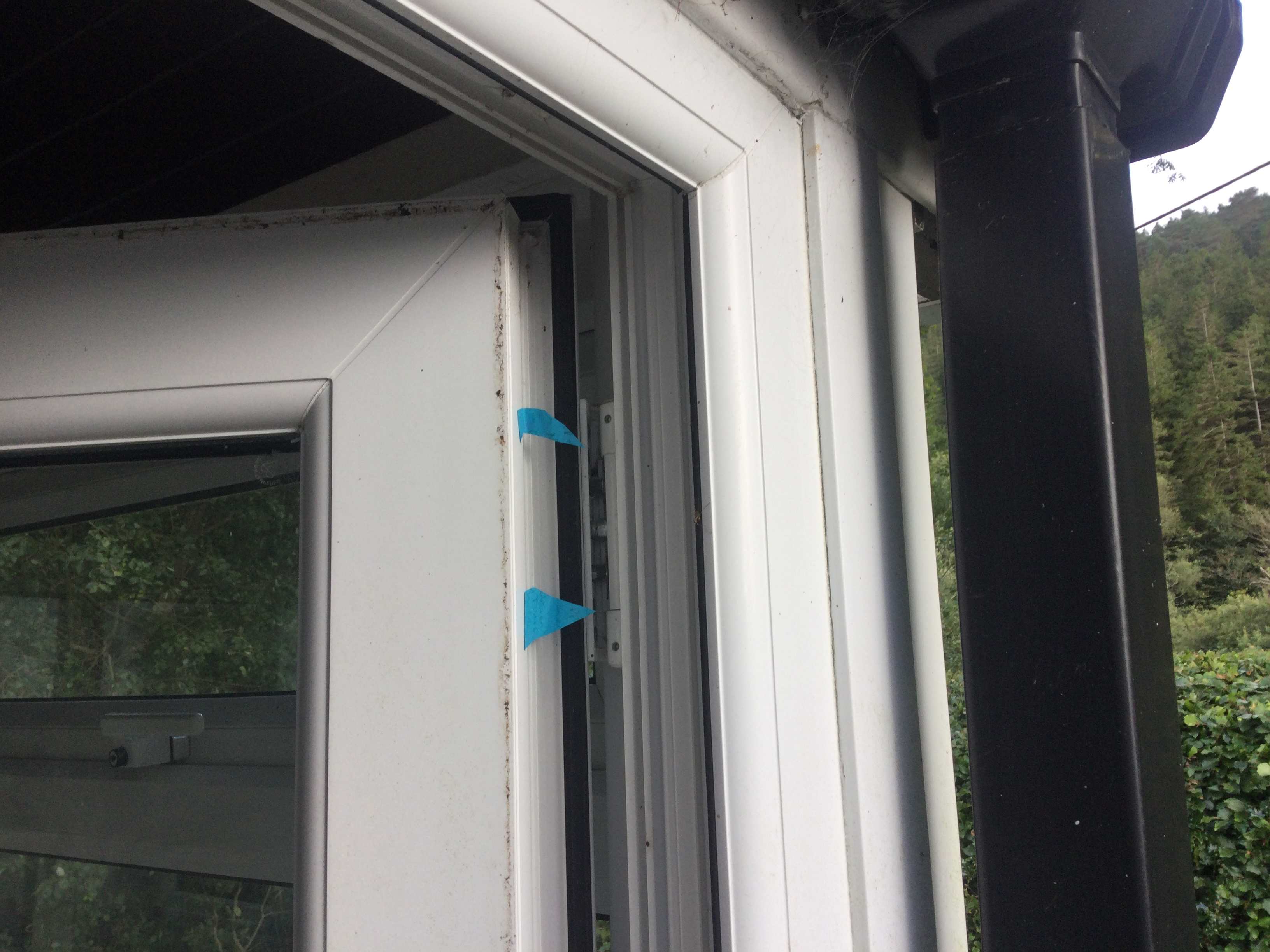

August 29, 20251 yr Author @MPH243 alas not: The large outer wrap around section of the hinge, cannot be levered off. It's metal for one thing, & seems to be fixed in place by 4x screws too (on the peskiest angle, so could only be accessed by removing the door). Bloody thing!! Driven me stark raving bonkers this. I conclude I'm defeated for now. Thanks anyway. Zh

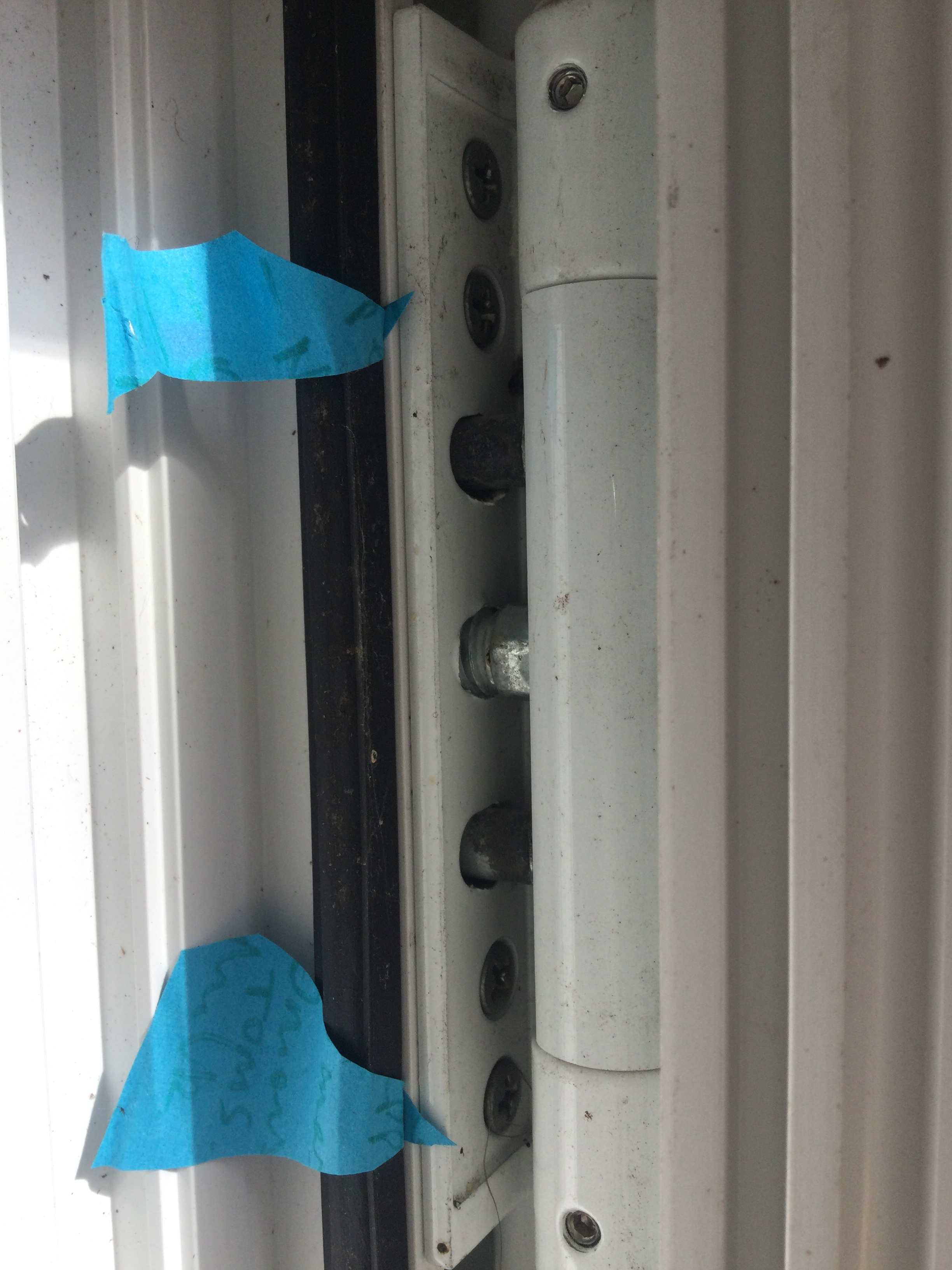

August 29, 20251 yr Author Ok last go.. Here is the inside of my hinge. Photo 1 taken from the outside to see general orientation. Photo 2 is a close up from same angle, to show 4x screws (blue pointed markers just aiming at each pair of them). These 4x screws seems to hold the large wrap around section in place, on the rearside the door. Even if I could access these 4x screws, the wrap around section wouldn't lift away, as there are two bar things within it preventing it, these two are either side of the nut section thing, that's bang centre of the hinge (which no spanner can make use of).
August 29, 20251 yr This is the type of hinge you have, it's known as an SFS hinge. An adjustment video can be seen here It might not be the exact same, but remove the covers. Is toe and healing the glass in this door, going to make a huge difference? Highly unlikely, the glass isn't a full panel of glass, it is 50% (approx) glass, 50% panel, with a transom midway. From what I'm seeing, the likely cause is a sash drop and the top 2 hinges need adjusted to move the door laterally. Edited August 29, 20251 yr by craig
August 29, 20251 yr Author @craig That's terrific help thanks, so the centre nut thingy -is- the right thing to do, & -can- be adjusted via a small spanner despite the room constraints here. Ok great, will buy one of these. I'd given up hope tbh! Gratefully, Zoot

August 29, 20251 yr Author @craig I don't suppose you'd know what the spanner size tends to be with these? Is that a question too far.. mine I've put a brass measuring caliper thing on, seems to be 9mm but I can't get be 100% certain. This seems a bit of an odd figure, & 9mm isn't in the typical spanner set someone kindly linked to. Thanks, ZH
August 29, 20251 yr It’s either 8mm or 10mm, can’t recall from top of my head to be honest. Edited August 29, 20251 yr by craig
August 29, 20251 yr Author 3 minutes ago, craig said: Just checked, it is 9mm. Fantastic, thanks so much. Useful to know about the toe & heel process though: I guess it just needs determining, first off, if the door has indeed dropped on the lock side, or is still square: mine -seems- to be still square. Although without a huge builders L shaped set square, must admit I can't be certain. zoot
August 29, 20251 yr Tape measure/string, corner to corner diagonally on door sash and you’ll have your answer. Edited August 29, 20251 yr by craig
August 29, 20251 yr 2 hours ago, craig said: Tape measure/string, corner to corner diagonally on door sash and you’ll have your answer. AND check both diagonals of the door FRAME as well.
August 30, 20251 yr Author 17 hours ago, craig said: Tape measure/string, corner to corner diagonally on door sash and you’ll have your answer. Hi craig, ok then doing this as suggested earlier in thread, I get 79-1/8" on the door corner to corner. So the solution is thankfully, to tweak the hinges. So I've got spanners bought, as access restricted. Now I have 4 hinges: so how do I go about this pulling the door 'in' at the top-? Is it to loosen off the two middle ones.. & tighten/ pull the door in at the top one/ get the other two back tensioned-up? Maybe wedge door 1st? Thanks, Zoot
August 30, 20251 yr Trial and error to be honest, an experienced eye would be able to judge but it definitely looks like you need to pull in the too hinges and possibly release the bottom a little.
