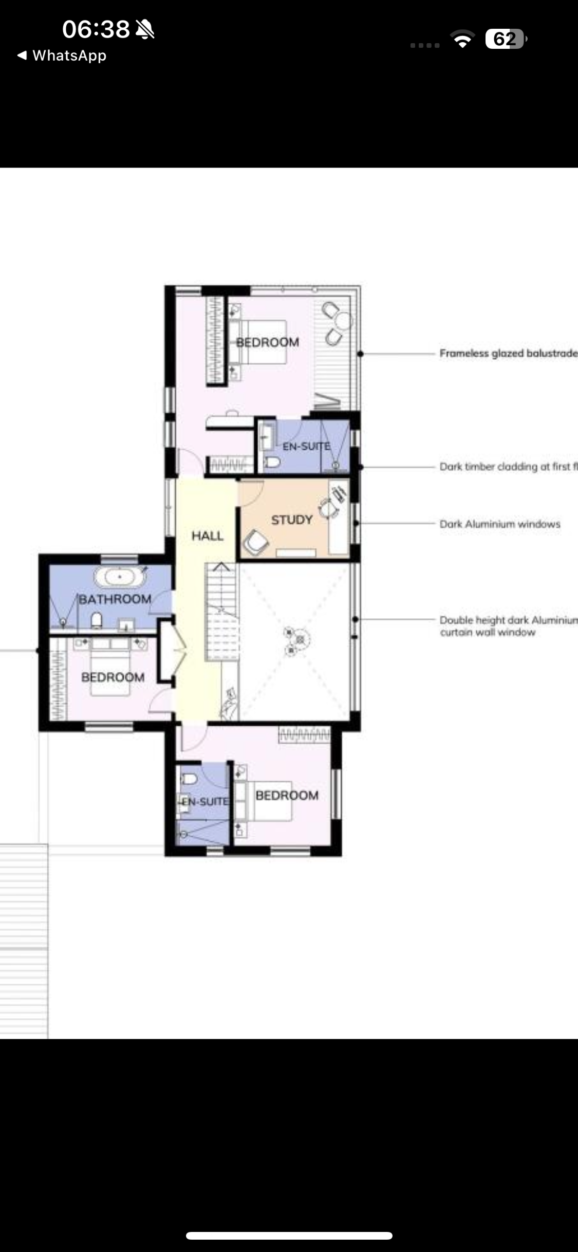

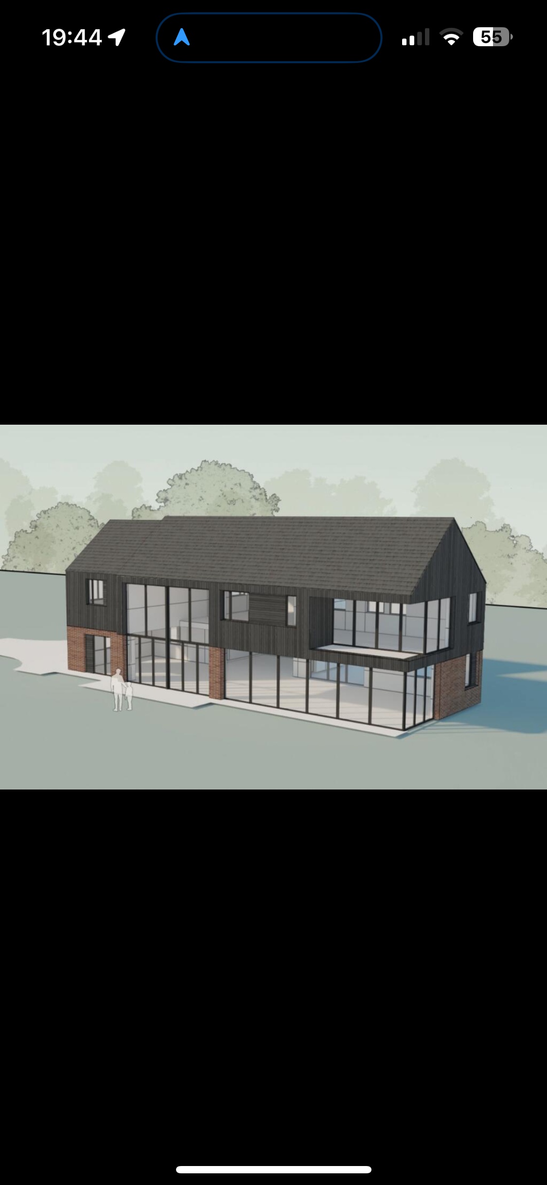

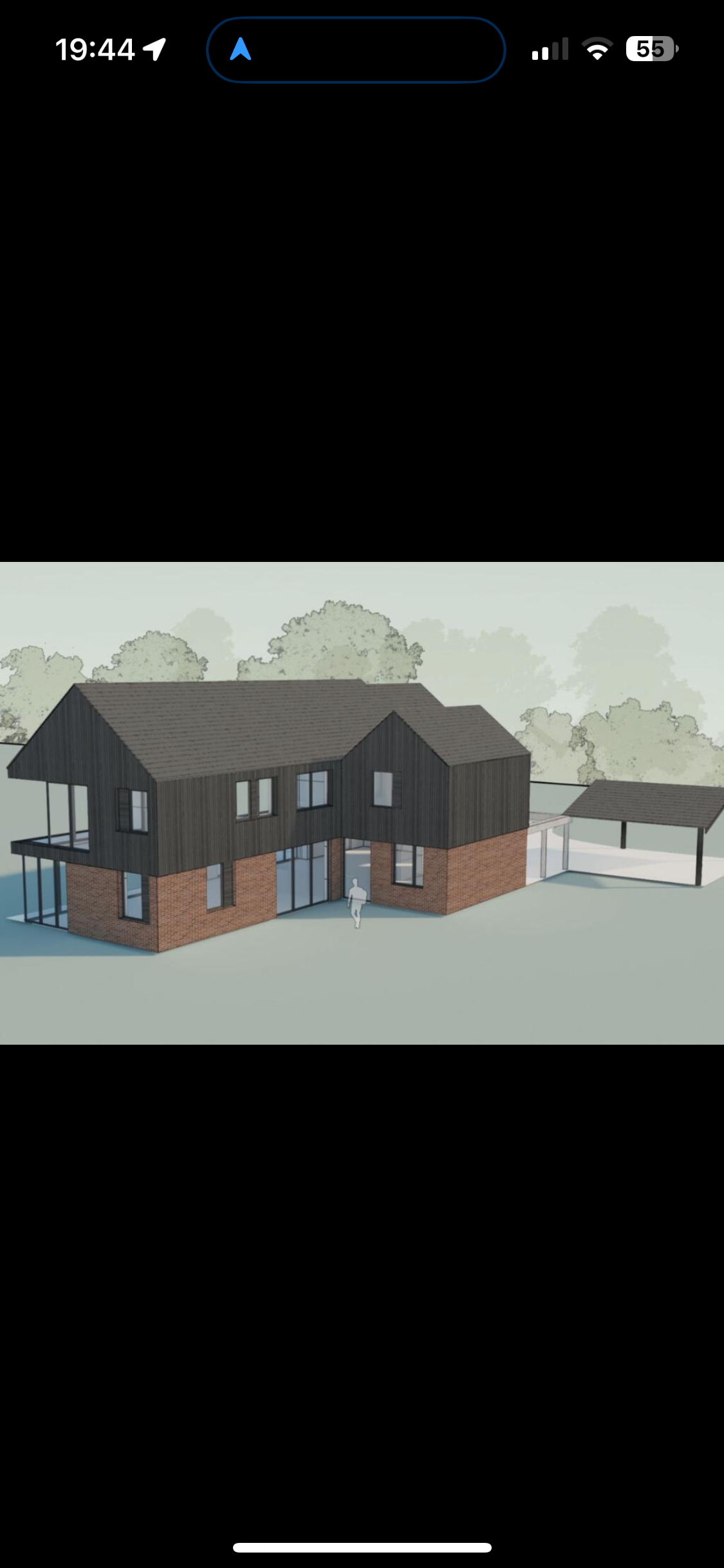

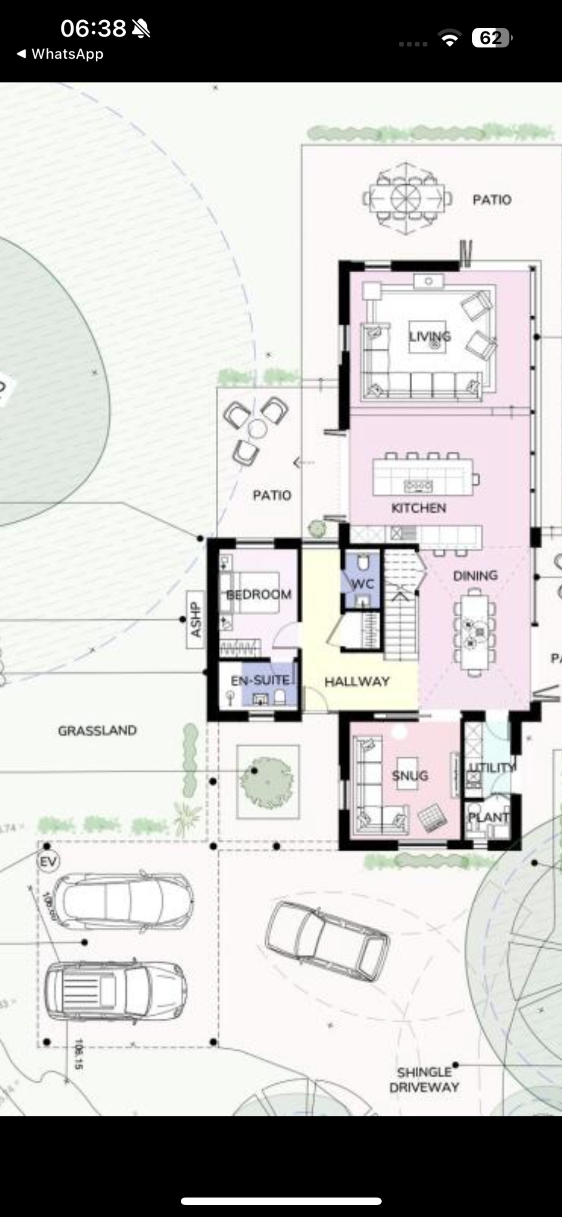

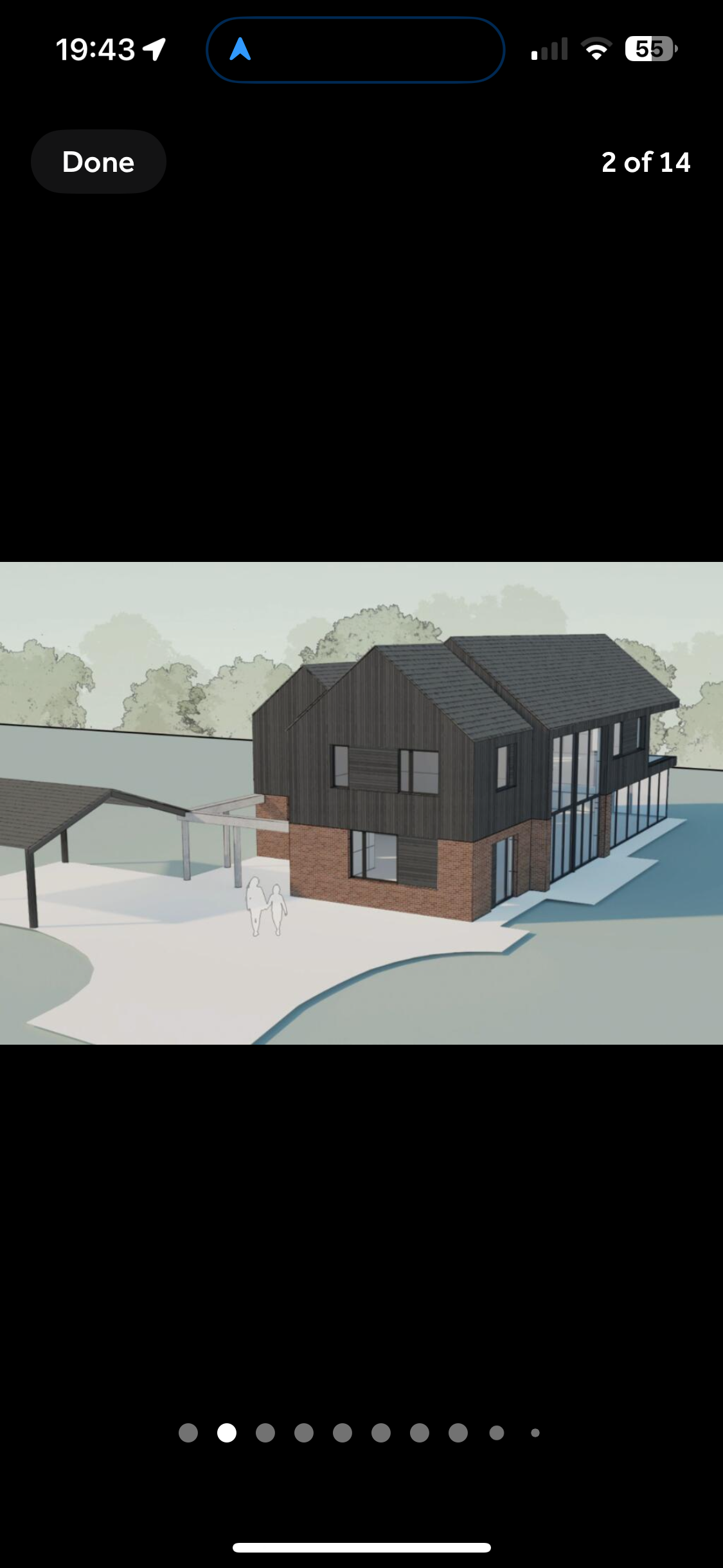

So it’s on a 0.5 plot the house is going to be 270m it just has full planning permission IMG_6521.thumb.png.f4d47482e818a11caaa60f86ce4c7480.png
The first thing that springs to mind is overheating…
Yep. It will need some mitigation. You’ll need to do that anyway. Personally I think there’s too much glass just from an aesthetic perspective.
I think the way it’s been designed like this as it’s open fields I’m sure I’ll have to get the correct glass

We've done solar reflective glazing for a few clients builds, works far better than I first thought it would. Part O compliance will be a big thing for this design, if you want to keep all the glazing for the views/personal preference etc, but it is a LOT of glass tbh.
Defo look at installing an ASHP so you can get cooling via chilled water > UFH and air handling. Either that or you're likely to need air conditioning in the upstairs rooms to make them tolerable during the peak of summer. Heating a well insulated, airtight house is a doddle in comparison to keeping it cool ;)

Is the most glazed elevation (by m2) south or west facing? If so you're more likely to get in trouble with Part O.

the main glass is east

If East and assuming you are in a moderate risk location, you can have no more glazed area than 18% of your internal floor area. That's using the simplified method.
Normally my hunch is that if you want brick facing, then build cavity walls. But with all that glass you need beams. Plus the first floor is timber clad.  So I think stick build.
So you don’t recommend timber framed for this
5 hours ago, Roof said:
timber framed
The proper term for stick build.
So yes timber I think, but tell more please. Are there big rooms that will need beams? Confirm is brick facing on GF intended and timber clad FF?
Too much glazing imo.  Overheating, heat loss, where to place furniture, privacy, structure (how's that east corner actually going to be built?), aesthetics...
