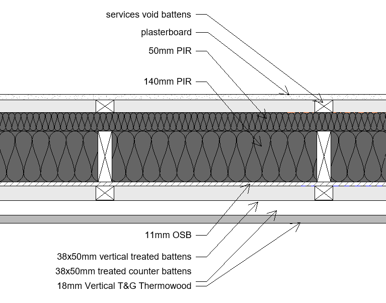

Ceiling service void size for domestic sprinkler system
Stratman replied to MattD's topic in New House & Self Build Design
Fantastic - thank you! And I see the pipes are just tucked over the battens below the VCL. -
Hi There Looks like you didn't get any responses to your query. Did you get it resolved in the end? We will have vaulted ceilings upstairs and I just came across similar advice from the sprinkler company - actually 130mm void. Also in Wales by the way. The TF supplier is installing only 25mm service battens below the VCL to the underside of the roof joists. Does anyone out there have any experience or suggestions? -

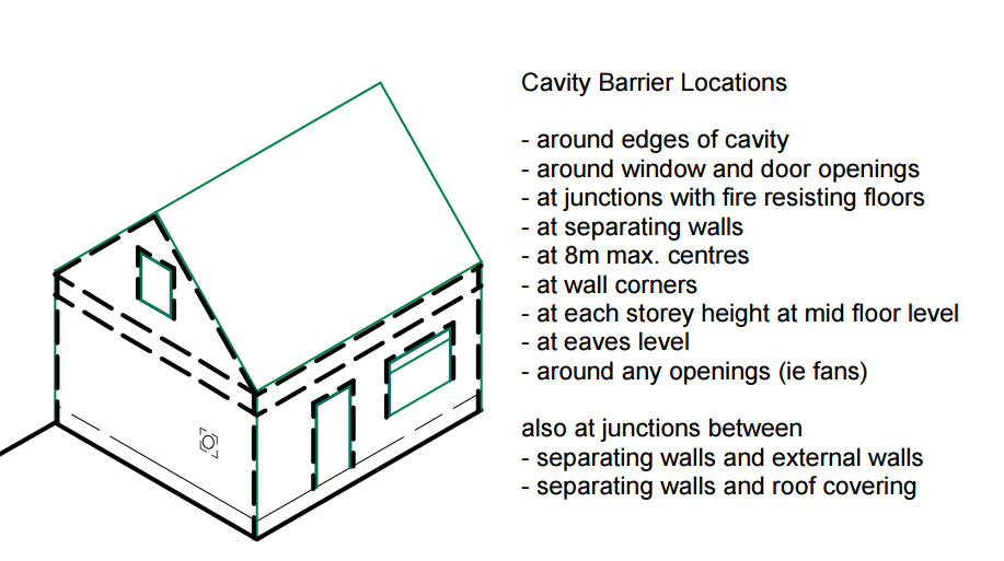

Cavity barriers in external walls FAQ.pdf This document might help with locations for cavity barriers in external walls by LABC Warranty. I also found this diagram helpful:
