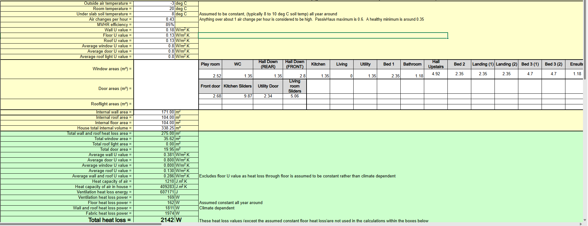

flanagaj Posted July 22, 2025 Author Posted July 22, 2025 Below is my heat loss calculation. So according to the below I need something that can output ~ 2Kw if I don't want the house to get cold when it is -3c outside. So a 3Kw unit would suffice, but I assume I also need to factor in the corresponding Kw for hot water heating. If so, how do you go about doing the calculation?
JohnMo Posted July 22, 2025 Posted July 22, 2025 (edited) Looking to heat DHW takes around 1 hour each time. So say doing 2x heats per day. So you have 22 hours to provide 24 hrs of heating. (2142*24)/22, adds a couple of hundred watts only. Small heat loads need some thinking about, because too small an ASHP, DHW can take an age to heat. You really cannot or have zones, even if you wanted. As heat pump would cycle to much. Your heat pump is going to be oversized, but you can live with that with a simple simple system. Edited July 22, 2025 by JohnMo
Ben1984 Posted July 22, 2025 Posted July 22, 2025 1 hour ago, flanagaj said: Below is my heat loss calculation. So according to the below I need something that can output ~ 2Kw if I don't want the house to get cold when it is -3c outside. So a 3Kw unit would suffice, but I assume I also need to factor in the corresponding Kw for hot water heating. If so, how do you go about doing the calculation? What did you use to produce these figures?
MikeSharp01 Posted July 22, 2025 Posted July 22, 2025 10 minutes ago, flanagaj said: Below is my heat loss calculation. So according to the below I need something that can output ~ 2Kw if I don't want the house to get cold when it is -3c outside. So a 3Kw unit would suffice, but I assume I also need to factor in the corresponding Kw for hot water heating. If so, how do you go about doing the calculation? Calculation is a good plan but won't account for absolute capabilities of the ASHP itself so your outcome will inevitably be a compromise between the absolute theoretical demand worst case (which you already have for heating @ 2kW) the rate at which you want to reheat your domestic hot water (DHW) and any additional strategies you may want to put in place e.g. direct electric heating of the DHW to support fast re-heat and your overall control strategy - see below. You will need to decide what operational strategy you are going for as this also impacts the final system - will you just run the system as a single open loop with weather compensation or have a number of zones all controlled separately by their own thermostats or some other combination. In the end you will arrive at a simple set of high level options all of which will have details that define the physical system and its components: Small ASHP say 3kW able to modulate down to 1.5kW which will run your heating, with some short cycling (ON/OFF) because only on the coldest days does the ASHP match the load perfectly on all others it has more output than you need and a slow heating of DHW, if you want faster then the immersion heater is available. A larger ASHP say 6kW that might modulate down to about 2kW which will run your heating but with more short cycling because it is oversized but your DHW reheat will be much quicker and so direct heating is less likely to be needed. Do not forget that ASHPs have a standby power drain, keeping the crankcase warm etc, that may be factor for you and you may want to factor in cooling as a possibility which will ask more questions of ASHP particularly the smaller ones. 1
MikeSharp01 Posted July 22, 2025 Posted July 22, 2025 10 minutes ago, Ben1984 said: What did you use to produce these figures? Looks like the JS Harris spreadsheet to me. 1
ProDave Posted July 22, 2025 Posted July 22, 2025 So you need 3kW of heat. That would assume your heating is on 24/7. It won't be, not unless you have something else to heat the hot water. In any event, there are very few 3kW ASHP's made. the smallest is generally 5kW. That will do your heating without having to be on 24/7 leaving time for DHW heating as well. A 5kW ASHP will typically use less than 2 kW of electricity so that's about 8 amps. It won't be the ASHP that tips you over 100A. Re the house going cold. Up here -10 is not unusual and that is what I used to size mine and the house is still snug and warm at that. So your real concern is your total load. 100A seems way too high. As if you are not applying diversity and assuming everything will be on at the same time? Post your calculations that says you will exceed 100A for us to analyse. 1

flanagaj Posted July 22, 2025 Author Posted July 22, 2025 41 minutes ago, MikeSharp01 said: Calculation is a good plan but won't account for absolute capabilities of the ASHP itself so your outcome will inevitably be a compromise between the absolute theoretical demand worst case (which you already have for heating @ 2kW) the rate at which you want to reheat your domestic hot water (DHW) and any additional strategies you may want to put in place e.g. direct electric heating of the DHW to support fast re-heat and your overall control strategy - see below. You will need to decide what operational strategy you are going for as this also impacts the final system - will you just run the system as a single open loop with weather compensation or have a number of zones all controlled separately by their own thermostats or some other combination. In the end you will arrive at a simple set of high level options all of which will have details that define the physical system and its components: Small ASHP say 3kW able to modulate down to 1.5kW which will run your heating, with some short cycling (ON/OFF) because only on the coldest days does the ASHP match the load perfectly on all others it has more output than you need and a slow heating of DHW, if you want faster then the immersion heater is available. A larger ASHP say 6kW that might modulate down to about 2kW which will run your heating but with more short cycling because it is oversized but your DHW reheat will be much quicker and so direct heating is less likely to be needed. Do not forget that ASHPs have a standby power drain, keeping the crankcase warm etc, that may be factor for you and you may want to factor in cooling as a possibility which will ask more questions of ASHP particularly the smaller ones. Thanks. It's all so complicated. Makes my head spin.
