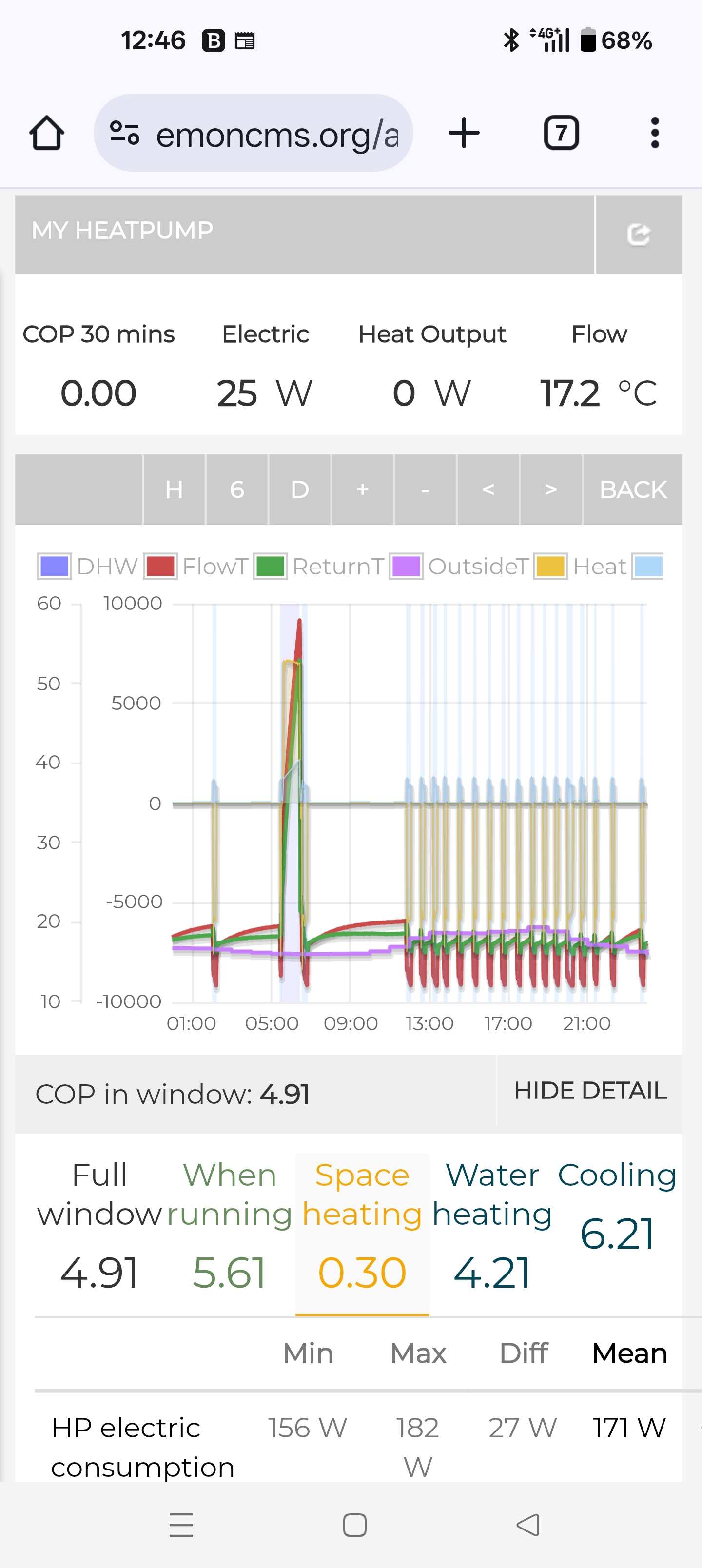

Here is mine, put out 22kWh in 24 hrs, so less than 1kW average.  In cooling mode, note the cop when running and average CoP over day.
 Screenshot_2025-07-22-12-46-38-73_40deb401b9ffe8e1df2f1cc5ba480b12.thumb.jpg.18ad9f99ef2ca31c2612414f59e05403.jpg.

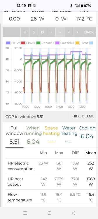

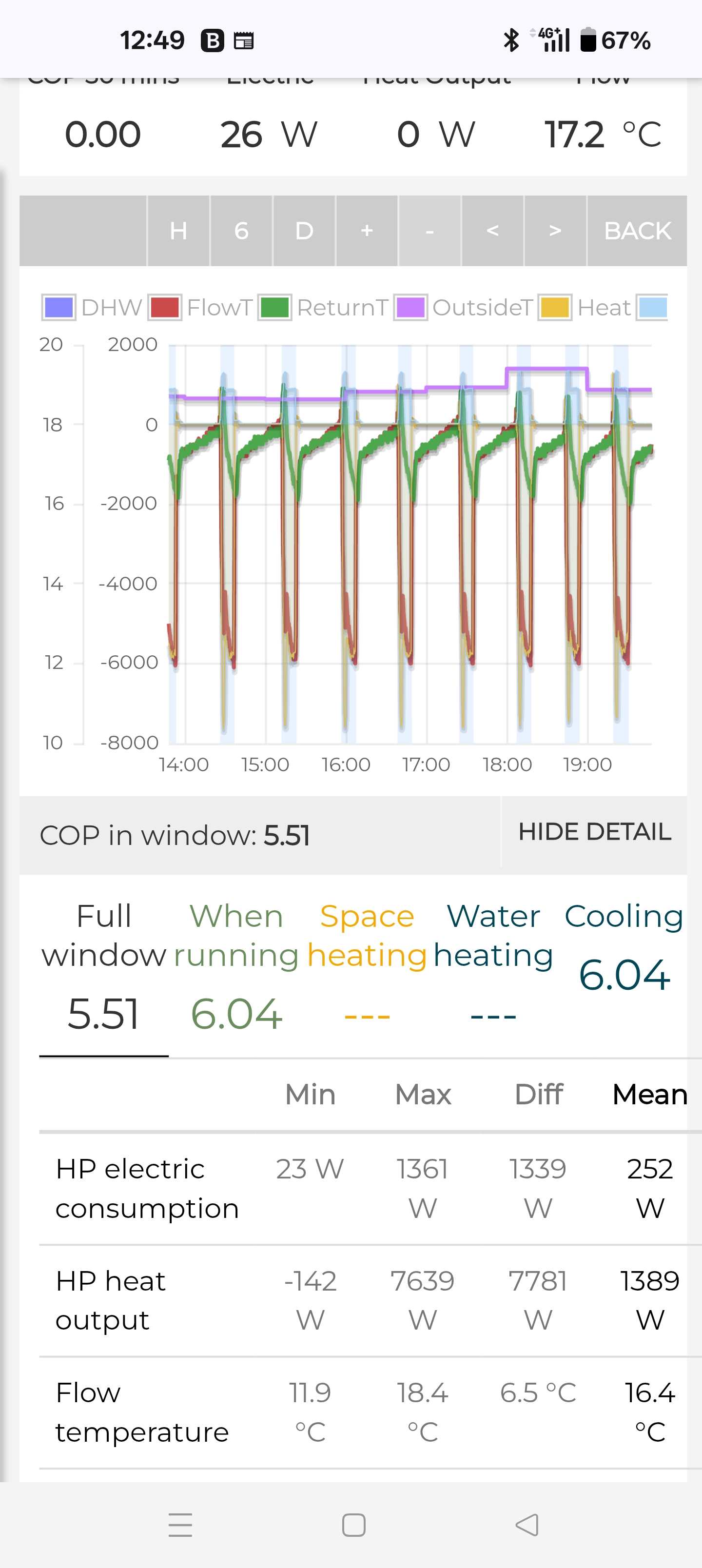

Zoomed in to show cycling, which all nice and controlled. That's how they do capacity control below minimum modulation.
Screenshot_2025-07-22-12-49-09-56_40deb401b9ffe8e1df2f1cc5ba480b12.thumb.jpg.b1c71f56b9b00d9d66d6e755174826f8.jpg

You don't even need that. As you see my heat pump was off (except spike doing DHW at 0500) from 0100 to 1300. That's just letting the ASHP run when it's controller says to - nothing in house at all controlling that, just sensing return temperature and outside temperature influences.

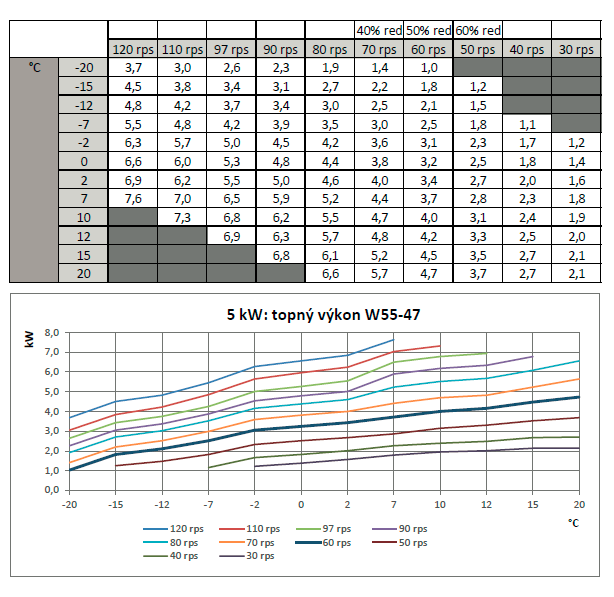

Yes. E.g. the Vaillant 5kW will go down to about 1/3 output or about 1.7kW
Their 3.5 kW unit is simply the same with a s/w limit to 85rps compressor speed, so does not modulate any lower than the 5kW does. Below that they will cycle but if there is a reasonable system volume that is not a problem, the (adjustable) Energy Integral algorithm limits it to about 2 cycles/hr, anything less than 3 is generally thought to be OK.
