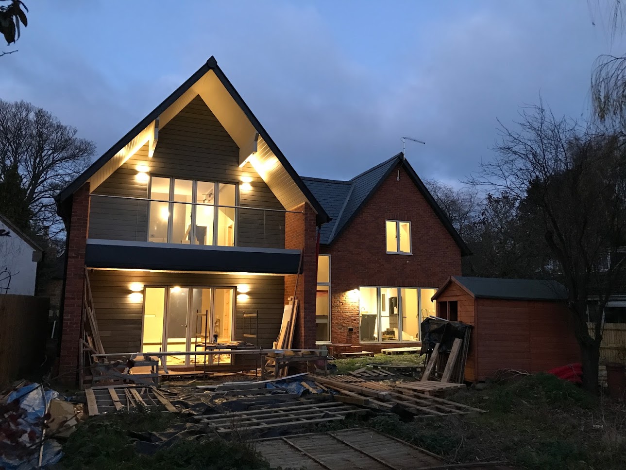

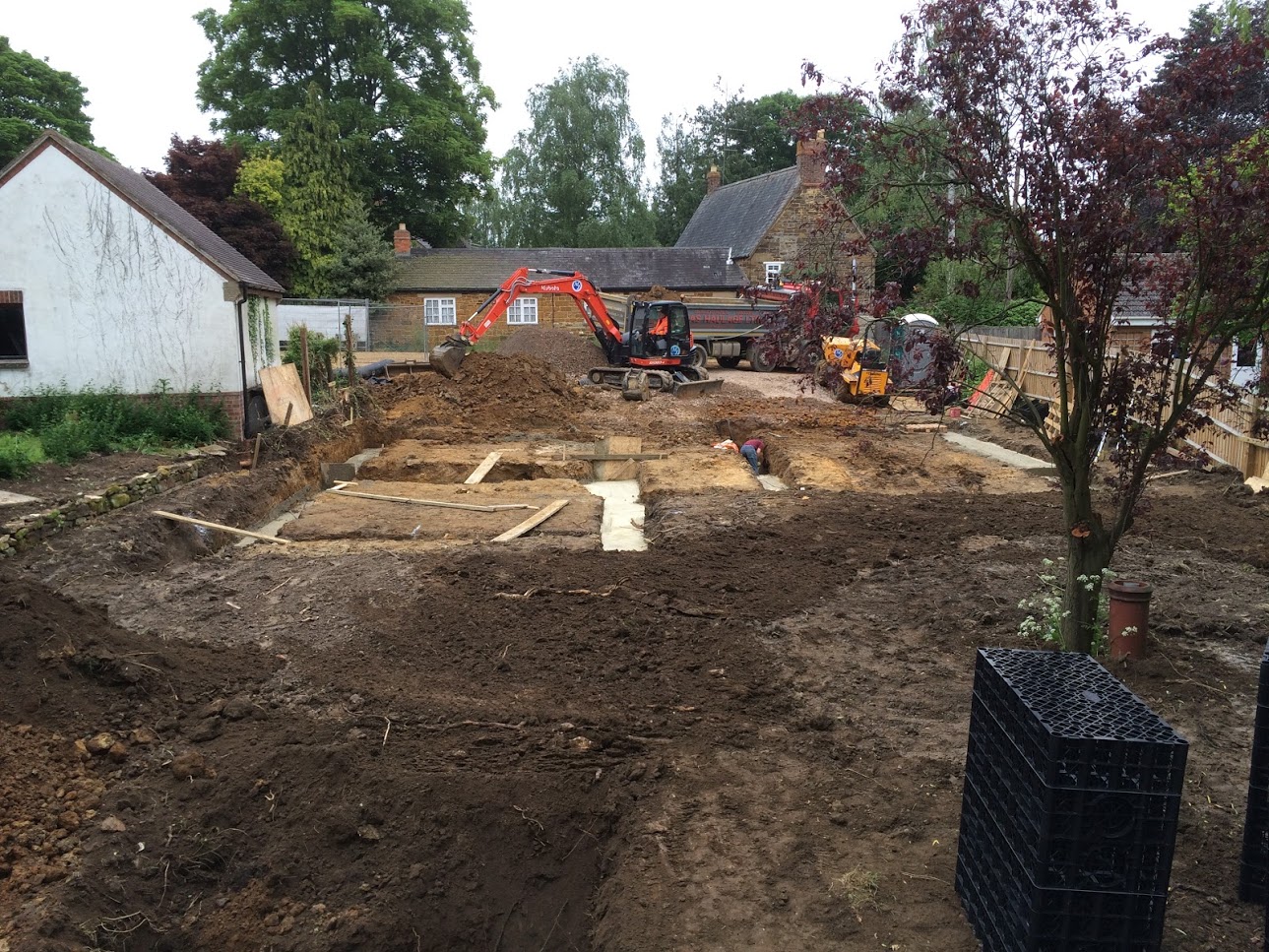

RandAbuild Posted December 27, 2017 Posted December 27, 2017 (edited) May 2016 Nov 2017 Edited December 27, 2017 by RandAbuild Wrong date! 7
