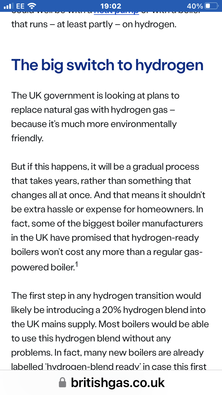

nod Posted 21 hours ago Posted 21 hours ago 5 hours ago, Wadrian said: Hi everyone we are soon to be starting on our self build re: services connection being one of first tasks. I know the regs are changing re gas heating - boilers etc and the need to have heat pumps installed. With that in mind was wondering if it is still worthwhile having a gas connection to the property? There’s nothing stopping you from installing a gas boiler Cheaper to run than a HP Legislation was supposed to faze out gas boilers on new builds by 2024 Which was never going to happen I’m not sure what the date is now But it won’t happen More likely to be hydrogen Which still uses mostly gas
SteamyTea Posted 20 hours ago Posted 20 hours ago 5 minutes ago, nod said: More likely to be hydrogen Really. Unless the oil industry, who are the experts at deep, directional, drilling convince the government of the day that there are unbound, deep, hydrogen reserves, right underneath finite, geological methane reserves, it isn't going to happen. Hydrogen is pretty poor energy carrier, and we would not be burning it anyway, it would pass though 'fool's ells". 1
nod Posted 20 hours ago Posted 20 hours ago 7 minutes ago, SteamyTea said: Really. Unless the oil industry, who are the experts at deep, directional, drilling convince the government of the day that there are unbound, deep, hydrogen reserves, right underneath finite, geological methane reserves, it isn't going to happen. Hydrogen is pretty poor energy carrier, and we would not be burning it anyway, it would pass though 'fool's ells".
nod Posted 20 hours ago Posted 20 hours ago Just now, nod said: Most experts seem to agree that a gas boiler installed today Will run its lifetime on gas Many on here disagreed when I stated back in 2020 that there was zero chance of gas boilers being banned for new builds My logic was that none of the heating companies whee preparing for this at the time Very few are now Ive a friend who is a bg gas engineer and he said that the new gas boiler will run 70% gas when or if they do Allowing them not to be classed as a gas boiler Everywhere you go BG are laying and replacing gas mains They must have some reassurance from the powers that be

LnP Posted 14 hours ago Posted 14 hours ago It's telling that the clip @nod shared on the switch to hydrogen is from British Gas. The fossil industries, gas network operators and boiler manufacturers are lobbying hard on this.... naturally, because without it, they're sunk. Consider this, to heat your house by burning green hydrogen will require 5.5 times as much renewable electricity as heating it with a heat pump or twice as much if you heat your house with resistive electrical heating. That's 5.5 times as many wind farms. And as @Mike says, as more people make the switch to electrical heating, the fixed costs of operating the gas network will have to be shared among fewer consumers. For these reasons, hydrogen will be prohibitively expensive. Additionally, the safety issues of having hydrogen in your home are problematic. It has a wider flammable range, is easier to ignite, generates higher overpressures when it explodes and is harder to keep equipment leak tight. Additionally, hydrogen gas hobs release more NOx that natural gas. NOx has been implicated in respiratory diseases. There have been three trials proposed for domestic hydrogen in the UK, Whitby (near Ellesmere Port), Redcar and Fife - notably all disadvantaged areas where consumers might be more attracted by inducements from the vested interests sponsoring the proposed trials - Cadent, Northern Gas Networks, Scottish Gas Networks. Whitby and Redcar have been abandoned largely due to independent academics and engineers stepping in to shine a light on the safety issues and misinformation being provided to the residents. Cadent engaged the engineering company Arup to do the risk assessment for Whitby, to estimate the expected frequency of leaks and explosions. Introducing hydrogen with no additional engineering mitigation measures gave unacceptably high risks, higher than gas. They proposed measures to get the risk down to the same level as gas. They considered this level of risk to be tolerable which is in itself flawed, since legislation here requires risks to be managed to be as low as reasonably practicable - heat pumps are a practicable way to heat your home with less risk of fire and explosion. Some experts challenged other conclusions of the Arup risk assessment. There will be challenges to decarbonising by renewable electrification - grid capacity, curtailment, Dunkelflauten. But solutions are available. There are uses for hydrogen for which, unlike heating, there is no alternative - e.g. making ammonia or methanol and desulphurising fuels in refineries. That's the first priority for green hydrogen. But if science and economics are allowed to prevail over politics and lobbying, we won't be heating our homes with hydrogen. @Wadrian, I don't think you need a gas connection! 4

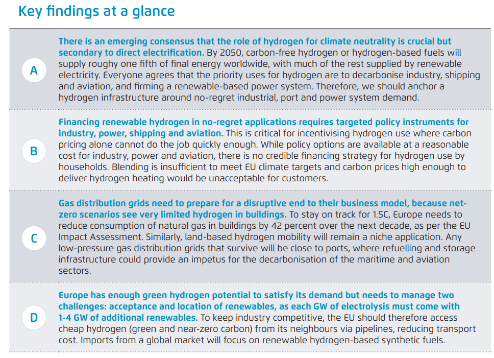

MikeSharp01 Posted 9 hours ago Posted 9 hours ago 7 hours ago, Mike said: *subject to UK variation - these are estimates for the whole EU from '12 Insights on Hydrogen', Gniewomir Flis & Matthias Deutsch for Agora Energiewende (page 22). An interesting read. Actually you can avoid going to page 22 as the 'Key Findings' from the link above say it all - finding 'C' mainly, an image of which is below, and leaves you with the gas pipe answer 'NO' - long term anyway. 2

nod Posted 8 hours ago Posted 8 hours ago 6 hours ago, LnP said: It's telling that the clip @nod shared on the switch to hydrogen is from British Gas. The fossil industries, gas network operators and boiler manufacturers are lobbying hard on this.... naturally, because without it, they're sunk. Consider this, to heat your house by burning green hydrogen will require 5.5 times as much renewable electricity as heating it with a heat pump or twice as much if you heat your house with resistive electrical heating. That's 5.5 times as many wind farms. And as @Mike says, as more people make the switch to electrical heating, the fixed costs of operating the gas network will have to be shared among fewer consumers. For these reasons, hydrogen will be prohibitively expensive. Additionally, the safety issues of having hydrogen in your home are problematic. It has a wider flammable range, is easier to ignite, generates higher overpressures when it explodes and is harder to keep equipment leak tight. Additionally, hydrogen gas hobs release more NOx that natural gas. NOx has been implicated in respiratory diseases. There have been three trials proposed for domestic hydrogen in the UK, Whitby (near Ellesmere Port), Redcar and Fife - notably all disadvantaged areas where consumers might be more attracted by inducements from the vested interests sponsoring the proposed trials - Cadent, Northern Gas Networks, Scottish Gas Networks. Whitby and Redcar have been abandoned largely due to independent academics and engineers stepping in to shine a light on the safety issues and misinformation being provided to the residents. Cadent engaged the engineering company Arup to do the risk assessment for Whitby, to estimate the expected frequency of leaks and explosions. Introducing hydrogen with no additional engineering mitigation measures gave unacceptably high risks, higher than gas. They proposed measures to get the risk down to the same level as gas. They considered this level of risk to be tolerable which is in itself flawed, since legislation here requires risks to be managed to be as low as reasonably practicable - heat pumps are a practicable way to heat your home with less risk of fire and explosion. Some experts challenged other conclusions of the Arup risk assessment. There will be challenges to decarbonising by renewable electrification - grid capacity, curtailment, Dunkelflauten. But solutions are available. There are uses for hydrogen for which, unlike heating, there is no alternative - e.g. making ammonia or methanol and desulphurising fuels in refineries. That's the first priority for green hydrogen. But if science and economics are allowed to prevail over politics and lobbying, we won't be heating our homes with hydrogen. @Wadrian, I don't think you need a gas connection! The problem that you have with switching to HPs Is in most homes the the running costs are considerably more than gas and are better suited to UFH A friend who has been fitting HPs for 22 years now Says that while electricity tracks gas This will always be the case I worked on a large estate in Liverpool where the HPs where being fitted free New Rads etc and hardly anyone was happy Complaining of high bills and cool Rads while watching Jeremy Kyle Not your typical eco warriors But the government needs to be honest I suspect that a variation of the gas boiler will be with us for decades
