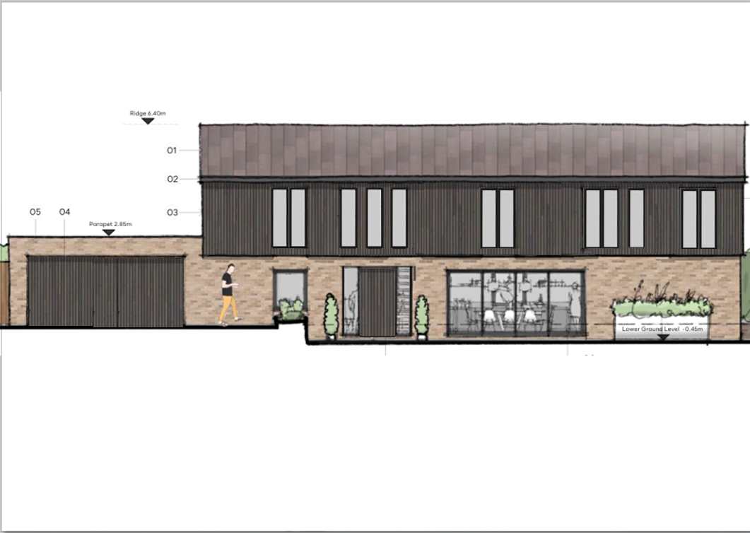

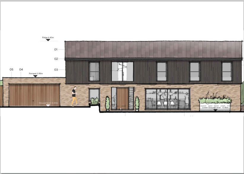

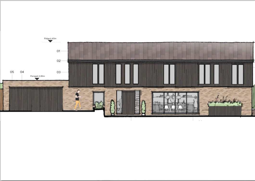

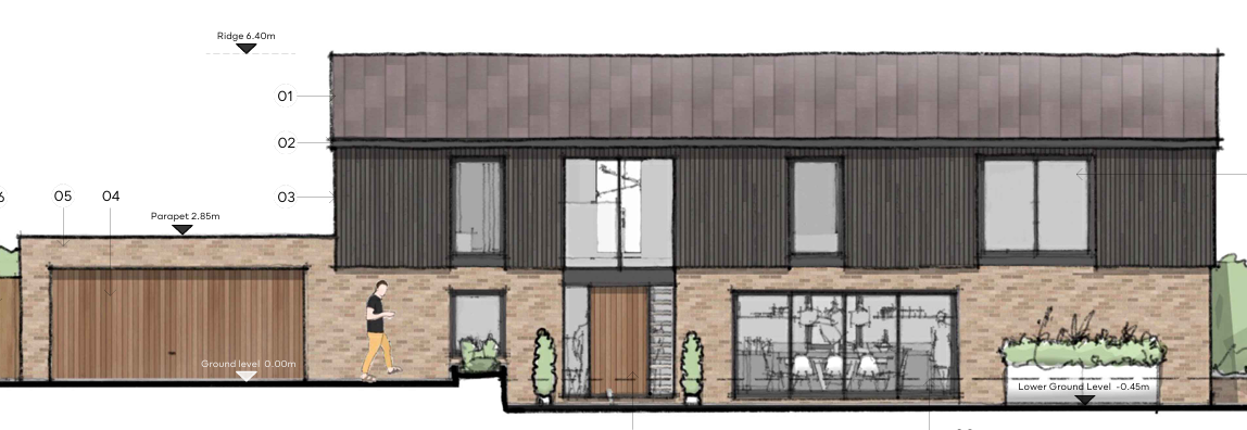

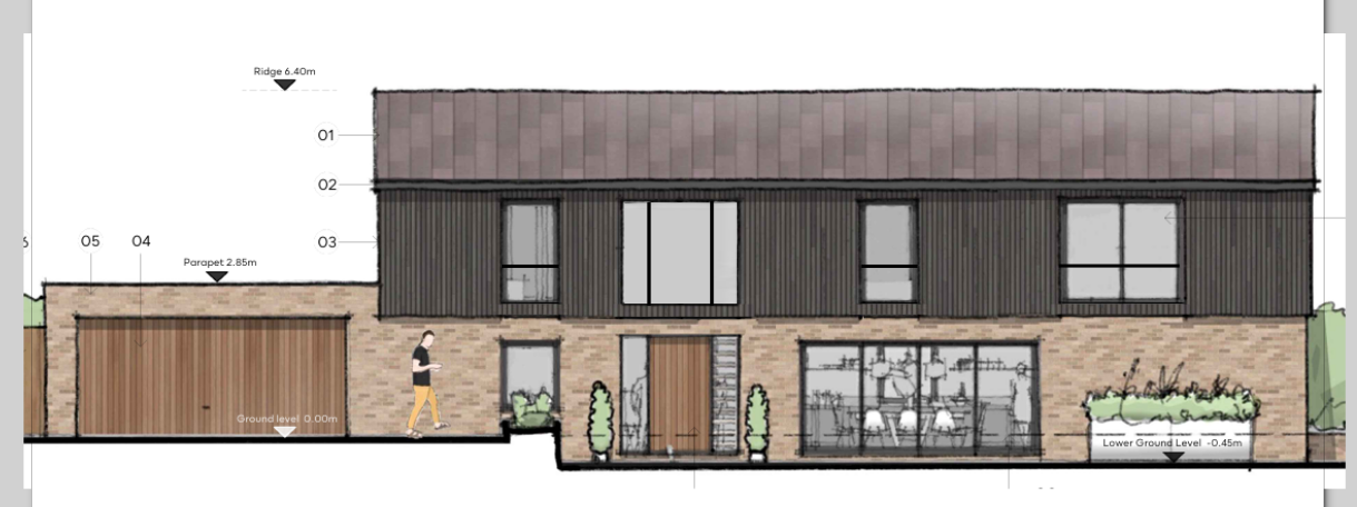

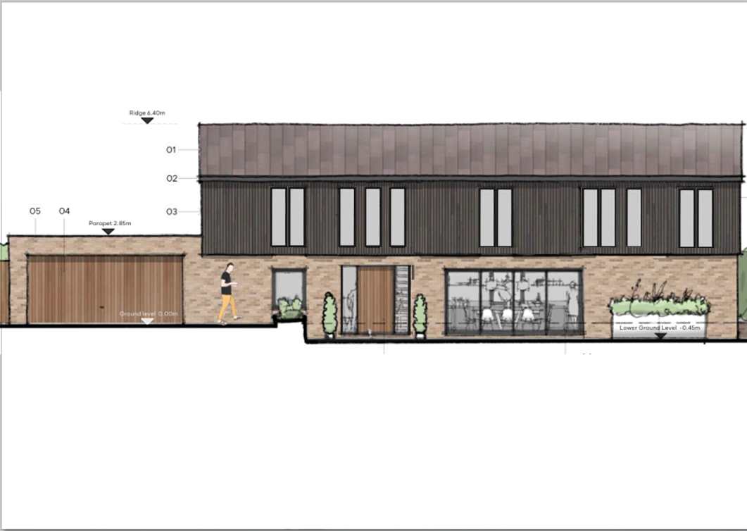

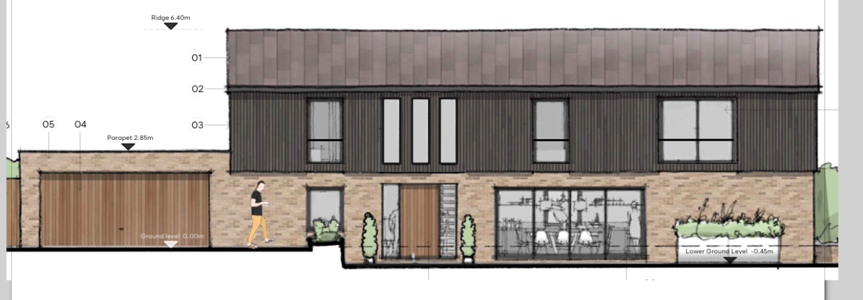

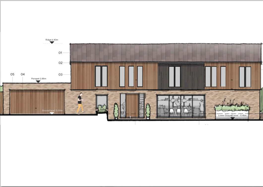

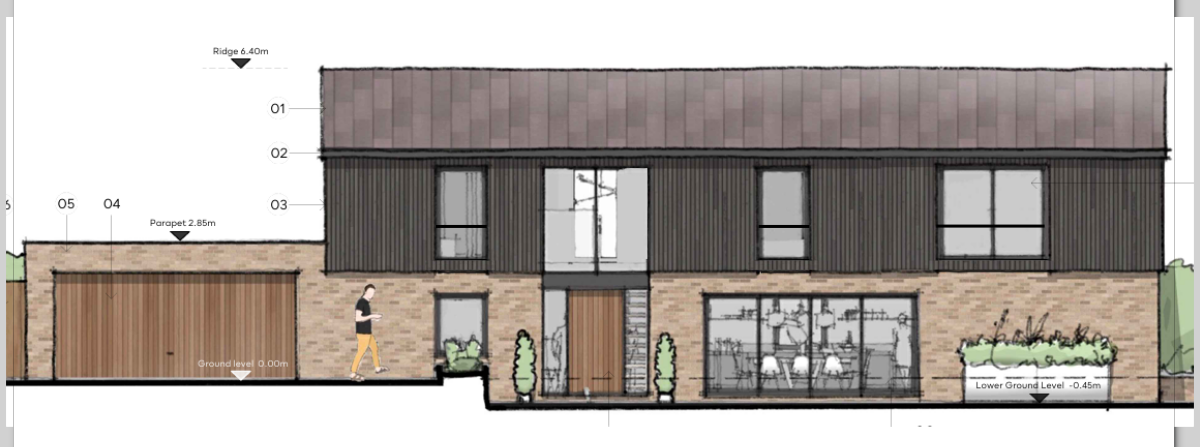

flanagaj Posted Wednesday at 22:22 Posted Wednesday at 22:22 So our planning application was approved on the design below. I personally am not sure about the following aspects, and have come up with a redesign below. The main aim was contemporary a) How the windows will satisfy EEW given they are bedroom windows, and how you will be able to open them if you want to during the summer. Just not sure they are practical. b) I am also unsure whether I like the vertical aluminium sill section that is under each window. I am contemplating one of the two options below and I would appreciate feedback. It's a bit of a spot the difference, eg subtle. Main change is a fixed lower pane on the upstairs windows to enable top hung casements.
Temp Posted Wednesday at 23:25 Posted Wednesday at 23:25 Remember the opening part must be a minimum height above the floor to meet Building Regs (fall from height). Think it's 800mm but check.
dpmiller Posted yesterday at 04:01 Posted yesterday at 04:01 getting that glazing bar at the right height can reduce costs too as it can allow a downgrade in the glass above it. Our archtect designed this into our large front windows. 1
flanagaj Posted yesterday at 06:02 Author Posted yesterday at 06:02 6 hours ago, Temp said: Remember the opening part must be a minimum height above the floor to meet Building Regs (fall from height). Think it's 800mm but check. Hence the redesign. I posed the question below to the architect regarding the full panel windows and I got the response in red. I have no idea what that means. The currently designed windows will be a problem for BC, As the bedroom windows will need to be EEW compliant, they'll will currently require opening stays to satisfy the EEW. I'm not a fan of this and instead would prefer windows that have a fixed lower pane and an opening upper part. Just want a window a window that meets BC regs. You have a protected means of escape so not an issue..

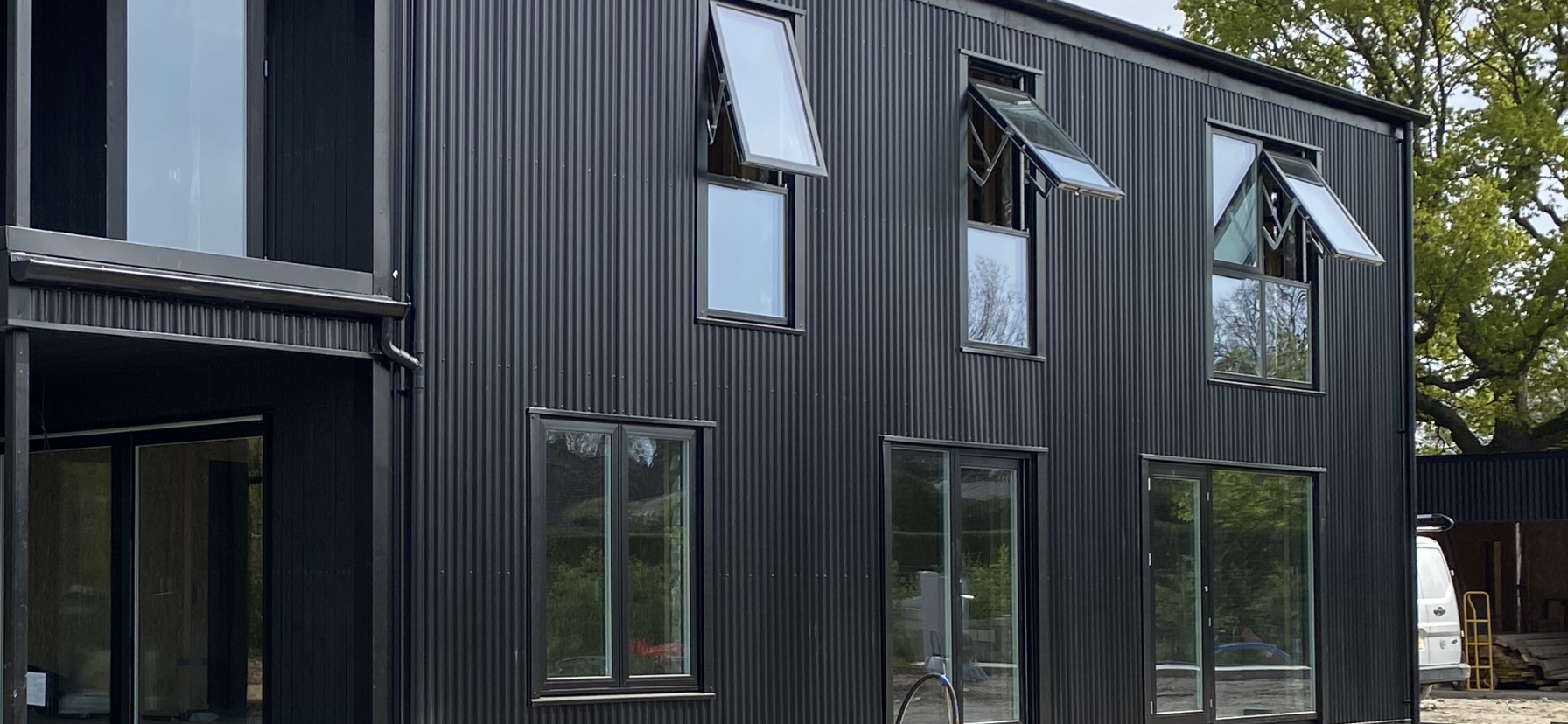

DownSouth Posted yesterday at 09:18 Posted yesterday at 09:18 Design is similar to ours. We don’t notice the cill but ours isn’t as deep. Could you just get them reprofiled? Having little strips of the cladding looks more fussy to my eye - sharing pic of ours, you can see this where the balcony is. Also agree with @Mr Punter it’s worth considering having them as escape windows (if costs not impacted too much). 2
flanagaj Posted yesterday at 10:20 Author Posted yesterday at 10:20 58 minutes ago, DownSouth said: Design is similar to ours. We don’t notice the cill but ours isn’t as deep. Could you just get them reprofiled? Having little strips of the cladding looks more fussy to my eye - sharing pic of ours, you can see this where the balcony is. Also agree with @Mr Punter it’s worth considering having them as escape windows (if costs not impacted too much). Your windows are exactly what I am proposing. We are potentially installing MVHR (depends on cost), but I still like a window that can be opened wide if you want to. A large single pane glass window will most likely be a top hung which for safety reasons only opens a 100mm or so.

JohnMo Posted yesterday at 10:48 Posted yesterday at 10:48 I like this design, but would replicate the cross bar in the window above the front door and the downstairs windows, but not the door side panels. 1

ETC Posted 23 hours ago Posted 23 hours ago I think you don’t like the way the cladding interacts with the brick - and I agree. It needs rationalising. Also you’re using too many different materials-it’s becoming too fussy for want of a better word. Plus the garage looks tacked on the end-it’s needs to be more integrated into the overall design. Watch this space! 1
flanagaj Posted 22 hours ago Author Posted 22 hours ago 7 minutes ago, ETC said: I think you don’t like the way the cladding interacts with the brick - and I agree. It needs rationalising. Also you’re using too many different materials-it’s becoming too fussy for want of a better word. Plus the garage looks tacked on the end-it’s needs to be more integrated into the overall design. Watch this space! This is my redesign and I like the simplicity of it. 1

LDNRennovation Posted 11 hours ago Posted 11 hours ago You can have a protected escape route instead of escape windows, contact your local building regulations officer to check. Op could post their layout so we know and also what the rooms are so they can have the right sized windows. I think the first design was nicer. I like using the same scale of windows only in different configurations. The only one that looks off is the one over the 4 doors. Where they stuck the planter seems like a cheat to hide a big blank wall. the garage parapet needs to be higher for the structure. That will help the weak intersection between the garage and house. might be an idea to get your solar gains checked out from the glazing. 1
