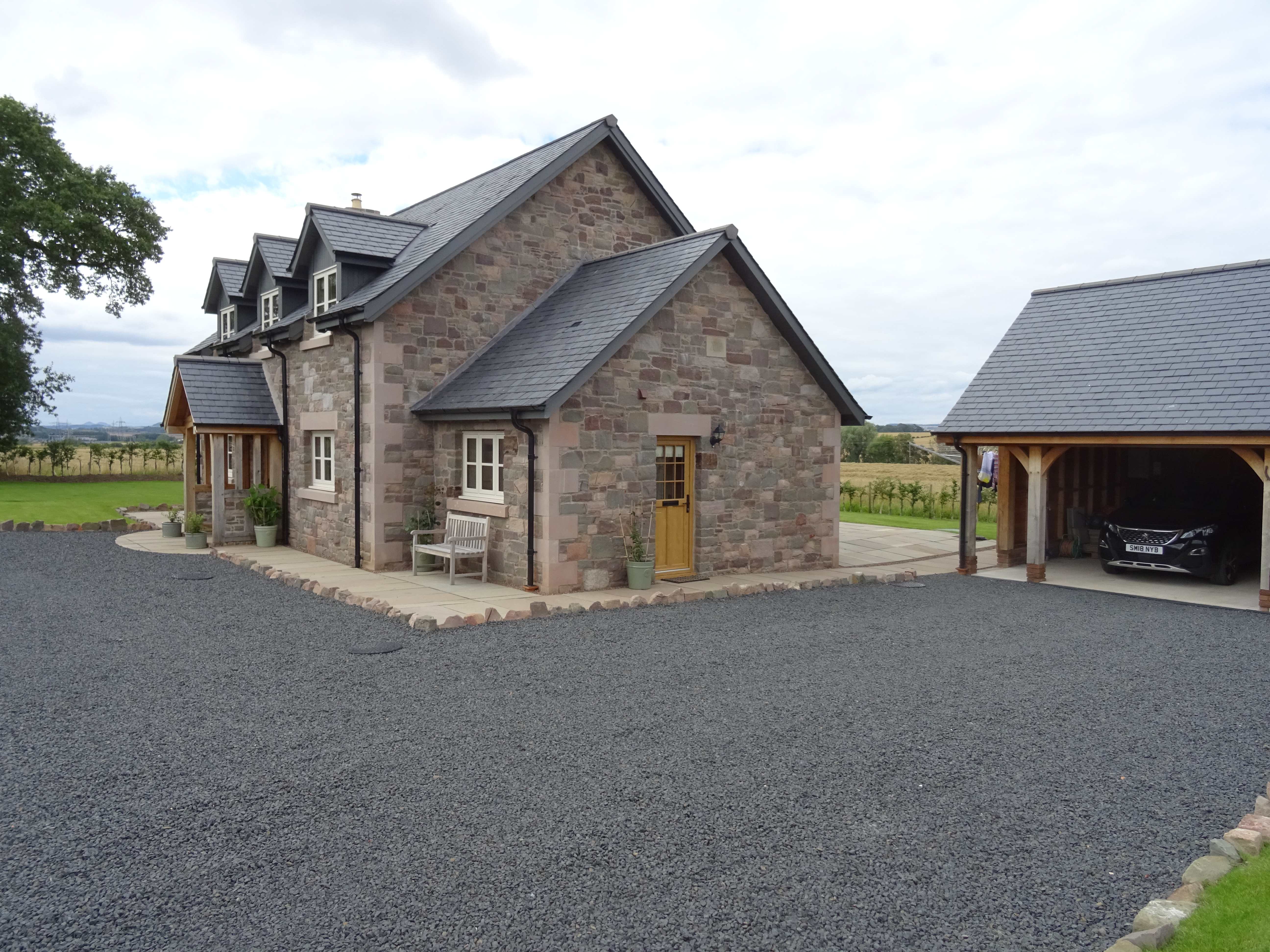

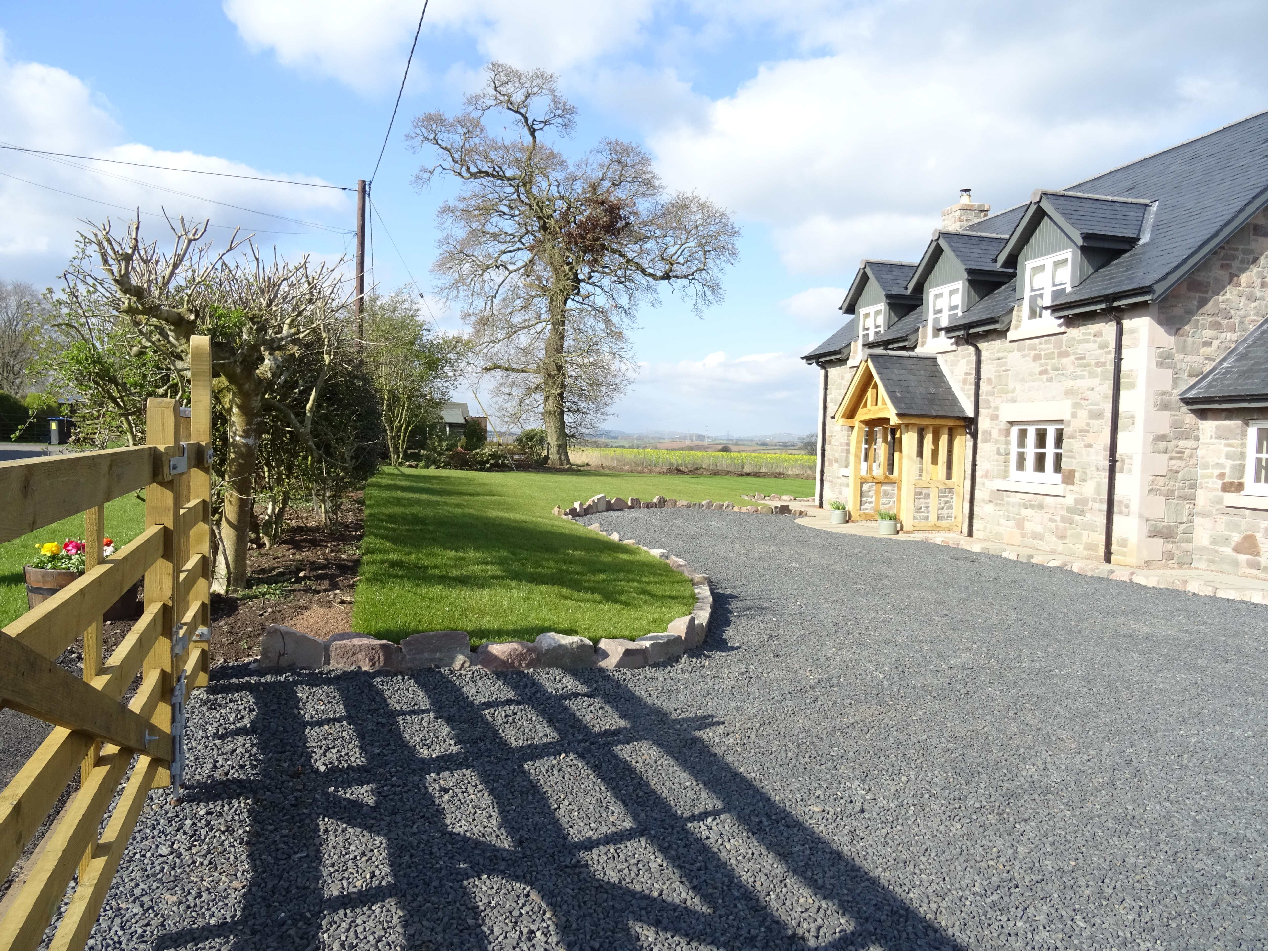

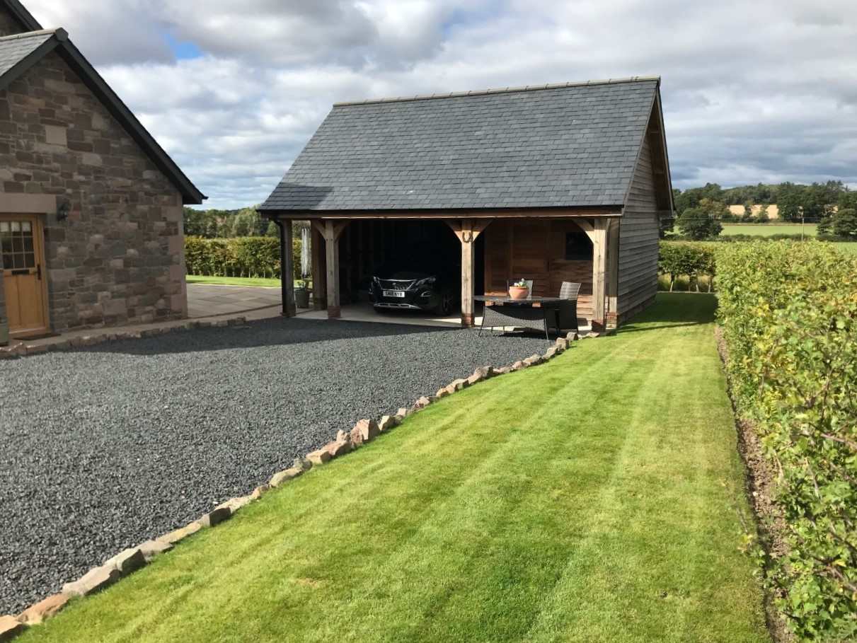

Redoctober Posted Saturday at 13:44 Posted Saturday at 13:44 We have quite an area of "driveway" and opted for 20mm granite chips. In my view they work much better than any smaller stone, as they do stay in place better. Anything smaller would be too easily distributed I feel - see photo for our set up - Occasionally, / rarely, I will rake them over but other than that, job done. 4

Redoctober Posted Saturday at 15:00 Posted Saturday at 15:00 38 minutes ago, BadgerBodger said: The MOT wants compacting well (twin drum roller ideally) and the gravel should knit well. This is a key element too - all in the preparation. As for a woven geotextile membrane, we were advised against having it by the landscaper. His thoughts were it would only get torn over time - the sub base we had down with the 20mm on top would be good enough and I have to say he was right. No weed growth as such, just what gets blown in. Easy maintance all round.

crispy_wafer Posted Saturday at 17:44 Posted Saturday at 17:44 3 hours ago, Redoctober said: We have quite an area of "driveway" and opted for 20mm granite chips. In my view they work much better than any smaller stone, as they do stay in place better. Anything smaller would be too easily distributed I feel - see photo for our set up - Occasionally, / rarely, I will rake them over but other than that, job done. Lovely job, I like! Suits your place nicely. 1

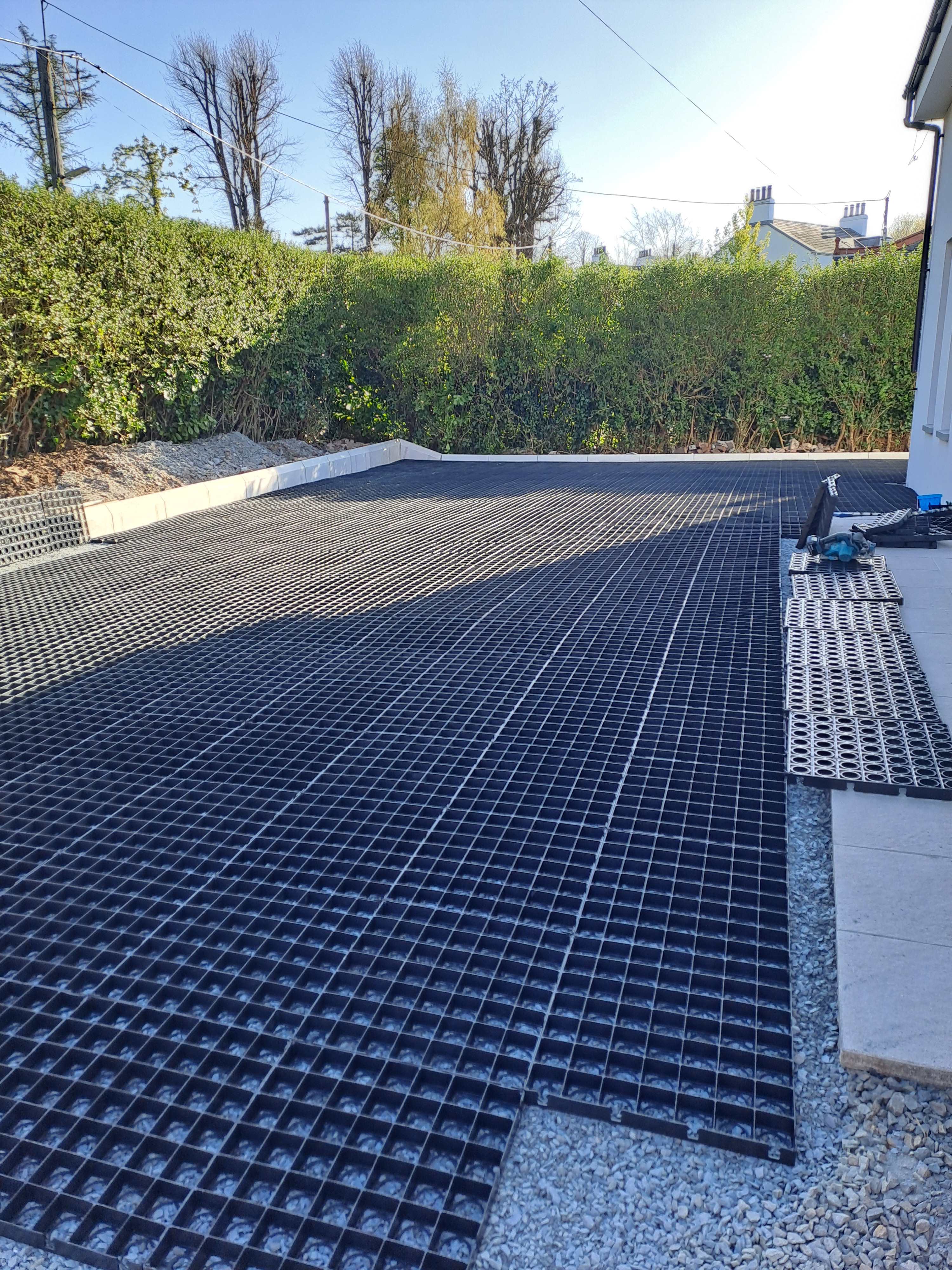

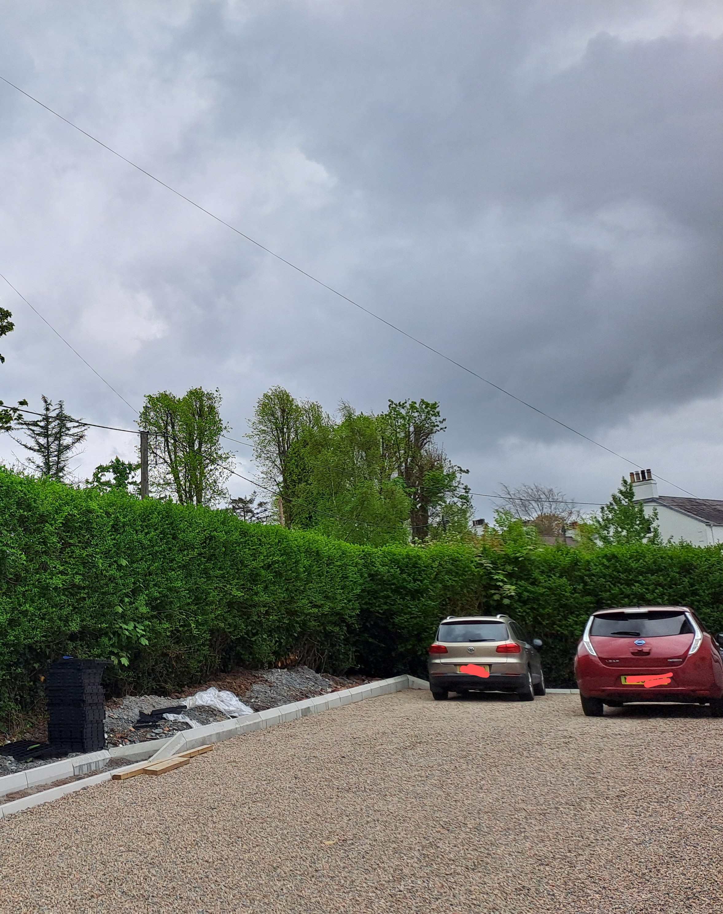

Conor Posted Saturday at 19:06 Posted Saturday at 19:06 We've 10mm mixed stone on gravel grids. You really, really need grids for small stones. 1
Thorfun Posted Saturday at 20:09 Author Posted Saturday at 20:09 1 hour ago, Conor said: We've 10mm mixed stone on gravel grids. You really, really need grids for small stones. We don’t want/can’t afford the extra expense of grids.
BadgerBodger Posted Saturday at 20:45 Posted Saturday at 20:45 1 hour ago, Alan Ambrose said: 1400mm stone? That is, 1.4m diameter boulders This is under suspension bridge piers? No!!! The total build-up was 1.4m. If I recall it was geotextile, geogrid (Tri-axial) 300mm 75-125 stone, three times, with 300mm 6f2 and an MOT capping to make-up. It was a for a pile mat. The permanent structure was built on driven piles. 33 minutes ago, Thorfun said: We don’t want/can’t afford the extra expense of grids. I don’t think It’s absolutely necessary. I was looking to use grid at my place but given that the drive is caked in mud at potato harvest I figured grid wasn’t any use as it would be gunked up with much after the first winter.
Conor Posted Saturday at 21:03 Posted Saturday at 21:03 53 minutes ago, Thorfun said: We don’t want/can’t afford the extra expense of grids. Go for 20-30mm stone then. 1
