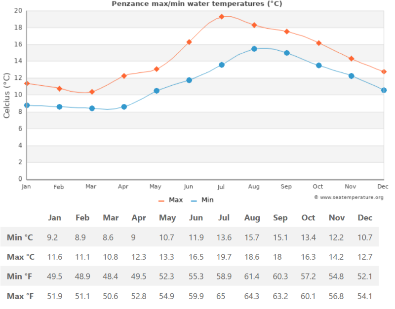

Not just houses, regional weather makes a difference.
Down here, our local temperatures are predominately governed by sea surface temperature.
