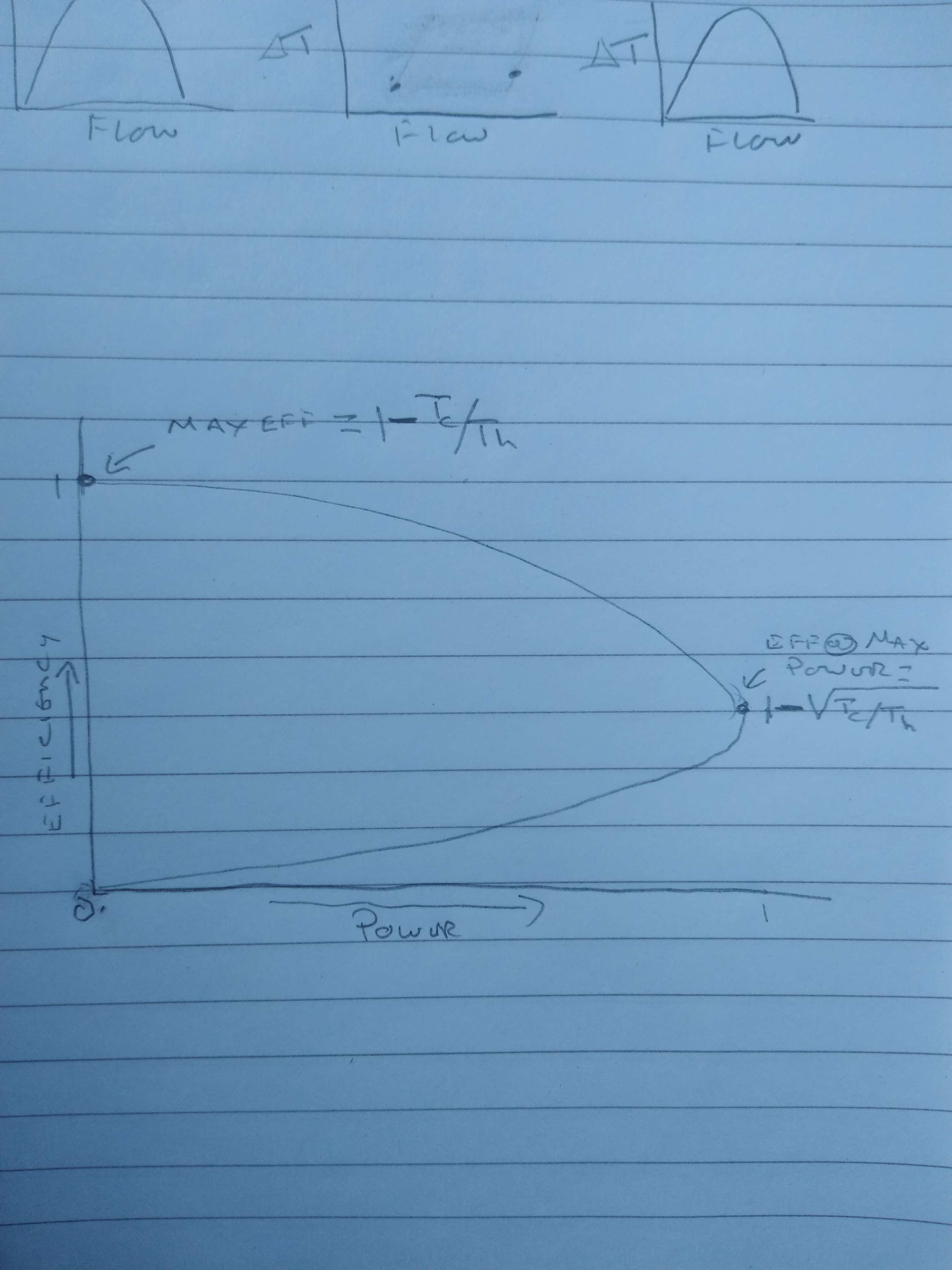

Had a while to kill, so had a think about efficiency of heat pumps.
Basically there are 3 variables, Power, Temperature in the cold side and Temperature on the hot side.
These should fit a curve that follows 1-√(Tc/Th) for efficiency at maximum power.
I have used a simple scale, 0 is nothing, 1 is everything.
Because this is a heat pump, the y-axis can be scaled to represent CoP.
To establish the true efficiency of a heat pump, data really needs to be collected for OAT, IAT and flow rates (both air/water and delivery depending on setup).
>>> Pure Carnot thermodynamics
I haven't heard that word for .... 40 years since engineering school :) Knew it would come in useful one day - well it would if I could remember what it was about.
The theoretical, maximum, efficient from a heat engine.
Heat is the old word for energy, so can be used in some non thermal applications.
More applicable to thermal applications though. I was also thinking about why ICE engines are so rubbish while wondering about all this thermodynamics.
