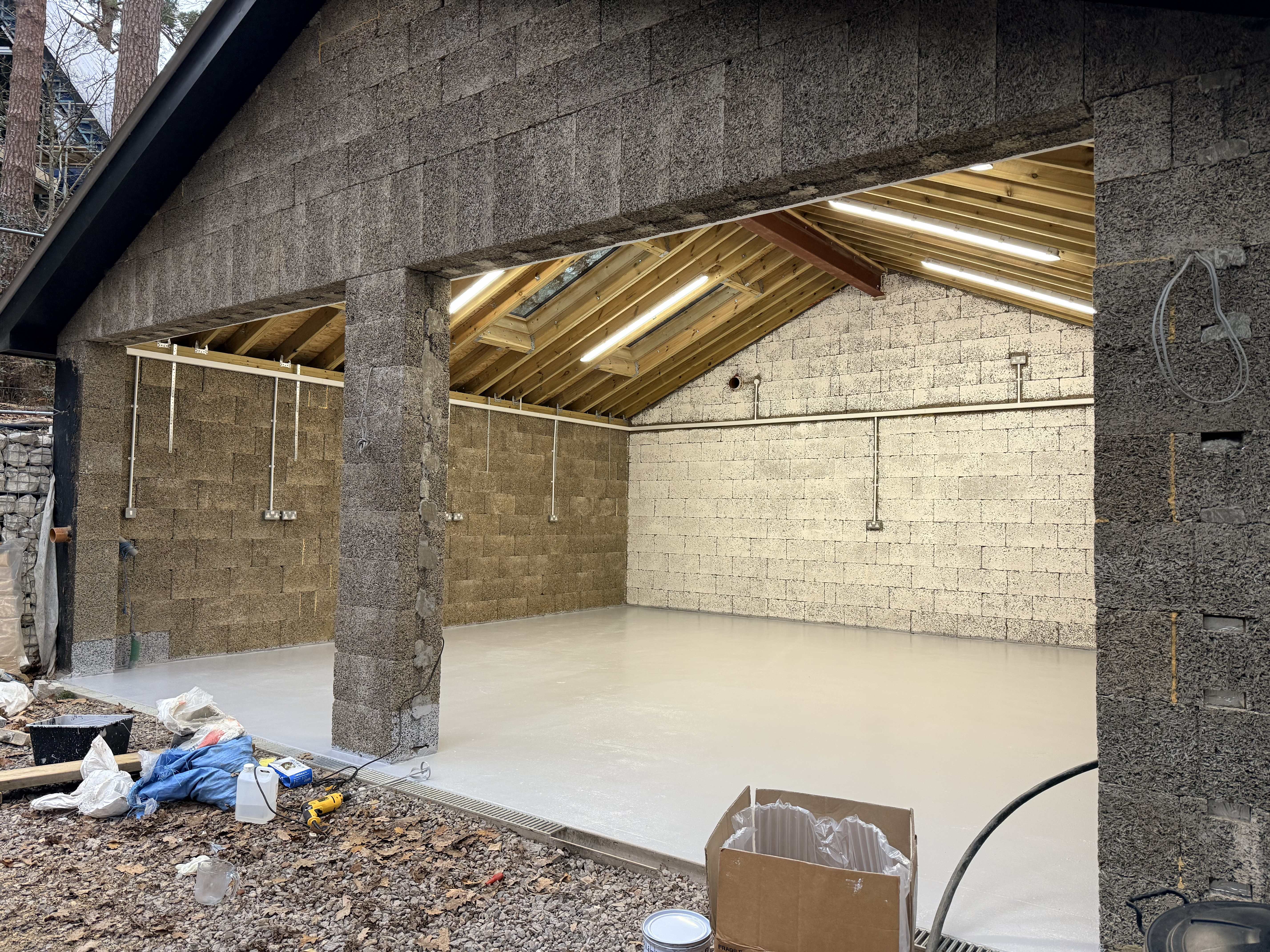

August 26Aug 26 Author Its getting close to the time for the garage to get its floor covering 😀 Epoxy resin. Product recommendations please. Can it be DIY'd?

August 27Aug 27 Author @Great_scot_selfbuild, curious about what the 110mm pipe coming through the wall is for?
August 27Aug 27 14 minutes ago, BotusBuild said: Which make? This was 10 years ago. Just something called garage floor paint and a diy product as well as from paint merchants. Just had a look. Leyland seem to do one. You may be stuck with grey. It was just paint so it dried and couldn't possibly be tacky afterwards.
August 27Aug 27 5 hours ago, BotusBuild said: @Great_scot_selfbuild, curious about what the 110mm pipe coming through the wall is for? Good spot. It’s so we can have an EV charger in the garage, but put a cable through the hole to charge car(s) parked outside. The consumer unit is on the other side of the garage and we also routed a large conduit in the concrete floor. We haven’t made a final decision on location - this was to give us options. I’ve done similar ‘what if’ options. In the house with wiring and plumbing for future possible expansion / change.
