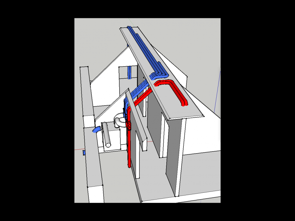

I aim to install a mvhr unit for whole house ventilation
I have read previous post time and again and i hope i have a much better understanding about mvhr than when it first became an idea for me a few years back.
The cottage is small and the system i hope to design is hopefully going to reflect that. I have a long stay volunteer who is very smart and though not that familiar with mvhr is willing to help me with design as he is smart and can use sketch up. I am very practical and adaptable but i would not call myself smart and i cannot use sketch up.
Hopefully with the collectives help, Mr smarts and my practicality we can design a system that i can install and will work as hoped.

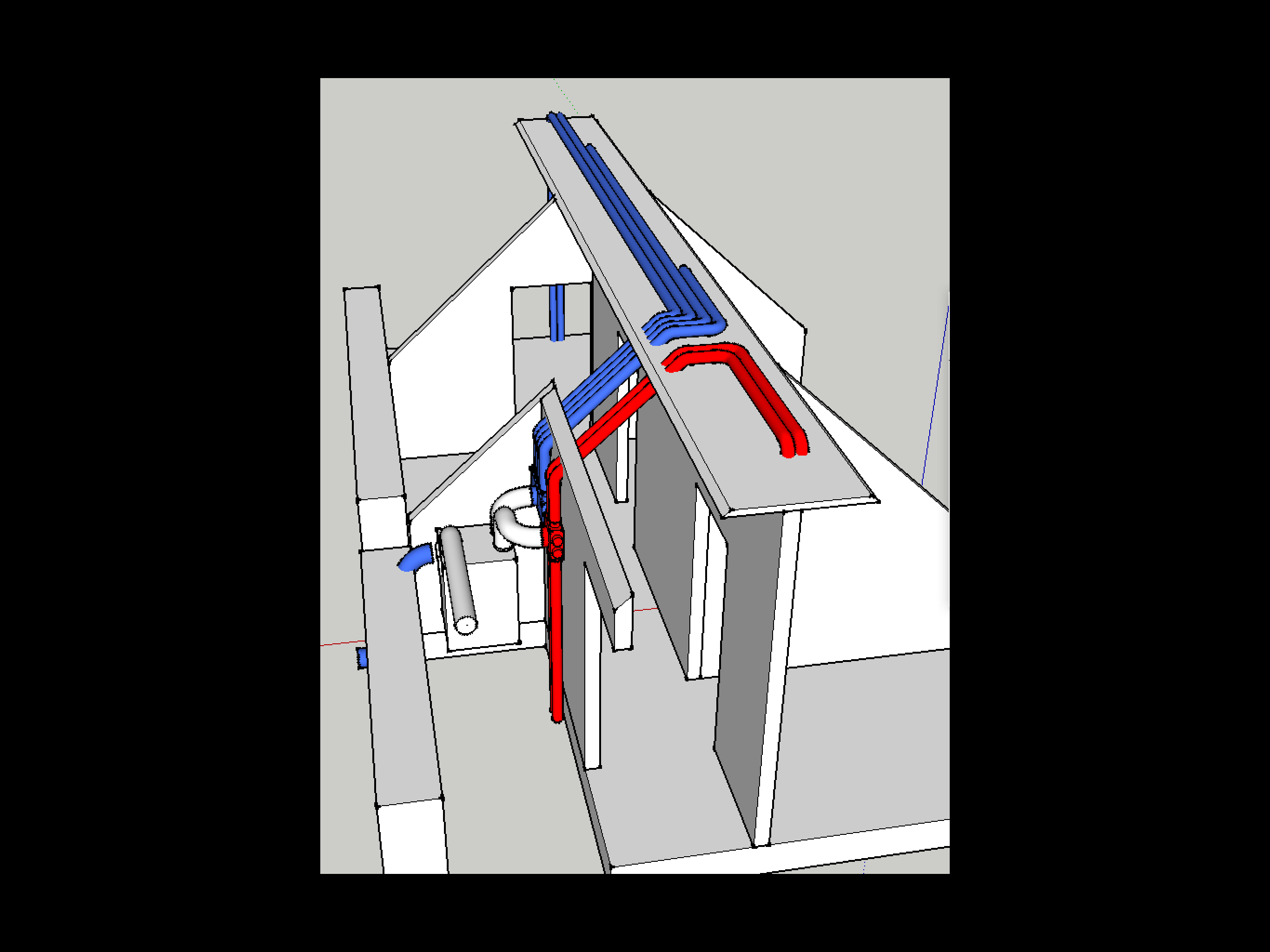

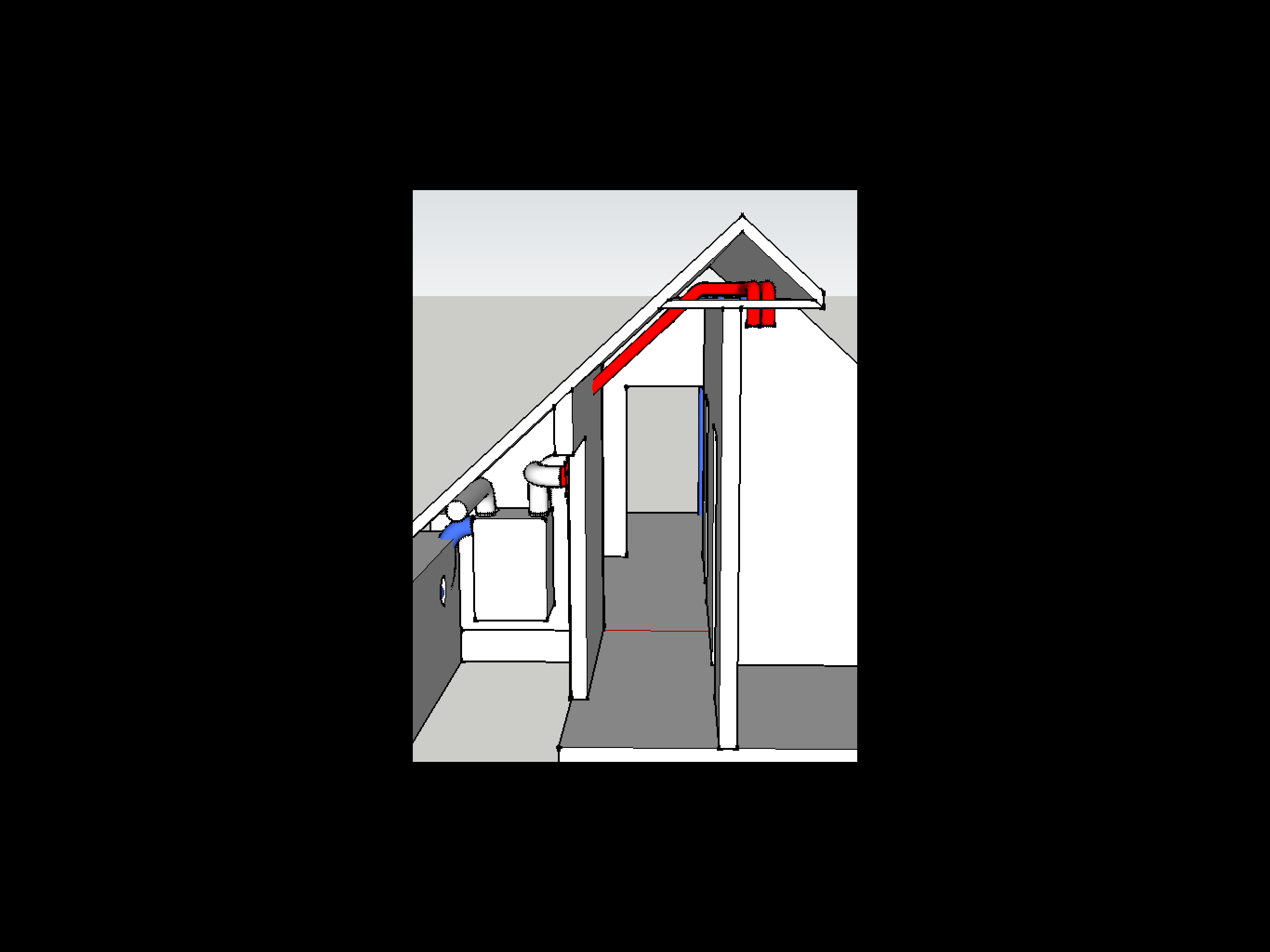

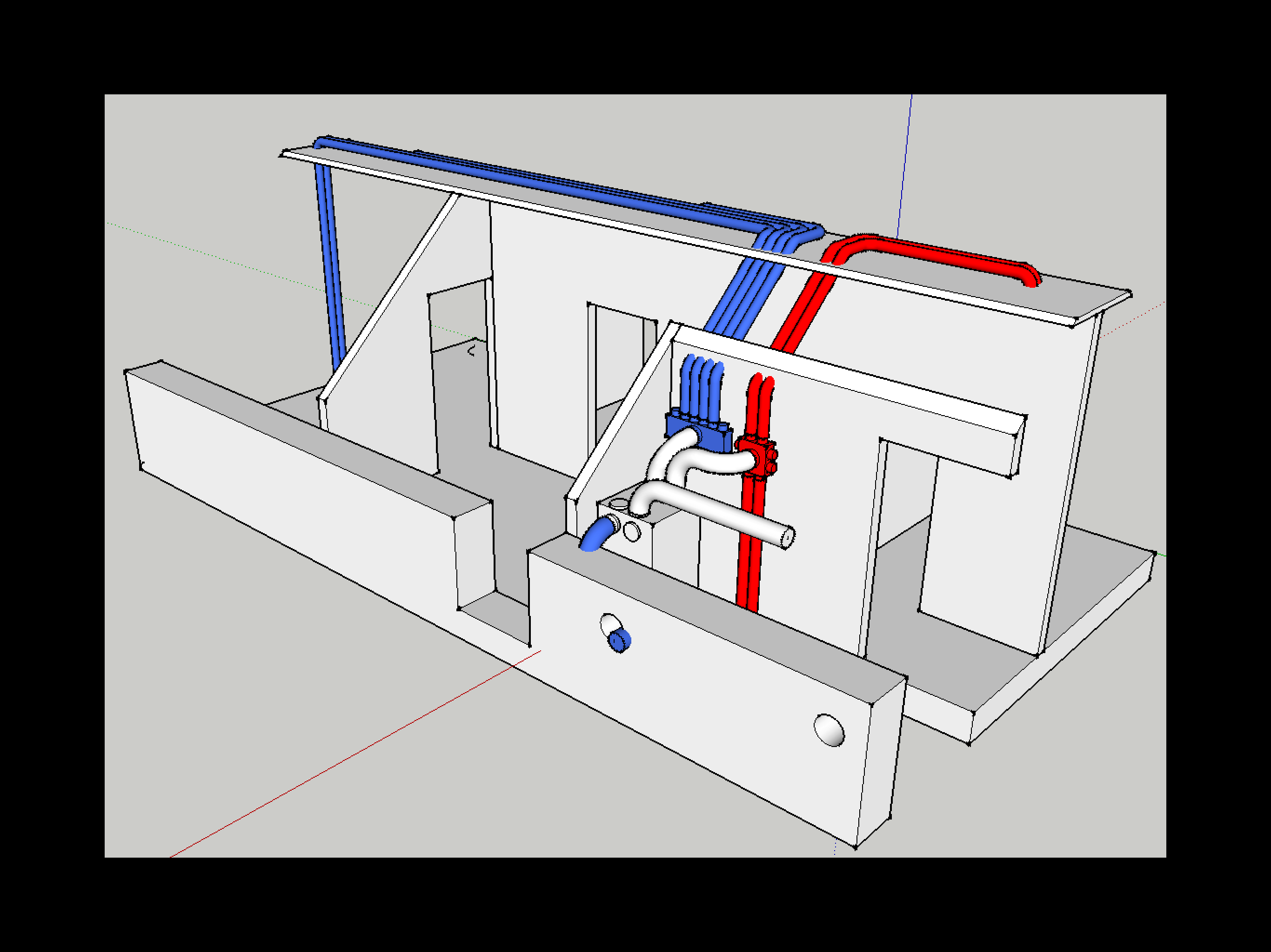

Being a small house the only place for the unit is in the stairwell. There is plenty of height so it does not impose on users and with some quirky wood work i can make it look right at home.
I will gather all the information i need together in a presentable form and will then start asking questions. I already have an mvhr unit as it was super cheep on ebay.  Its oversized but can be adjusted according to requirements.
Just a few of Mr Smarts screen shots from Sketchup. As i said i will get all the info together and come back to ask questions. Please be patient with me on this one.

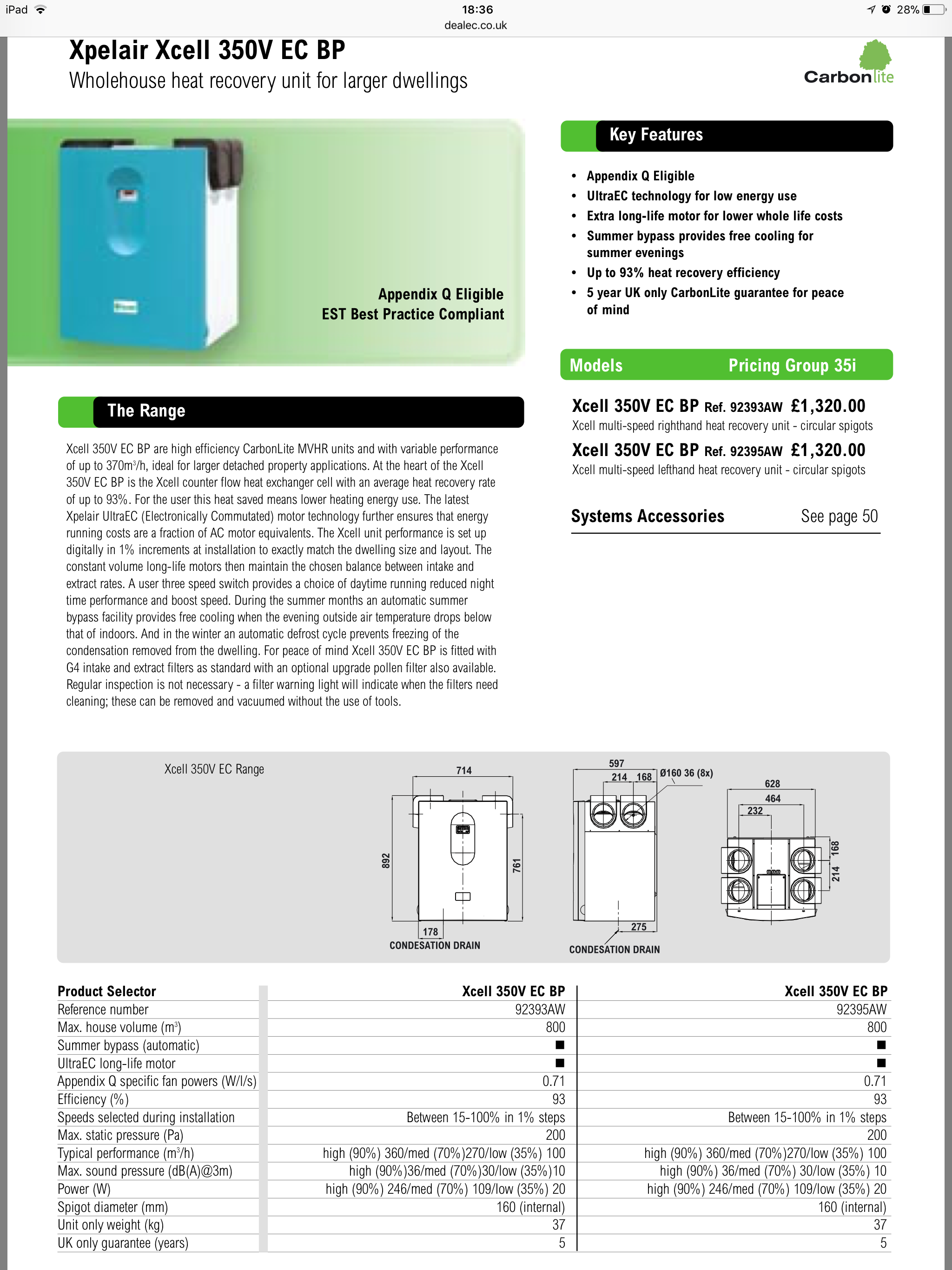

@Crofter    I got this one for £300 new of eBay it can do up to 370m3 and my place is shy of 250m3 so i assumed.... this would be a bit big but it has the ability to be wound right back so hopefully... providing minimal work and good efficiency but have the ability to boost from kitchen and bathroom on a humidistat or switch..... it was my first “risky” buy of ebay and i am yet to understand the consequence of that decision......

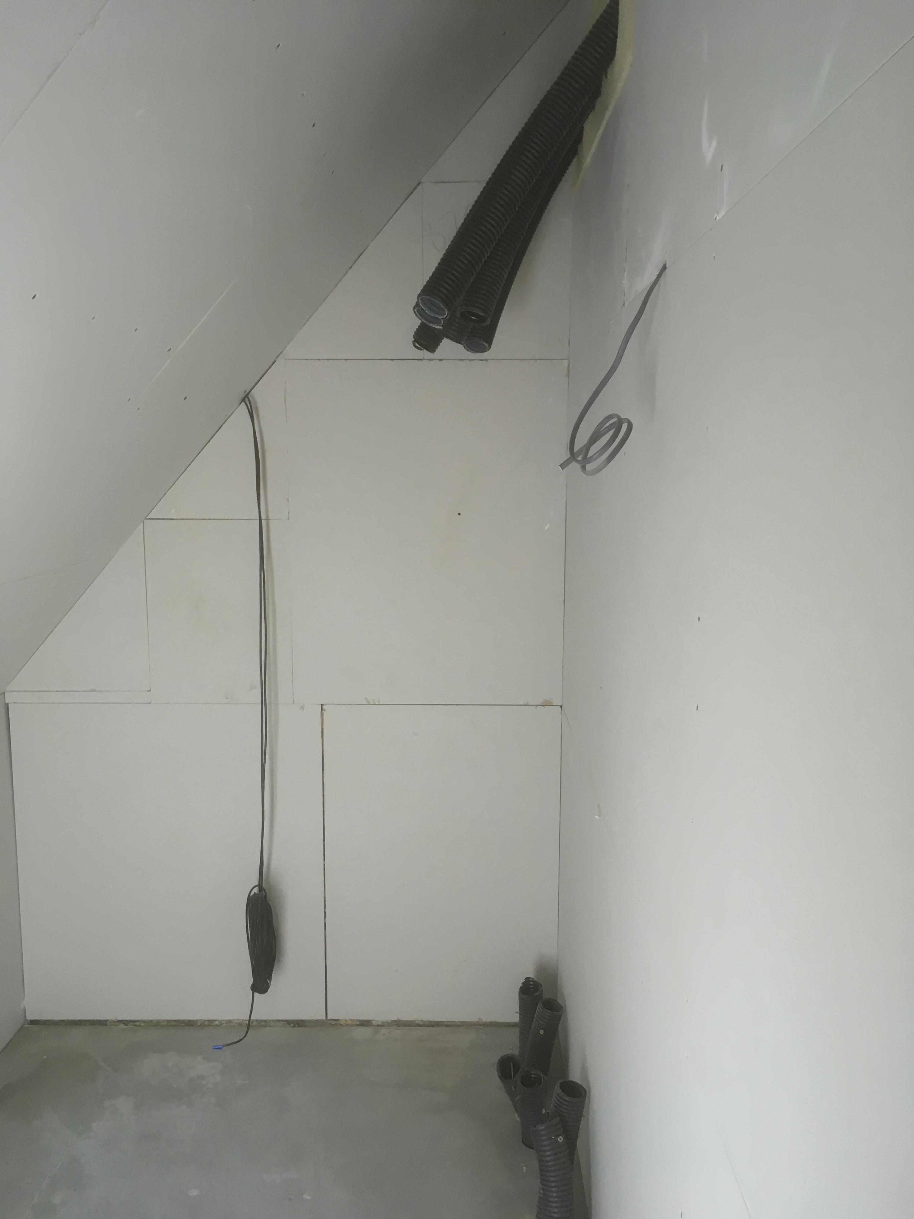

Am getting close to needing to instal my mvhr and ducting but want to get closer to choosing the ducting. Its a small cottage and there is only 51m of supply ducting needed and 31m of extract ducting required.
12 hours ago, Stones said:
I've had MVHR in 4 houses now, but this is the first I've had to fit a silencer. Not sure if its the MVHR or type of ducting I used this time (semi rigid) around.
Given the small amount of pipework needed i want to get the best i can. Semi ridgid is appealing (and seems to be the preferred option on here) for its simplicity but as my duct runs are relatively simple and short  should i be looking at rigid. Noise reduction is very important to me as its a small house and short duct runs from unit to extract / feeds.
lounge feed 16m
end bedroom 11m
middle bedroom 8m
bathroom extract 10m
kitchen extract 5m
stairwell extract 2m
Fitting silencers / attenuators will be required but a bespoke approach is needed as space is tight, following @JSHarris and @Stones approach on how to do this.
so my question is what recomendtions do people have for quality ductwork, i will look at fittings next but before trying to get a package deal i want to get some independent advice from people who have fitted and are living with mvhr.
As always thanks for any advice.

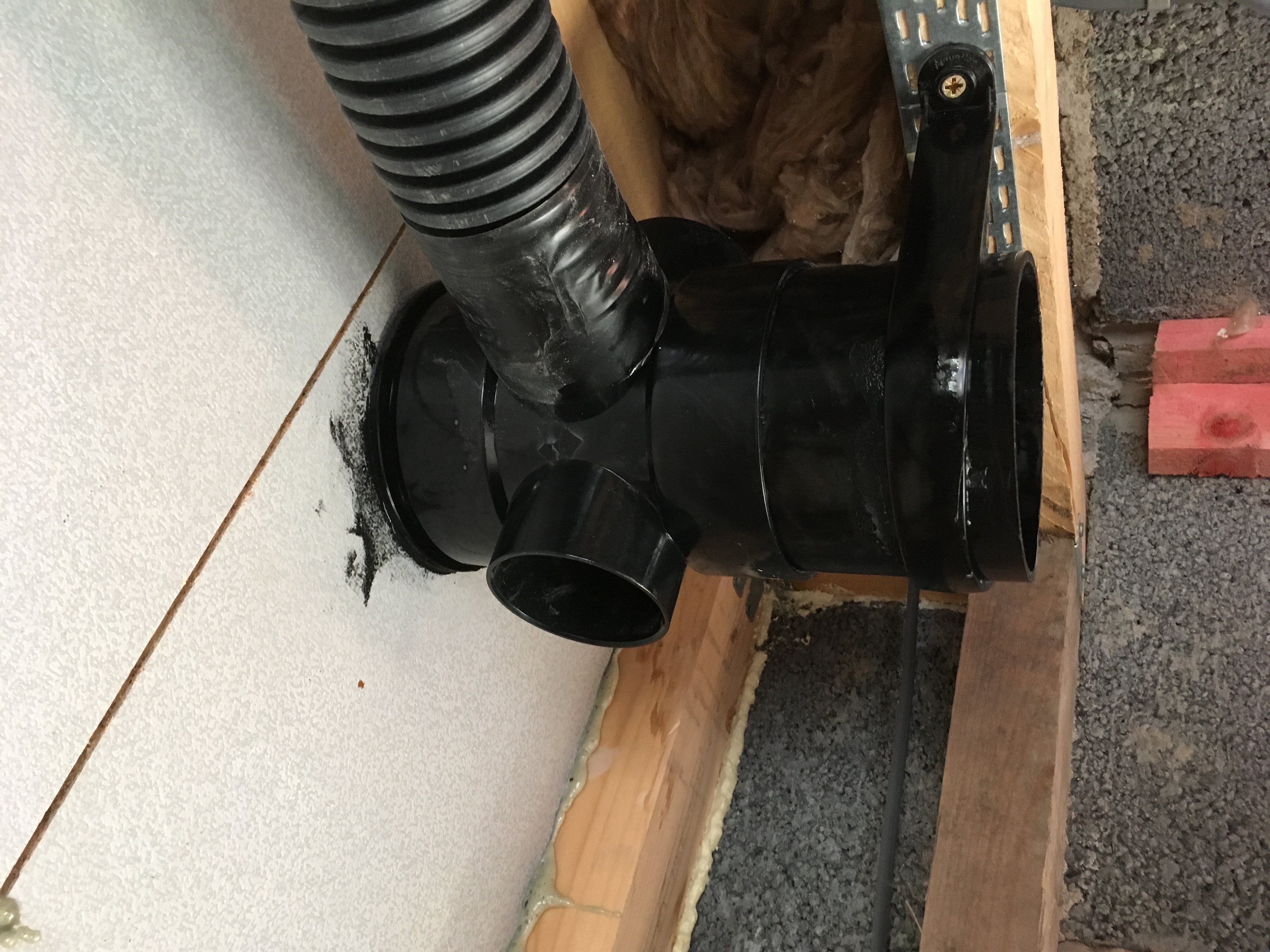

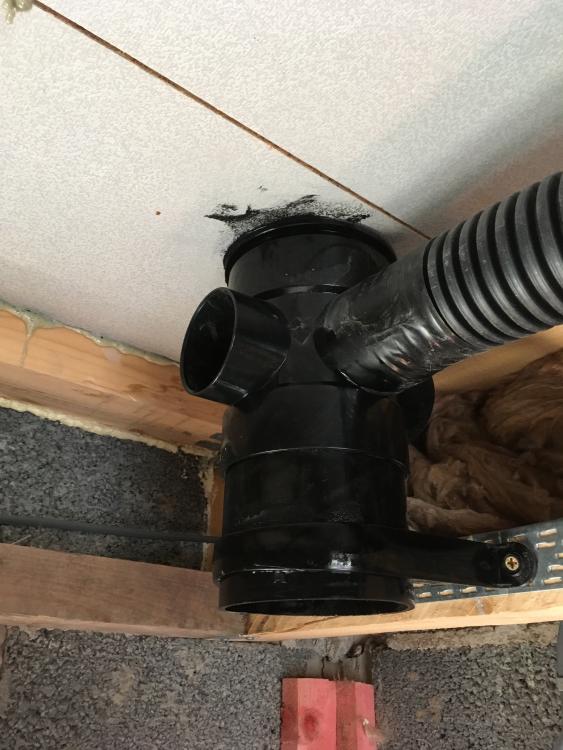

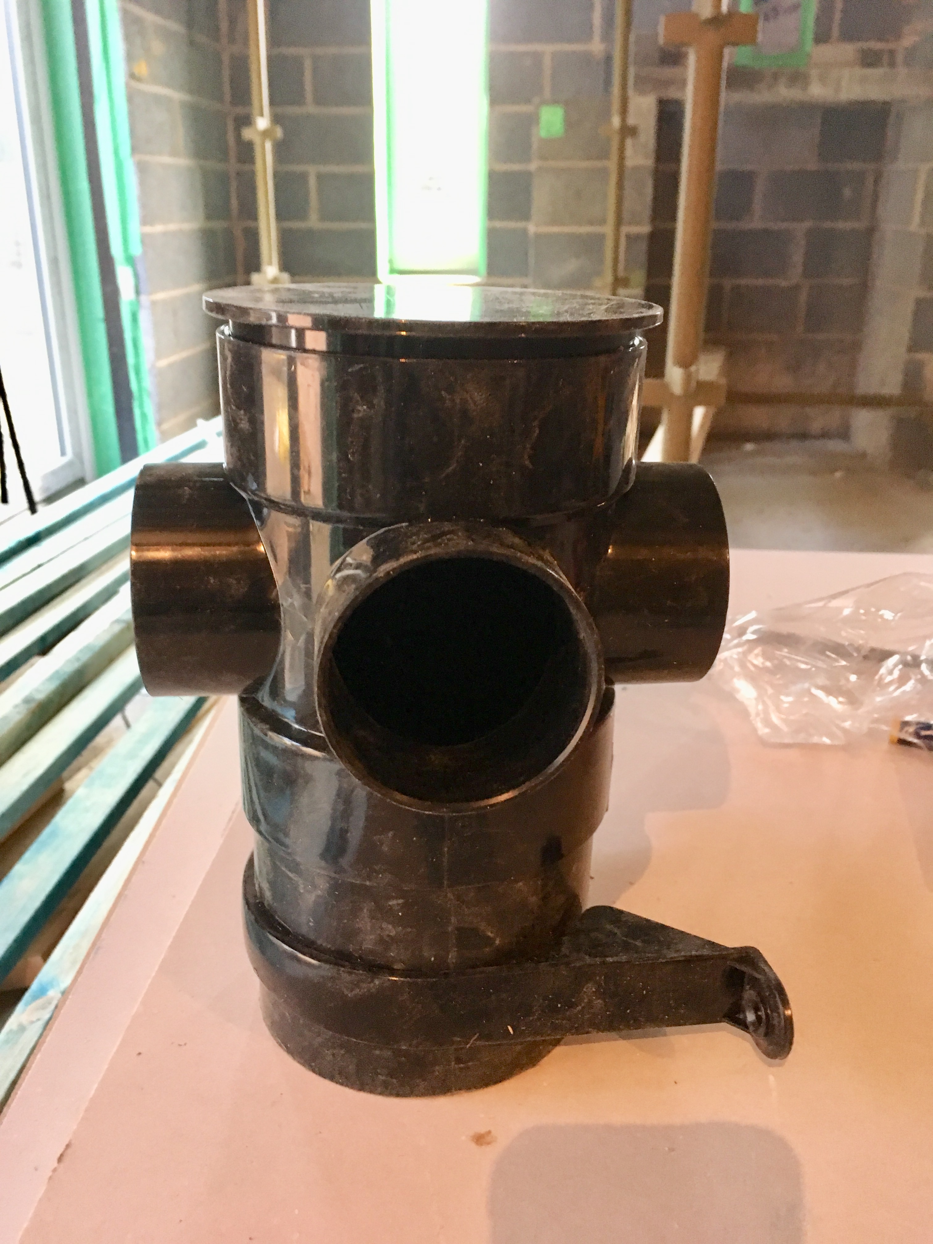

I’m doing a “hybrid” install as like @joe90 I picked up a decent Mitsubishi/Kingspan unit for less than £60 in an auction and it was brand new.
So far I have the terminals and the ducts in back to the location the unit will be placed - I will most likely build a silencer as part of the distribution system.
I used a spreadsheet to work out the duct velocities and found that I could drop to 55/63 standard electrical duct for the distribution with no real issues.
Terminal plenum are made of off the shelf uPVC solvent weld fittings and the terminals themselves are from Toolstation ..!

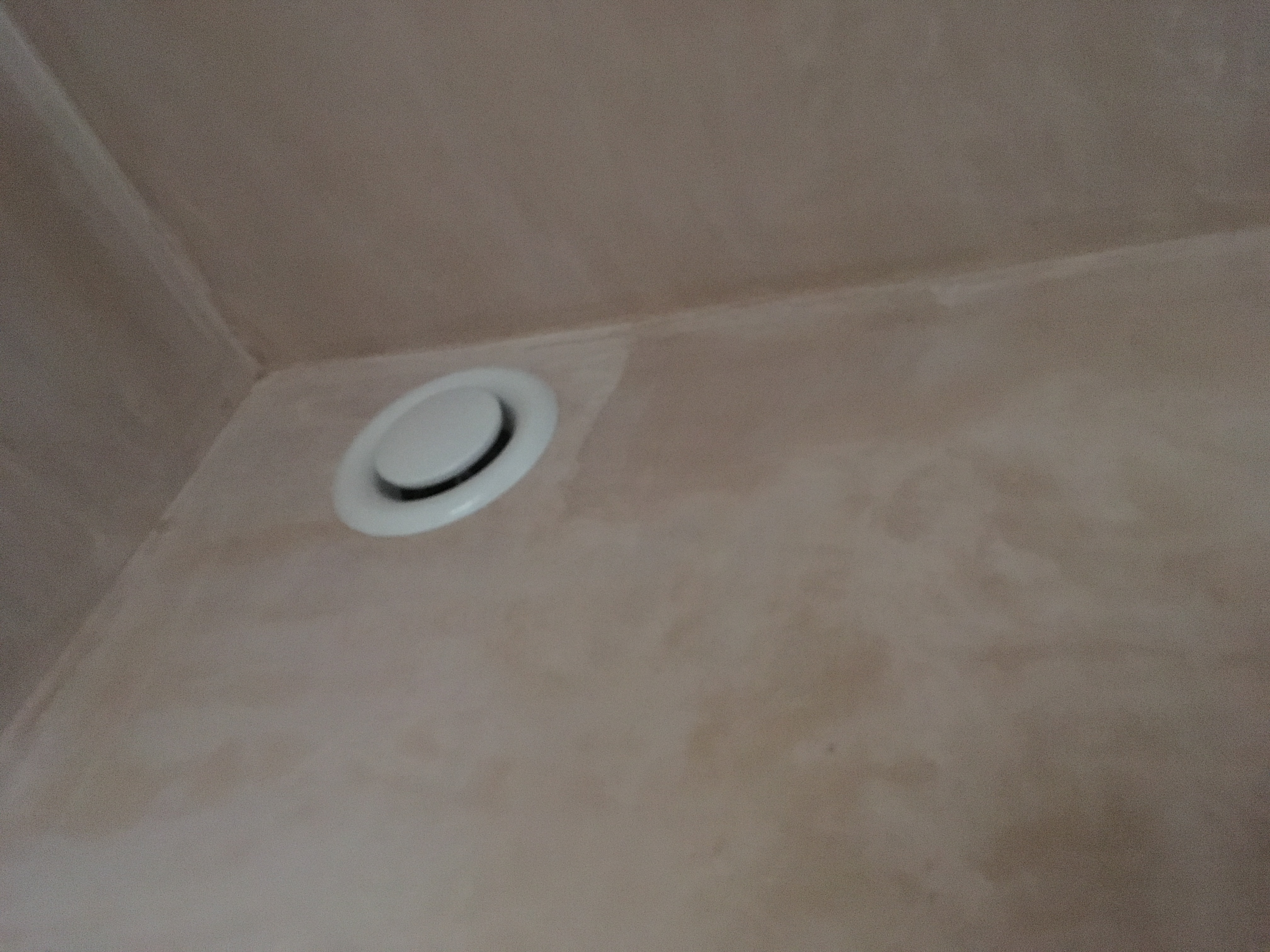

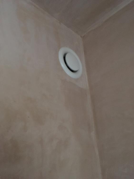

Very nice white steel two part terminal with a galvanised steel flange that has been glued / plastered into the wall or ceiling as they fit with about 2mm tolerance into a piece of soil pipe. You can just see this one in the top corner.
They have a foam gasket on the outer part and are a 1/6th turn to fit them - you can see the coarse thread in the image on the website. There are no sharp edges to the valve itself and they seem well made.
There are two where we have them wall mounted, the remainder are ceiling mounted. I may also fit carbon foam filters into the extracts in the kitchen - there are two - so that it keeps grease out of the ducts.
Total spend so far is £150 on ducts, £150 on 12 terminals and parts (that’s a solvent cap, solvent stub branch, bracket and offcuts of pipe) £60 on the unit and the most expensive was £80 on the proper Mitsubishi controller ..! Another £100 should see me done including filters and externals.

@PeterW, I really admire your ingenuity!  I wish I'd thought of doing something similar, as using standard plumbing fittings allows a heck of a lot more freedom when trying to fit things in.
Thanks Jeremy !! It came about from a partial cost and partial “it can’t be that hard” sort of discussion ..! It was by chance we found that the electric duct is a tight interference fit into a solvent boss - we tried a couple of things including rainwater fittings but they soon added up ..! The duct tape is just there to ensure nothing comes loose in the future although given how hard it was to get it to fit, I don’t think it’s coming out any time soon ..!!
The most expensive part believe it or not was the solvent end caps - in all the downstairs rooms these are “bonded” onto the floor above with a decent high strength adhesive and then the bracket just keeps the lower pipe in place.

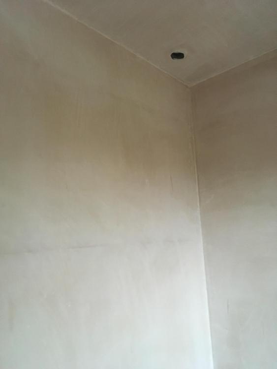

The nice thing about the Toolstation vents is the two piece design means the soil pipe can be slightly above the plasterboard ceiling and then a hole is cut and the flange covers the small gap between the bottom of the pipe and the ceiling itself so no difficult cutting needed to get them flush. It will also give a lip for a drum of carbon foam to sit on in the kitchen.
Roughly speaking then your duct was about 1/3 the cost of the slightly larger bore stuff many of have used.  Well done!  From what you say similar 1/3 - 1/2 the cost for the other comparable parts?
33 minutes ago, Stones said:
How have you secured / fitted the ducts to room terminal plenums?

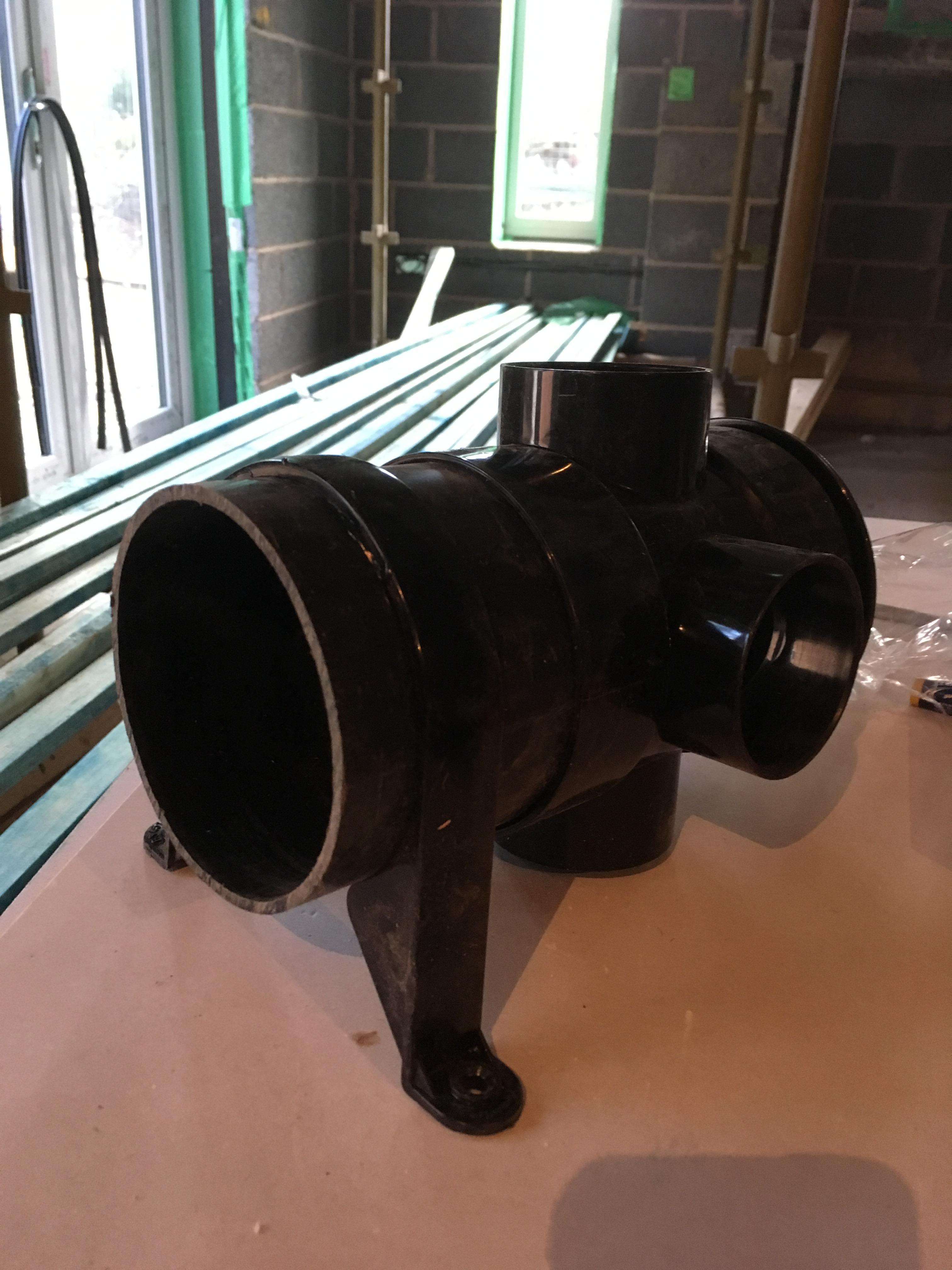

So the room terminals are made from a solvent end cap, and a solvent boss fitting with a variable length of solvent weld pipe to make up the depth needed. Some need about 150mm to fit between the ceiling and the floor above, others are just about 90mm as they are only secured to the ceiling joists.
You can see the boss here - the middle branch is pre-drilled and I did consider using strap bosses but the caps would have then not fitted.
The flanges do rattle a little in the 110mm soil however a liberal use of solvent free adhesive means that they are then held into the board and the plenum. The plasterer then skims over the flange and they are going nowhere ..! Flanges are about 0.8mm steel and well made.
I looked at duct costs and from memory I think it’s come to about the same as a single roll of standard duct from any of the usual suspects.
Prior to finishing I’ll be pulling a pompom sprayed liberally with Mr Sheen (other sprays are available) through each duct to clean out any dust.
Cost-wise I would say yes.
A plenum is £7.85 plus a pipe offcut, and the vent itself is £6.98. I also made sure these all got bought with “offers” so total is around £12.50 per room.
