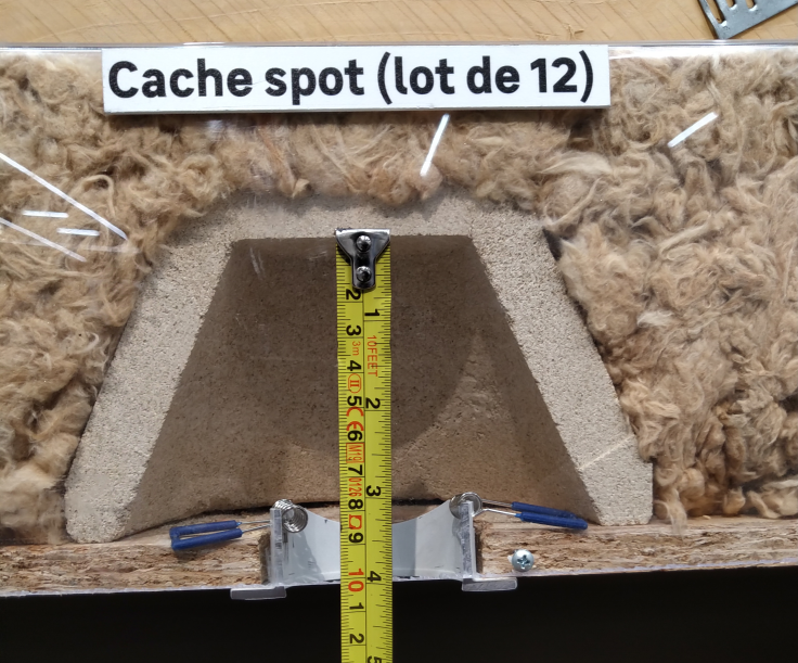

Mike Posted February 25 Posted February 25 (edited) For interest, here in France intumescent downlight hoods aren't a thing - at least I've never come across them. Instead they currently mandate this type of fire-resistant, air-tight, & acoustic hood, mostly made from compressed vermiculite, unless LED downlighters suitable for direct contact with insulation are used (which they often are): Edited February 25 by Mike
